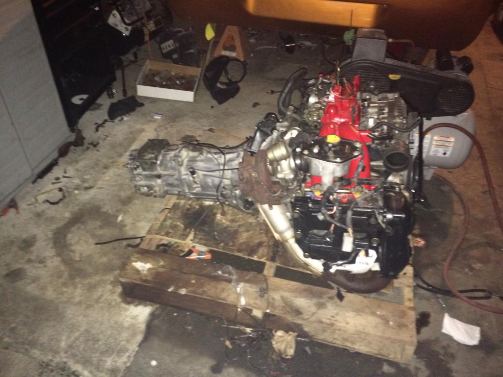

Update!Ive finished lining the interior and floor pans. In much more cool news after many attempts, two different clutches and, two flywheels my engine and transmission are together! (kinda like pandas, many attempts to get them together) soon i will have the trans hangars from ian and a new motor mount welded in.

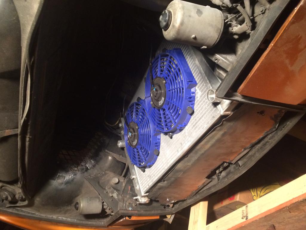

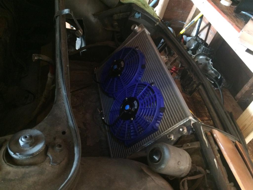

I almost forgot i also welded in radiator mounts and im in the process of mounting the radiator now
Your not going to hard mount it are you. You need some rubber at the mounts to account for flex. If not you will get cracks in your radiator & it's life won't be long.

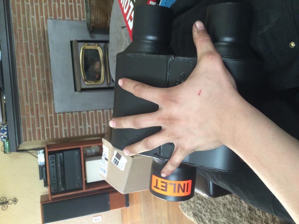

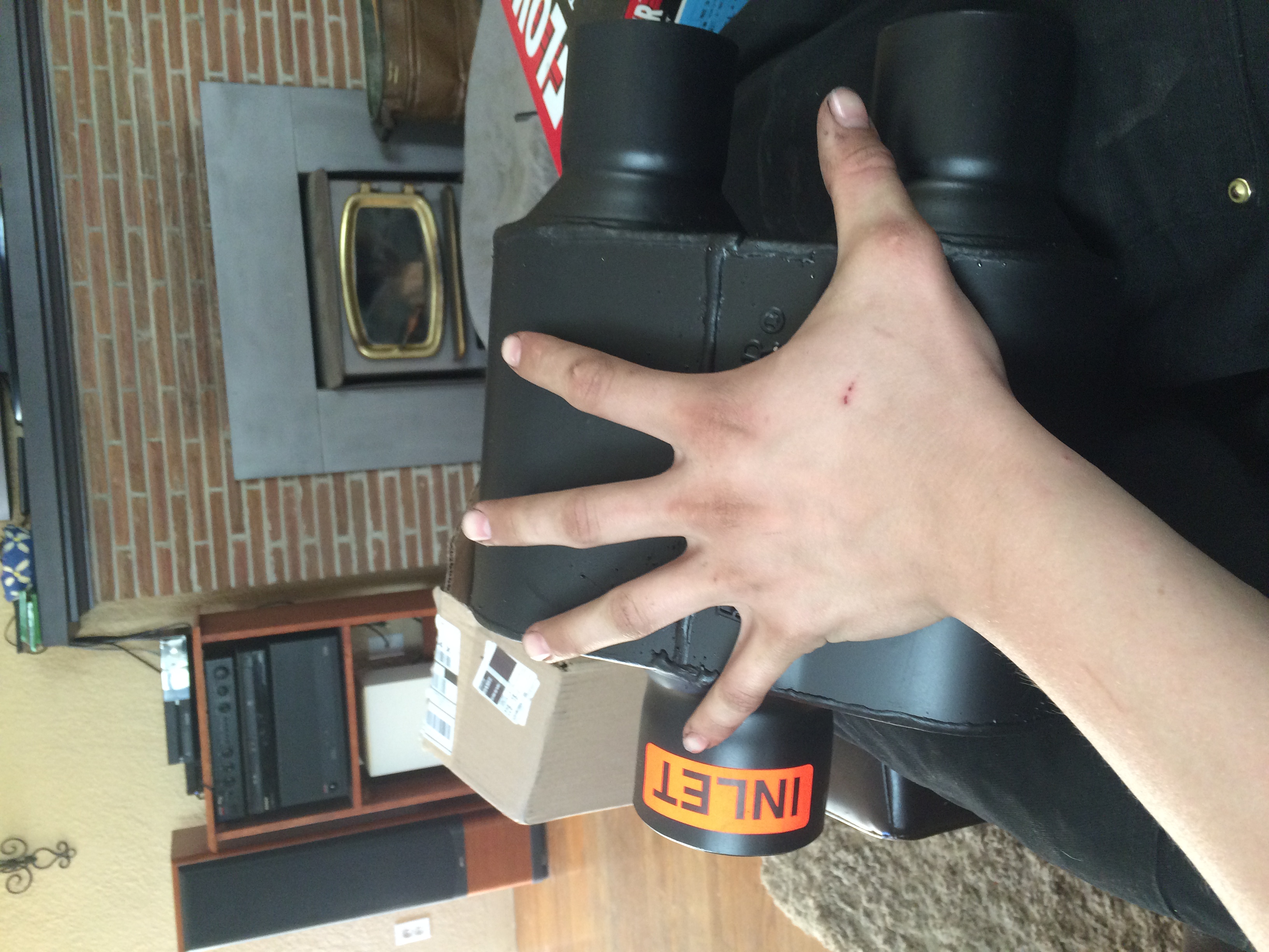

Been a while since my last post but, the engine and trans are together! I received the trans hangars from ian and im now working on finishing the motor mounts. I have sent my axles out to get machined to what is hopefully the right length. The axles were cut down to 18 7/8" then resplined to the Subaru splines. im finishing my radiator shroud using metal from the original fenders i cut off for the widebody. I also received the muffler for my car, its a flowmaster super 10 and it's about as big as my hand, sorry neighbors.

I too bought the radiator with fans but no shroud in error. you'll probably need s shroud. I reused my renegade shroud but I am finding this radiator struggles to keep a sbc v8 at 190 degrees. as the summer temps start to rise, I expect problems (IMG:style_emoticons/default/sad.gif) I may put a fan on each wheel well opening to expedite hot air flow out of front trunk.
Are you saying you bought this radiator? im making a shroud right now and its not turning out too bad had a little change of plans at one point but it should work. i also have fairly big openings for exhaust air.

I now have my radiator shroud done for now. Later on im gonna properly paint it but im running out of time. Im trying to bring it to the pierce county skills center car show on the 21st of may. its on 160th and canyon in puyallup WA. The more teeners there the better. Id love to not be the only 914 there(considering i make it). Attached Image

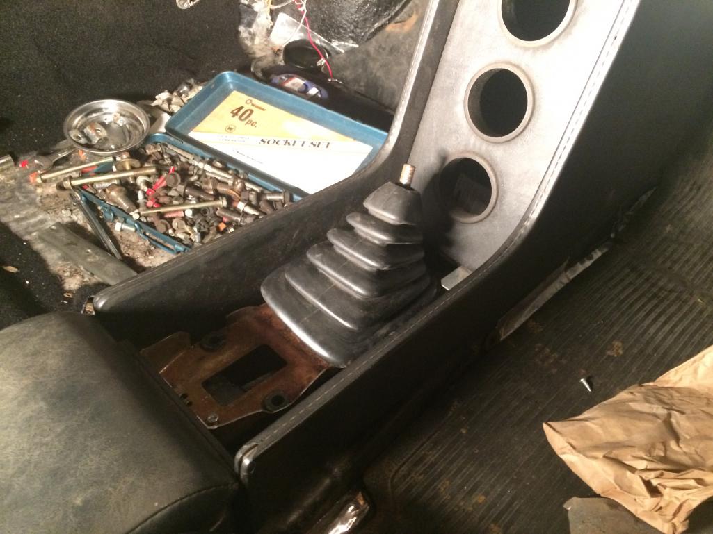

Ive also been working on the shifter. i got the cable shift kit from ian at coldwater 914 and i am trying to prove that you can use the mr2 shifter and stock center console. so far so good!Attached Image

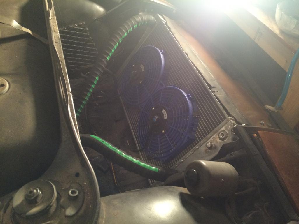

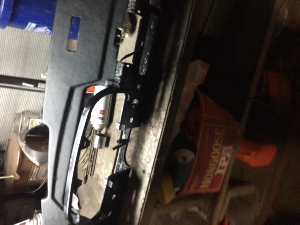

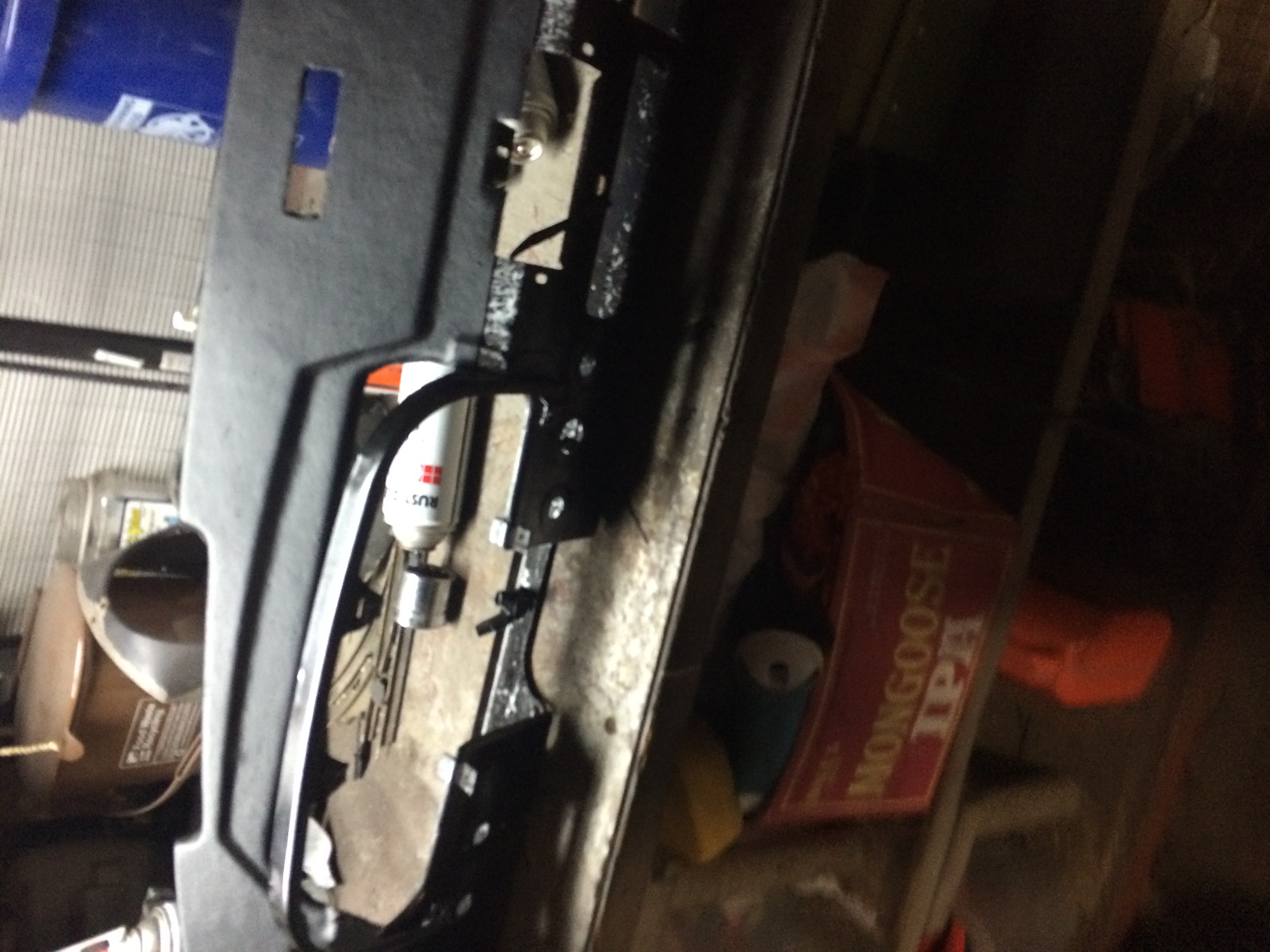

installed radiator hose last night. it was flexible 1-1/2" hose and it fit perfect through the rack and pinion. a hole was cut and now it looks like a racecar!Attached Image

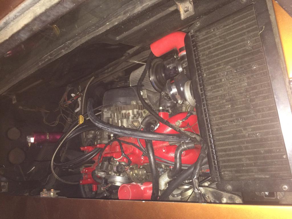

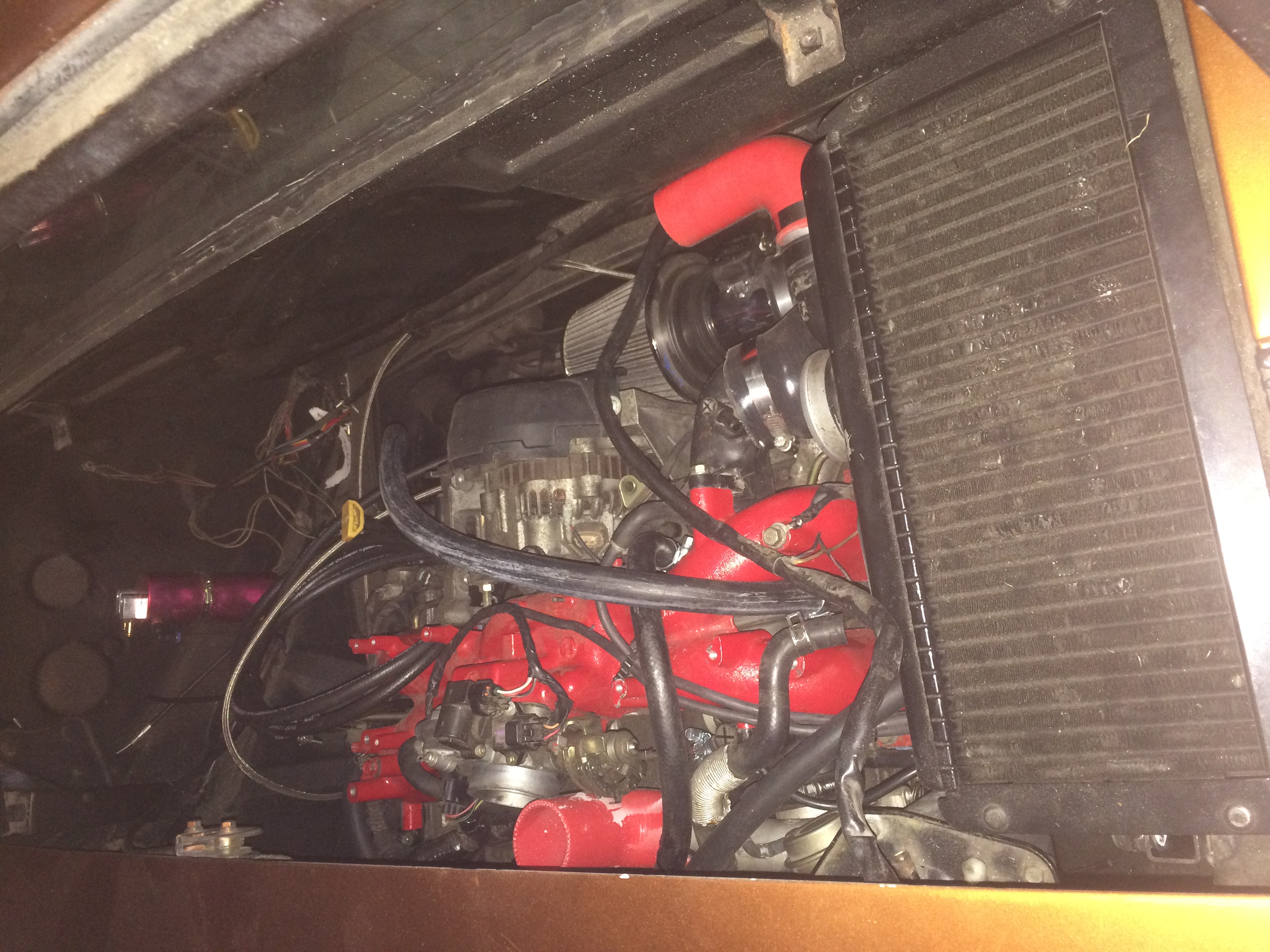

It has been a while and i have been busy. I now have installed the engine (IMG:style_emoticons/default/piratenanner.gif) and i am now working on hooking everything up. Ive got some bad pics of the engine in the engine bay, but as a word of advice for all of those doing turbo engines: If you are using the stock intercooler put it on the passenger side, it makes packaging WAY easier.
