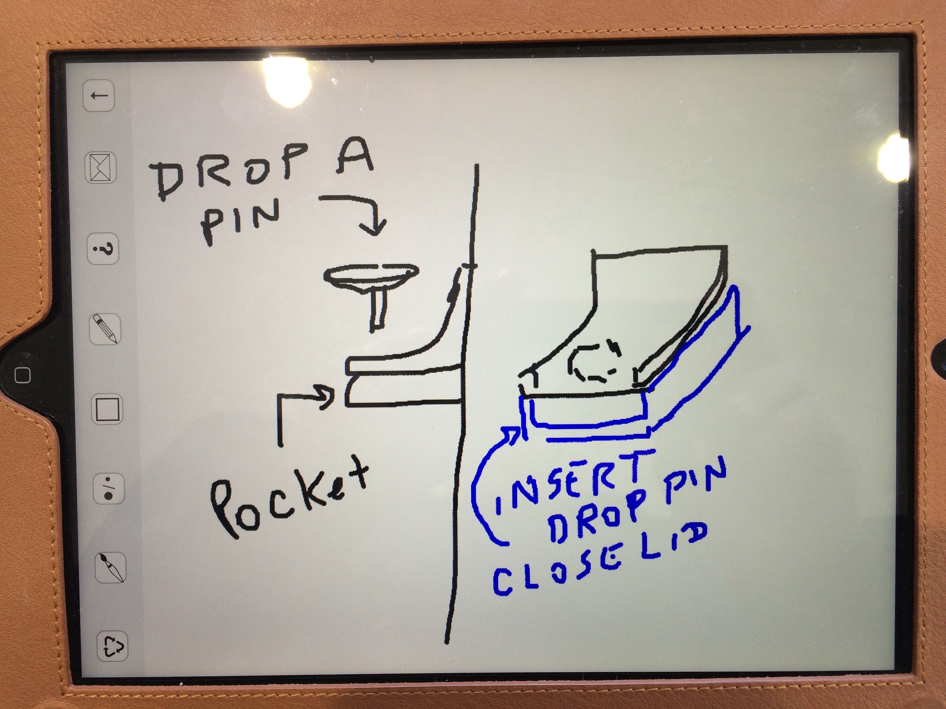

Ok. This started as a quick remove engine lid thread and I'd like to have something work but simple. Here's my free idea gift to you.
A simple pocket attached to and below the firewall mount. Slide in the lid hinge, drop in a pin, close the lid. Pull the pin, slide the lid out and off.
You make the pocket, add the pin, and sell the kit.
It could attach to the firewall with jb weld, pop rivets, or some easy way to install the pocket.
