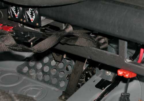

already got the plug in the car.
have matching plugs on my garage charger and jump pack already too.
so maybe Ill install a plug in the truck and be done with it.
