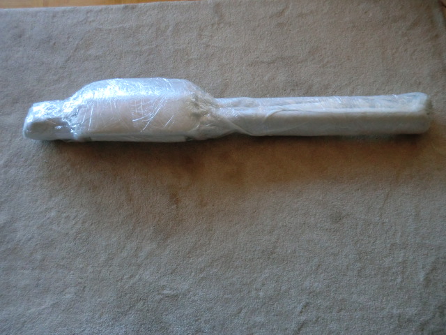

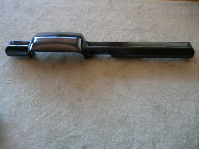

Received my dash safely today. It only took 7 days form the day it was shipped.
Dov was a pleasure to work with and could not have been more professional. Attached Image Attached Image

QUOTE(Sedonut @ Feb 11 2016, 09:44 AM) *
Perty - be sure to post another once its installed.

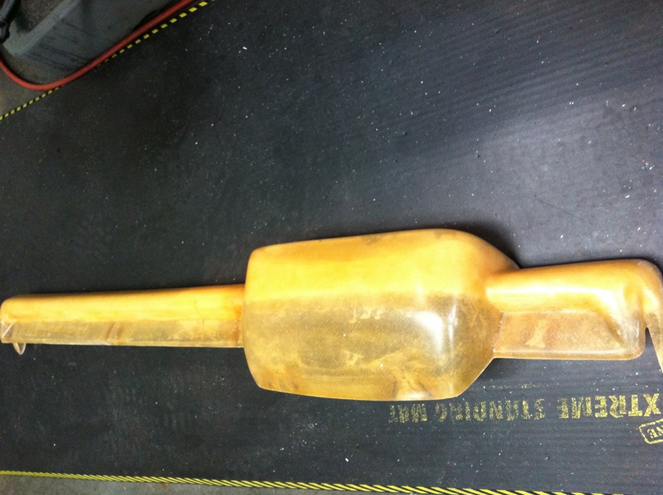

What do you do for UV resistance? Most epoxies yellow pretty quickly when exposed to the sun.

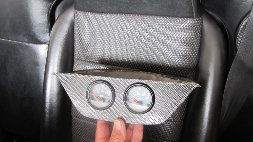

Attached Image While laying up a carbon part I noticed that the twill fabric resembled the 914 upholstery. I needed a couple more gauges so I made this to hang below the dash.

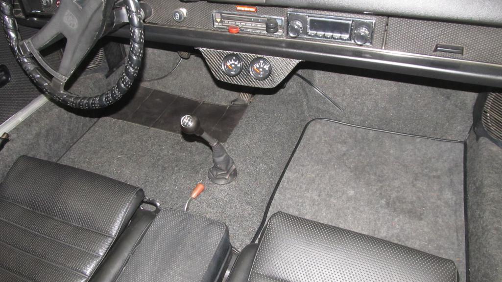

Member No.: 17,248
Installed under dashAttached Image

QUOTE(fiberglass1inc @ Feb 12 2016, 12:56 AM) *
The dash was treated with 3 coats of automotive-grade UV-stable clear coat lacquer. Nevertheless we always recommend to avoid any overexposure to sunlight and to use a windshield cover when the car is parked outside. These common sense steps will prevent the dash from turning yellow overtime just like they will help prevent cracking and discoloration on any vinyl or leather trimmed dash.
