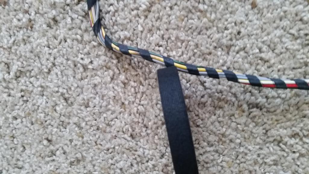

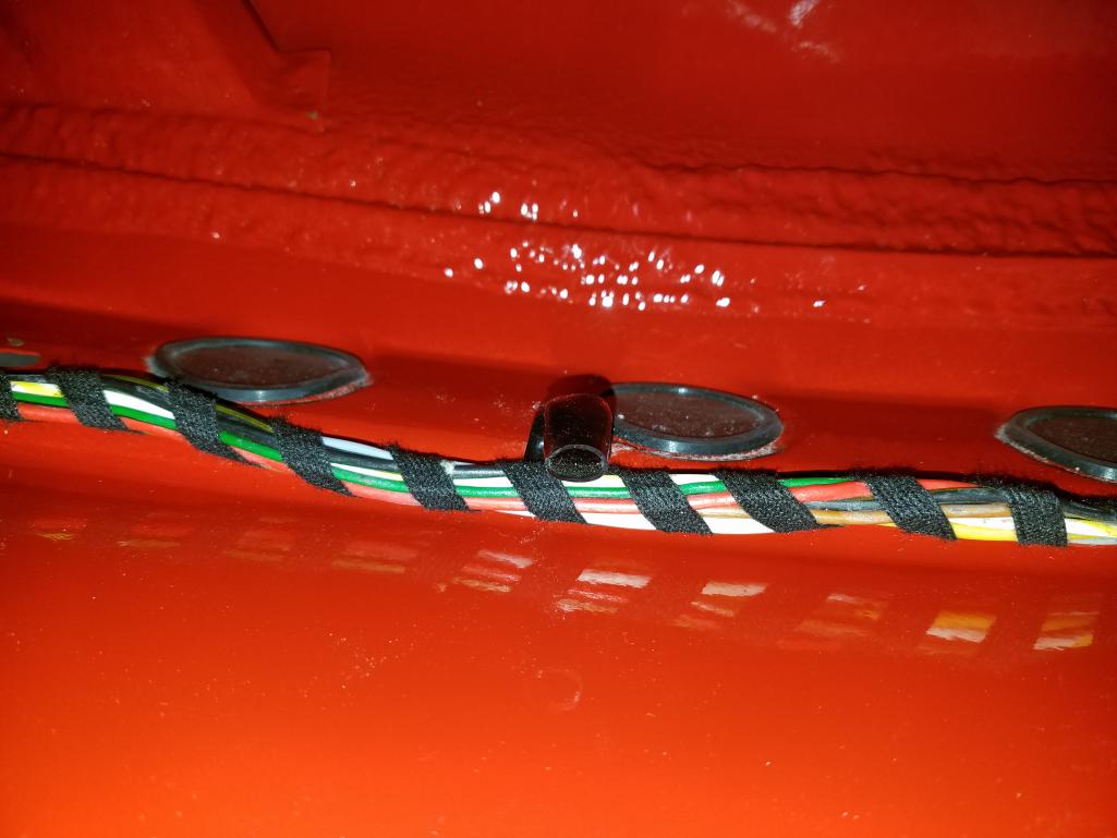

I had wrapped it with the wrong width and then I undid it and rewrapped it yesterday with the correct width. Also put in our new material for covering the metal tabs on the wiring harness connection to the body. Yes these do need to get listed on the website but I'm working on the car today

You can see how much wider the typical 15mm tape like Tesa is.
The harness the Tesa tape is next to is NOS 1971 914-4.
The correct width is about 8mm as far as width goes.
Your tape width looks "spot on" Matty.
