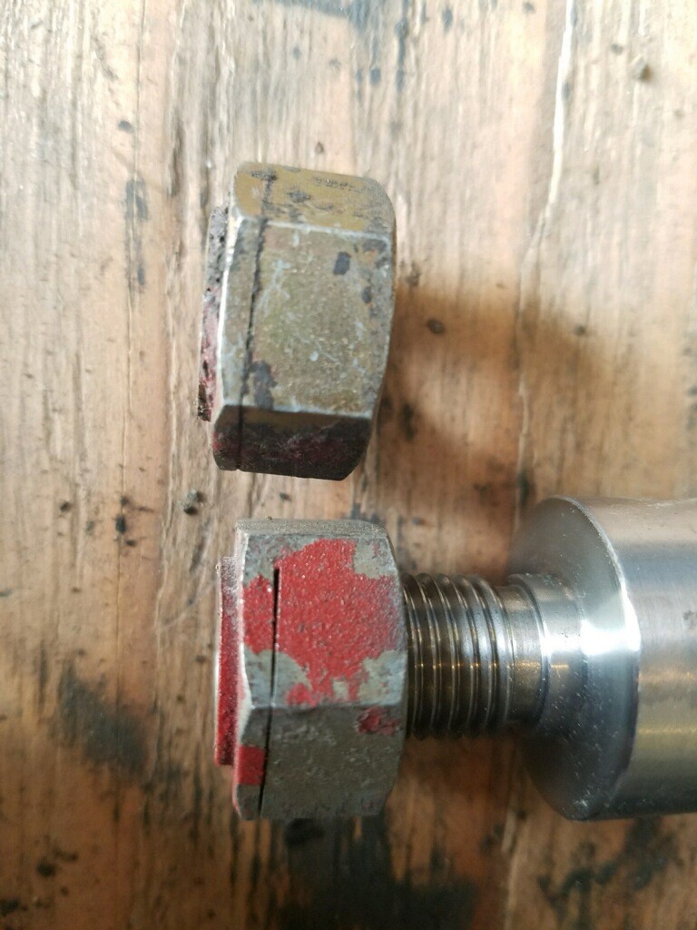

One of these is a new 914Rubber part comming soon

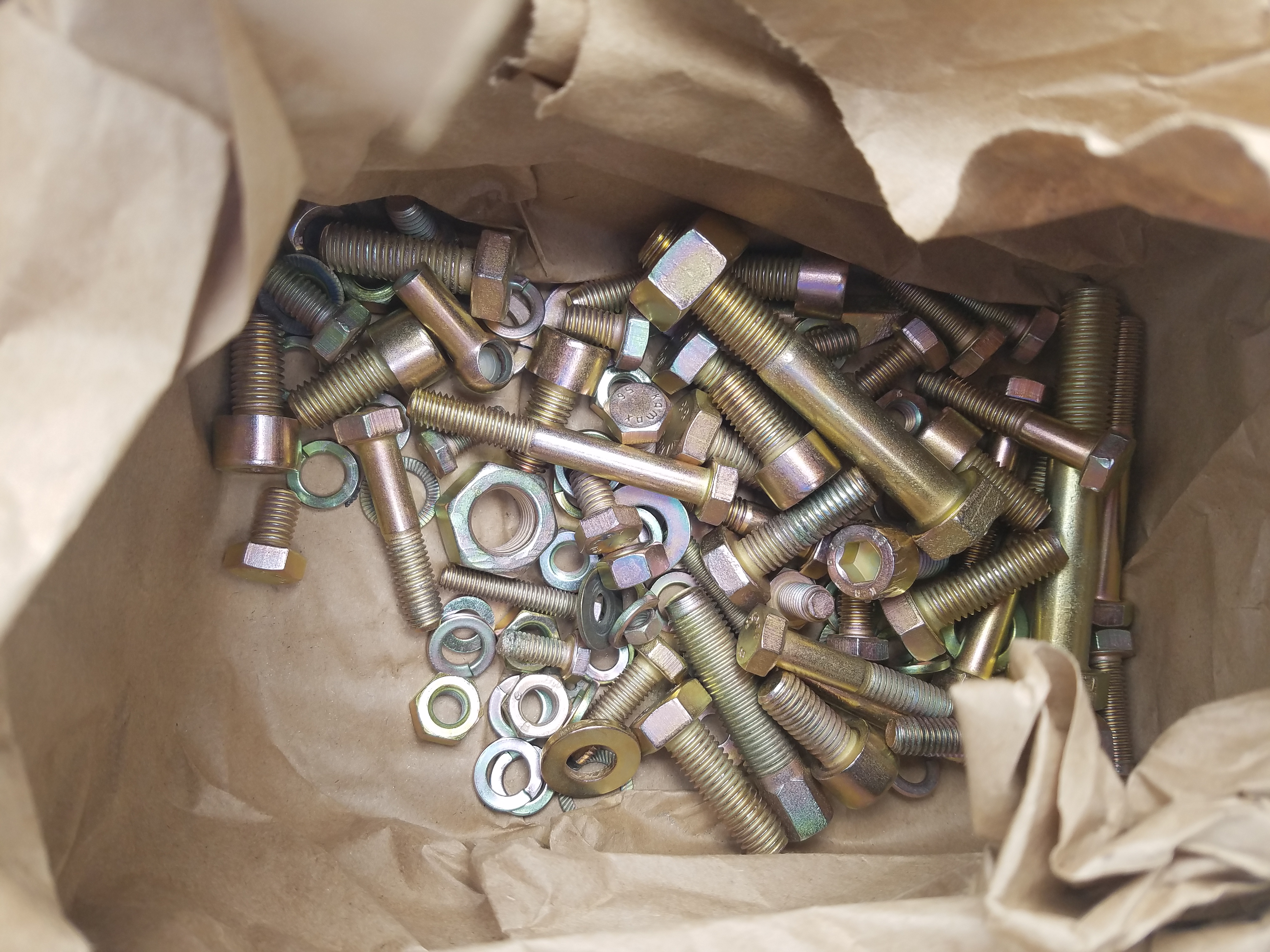

A few schnoor washers got in to the batch that got replated. These will be thrown out and replaced with new ones. They are one time use.

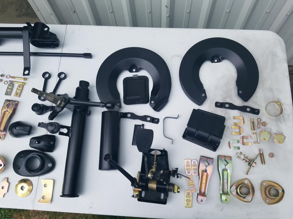

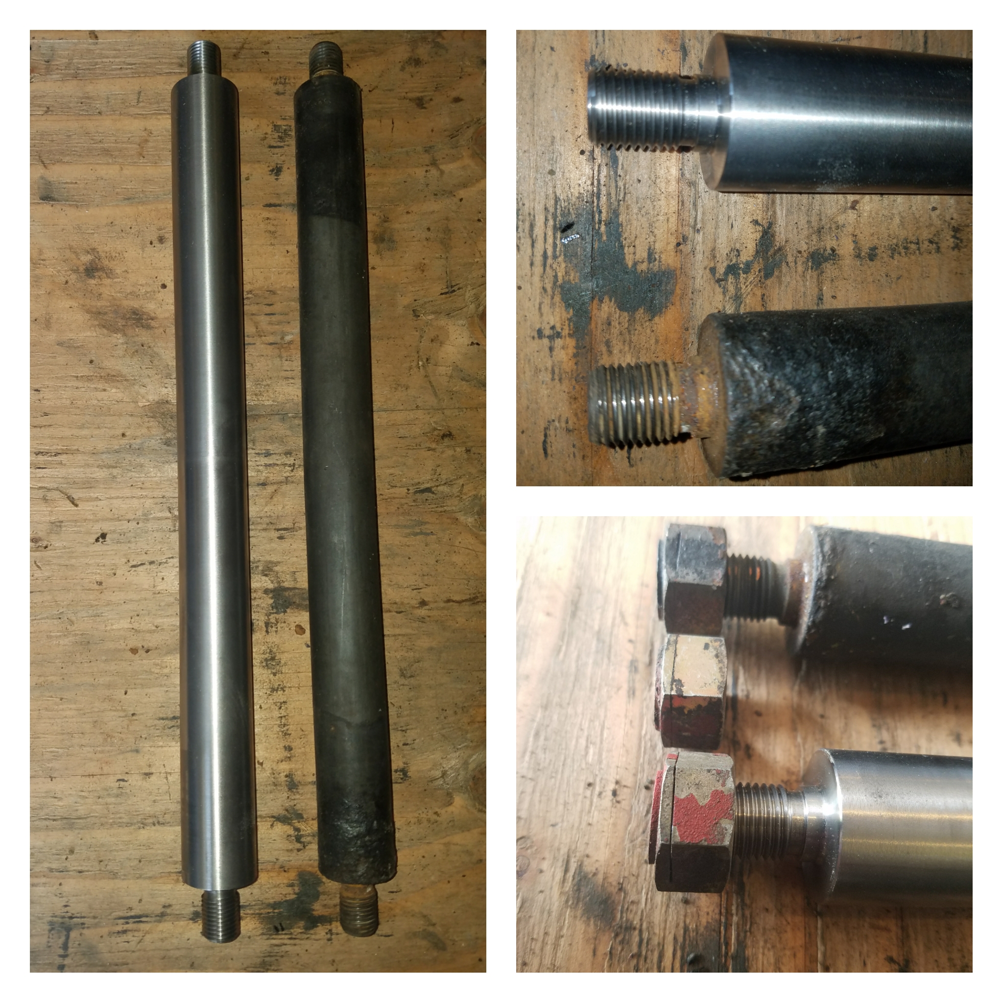

Old part vs new part. 914Rubber percision Stainless Steel pivot shafts (IMG:style_emoticons/default/shades.gif)

Thank you Bruce Stone, very nice work

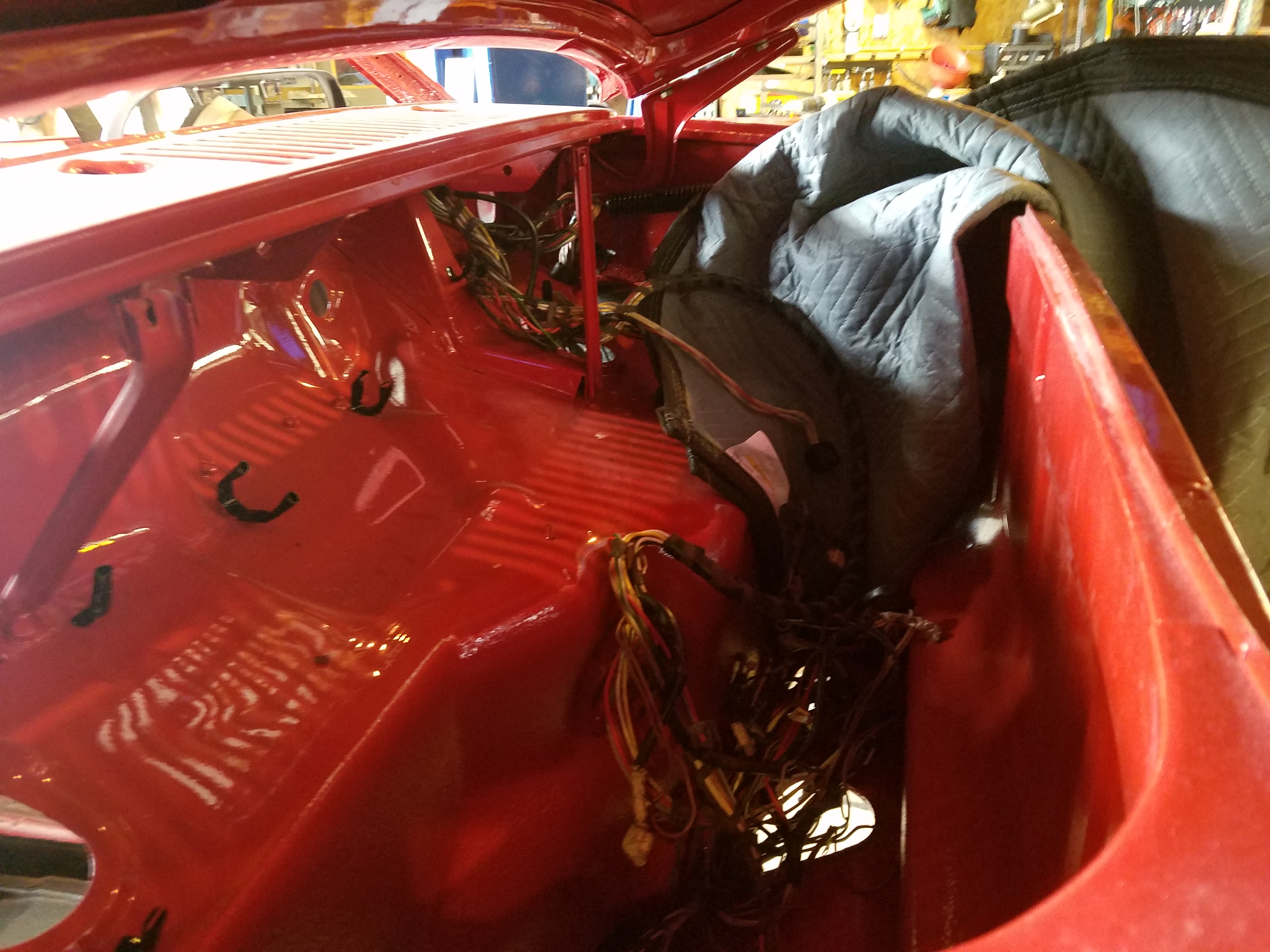

Ran the wiring harness back into the front trunk.

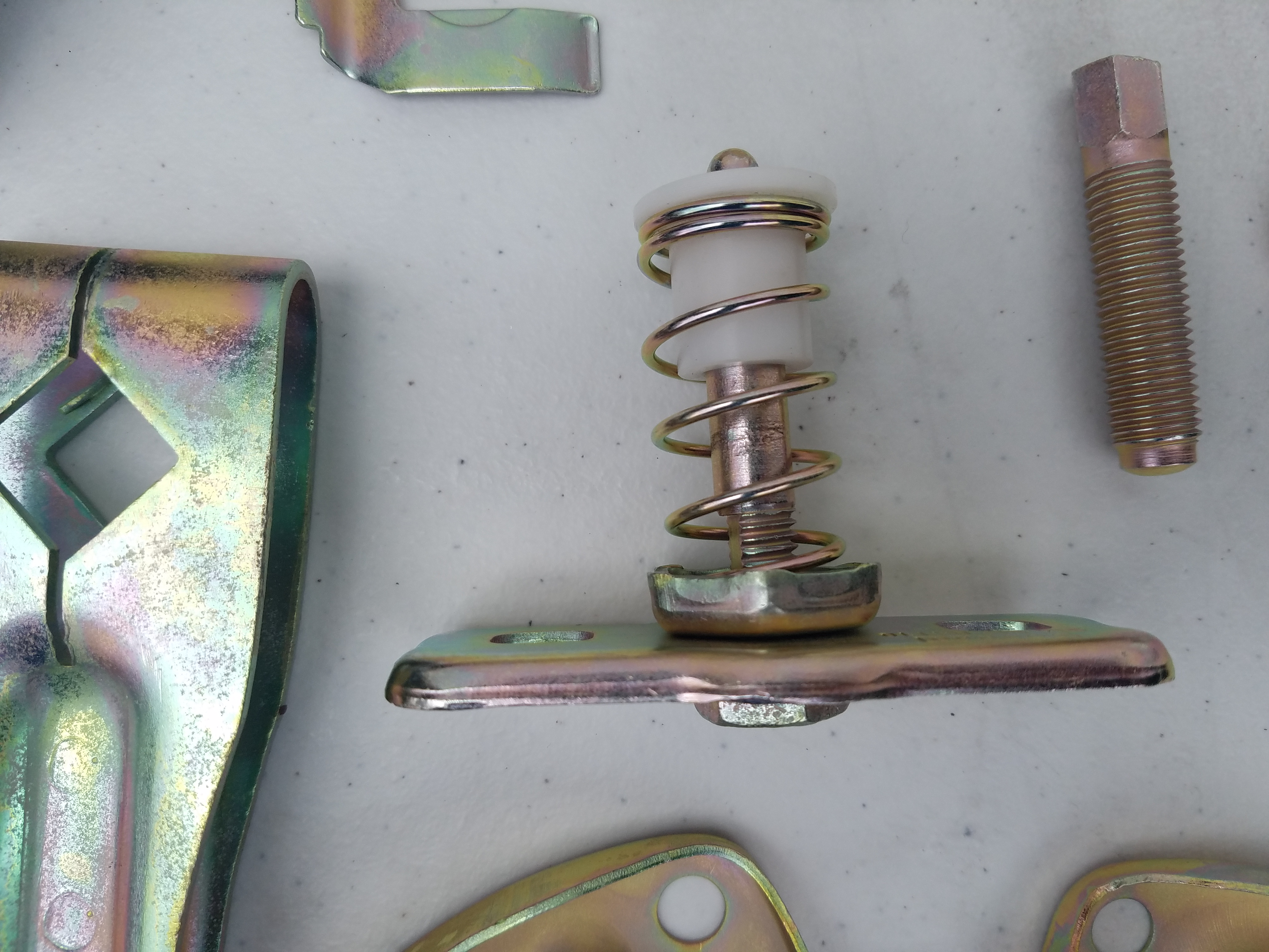

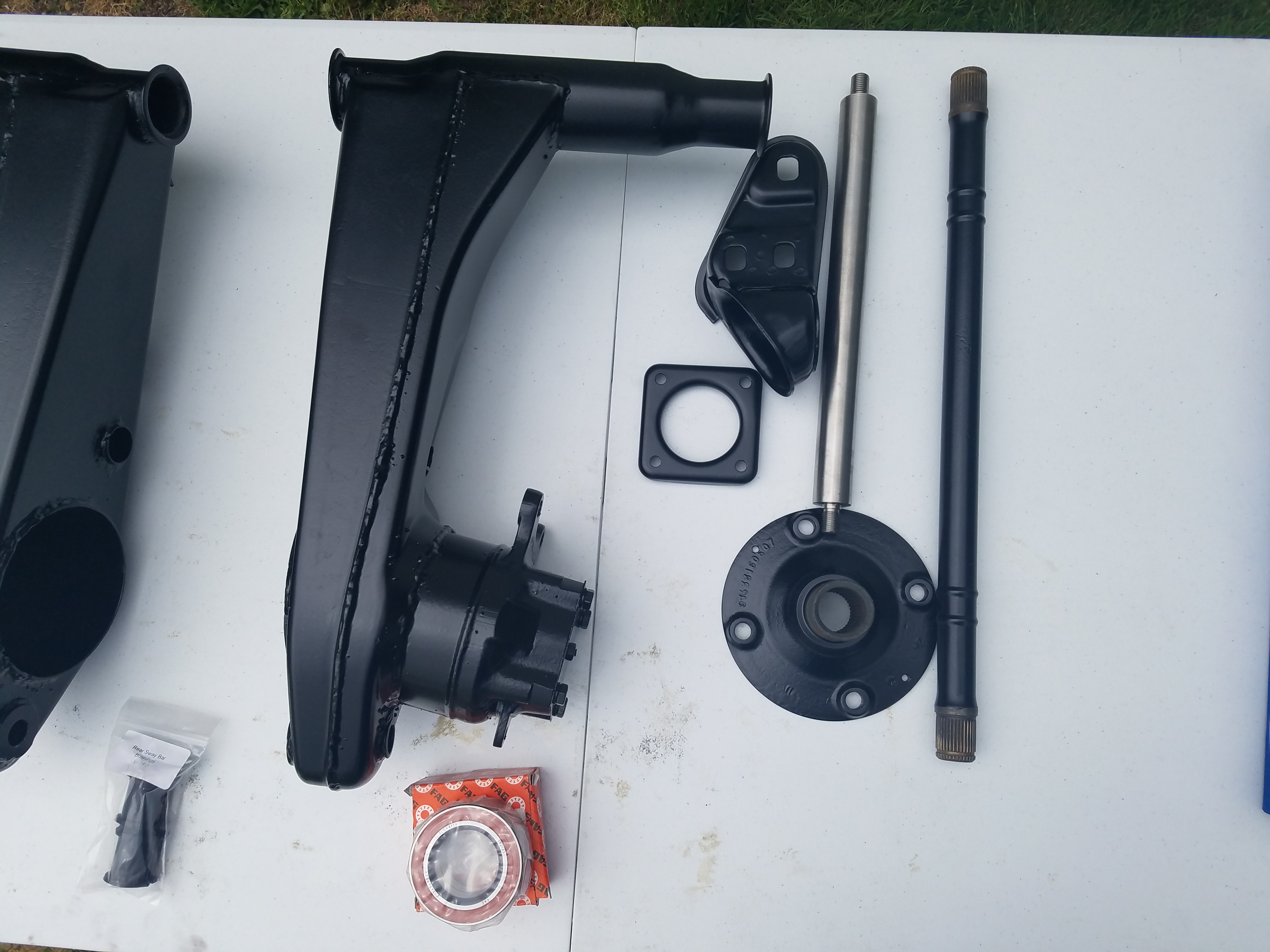

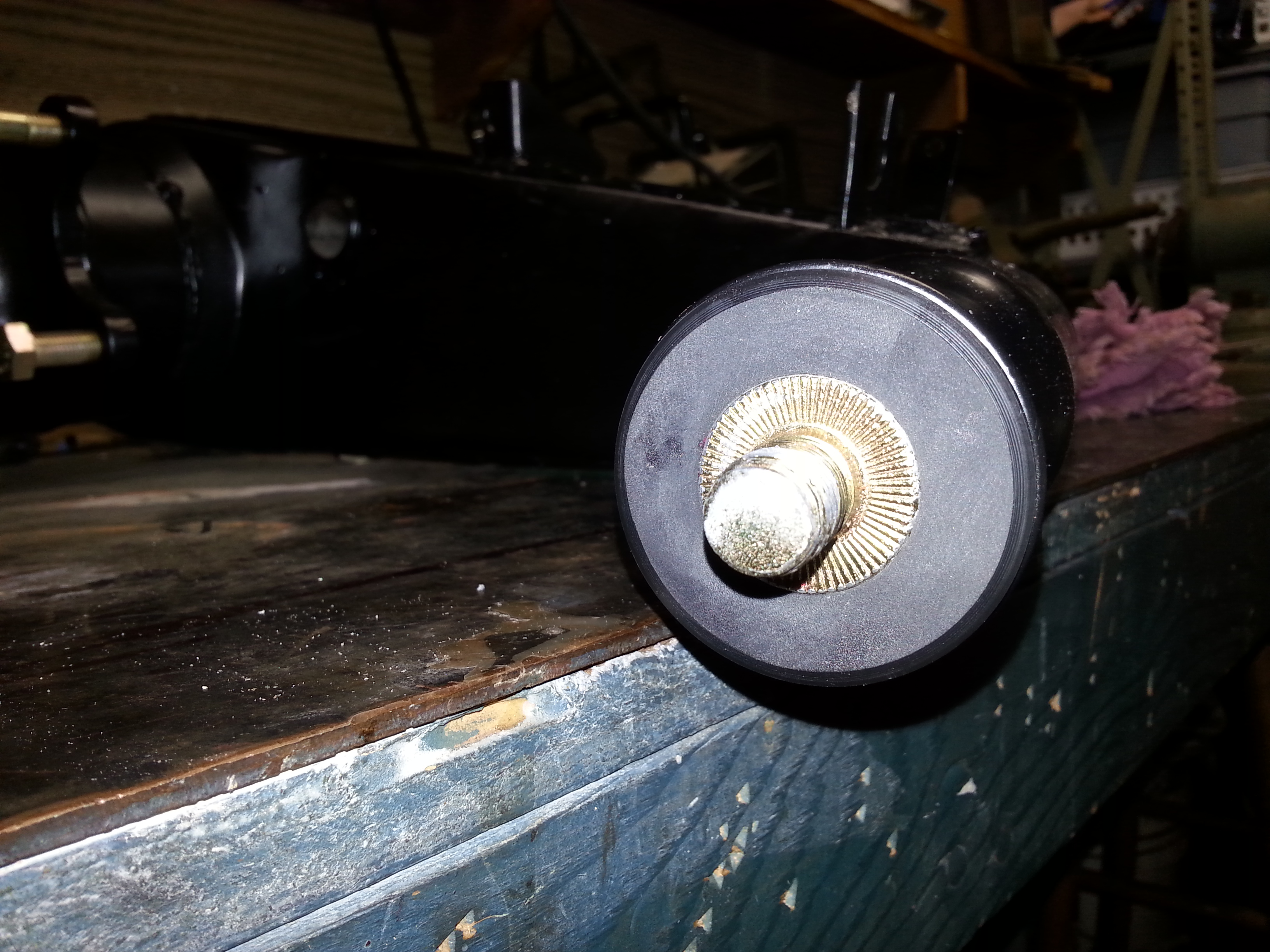

QUOTE(Matty900 @ Jun 9 2017, 12:12 AM) *
Do the new pivot shafts have a correct diameter shoulder and serrations on the ends ?
Mikey914
post Jun 9 2017, 12:07 PM
Post #134
The rubber man
Posts: 12,785
Joined: 27-December 04
From: Hillsboro, OR
Member No.: 3,348
You mean the nut?
rgalla9146
post Jun 9 2017, 12:26 PM
Post #135
Posts: 4,999
Joined: 23-November 05
From: Paramus NJ
Member No.: 5,176
No, not the nut.
The picture answers the question.
The original shafts have a collar or shoulder that is a perfect fit into the inner
chassis ear and the outside alignment bracket. It acts to locate the shaft with no play.
The shoulder is visible, is it a tight fit into the chassis features ?
The shafts also have serrations that (when tight) prevent rotation of the shafts with suspension movement.
Both features are important. The mating surface in the photo is smooth.

What you can't see yet is what we are doing with the rubber.
These are in testing right now.

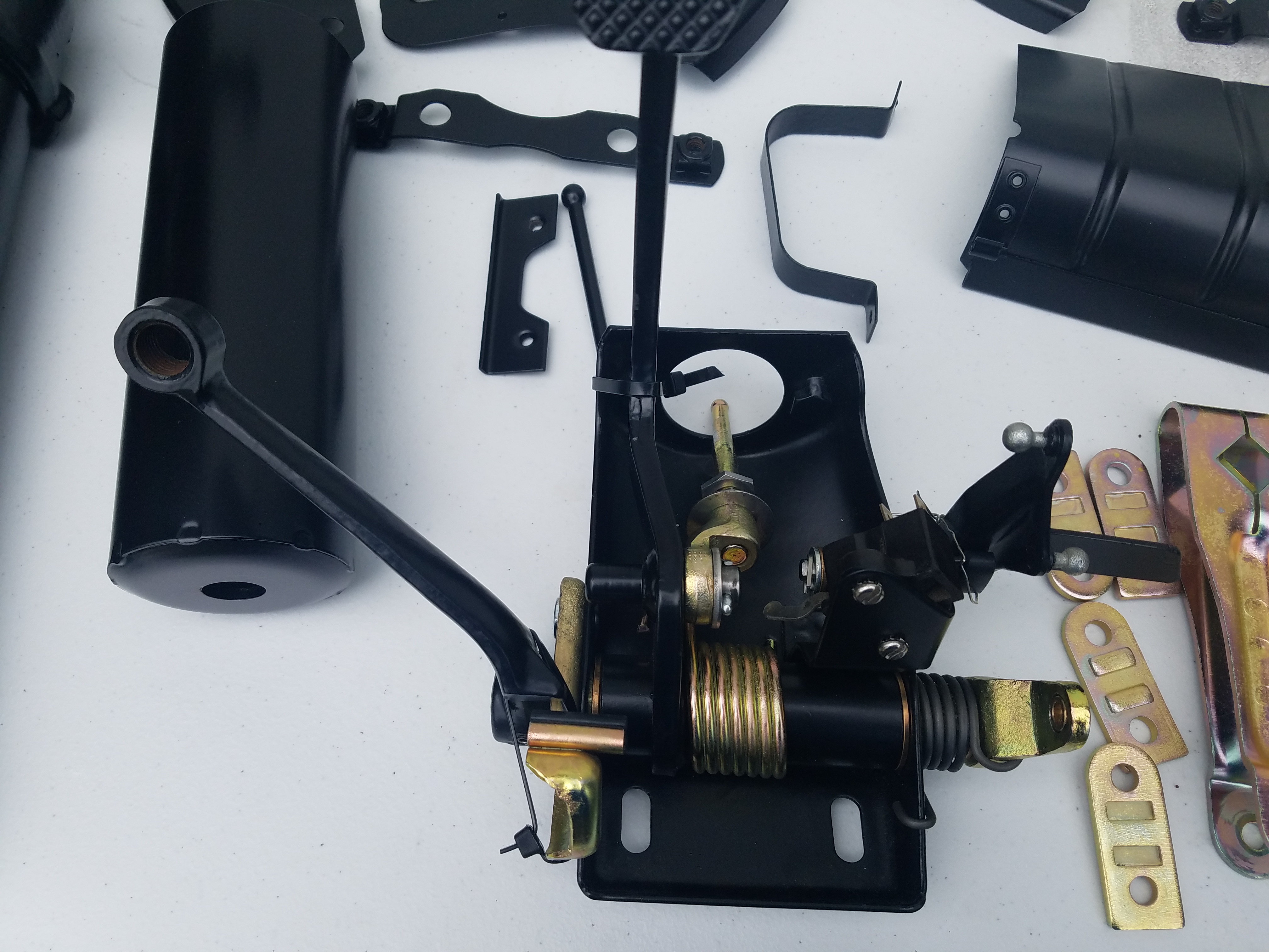

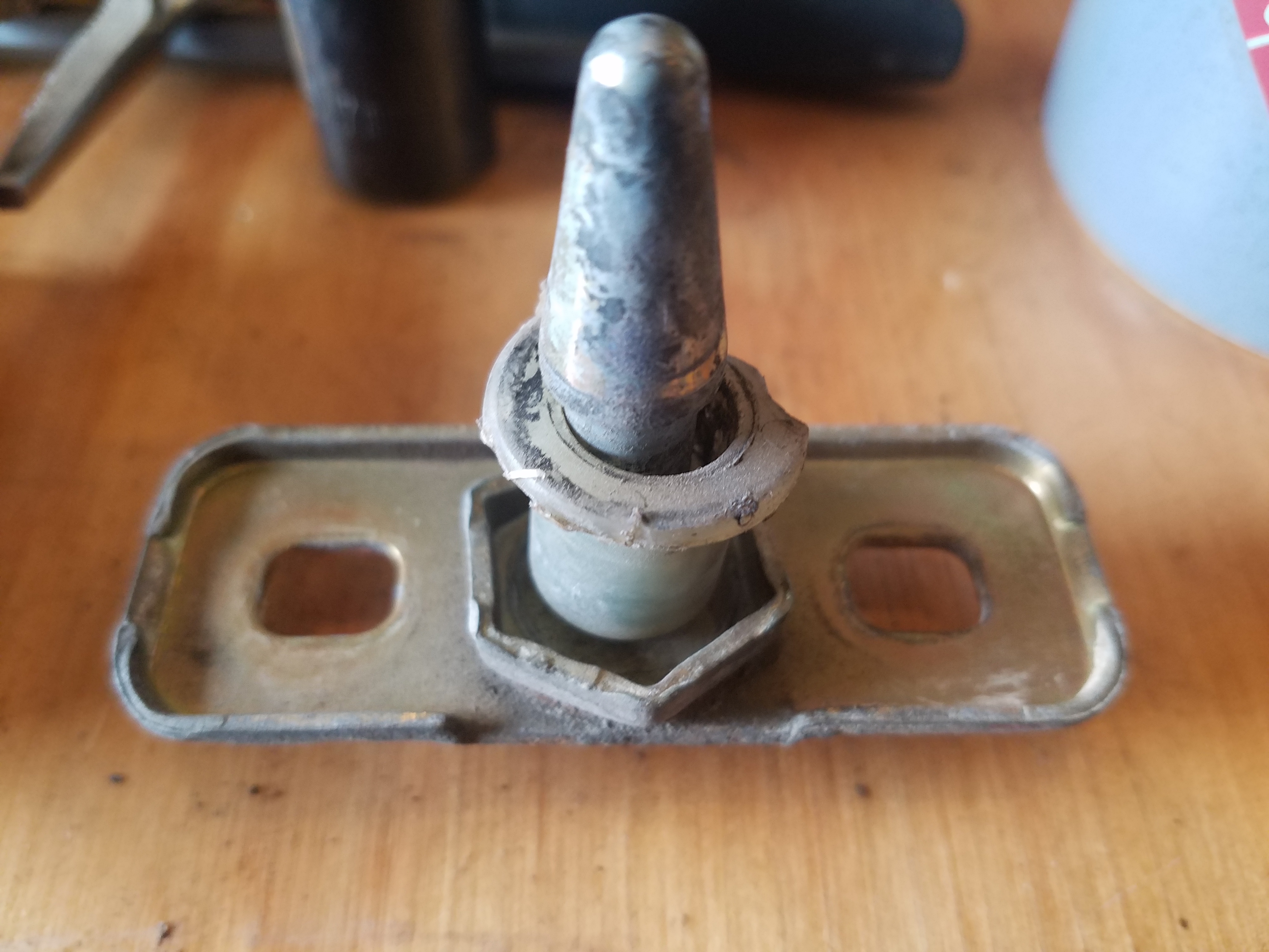

Matt, Your upper rear latch trunk assembly needs to have the plate flipped around.
Craig at CAMP
Matty900
post Jun 9 2017, 11:13 PM
Post #139
Posts: 1,337
Joined: 21-February 15
From: Oregon
Member No.: 18,454
QUOTE(boxstr @ Jun 9 2017, 08:12 PM) *
Craig at CAMP
Thank you, Craig. I got excited with the pretty, shiny parts and did not look at my photos. This really shows why you need the new bushing.

QUOTE(rgalla9146 @ Jun 9 2017, 11:26 AM) *
No, not the nut.
This is a great thread....and nice work.
The shaft ends should look like this though:
