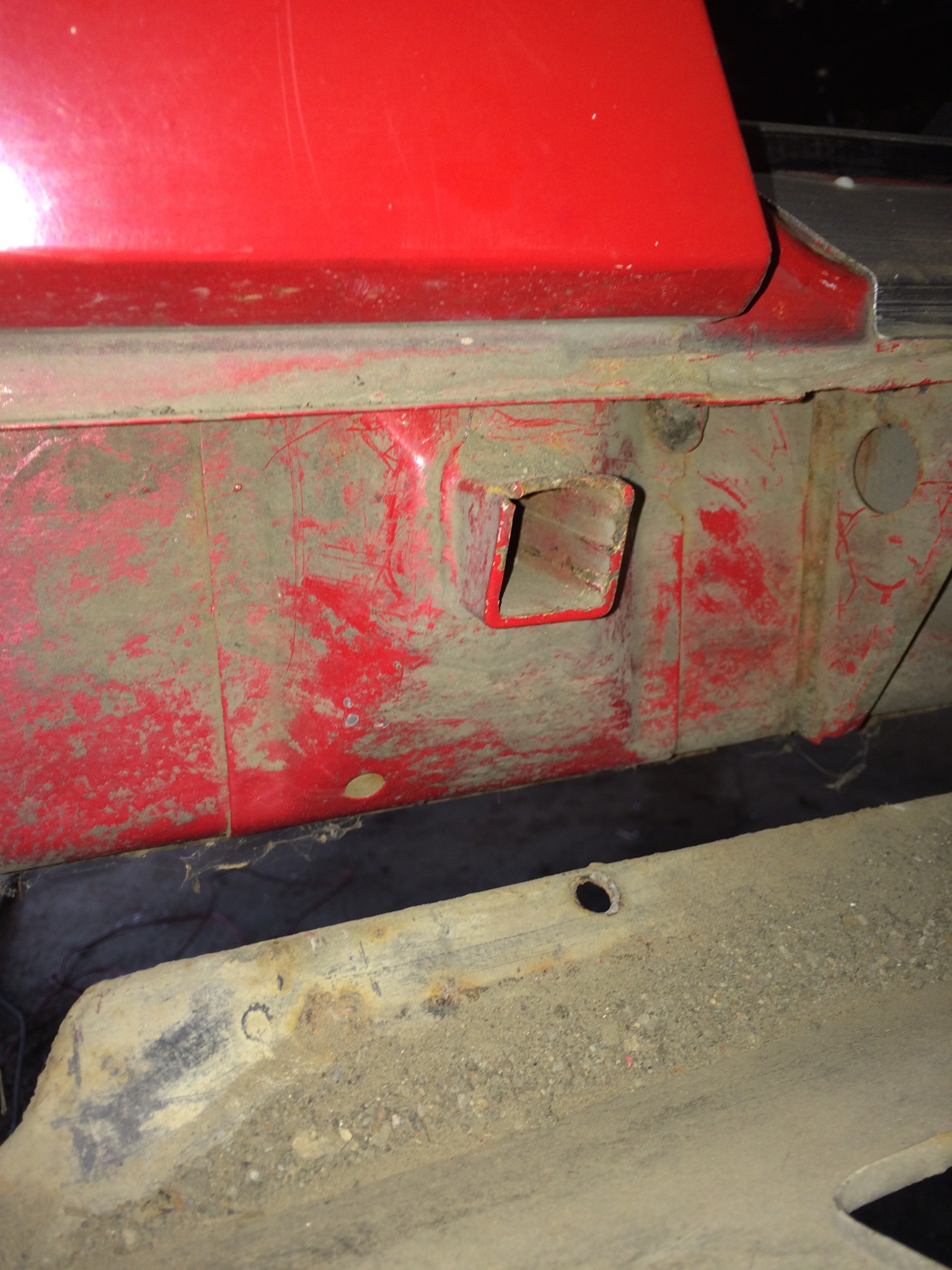

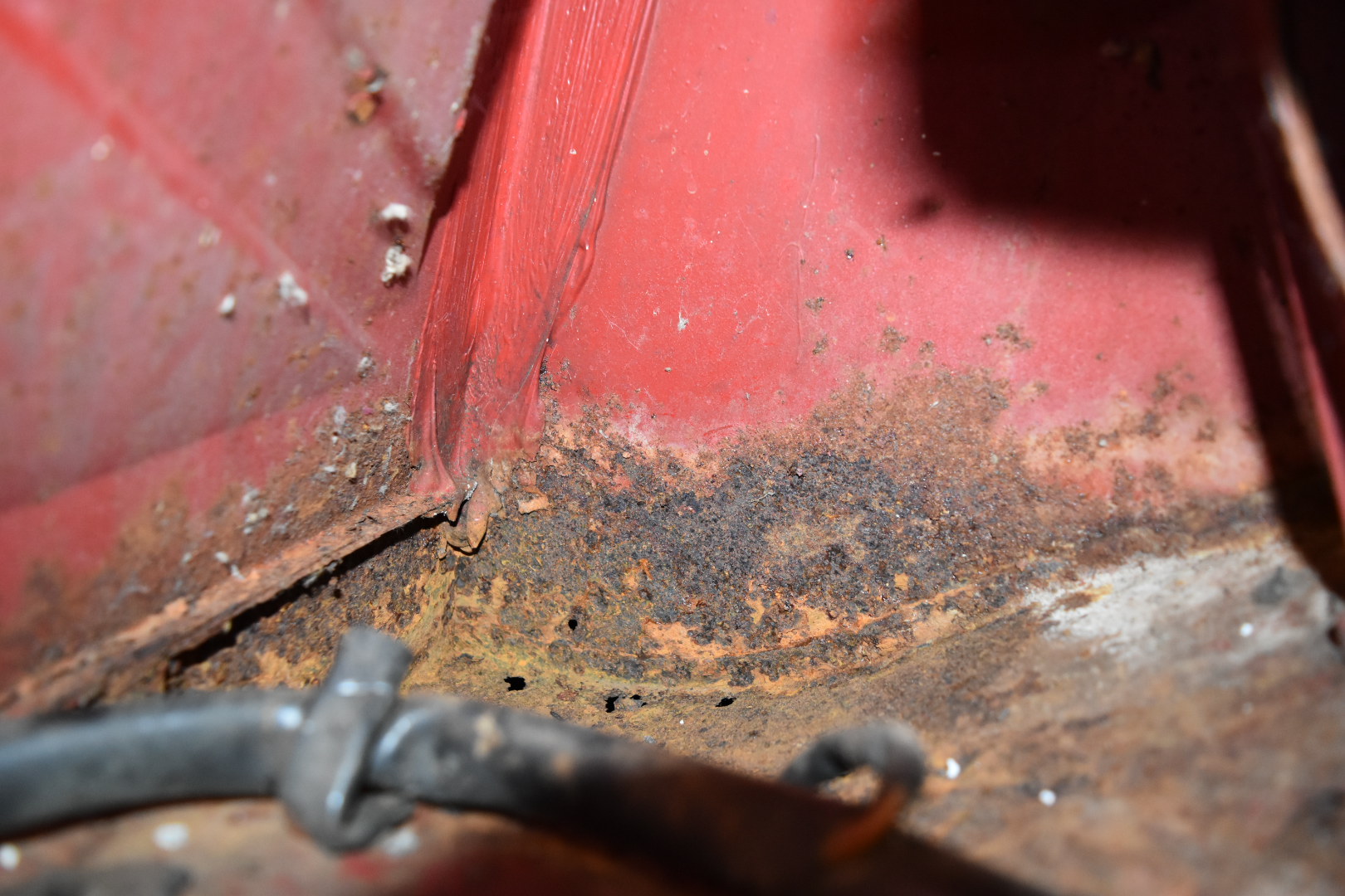

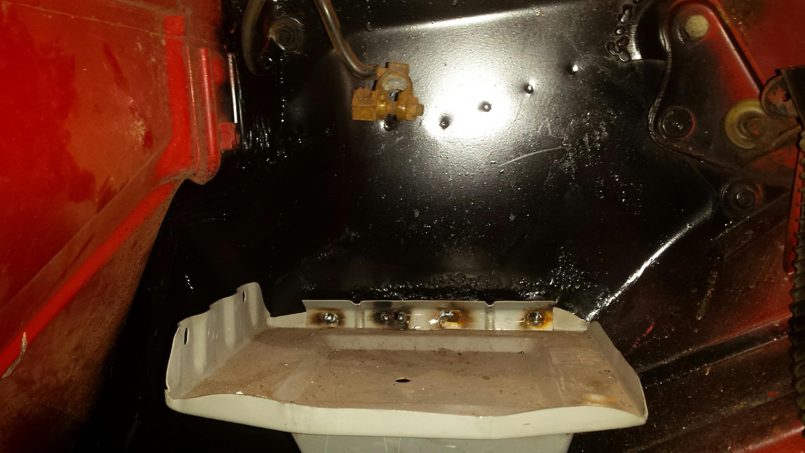

I was able to get a better look at the car today. It really is pretty solid. I did get some better pictures of it and in looking at the hell hole, I can see that the rust has go all the way through the metal in some pin holes.

I am not sure what rust issues I may have inside the longs.hopefully it is not too bad under the rocker pannels

Took off the rocker pannels and there was lots of dirt. (Thankfully very dry dirt) the rest looks great

What is the best way to take care of this level of rust in the hell hole? Who do you prefer to get the metal from, or do you just make your own patch for this?

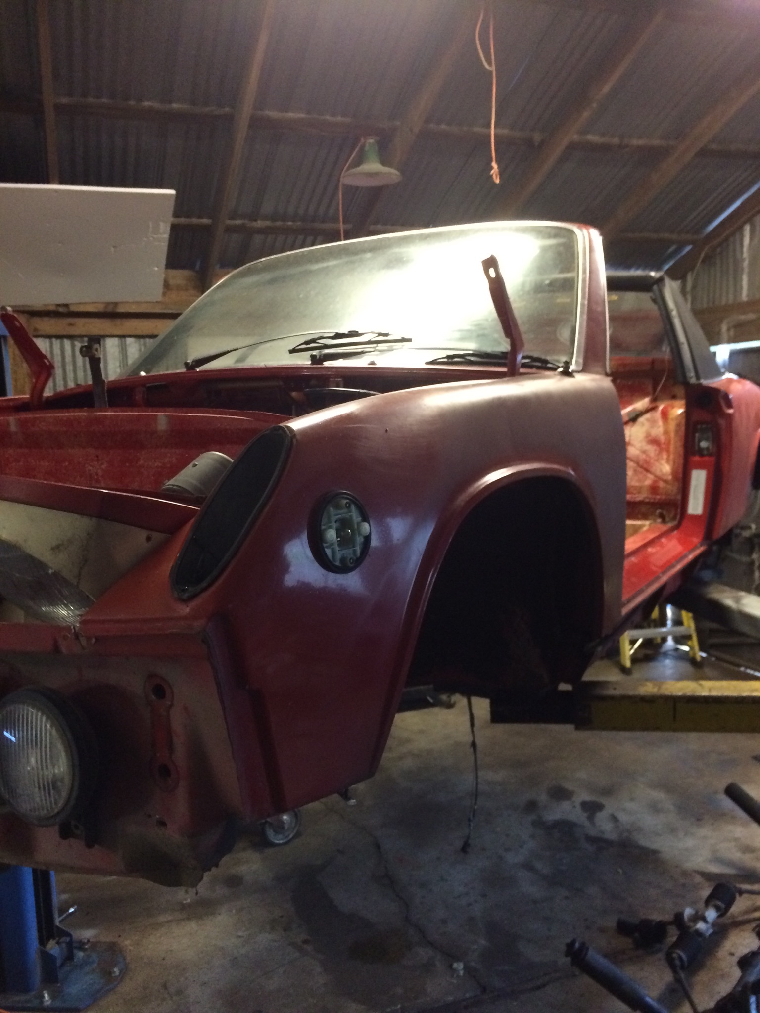

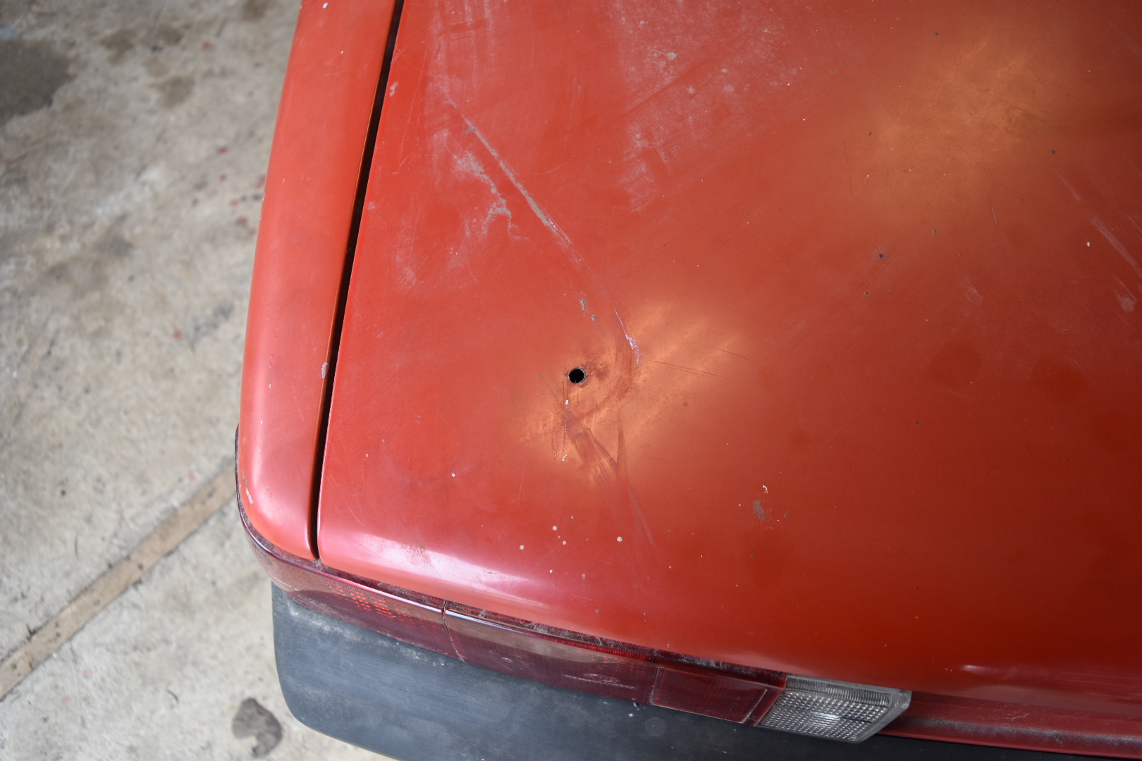

Decided to go ahead and fix the damaged fender and minor dings aroundthe body and paint the car. So I guess this is project thread now.
Matty900
post Feb 18 2016, 01:01 AM
Post #49
Posts: 1,337
Joined: 21-February 15
From: Oregon
Member No.: 18,454
Everything is coming apart nicely.

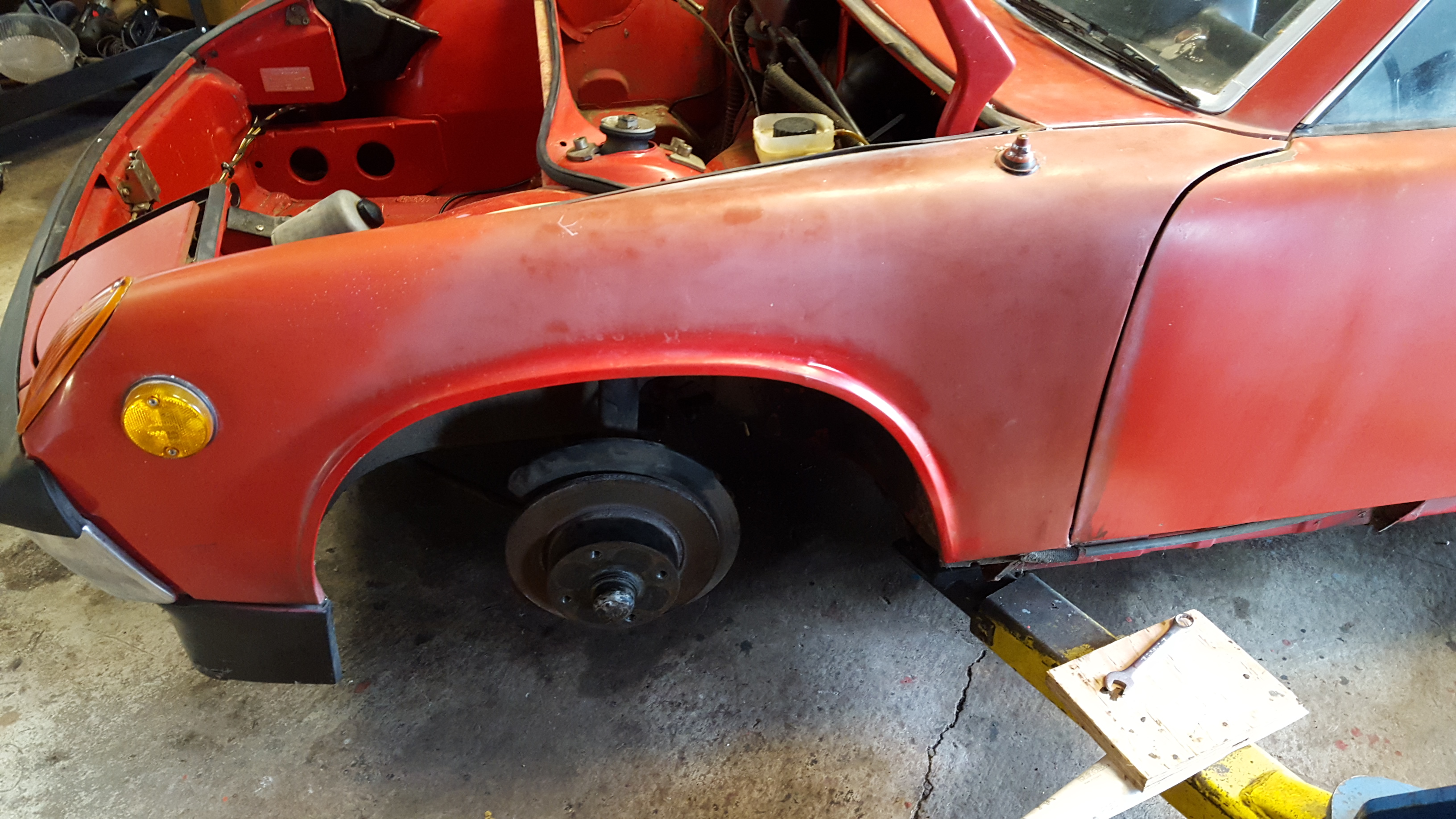

Matty900
post Feb 18 2016, 01:08 AM
Post #50
Posts: 1,337
From: Oregon
Member No.: 18,454
Getting ready to steam clean everything.

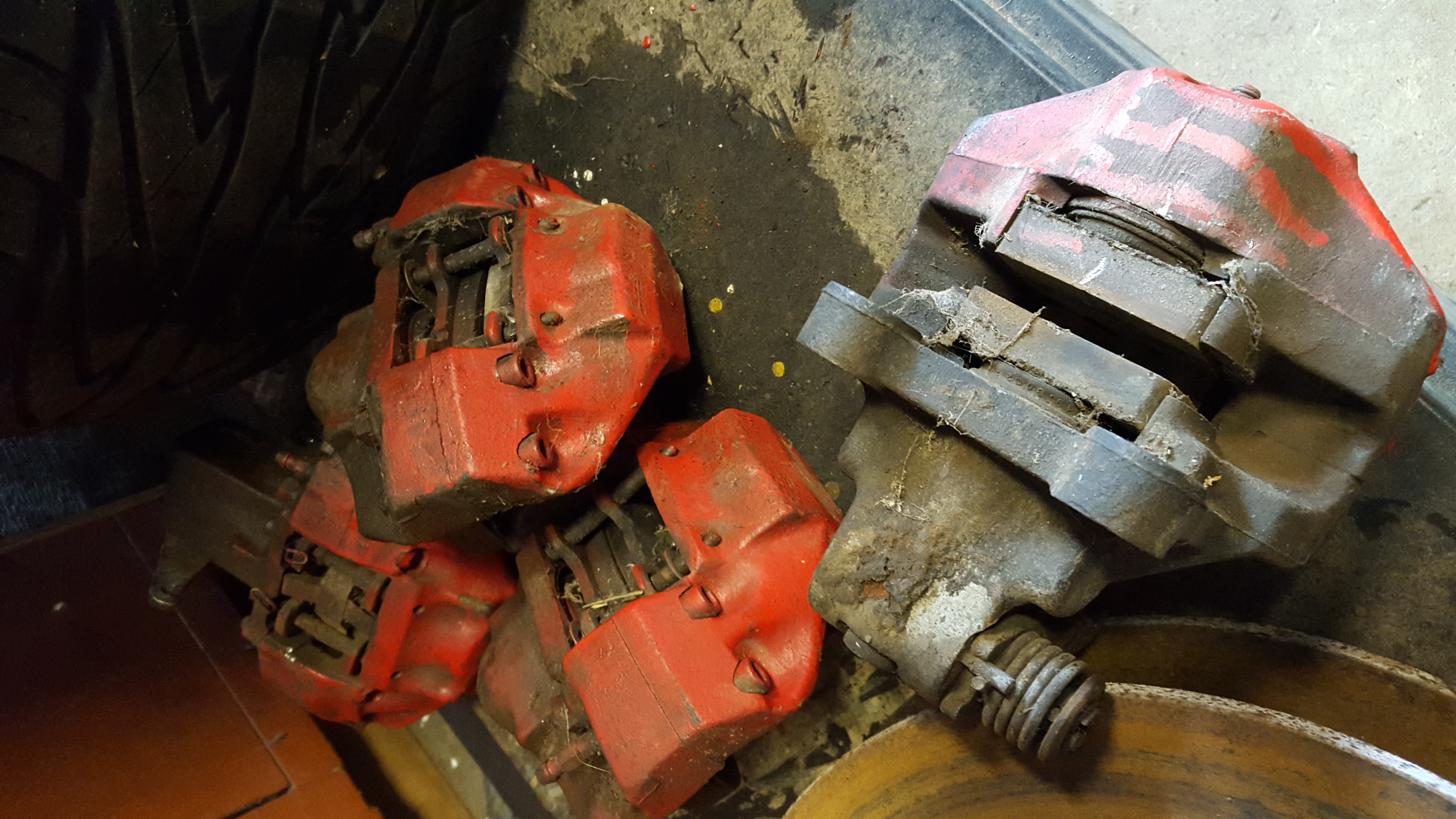

Very nice red breaks. I guess there was some leftover in the can after the fender. Sent these off to Eric at PMB. Will be replacing breaks, bearings and suspension all the way around.
Now I just need to find a factory front swaybar. Anyone have one they are willing to part with?

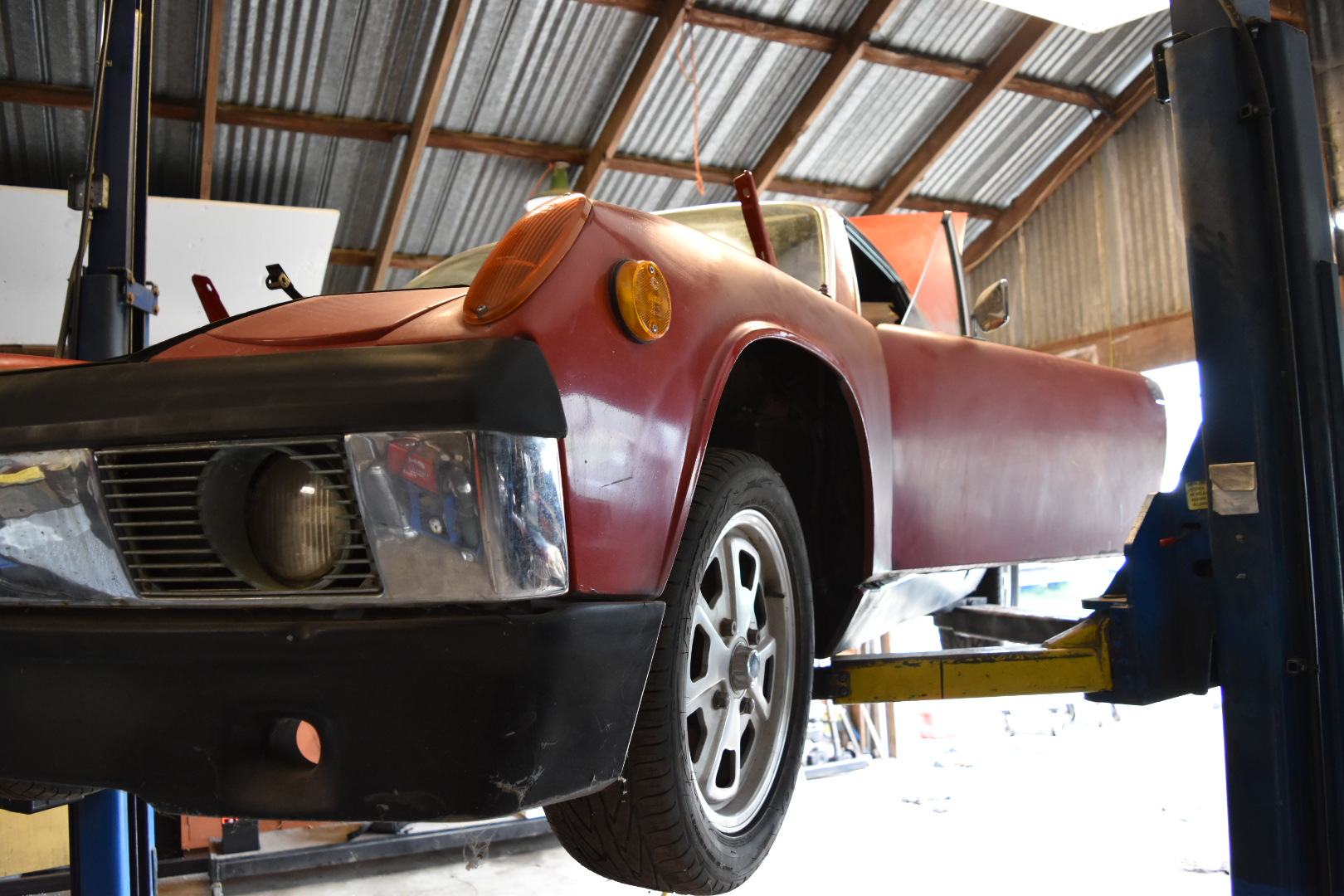

Steam cleaning today
Matty900
post Feb 18 2016, 10:47 PM
Post #53
Posts: 1,337
From: Oregon
Member No.: 18,454
Few more photos from today

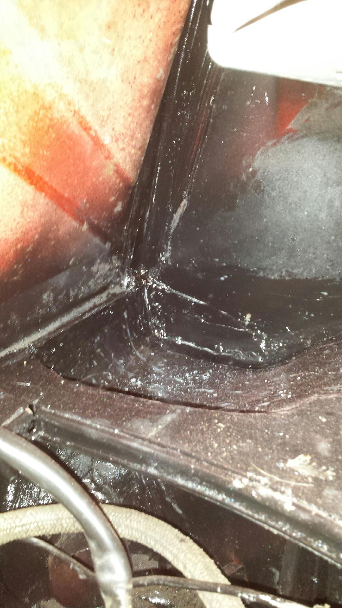

(IMG:style_emoticons/default/piratenanner.gif) Hell hole fixed!

Nice progress, looks like you have a mix of long and short wheel bolts. If you run the fuchs make sure to find a full set of long bolts.

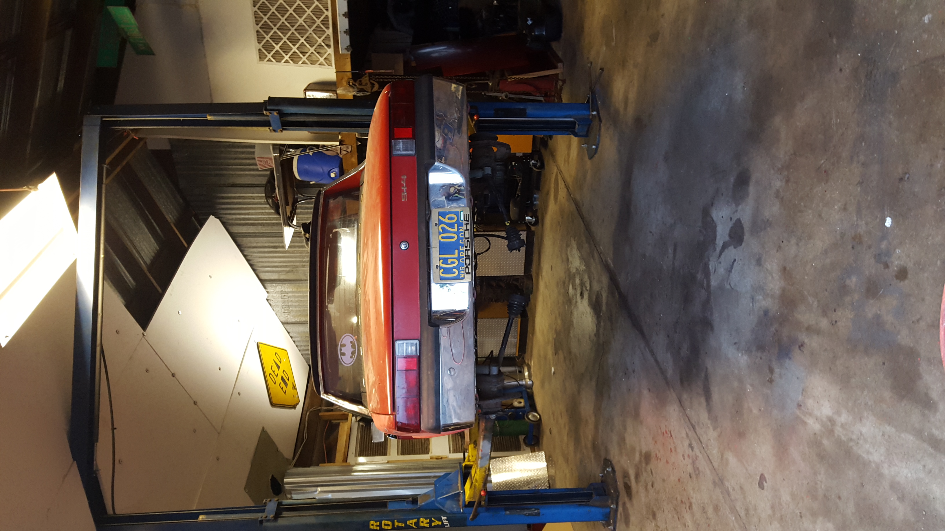

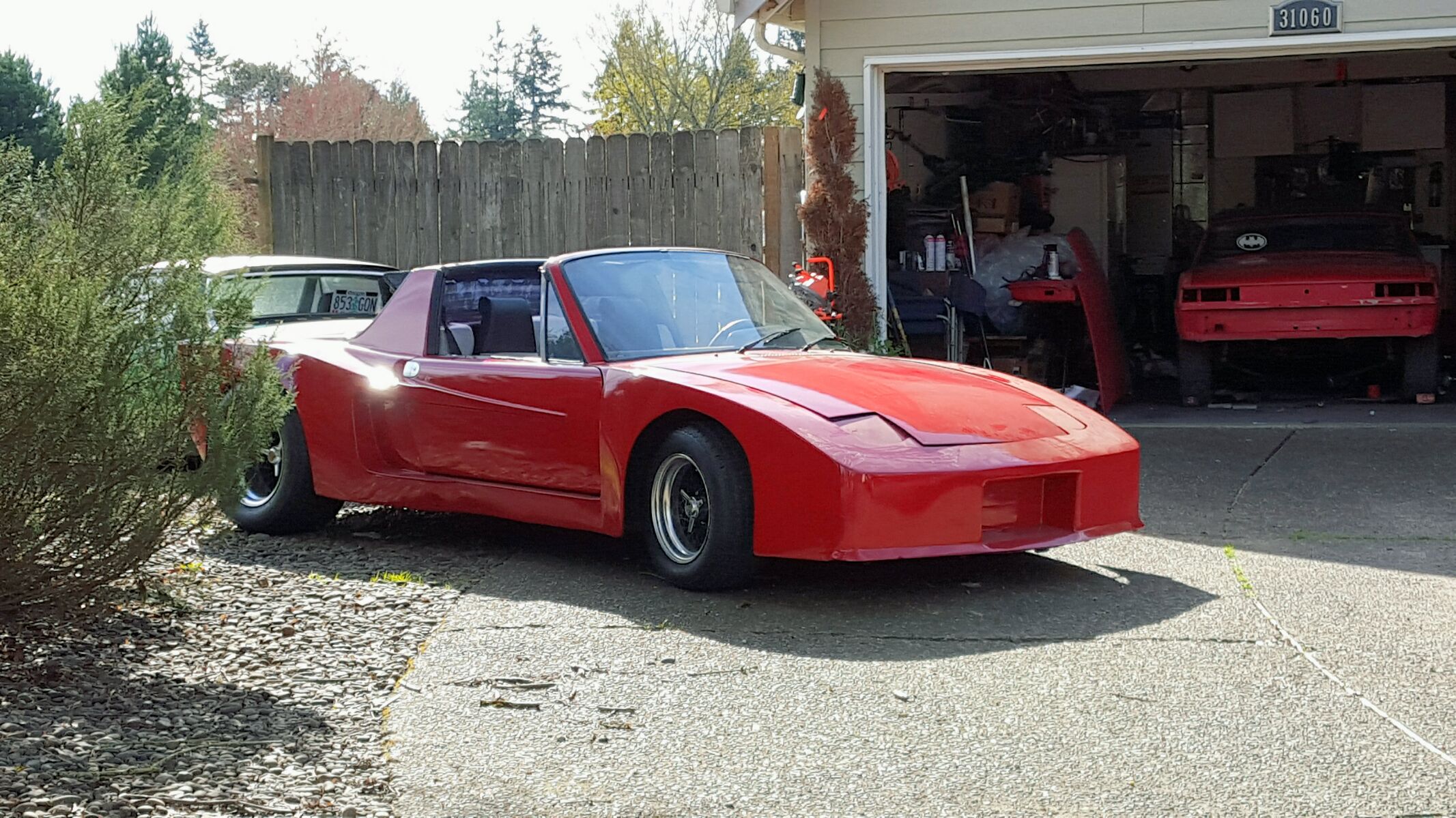

Coming and going. Got the 72 home to complete the body work and prep for paint. Lucas has been busy this week with with the DA sander, stud welder and dent puller.
Sent the wide body out to fix the wheel spacer issue and bent trailing arm. May be able to get both cars to West Coast Rally
