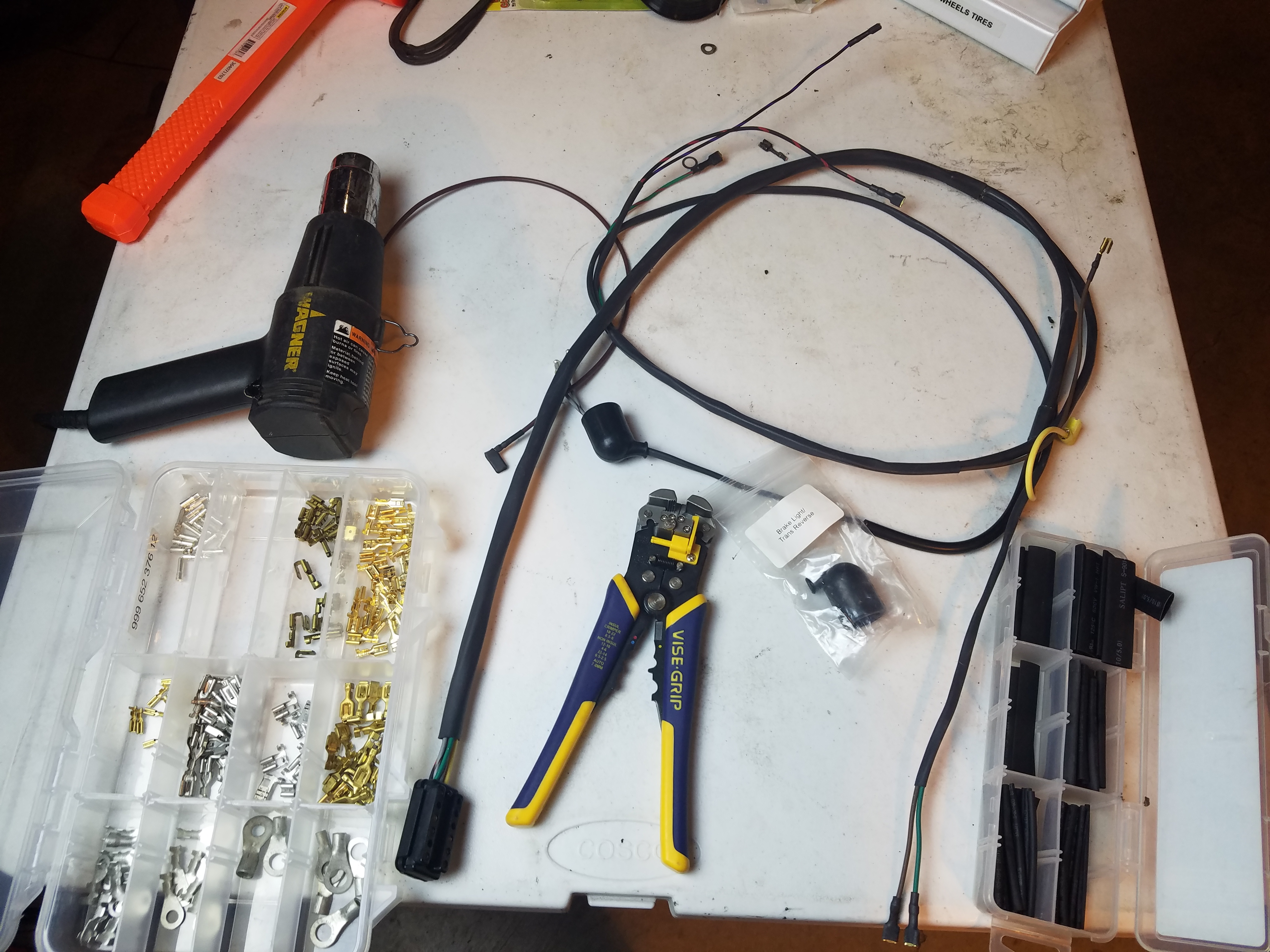

Got the wiring harness done and the jumper is installed for grounding the fuel pump

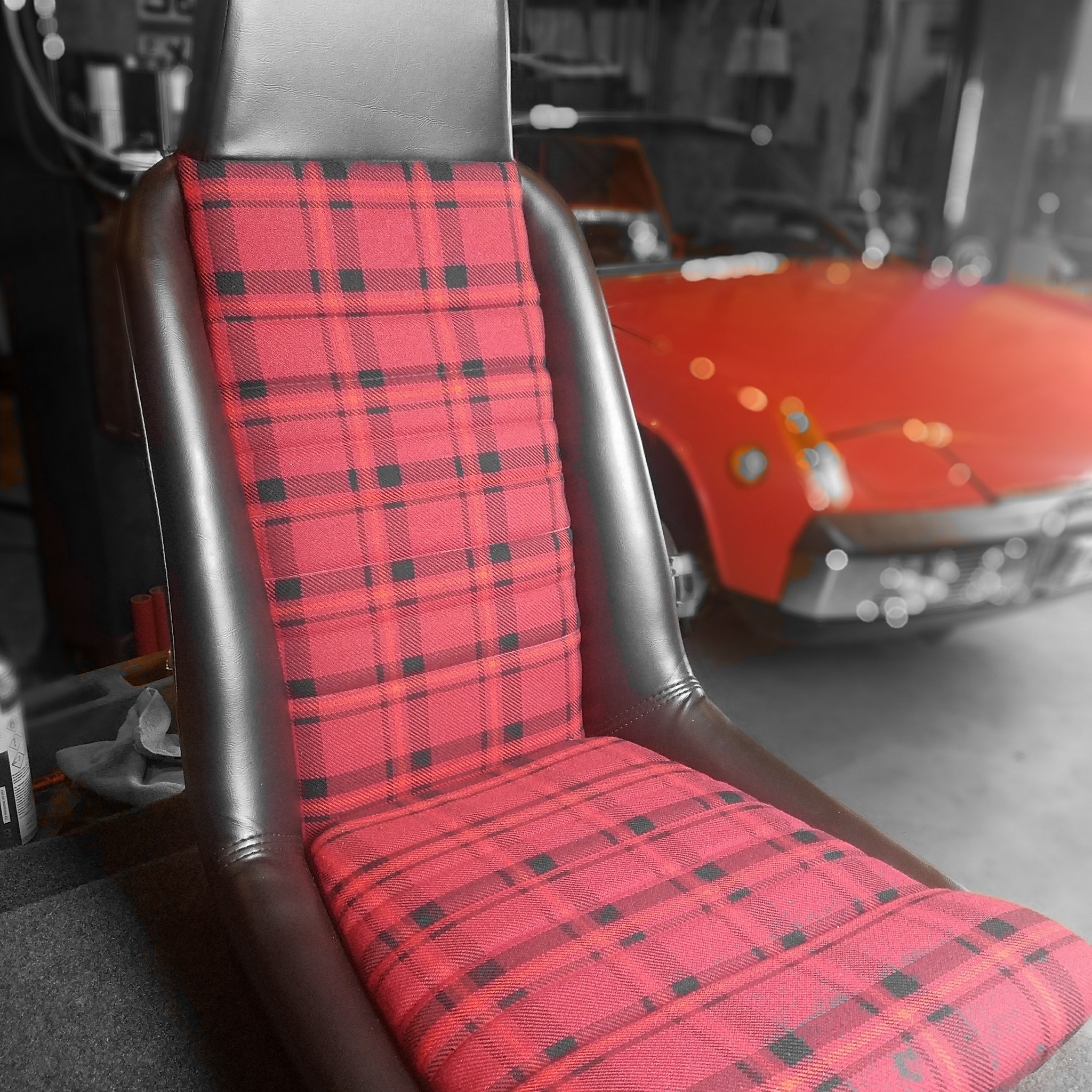

Got the seats picked up and they turned out beautiful

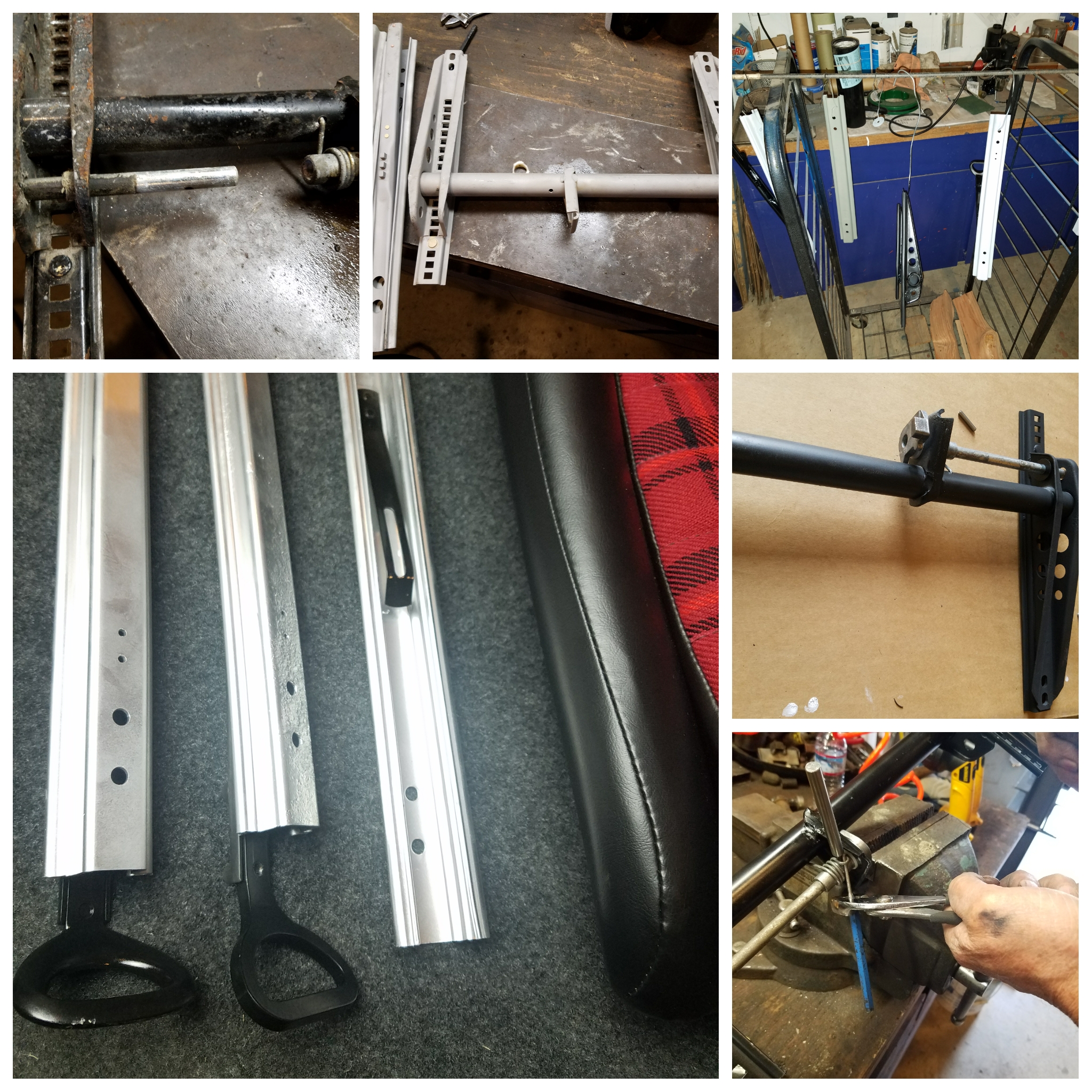

Got the seat bases and Adjusters all restored with new bushings and fresh paint after sandblasting. One had a broken seat adjuster handle so I drilled that out and put in a new handle that we make

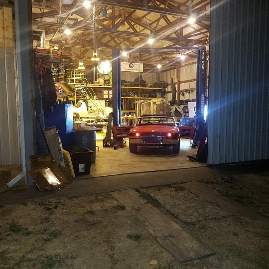

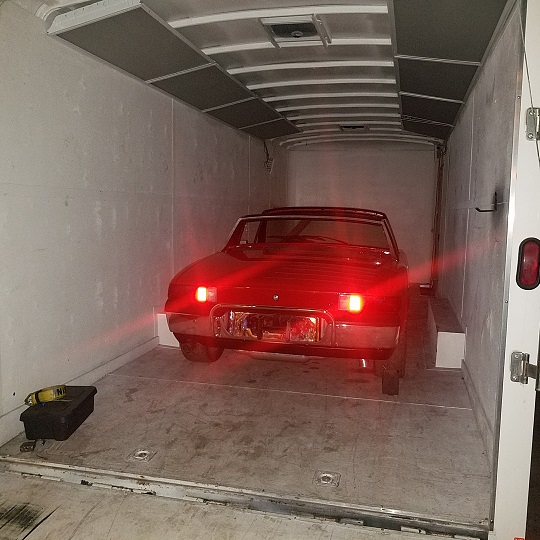

1:15 am and she's loaded in the car ................
Ran into more issues. I'll let Matt elaborate.
Left Matt at the shop to load up what's left for the car. For safety's sake I suggested Matt have his son drive him to Salt Lake City and fly him home. That way Matt can unwind and sleep.

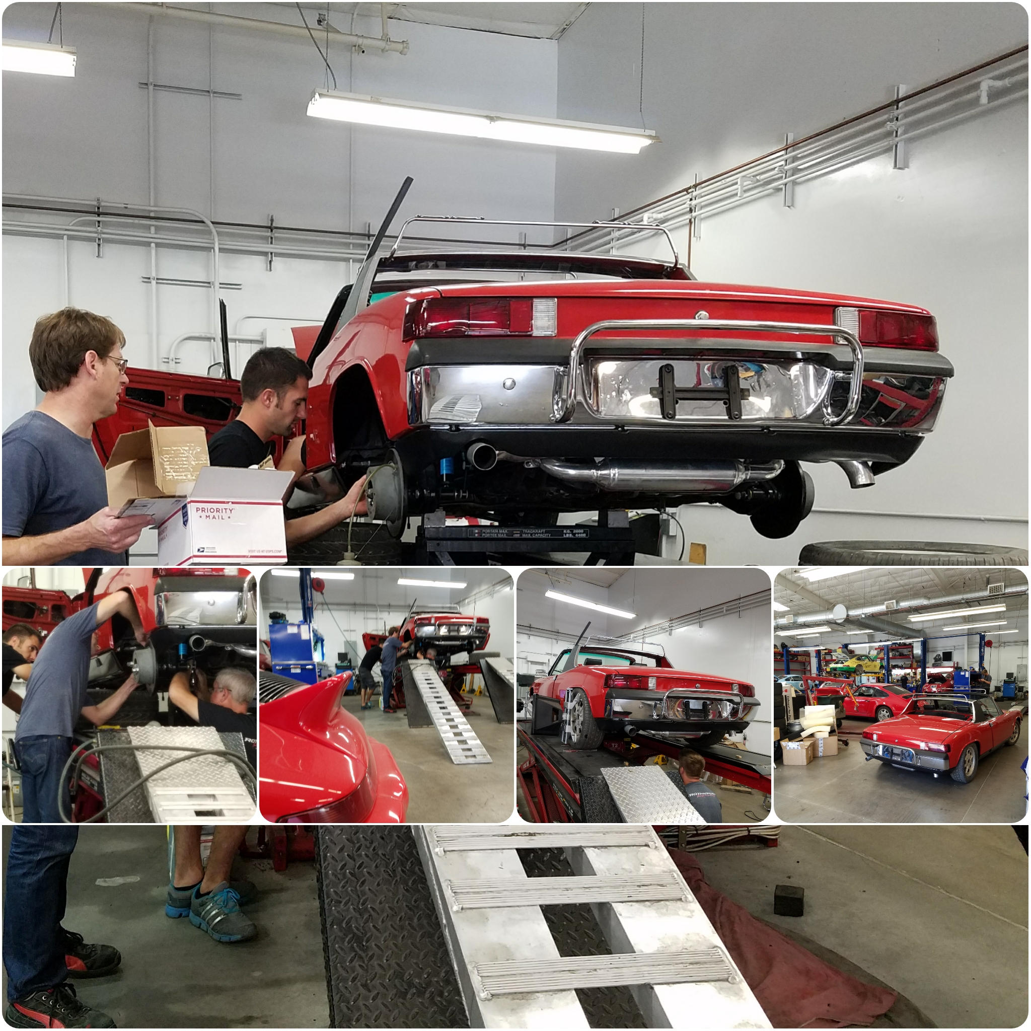

Starting to forget what day it is and my name and... what were we talking about.
A lot has happened in the last 48 hours I worked on a car from most of those hours. In the wee hours of the morning trying to get packed up for the trip to Atlanta with a car that was not running because of linkage issues and still so much still to be done with the car it occurred to me that as much as I wanted to make it there it was not going to happen and it would make a lot more sense to take a running driving car to an event. Red Rocks is a lot closer and I had a blast last year so altered plans with the car back off the trailer I went to work overtime if that's possible. What's over time to 3 o'clock in the morning well I stayed up all night last night working on the car. Yes that's right zombie mechanic. It was a very surreal thing no music playing like I usually have for motivation, no two liter of Mountain Dew just working through the parts sorting things out figuring okay this goes here and seeing something else okay that goes there but I have to do it in this order and spending a buttload of time on that damn window. That is still not done (IMG:style_emoticons/default/headbang.gif)
I always try and keep in mind that things happen for a reason and this is not in sequence for everything that's happened but is too cool not to share. We still have to figure out the alignment ride height and we're still having some brake issues carry in his awesomeness hold a favor at Rothsport Racing and was able to get the guys excited about the project and wanting to help on it. He was able to get me an appointment at 1 p.m. but we still needed some brake components that we're being overnighted from Eric at PMB (thank you, you rock (IMG:style_emoticons/default/aktion035.gif) (IMG:style_emoticons/default/beerchug.gif)) so I work on the car up to the point where I get it into the trailer and load only the car and take it out there. Pick up the brake parts and head out. I get there and I'm just overwhelmed with how cool this place is but I'm so freaking tired. Taking a nap for about an hour and a half on the couch in the employee break room. I will not make it back downstairs Jeff gamroth himself is doing the clinic with the guys on the car. Pretty freaking amazing had to share this out of order. As soon as I have the time I will get more sequential build information for you.

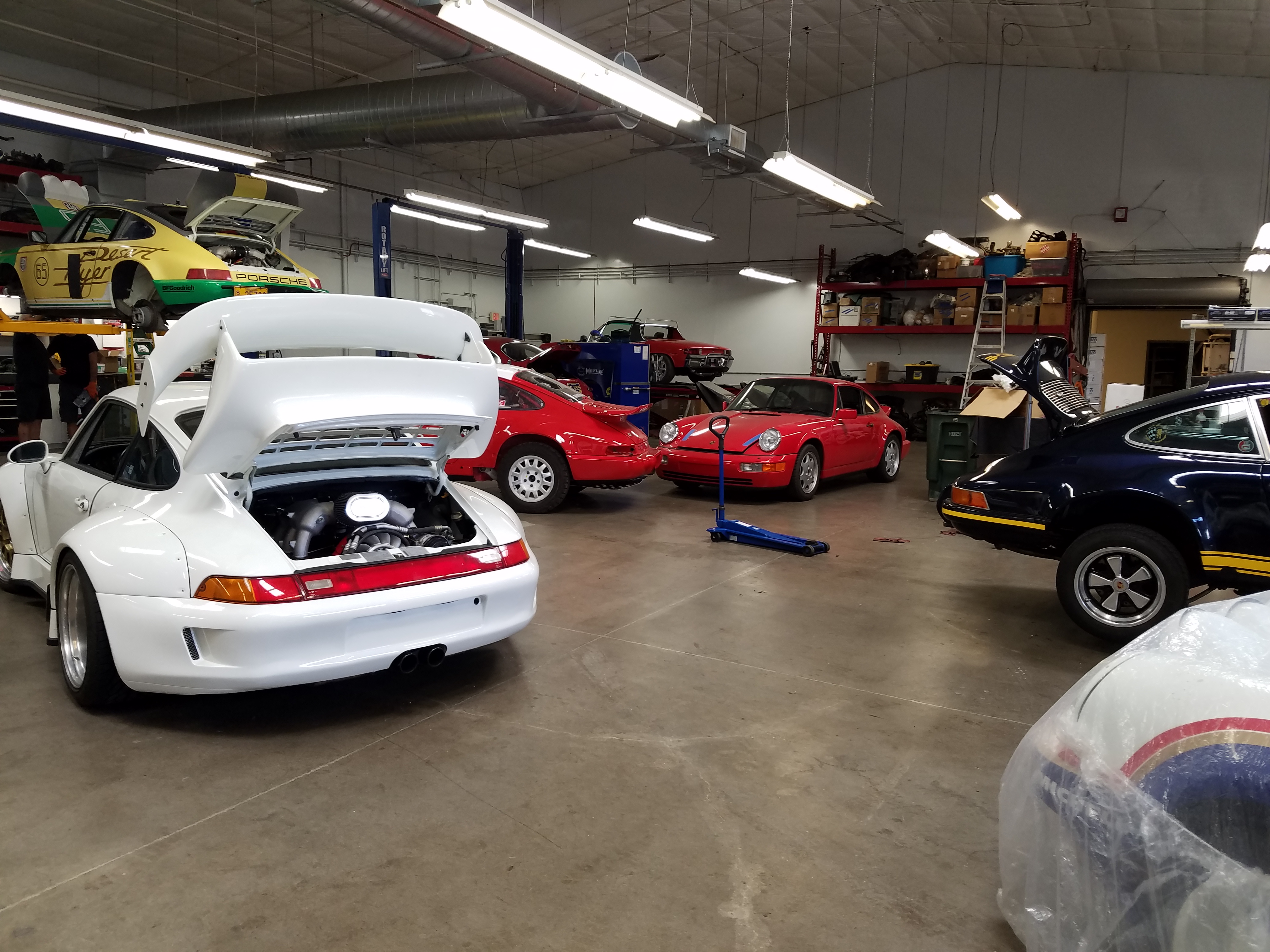

This is what my car was surrounded by. Place is truly amazing. Very I don't know how you get any work done at all I'd be drooling all day long. Thank you thank you thank you you are awesome and it goes without saying my project would be nowhere near the caliber it is without your guidance and assistance (IMG:style_emoticons/default/beerchug.gif) (IMG:style_emoticons/default/first.gif)
