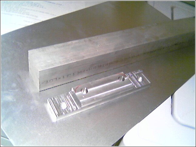

started working on the real part today....will have to finish it once I get back from vacation in a week+ (IMG:http://www.914world.com/bbs2/html/emoticons/smash.gif)

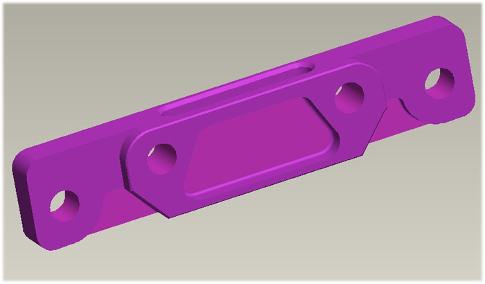

the final part should look like this...now I have to get McMark to get his anodizing kit working (IMG:http://www.914world.com/bbs2/html/emoticons/smash.gif)

It's ready to go as soon as I get some battery acid. I've even got "smoke" dye to use, but you can order your own dye. (IMG:http://www.914world.com/bbs2/html/emoticons/wink.gif)

Why didn't you finish the part? Didn't want to write extra lines of code to do the pockets? It wouldn't have taken up too much more machine time when it was already fixtured and located...

I did that part manually on the mill, I'm having problems with the stepper motors stalling every so often while taking cuts, I "think" it's due to me running them at half winding or it's a setup problem with the computer.
