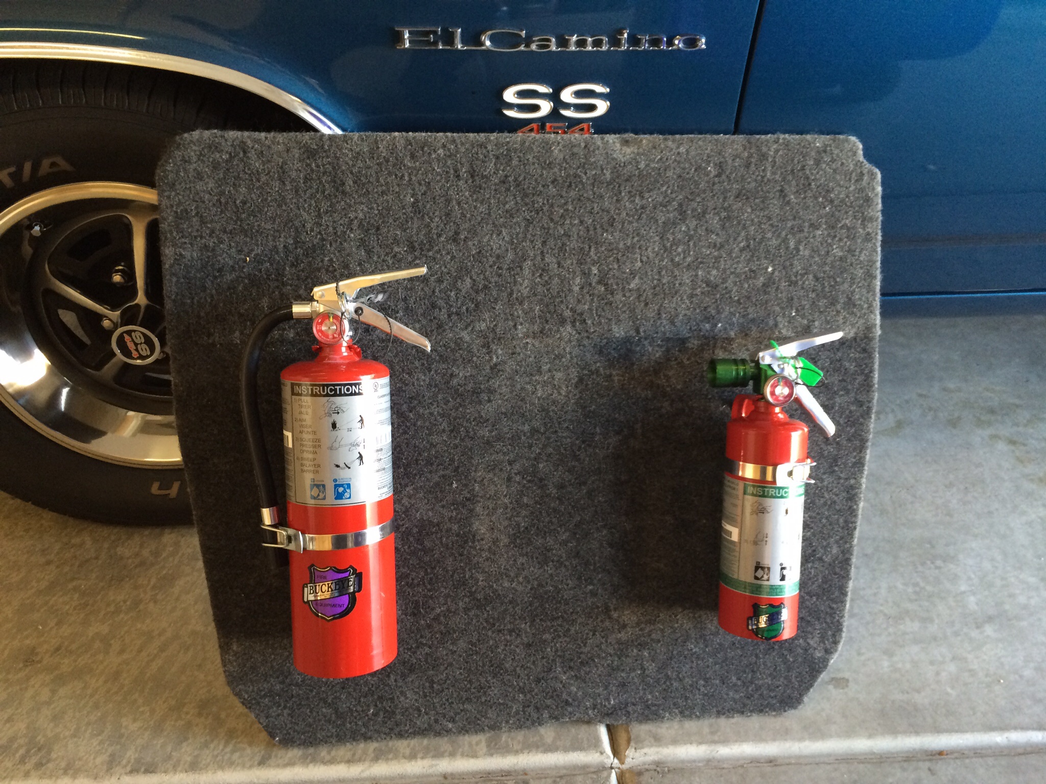

After many years of responding to vehicle fires and almost losing my second 914 to a leaking fuel line back in the day. I decided it wouldn't look to good if I lost my latest 914 to a fire. Here is the reason for two differnt types of extinguishers and there placement.
The larger Ext. is a purple K. This type does not have the corrisive residue that you would find in the A-B-C type extinguishers. Yes it is still a powder Ext. but washs off easier. This is a superior Ext. for fuel related fires.
Tha smaller Ext. is a halotron which is best for electrical fires but not so good for fuel fires as it does not leave sufficient residue that would lay on top of the fuel and suppress the vapors.
Bottom line: electrical fires in the interior grab the Halotron, fuel fires in the engine bay grab the Purple K.
As far as my placement, I am sorry but those little extinguishers I have seen mounted in the interior would be like pissing in the wind on a fuel fire. Plus the fact is if the back of my 914 is on fire I want to get the Fuch out of there and not unhook a Ext. while doing so. Easy to unlatch the HOODS, get some distance away from the rear of the car and grab the appropriate Ext. Now if the front of my 914 is on fire then I am truly FUCHED.
One last tip for any car you own if you are able to pull the hood release please do so. Trust me we have cause more damage trying to get a hood opened because the heat melted the hood release then the fire had caused.

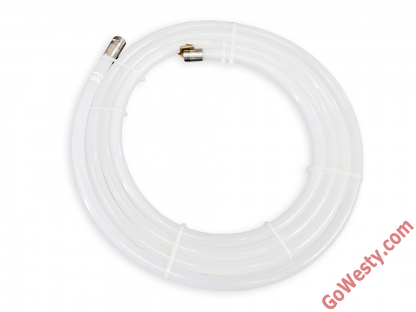

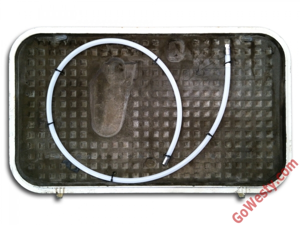

I saw this Blaze-cut set=up on GoWesty & was thinking of doing them on all of my cars' engine bays. They're probably also available elsewhere & maybe for less $$.
http://www.gowesty.com/product-details.php...24393&type=
(IMG:http://www.914world.com/bbs2/uploads_offsite/www.gowesty.com-10181-1455325551.1.jpg) (IMG:http://www.914world.com/bbs2/uploads_offsite/www.gowesty.com-10181-1455325551.2.jpg) (IMG:http://www.914world.com/bbs2/uploads_offsite/www.gowesty.com-10181-1455325551.3.jpg) (IMG:http://www.914world.com/bbs2/uploads_offsite/www.gowesty.com-10181-1455325552.4.jpg)
6' & 12' lengths - it apparently coils up & zip-ties on the engine lid/hood, & melts dropping foam when a fire heats it up.
What do you think of that set-up Coondog & any other fire pros out there? (IMG:style_emoticons/default/confused24.gif)

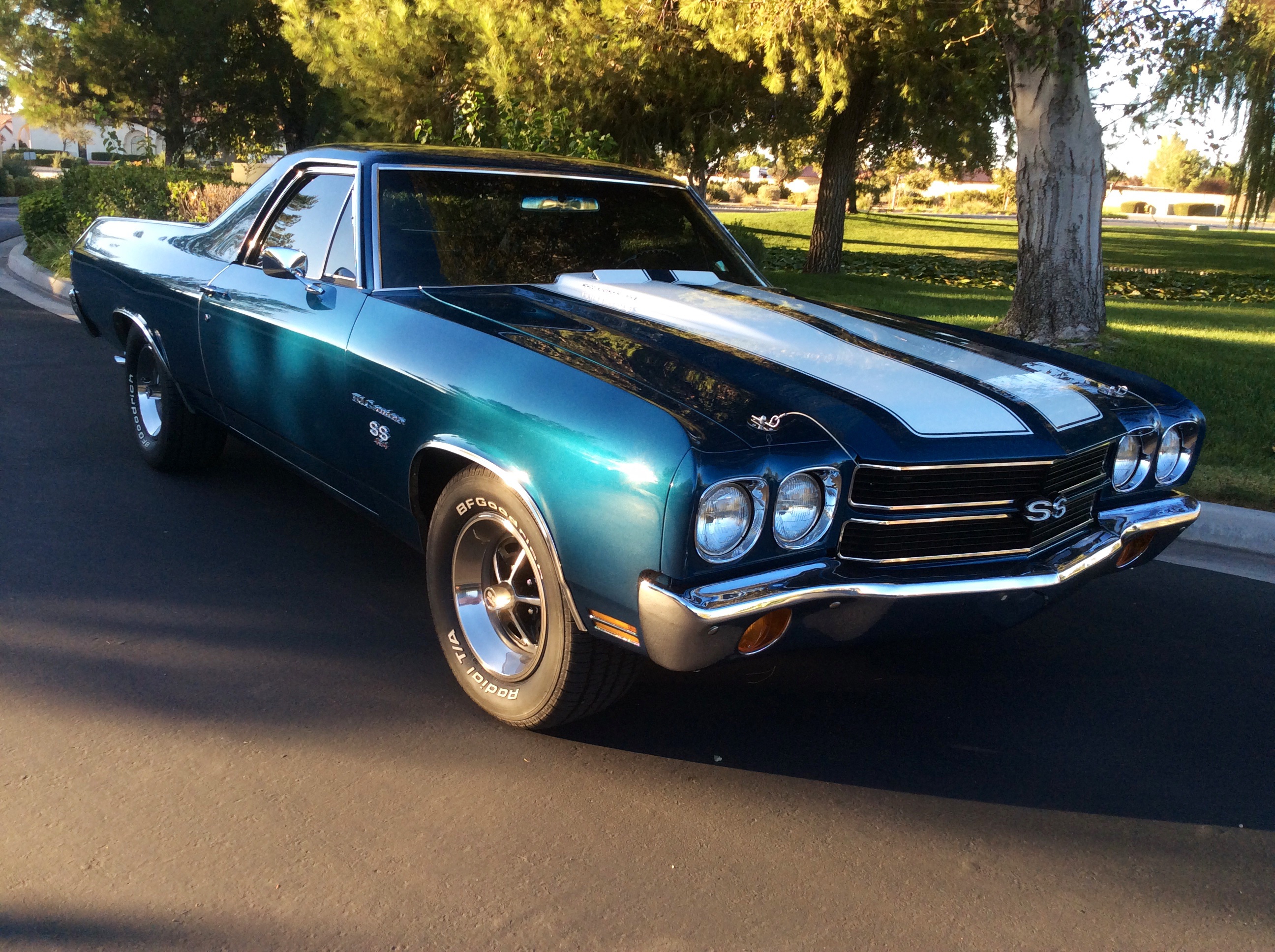

I just caught a little background detail in your photo Coondog! (IMG:style_emoticons/default/drooley.gif) (IMG:style_emoticons/default/wub.gif)
(IMG:http://www.914world.com/bbs2/uploads/post-19195-1455319277_thumb.jpg)
.... `72 'Mino SS 454? (IMG:style_emoticons/default/confused24.gif)

Coondog
post Feb 12 2016, 07:19 PM
Posts: 2,089
Joined: 24-September 15
From: Apple Valley Calif
Member No.: 19,195
1970 SS 454 LS 6

QUOTE(Coondog @ Feb 12 2016, 05:19 PM) *
1970 SS 454 LS 6
I had to guess `72 - not seeing the grill nor tail in the pic of the fender detail Coondog!
That was prime time (IMG:style_emoticons/default/drooley.gif) on the way to/from school back in `69-70 down in San Diego, for me driving along in my lowly 4-banger Opel Kadett!
Screaming scary fast too with the LS6 454! (IMG:style_emoticons/default/yikes.gif)
Thanx for the "full body" pic!
Beautiful! (IMG:style_emoticons/default/first.gif)
