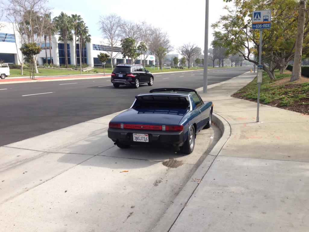

I'm IN Lawrence!
This morning heading home from Cars and Coffee!
Less than 3 miles away to home, from stop light my Tach was bouncing between 3,500 and 4,000 rpm but the actual rev is just on idle. When the light turn green and about to roll, engine died. Scary i was at the middle lane of 7 lines and good after all cars from stop made the road clear and I was able to push the car to the right corner by the bus stop. It cranks well but wont engage the engine. Maybe fuel pump or relay?
