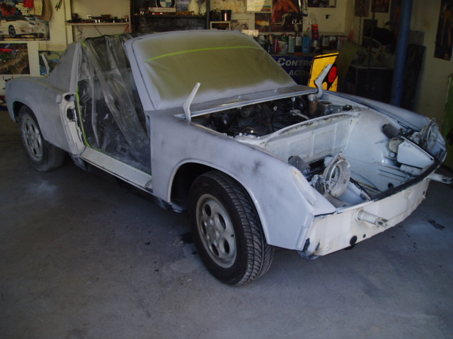

So I think I'm going to chicken out of painting it my self. I just spent the better part of 6 weeks stripping and doing body work. If I mess it up, I'll be back to square one. I'm going to go look at a few body shops today and see what I can come up with...

Ok...so here's tonights' installment. I talked to a half-dozen shops today, and the last guy told me "You've done all the hard stuff, now is the fun part. Go home, pick a quarter-panel and prime it. You'll see how easy it is..."
SO home I went to paint a quarter. Here's before...
(IMG:http://www.hardman.org/pix/914_progress/914_progress-Images/148.jpg)
CptTripps
post Apr 7 2005, 06:58 PM
Post #120
:: Punch and Pie ::
Posts: 3,585
Joined: 26-December 04
Member No.: 3,342
And 20min later...
(IMG:http://www.hardman.org/pix/914_progress/914_progress-Images/149.jpg)
