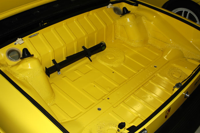

carreraguy
post Apr 17 2005, 07:34 PM
Post #180
It's not your dad's 914!
Posts: 1,197
Joined: 17-October 03
From: San Jose, CA
Member No.: 1,256
Nice job! Looks familiar; here's my Sunflower yellow:
