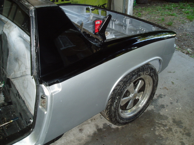

QUOTE (CptTripps @ Apr 27 2005, 07:17 PM)
Everywhere else, I seem to be good. I really hope the color sanding helps get the dust specs, and runs.
(IMG:http://www.hardman.org/pix/914_progress/914_progress-Images/199.jpg)
If the rest of your car looks like that passenger quarter pic, your going to be smiling for weeks after a bit of colorsanding. Looks great man. (IMG:http://www.914world.com/bbs2/html/emoticons/smilie_pokal.gif)
