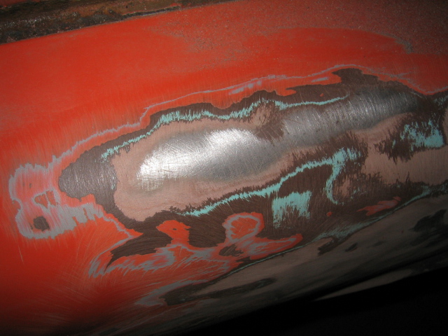

what kind of tool are you using to take all of the paint off
im using one of those 3m paint and rust grinder type pads that attatch on a drill and im hitting bondo on the front fender i think its factory bondo since the layers i see are paint-primer-paint-primer dark reddishbrown primer? and then in some areas bondo then the metal
whats the red stuff
id like to know what tool your using cause the drill im using is cutting into the bondo or body filler and by doing that its going to be hart to shape the fender back to the stock look
or should i just grind all of the filler out
thanks

QUOTE (shorty01 @ May 18 2005, 07:11 PM)
You're using this on a regular drill? This might take you quite a while. I would look into an angle grinder. Much more power. Also, if you don't want to completely strip the filler, maybe use a DA sander if you have a compressor.

the pink is bondo and the green is bondo. The factory didn't use body filler. It looks like your car was painted several times. Look under a body gasket for origonal color. 120 grit on an electric random orbital sander will cut the paint without gouging the bondo.

Shorty: Brown was a typical sealer/primer in the 70s. You probably had a re-paint at some point. I took it ALL THE WAY to metal. Used the 3M SandBlaster purple pads on an angle grinder. If I had to do it over? I'd use a chemical stripper. WAY faster/cleaner/cheaper/better on the metal.

Cpttripps what kind of stripper would you use, And should i take out all of the bondo and apply new? or just bondo over the old stuff.
