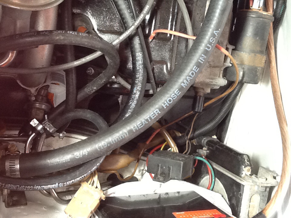

It's the brown wire (with some red shrink tubing covering the cracks in the insulation) and a female spade connector on the end coming off of the fuel injection harness near the battery and ECU. You can see it just to the left of the dual relay. Is it a ground that connects to a male spade connector under the plenum?

It should be connected to the Ignition Coil.

Which side of the coil, + or -?

Negative.

Negative
