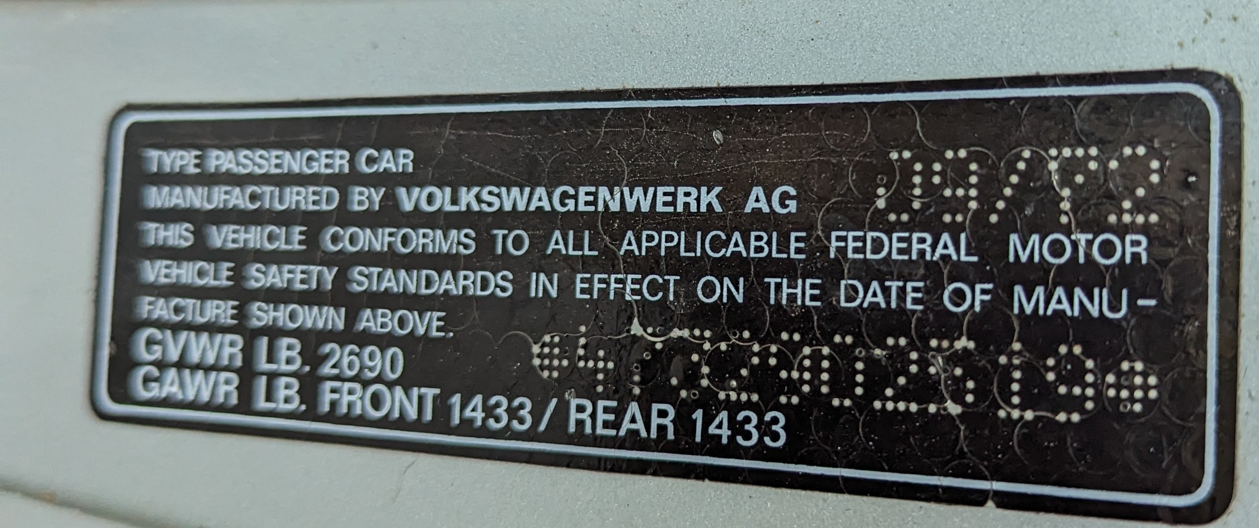

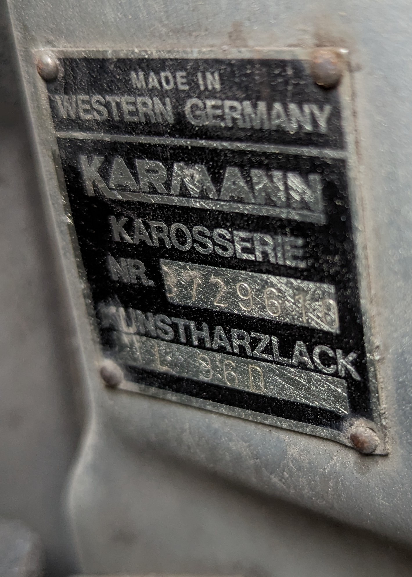

So mine says 9/72 but I can't figure that out by the chassis number...

QUOTE(emerygt350 @ Sep 27 2023, 03:28 PM) *
@emerygt350
Looks to be 3729610 so according to the guide from the first post that would be:
37 week
2 day
9
610 - 500 = 110 car that day
Google-ing the calendar for 1972 week 37 was from September 10th to September 16
Since Karmann started counting on Mondays, the 2nd day that week would be:
Tuesday, September 12th 1972

QUOTE(SirAndy @ Sep 27 2023, 05:15 PM) *
@emerygt350
37 week
2 day
9
Thanks Sir Andy!!! I missed its 51st birthday but I am sure it will forgive me.
