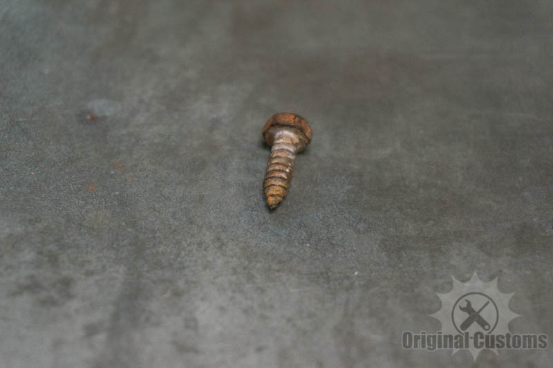

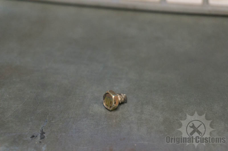

900.187.018.02
Hex Head Tapping Screw B 4,8 x 16 Material: Steel, gold zinc plated Hex head width across flats: 8mm Head thickness: 2.93mm Head is recessed ~0.5mm Recess diameter ~7mm Thread pitch: ~1.44mm Pointed tip, threaded all the way to the tip Attached image(s) ![]() ![]() ![]() ![]() ![]() |

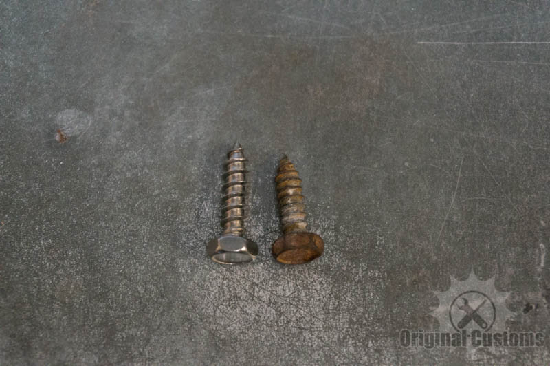

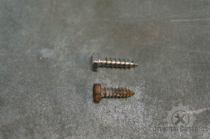

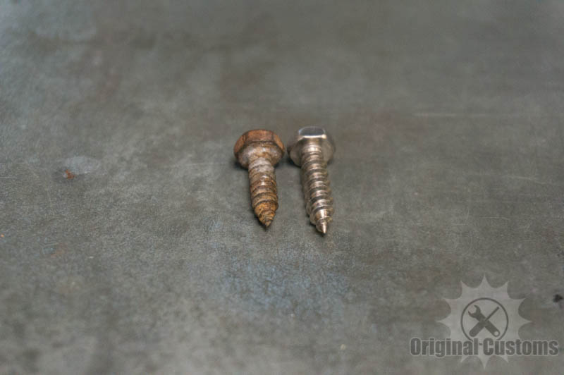

Nearest replacement I've found:
Fastenal #0173112 Head is nearly identical, they're slightly longer and the thread pitch is wrong (~2mm). Also, threads are deeper cut. Attached image(s) ![]() ![]() ![]() |

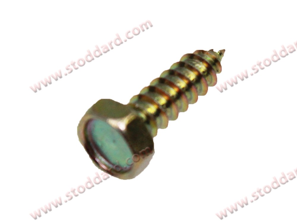

Apparently still available from Porsche as well.
http://www.stoddard.com/90018701802.html (IMG:http://www.914world.com/bbs2/uploads_offsite/www.stoddard.com-419-1456864319.1.jpg) |
