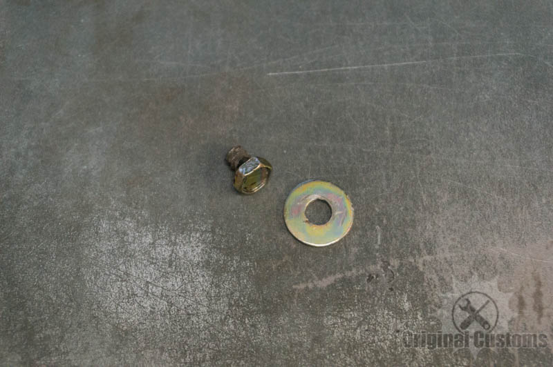

This is the washer for the bolts that hold on the front and rear valence.
These were used on all 6 front valence fasteners for 1970-1971. They were only used on the 2 screws below the bumper mount bolts on the 1972-on cars. The center 2 washers on these later cars were bigger. Material is steel, gold zine/cad plated. ID is 5.3mm OD is 14.82mm Thickness is 1.27mm Attached image(s) ![]() |
