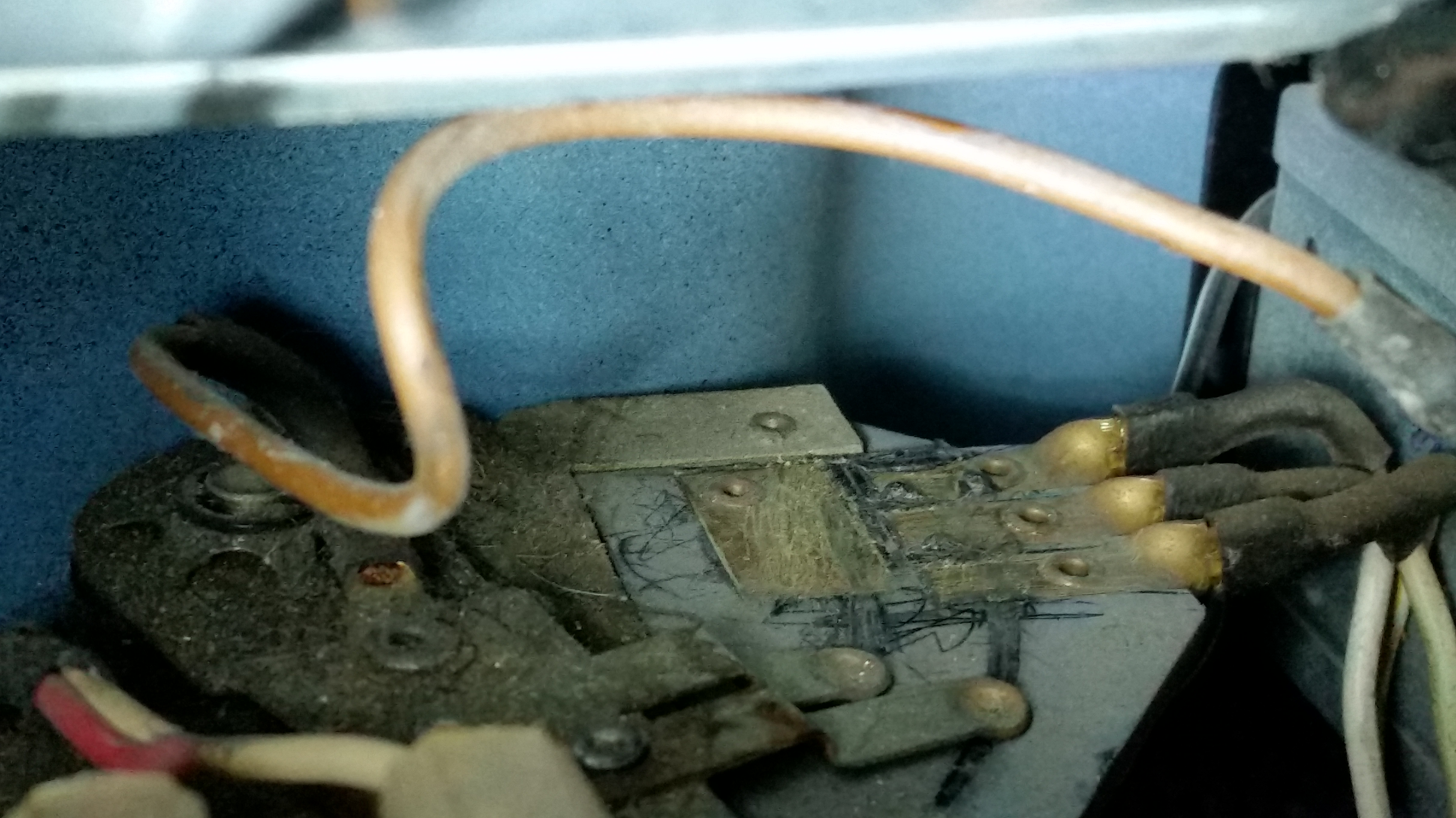

So after a year I've finally gotten around to troubleshooting why my fresh air blower fan doesn't work. Some deoxit and scraping away crud with a long screwdriver got the low and mid settings on the fan to work. It seems though that the little borders that create a detent in the slider movement between settings is preventing the contact arm from reaching the third setting. It's like the contact arm isn't long enough to make it over the last detent border. Anyone know if there's anything that can be done? Any adjustments?
You can (hopefully!) see how much bigger the last detent is in the pic. Not an easy shot to get through the ashtray hole!!!

The last "detent" is deeper because at one point that connection got too hot and melted the plastic causing it to sink. I've seen it happen a few times. You can try removing some of the excess plastic and bending the arm some to make full contact. Also clean those connections real well so it doesn't happen again.

Resistance has built up enough heat to melt the plastic behind the contact. Bending the contacts doesn't help much.
I have the same problem, still looking for solutions.

It happens because the fan motor is old and dirt interferes with its movement. As a result, it draws more current and melts that contact.
Clean the motor and re-grease it. Maybe you need to re-bush or just replace it.
Clean that contact, remove any melted plastic that can interfere with the moving arm.
You may want to remove that speed at all. You can shift the wires and get rid of the lowest speed that doesn't do much anyway. Then just add a stopper so you don't go over the middle contact (or remember that the fan lever will not work all the way to the right)

(IMG:style_emoticons/default/agree.gif) It's not just the contacts there. It's the whole circuit through the resistors in the fan housing. If there's too much resistance, something is going to give. I managed to get my mid and high speed settings working, but the low-speed resulted in smoke. I have since disabled that setting.

From under the dash, you will see a nut holding it to the chassis. Undo that nut and it will slide out of the dash, though at this point the cables will be a problem. Might be able to tilt it enough to get your hand in there well enough to clean.
Like Doug said, the plastic melted and pushed the contact in deeper. Cut/sand the bubbles, I used a sanding disc on a Dremel, and pull/bend the contact back to level.
A lot easier to just swap wires.

On closer inspection I can see now that those "detents" are actually melted plastic and not supposed to be there. Yikes!
I was able to clean the contacts by reaching under the dash and up behind the controller with a q tip in one hand, and spraying contact cleaner from the front through the ashtray opening. A bit of the old reach around! (IMG:style_emoticons/default/shades.gif)
