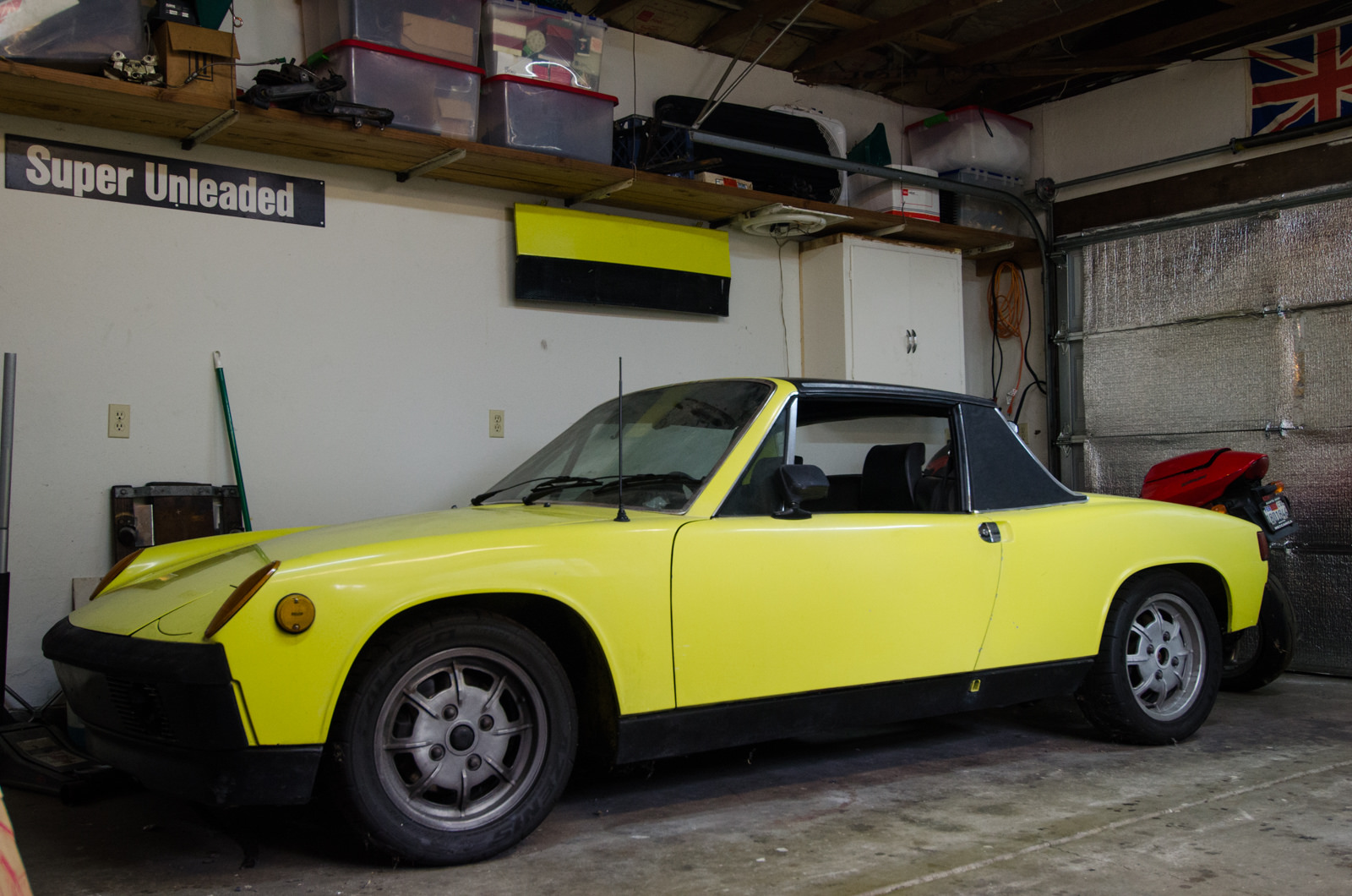

Welcome to my scattered 1974 1.8 Chrome Yellow project thread.
I purchased the car back in '05'sh. One of the POs had converted it to a well sorted 2.0 D-Jet autocross/street car. It was complete but a bit ratty with a tired motor. Great Koni Sport suspension with a fat solid sway bar and adjustable drop links. Otherwise bone stock.
Built a fresh 2.0 with a 9550 Raby Cam and kept it D-Jet. Ran a DE Event at Thunderhill, a few auto-x's at the Sonoma County airport and otherwise used the car as my DD. During this time, around 2007, early 2008 I picked up a very clean Marathon Blue '74 2.0 from Doug Wright. I ended up putting the new motor from the yellow 914 in the Blue car in 2008 and it's sat in my garage since.
Here it was as of a few weekends ago:
So what's happening?
My friend and machinist is currently building a 1911 from the ground up. Opened up 1.8 heads, rebuilt dual 40 IDFs (thanks George, @thepaintedman here on the World), Elgin cam, etc. I'll post motor specs in a different post.
Purchased Chris's SS tunnel fuel line replacement kit w/ pump. Need install that in the next few weeks.
Sourced a rear bumper from GMS and am currently repairing some issues it has and then move onto the front bumper and rocker panels.
I need to go through the brakes.
Should probably check the tank closely for rust issues.
Need to replace the heater pull cables.
Need Mark D's modified speedo drive with the extra o-ring, or source a nosecone that doesn't have a worn out drive hole.
Already purchased rain caps for the carb's as I also purchased Sergio's GT lid clone.
Need to strip and paint the Mahles unless I source different wheels.
I have a mostly complete 5-lug setup (including rear hubs and s-calipers), but I'm saving that project for later.
Still reading? I'm sorry.
Anyways, plenty of photos coming and I'll keep this thread updated as I make progress.
