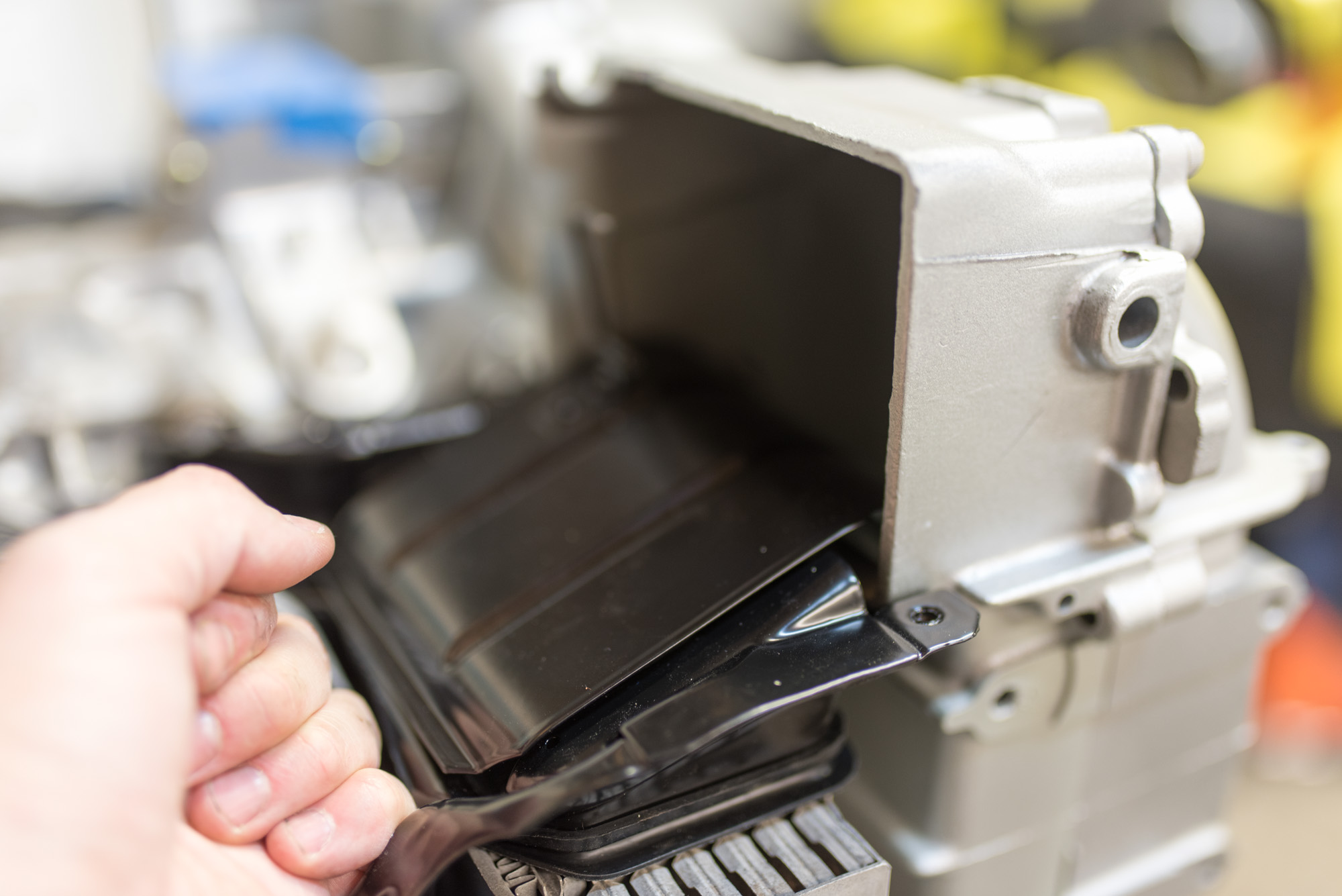

More progress tonight -

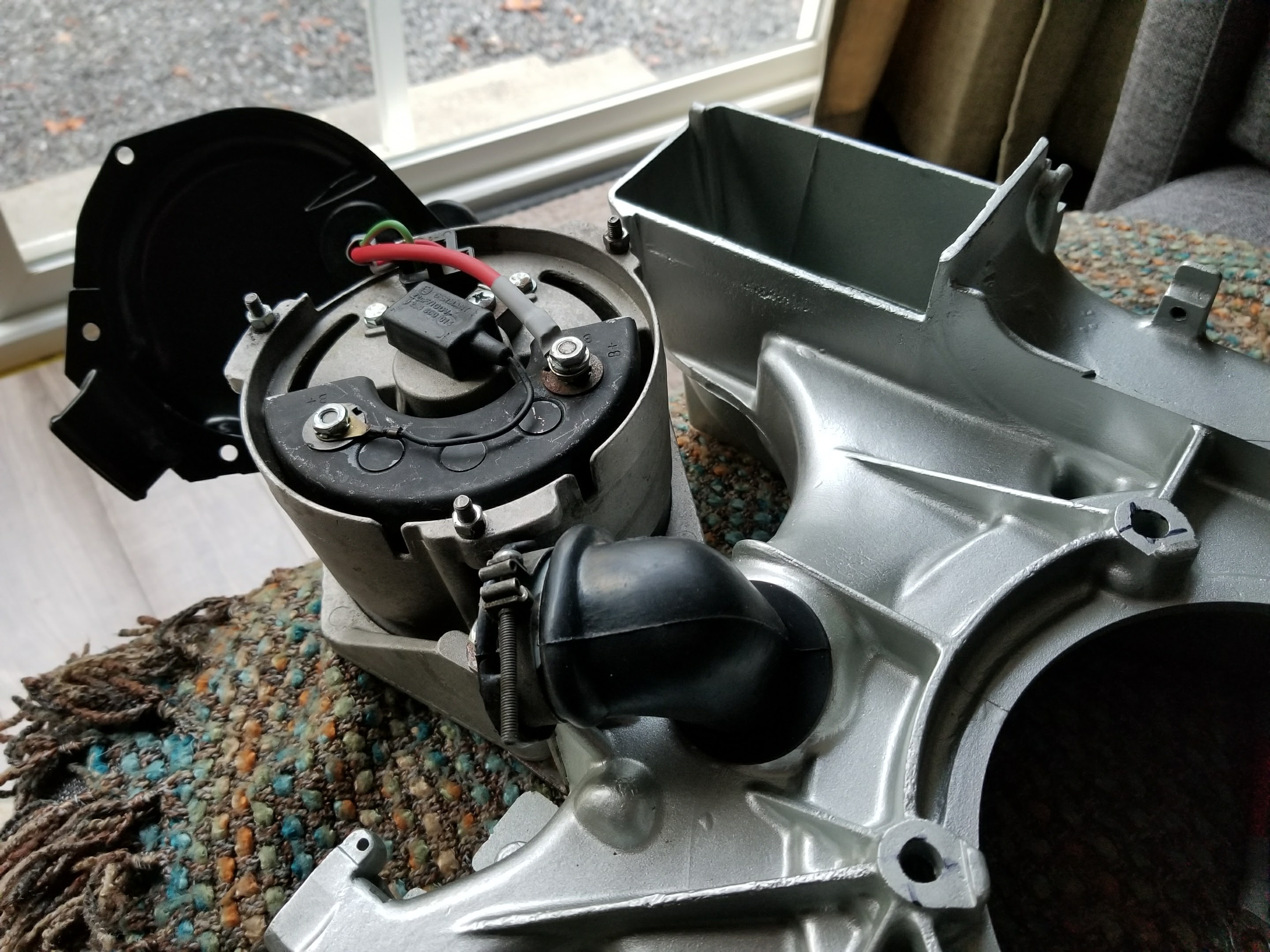

A few more -

Have a cold, so I didn't get a ton done this evening. Realized I'd left off the flapper bar, so I had pull off some tin and sort that out. Missing the spring tab. Looks like something I can probably fabricate pretty easily if I can't find one in my stash.
I'm also missing the oil cooler support bracket. Lame. Hopefully my machinist here in town has a spare, or else my plans on installing the motor this weekend will be stalled until I can buy one from Garold (you listening buddy?)
Just an upskirt shot. Maybe I'll invest in a bellows kit. IDK, I've never had one working on any 914 I've owned.
