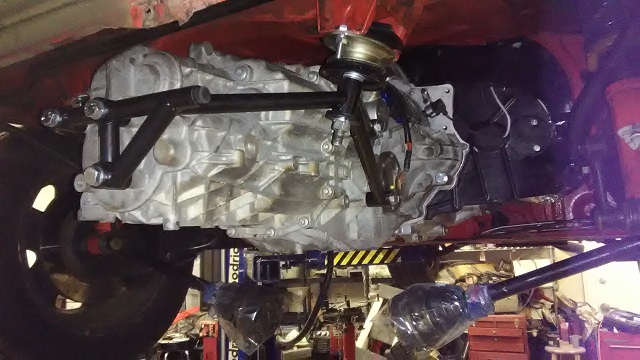

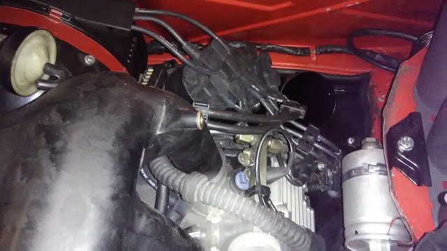

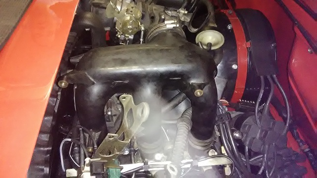

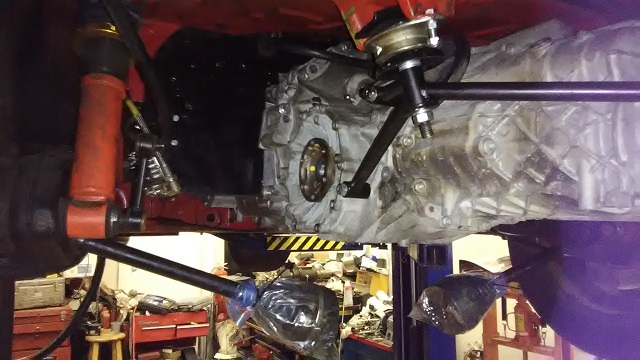

I have to use this quote!
![]() Got the engine and trans into the chassis tonight! (IMG:style_emoticons/default/aktion035.gif) (IMG:style_emoticons/default/mueba.gif) (IMG:style_emoticons/default/mueba.gif) (IMG:style_emoticons/default/smilie_pokal.gif) ![]() ![]() ![]() ![]() Now to get everything hooked up and get it FIRED UP! |

Where is the cut n patch you that needed to do to the cradle so the tranny lines up?
| ClayPerrine |
Aug 8 2019, 08:52 PM
#155
Life's been good to me so far..... ![]() ![]() ![]() ![]() ![]() ![]() ![]() ![]() ![]() ![]() ![]() ![]() ![]() ![]() ![]() Group: Admin Posts: 16,542 Joined: 11-September 03 From: Hurst, TX. Member No.: 1,143 Region Association: NineFourteenerVille
Where is the cut n patch you that needed to do to the cradle so the tranny lines up? Aaron (the machinist) took the front mount apart and removed 1.25 inches from the U shaped plate between the engine and the arm for the mounts. That moved the engine forward enough so the trans mounts fit. It probably could have used another quarter inch removed. |

I have to use this quote! Got the engine and trans into the chassis tonight! (IMG:style_emoticons/default/aktion035.gif) (IMG:style_emoticons/default/mueba.gif) (IMG:style_emoticons/default/mueba.gif) (IMG:style_emoticons/default/smilie_pokal.gif) Now to get everything hooked up and get it FIRED UP! It actually fits, what a relief that must be! (IMG:style_emoticons/default/beer.gif) |
