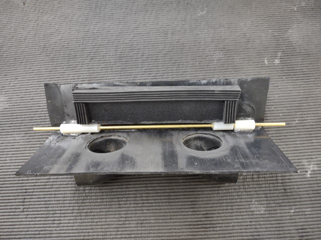

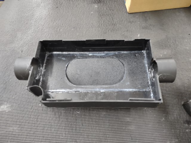

Last night I went back to work on the AC evaporator.
And the door for the defrost/face vents came loose from the rod.... inside the box I already glued closed.  So I ended up cutting the box open at the seams to fix the door.
Safety note kids.. when cutting plastic that was bonded with super glue, wear a mask and goggles.  When the cured glue gets hot, it gives off toxic fumes that will make your lungs hurt and your eyes water. I use an N95 mask and a set of safety goggles. And I keep a fan running to push the fumes away.
Got the door fixed, and set it aside to let the glue dry.  I will be adding epoxy to re-enforce the pivots inside to insure the door does not come off again.

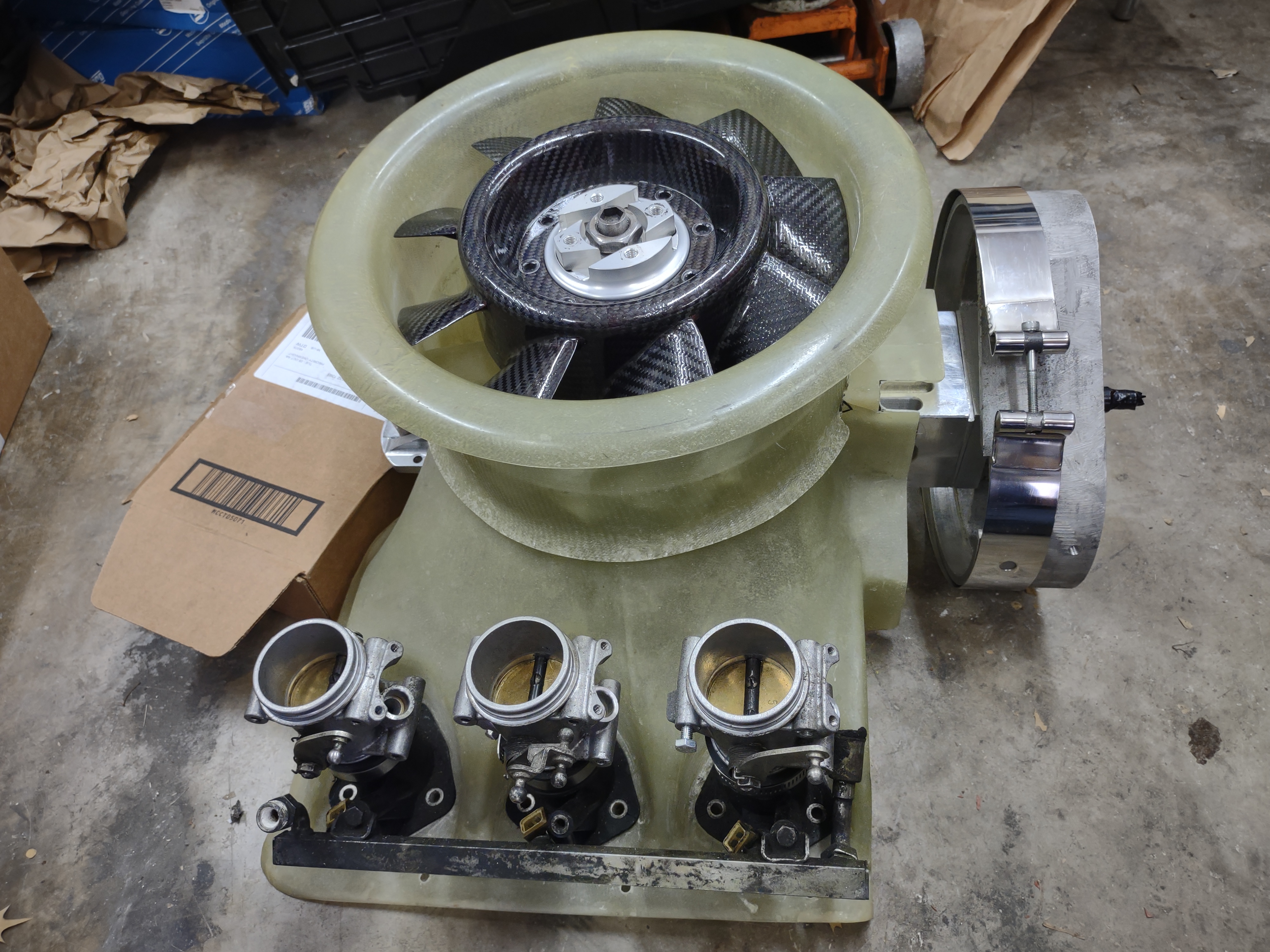

I have not updated this in a long time. Worked stopped on the ac setup due to family issues. Now I am going to drop the motor, and fix the leaking cam box. And I just got an epic case of Dirk Wright's disease. While I am in there, I am going to install this:
It is going to be FUN!

QUOTE(ClayPerrine @ Apr 4 2022, 06:16 PM) *
It will be after the Hill Country tour, and when Betty's 914 finally comes back from the body shop, it moves to the front of line.
I'm counting 6, its missing 2? (IMG:style_emoticons/default/smile.gif) (IMG:style_emoticons/default/stirthepot.gif)

QUOTE(wonkipop @ Apr 4 2022, 09:33 PM) *
Nope, only six cylinders. That is a replica of a Porsche 935 fan. It is going on top of the 4.0L air cooled six. The throttle bodies are from a BMW K1300GS motorcycle. I have another set for the other side. I have to make plates to tie the throttle bodies together and provide a mount for the throttle linkage crossbar.
Stay tuned... more to come.
