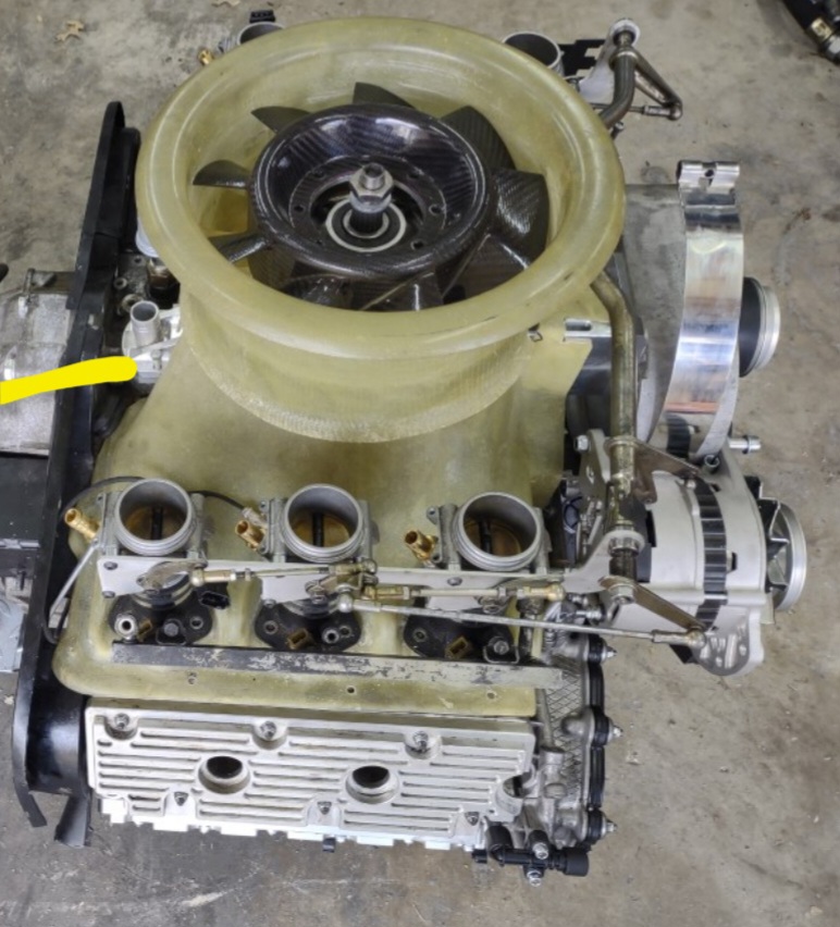

QUOTE(ClayPerrine @ Apr 2 2023, 01:26 PM) *
Today's progress...
There is a big hole behind the original fan location. So I am going to have to make a block off plate for it.
After the picture, I made the holes in the shroud for the wiring for the two knock sensors. They are the same size as the holes in the original 964 fan shroud, so I can use the original grommet setup.

QUOTE(wonkipop @ Apr 2 2023, 04:55 PM) *
do you have to do firewall mods for the alternator position?
engine looks horn. you almost want a circular hole cut in the engine lid to cop an eyeful of that fan like the old 917s. (IMG:style_emoticons/default/aktion035.gif) (IMG:style_emoticons/default/beer.gif)
I am using coil on plug, so there is no distributor. The alternator will be placed lower, down where the distributor is located, to clear the firewall.
I have a GT engine lid, so the fan will be visible through it. My only worry is getting something sucked into the fan while running it when working on it.
Clay; you should be good to go with the gt engine lid keeping 99% of debris from sucking into the fan while under way. Working in the engine bay while it's running; don't wear loose fitting long sleeve shirt, keep anyone with long hair away from looking over the fan, and no loose shop rags left near the fan. Dirt and gravel roads tend to throw debris up from below and suck back into the fan downdraft. When parked (not running) you might want to make a simple plexi disc to cover the top of fan housing...I've seen several displayed on 917's at Rennsport 7.

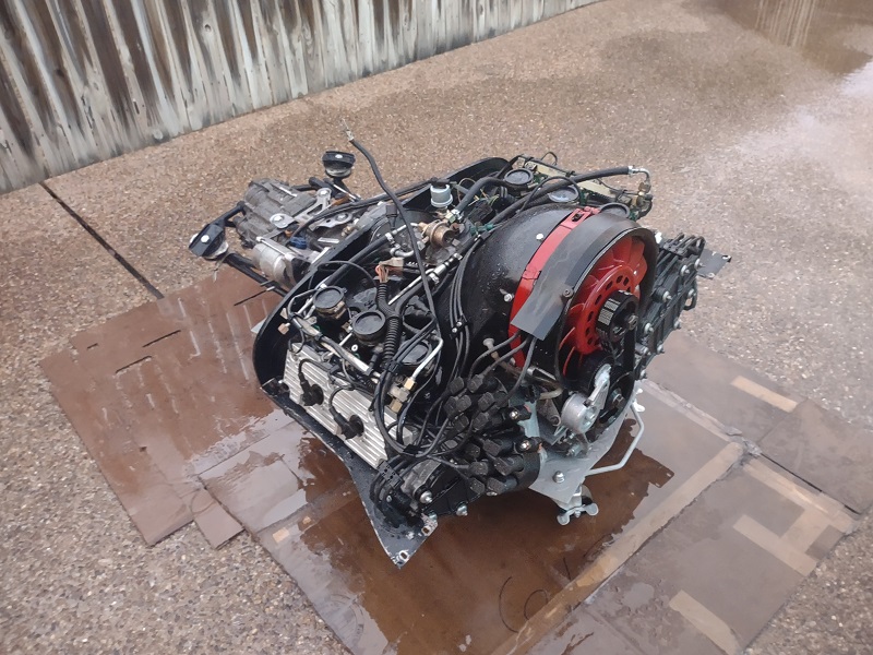

So I am finally getting back to working on the new EFI system for my 914-6 conversion.
I am finishing up the new relay box for the MS3Pro.
This goes in the same location as the factory relay board. It has fuses and 6 relays for the EFI, the baro sensor, and a 14 pin connector to hook it to the rest of the harness.
I stopped because I have to go get loop connectors for the ground leads and for the power connections. I also need to get a new 14 pin connector. That one is broken and glued back together.
