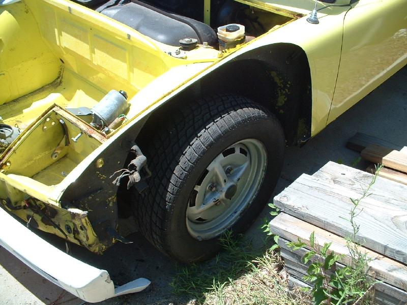

The GT project went on hold for a while but now that Ida's out of the garage it has a prominent place on the service roster.

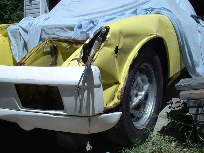

Sunday was the big day. I finally got rid of the last bit of damage to the tub and welded on my final fender. Here's some pics that showed what went on:
Before. Checking the bumper fit and taking measurements That corner was in about 1.5", mostly on the bottom. Luckly the headlight bucket didn't need to be removed.

Chop Chop... (IMG:http://www.914world.com/bbs2/html/emoticons/sawzall-smiley.gif)

I had to pull out that tab about 1.5 inches. Damn, these little things are tough (IMG:http://www.914world.com/bbs2/html/emoticons/smash.gif)
Weld Weld (IMG:http://www.914world.com/bbs2/html/emoticons/welder.gif)

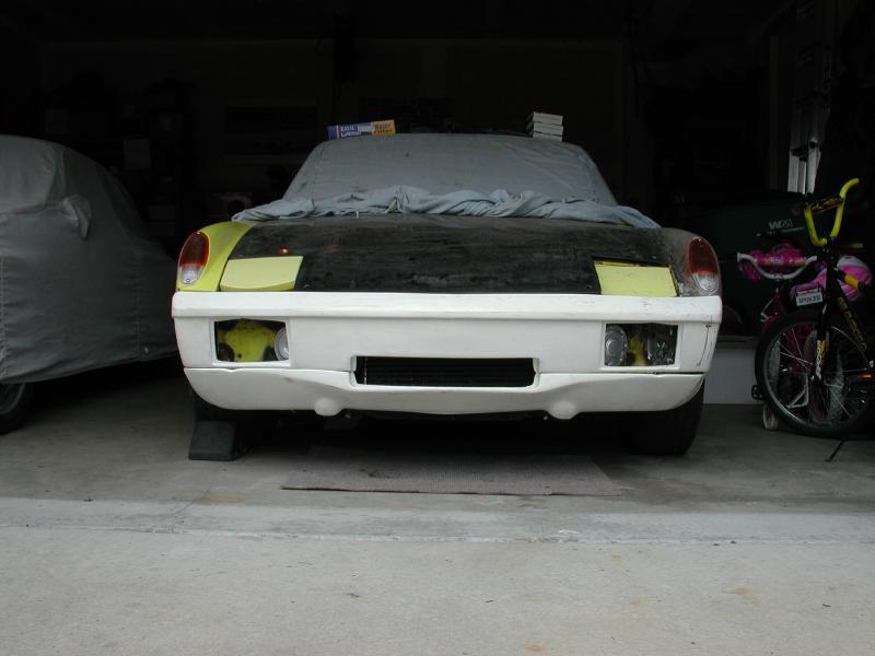

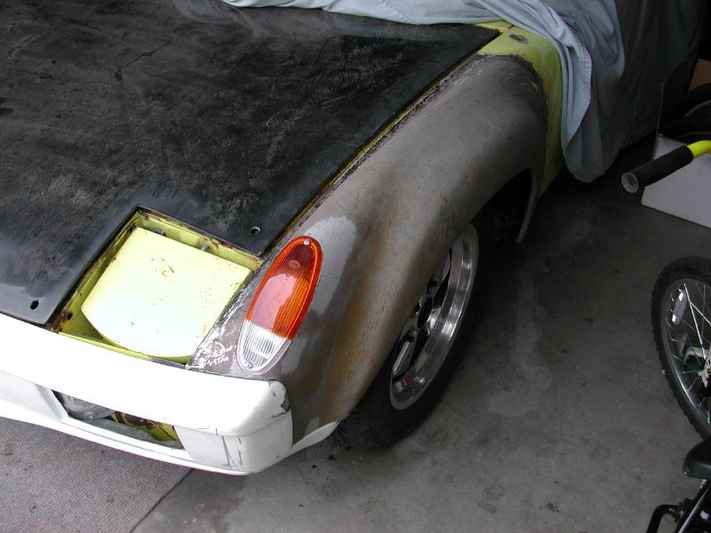

Front end is clamped and bolted in place to check final fit before it gets torn apart again.

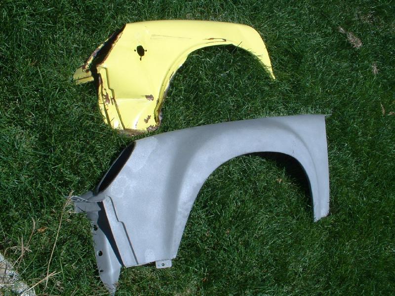

Here's the two fenders side by side...
