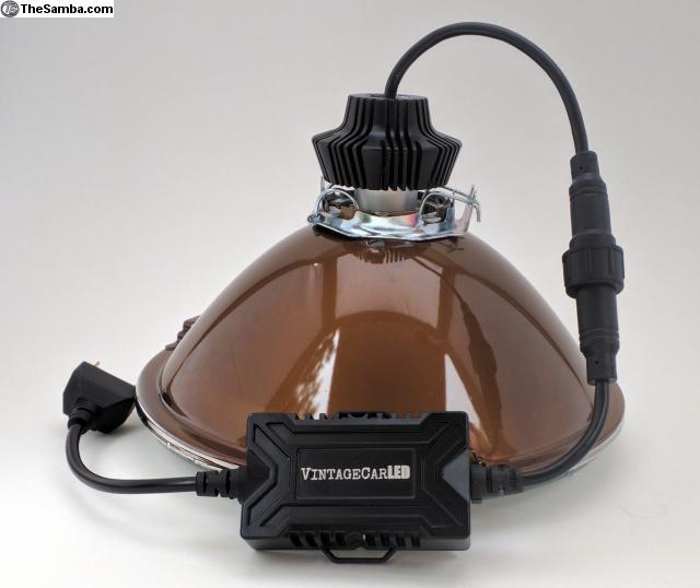

$209 for the pair? Sounds too good to be true. Anyone have any experience with these?
http://www.thesamba.com/vw/classifieds/detail.php?id=1934155

But I don't think it will fit into the tight bucket space. If you decide to do this take pictures and let us know

Cool. I would need to see a beam pattern before buying. I also would be concerned about how far the bulb base sticks out.

I have a sneaking suspicion that they might actually fit. Like an idiot, I lost whatever measurements I had of my HID light solution when I made the ones in the picture below (had to make fiberglass light covers just to get them in there), but it was a significant gain in length, maybe 3 inches. These don't look like they protrude nearly that much. I'll see if I can get an answer from the manufacturer, or maybe even a test pair (IMG:style_emoticons/default/idea.gif) (IMG:style_emoticons/default/biggrin.gif)

The other model they sell is even cheaper, still almost 2x as bright as H4s, no extra ballast hanging off and $159...plug and play?

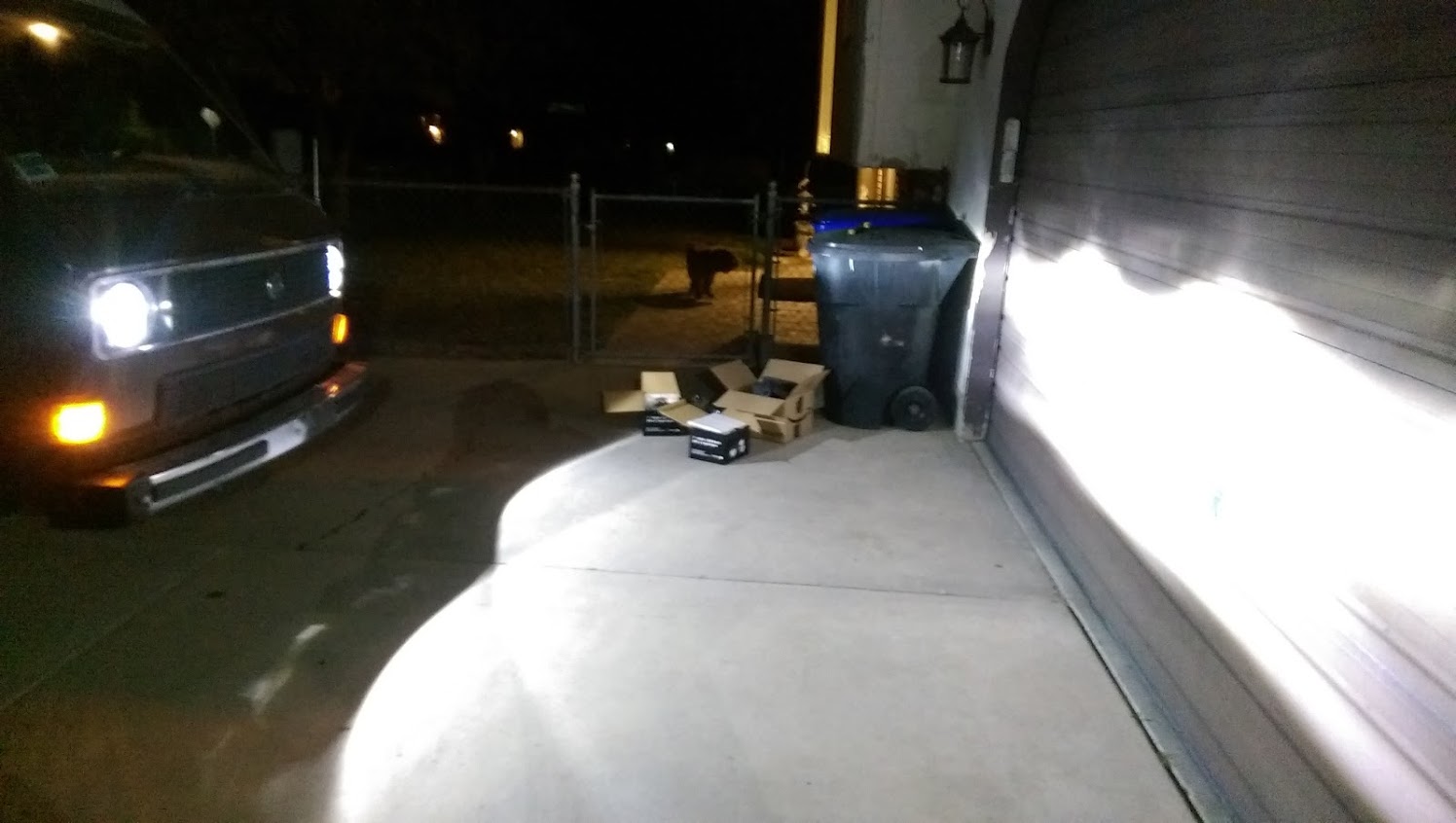

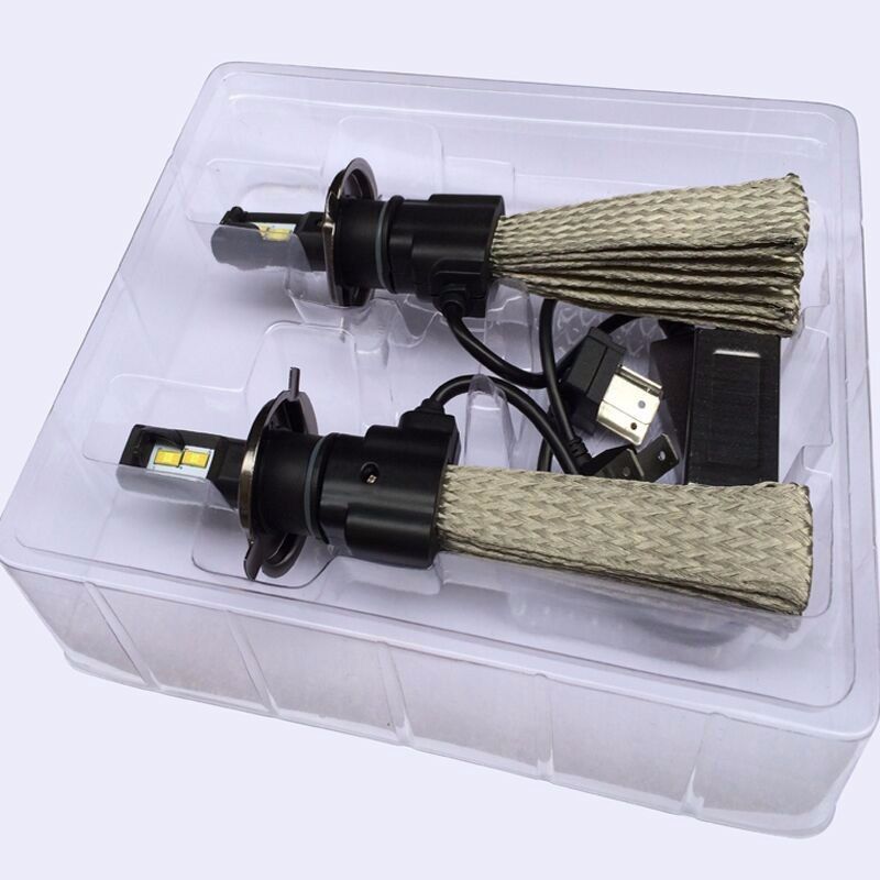

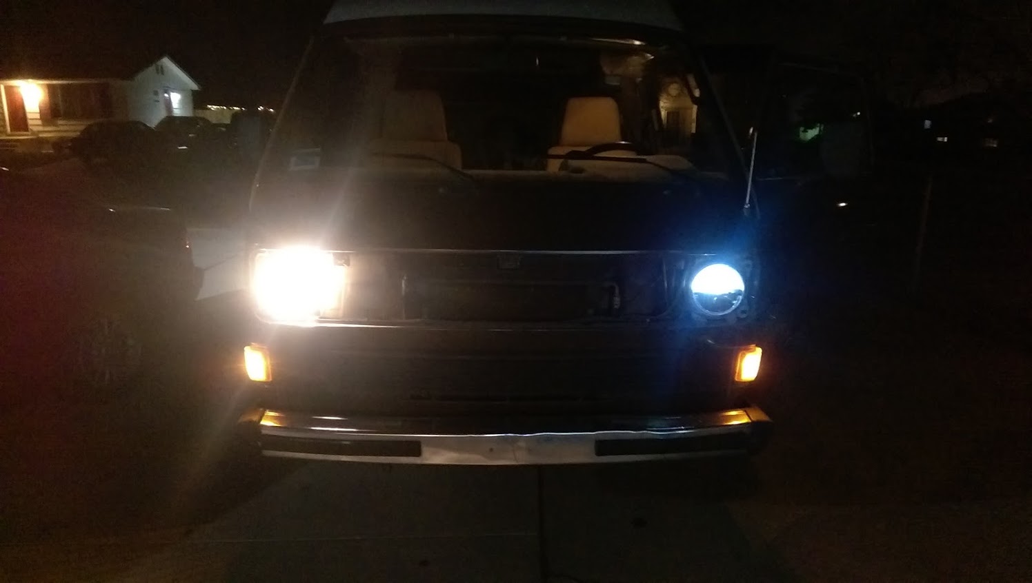

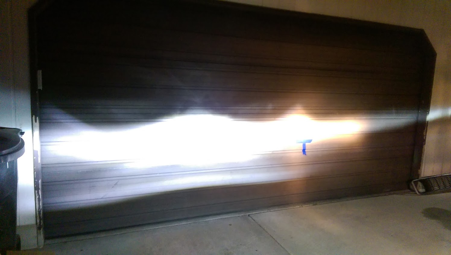

Amazon has a few vendors that sell LED headlights that appear identical to the GE Nighthawks (which themselves are identical to the Trucklite LEDs") for ~140 a pair. I haven't personally tried the nighthawks due to the price, but the sets I got for $140 were worth it. I have them installed on my Vanagon and 2 of my 914s. They make a HUGE difference for night driving and are a "safe" plug and play upgrade as they have less current draw than even stock headlights (something like only 3amp)
Side by side output with LED on the left and stock highbeam on the right. The white light on the far right is actually coming from the LED headlight on the left. One of these casts way more light than a pair of stock bulbs. They made an even lager difference on the 914s, due to the old wiring/voltage drop, the LEDs are pretty much un affected by it. The vans stock headlights were not bad whereas the 914s were near useless.
