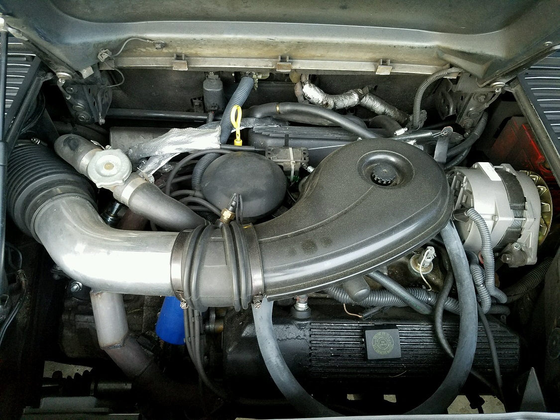

I've seen at least one 914 with a 3.1 (as stated, same as 2.8, 3.4 - non DOHC) and another with a 4.3.
You really butcher up a 914, add a bunch of weight etc. It's not worth it.
Attached picture (yes, after 8 years I still have this thing), the 2.8 is so worthless, I pulled it and tossed in a 4.5 Alum block FI V8. It weighs 45lbs less than the 2.8.
