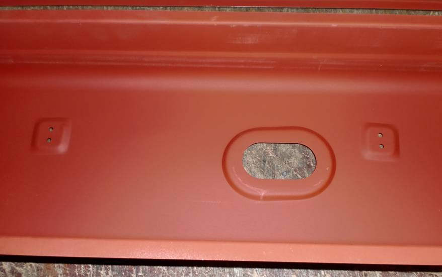

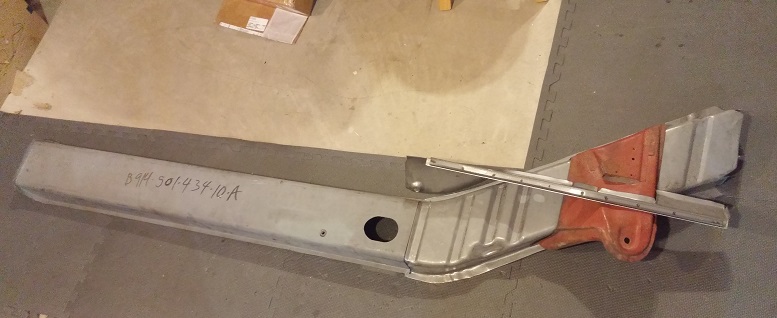

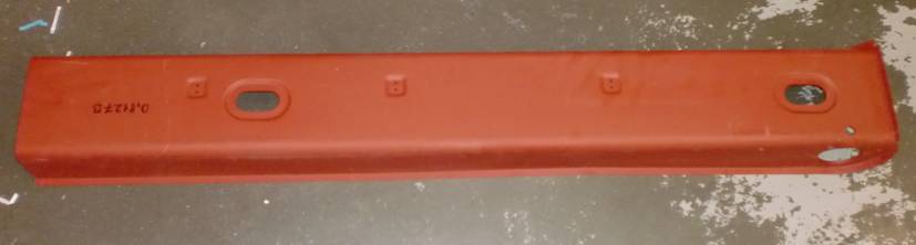

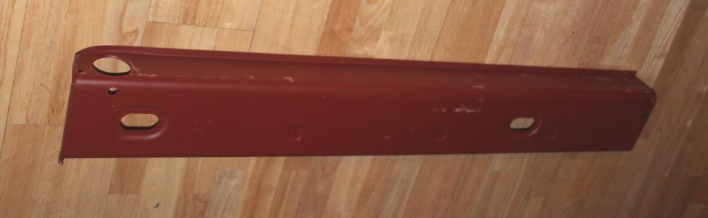

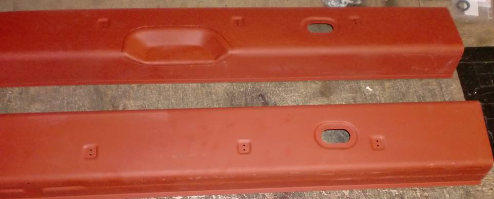

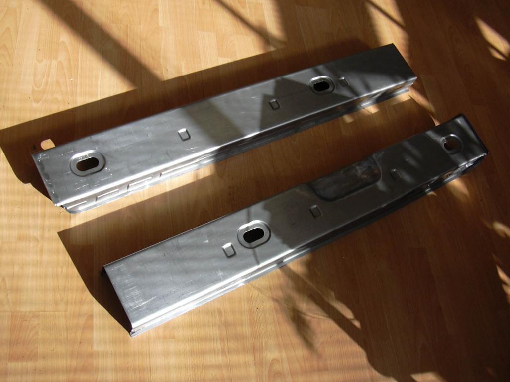

I got the confirmation from MM that the parts are in and ready to ship.
I wanted to make sure the part was correct so I had MM send me a few pics prior to shipping. The part is made by Hersteller Hess and looks correct.
I'm not sure when I'll have it in hand but it'll be on it's way shortly.

Luke is correct. We carry AA passenger side inner long. It does not have the correct impressions like the original.
The one from Hess is pretty nice. Aside from the fact that the depression for the ebrake is welded in after the part is stamped. I dont know why they are doing this, perhaps they were having trouble getting a nice part with that impression in the tooling to begin with.

On a tangent, what's are the oval holes for? Is it for doing maintenance on the heater tubes?
peteyd
post Jun 22 2016, 08:04 AM
Posts: 740
Joined: 27-March 08
From: Elora, Ontario, Canada
Member No.: 8,858
QUOTE(cary @ Jun 22 2016, 04:56 AM) *
So Pete your carrying both the drivers and passenger side longs from Hess ?
Web catalog only shows the drivers side.
We only carry Hess' driver side.
I have no idea what the oval holes purpose is.
