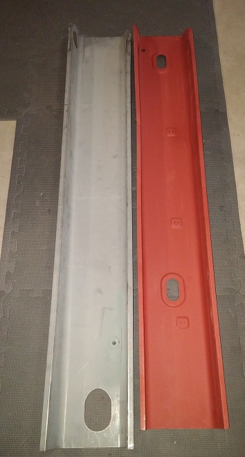

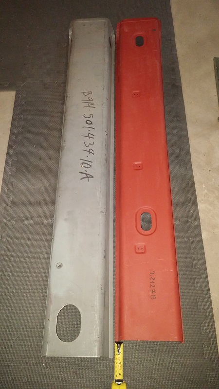

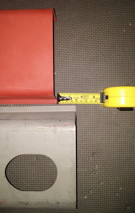

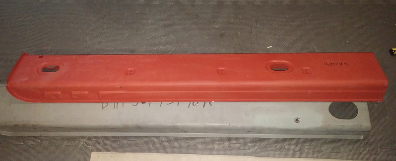

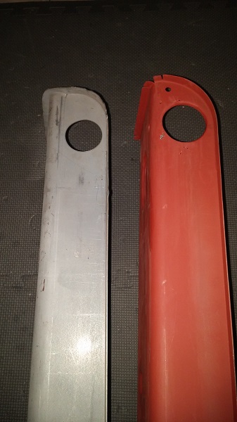

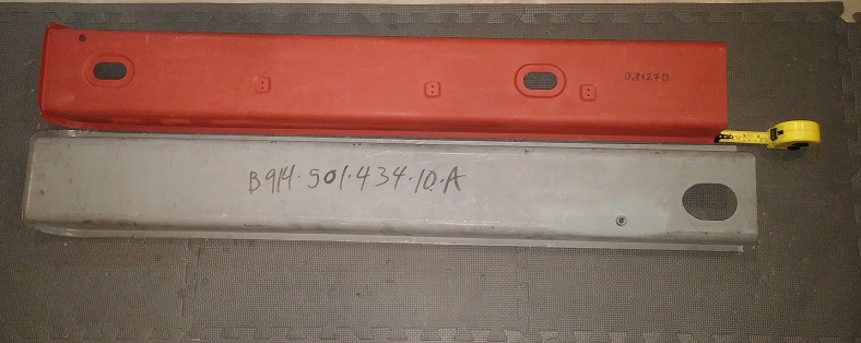

Look at what showed up today. Nicely made part I must say. There's several differences between the AA and the Hess part.

QUOTE(peteyd @ Jun 22 2016, 05:40 AM) *
Aside from the fact that the depression for the ebrake is welded in after the part is stamped. I dont know why they are doing this
The original longs tend to crack at that point, maybe welding in the recess is stronger?

Member No.: 453
is the depth of the long the same?
I wonder why they left off the rear cut out?

All depends on what YOU want. I'm biased. I've used both RD and AA parts on my driver quality build that has been in progress forever.
Factory parts are largely NLA unless you can find someone with NOS parts and have $$ to pay the premium. Would be the way to go for 914/6 concours build IMHO.
RD/AA parts are just fine for driver. However, they lack the OEM details. Doesn't matter for a driver.
If you're OCD and/or concours oriented the Mittlemotor and Hess parts look nice but I'm sort of baffled by the shortness of the part. There isn't a lot of overlap between the engine long inner and the cabin long at that rear edge. Don't know why anyone would go shorter at that end? And then there is the the lack of the oval for the heater tube pass through which you'll have to cutout for yourself. Not a bid deal given the fab work invoved to be doing this work in the first place but that's another lost hour of my time to have to cut it myself. Also seems to be lacking seat belt attachment. Again, not a show stopper but more fab work for the installer.
AA/RD parts are also made with Galvaneal. They ship without primer and don't surface rust easily due to the Galvaneal. Galvaneal can be a bit more difficult to weld but overall it is going to corrode more slowly than plain steel. Based on the presence of red primer on the other parts I'm going to assume they are plain steel and were primed to prevent corrostion.

Having held and inspected both the AA and Hess parts, I would go with the Hess part hands down. There's several issues with the AA part that would need to be addressed. Again up to your fab skills. I found a NOS long for my factory 6 repair. Good luck locating one and if you do be ready to drop $$$$.
