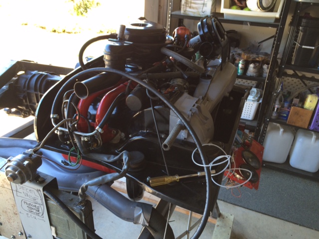

On the run stand:
Everything primed except oil. and the starter won't spin:

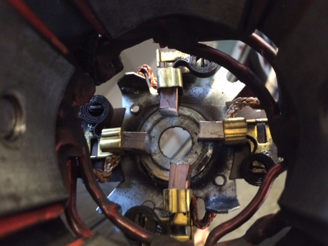

Here are the brushes:

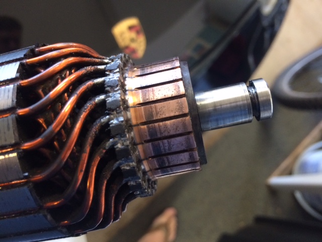

Here is the armature/communicator:

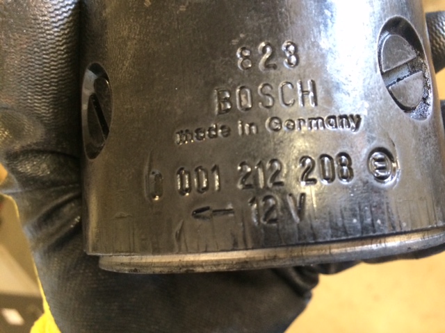

Here is the casing/Bosch part ID:
When the brushes get this worn, will it not spin the armature ?

QUOTE(pgollender @ Jun 19 2016, 07:55 AM) *
All I really want for father's day is to spend a little time with my dad and to start my new motor. (IMG:style_emoticons/default/hissyfit.gif)
Can you just order the brush plate assembly ?
I looked hard for the brush plate assembly. You can find them for many starters, but I failed to find one for the Bosch starter.
