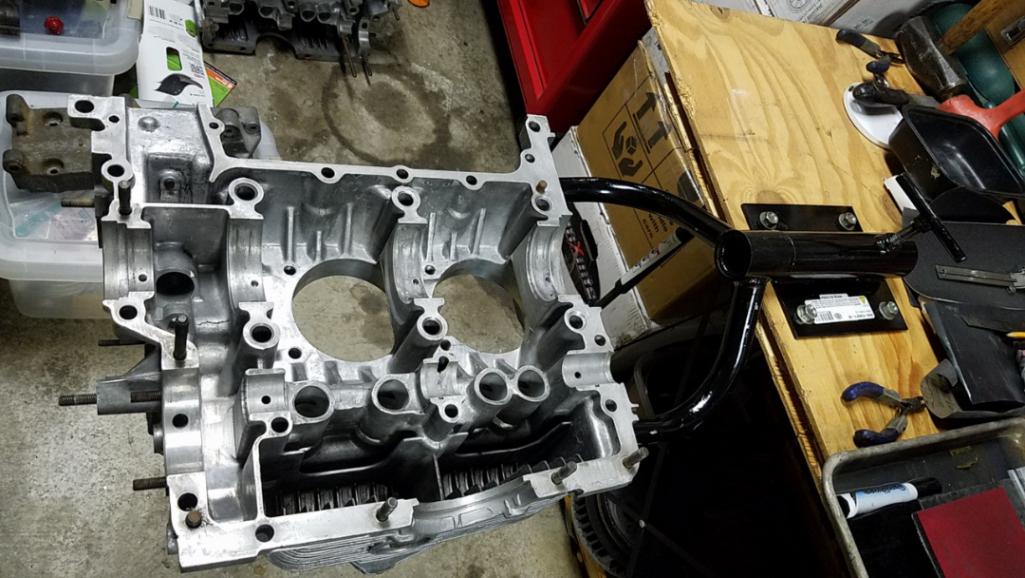

Silly question, I need to buy or make an engine stand yoke/holder for my Type IV, if I make one does it matter which half of the case I mount to the engine stand to start the assembly?

I always install the stand/yoke on the 3-4 (passenger) side of the engine case.

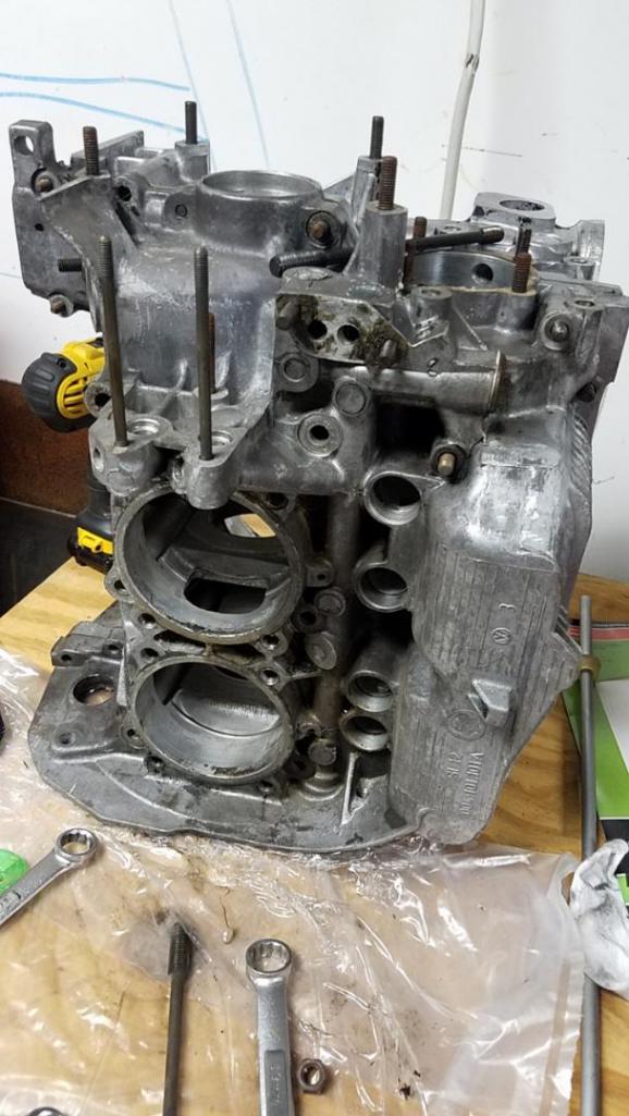

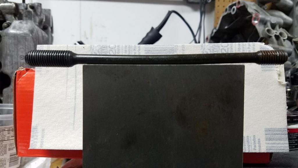

Finally, some work related to my 914...
Removed the main cylinder studs this morning.
Noticed one of the smaller studs is bent pretty good. Will have to source another one.
I plan to clean the engine case one more time, might be a little easier with the studs removed. The other side has a lot more oil caked onto it for some reason.

Dominic was nice enough to send me a straight engine stud and I got my 1.7 rockers with 911 adjusters.
