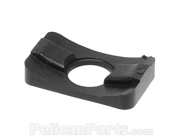

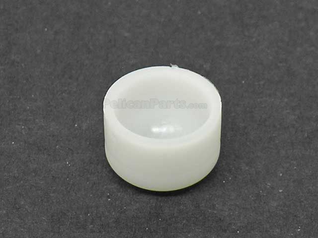

Are these pics the correct pivot bushing and the TO bearing clips?

Those are the parts I mentioned. I forgot the fork retaining plate. #901-116-077-01 OEM. More cheap piece of mind.

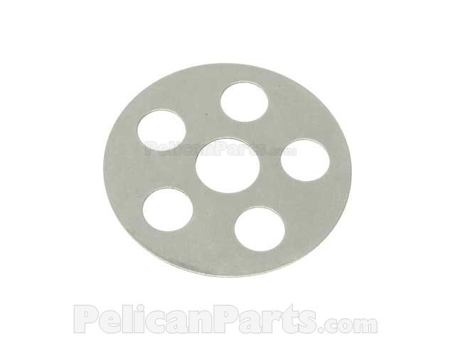

When you mention "crush washer" are you referring to the plate that goes under the flywheel bolts and locks them in place? If not, add that to the list.

This thing, right?

Yep, that's it.
