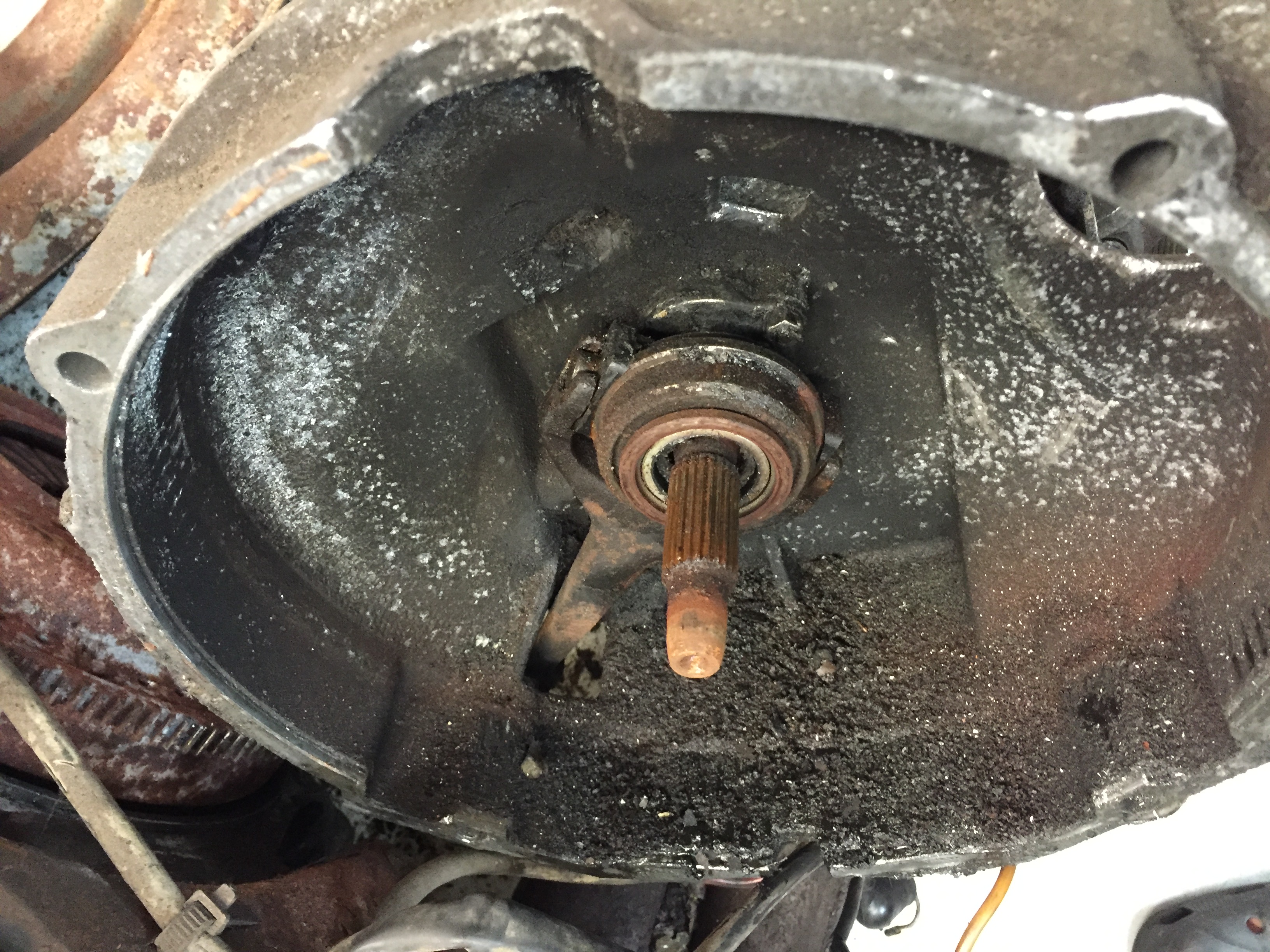

I just did as above, but the engine and trans will not disengage/separate......
Going crazy here.....
Thing is that reason to make thos manouver is due to I think that the flywheel is rusted to the engine (is it even possible?).
When I put a gear in, the wheels can turn with no problem.
When I try to start the car, the starter cant turn the engine, when I take off the starter it works excellent.
And now I cant separate them two....
Tired... (IMG:style_emoticons/default/unsure.gif)

Try to actuate the clutch. The Throw out bearing will try to separate the trans from the engine

Ok, you cant turn the engine, but can you rotate the trans?
If you can turn the trans, you can try to remove the clutch pressure plate bolts from the flywheel by reaching through the starter hole.
The driveshaft splines must be rusted (fused) into the clutch disk
Is it a tail shift? I would (myself) rather destroy an engine to save a sideshift, but a tail shift is mostly disposable.
Even if you have to destroy the case to get it loose, the internals might be worth something (not if it was submerged for years though)

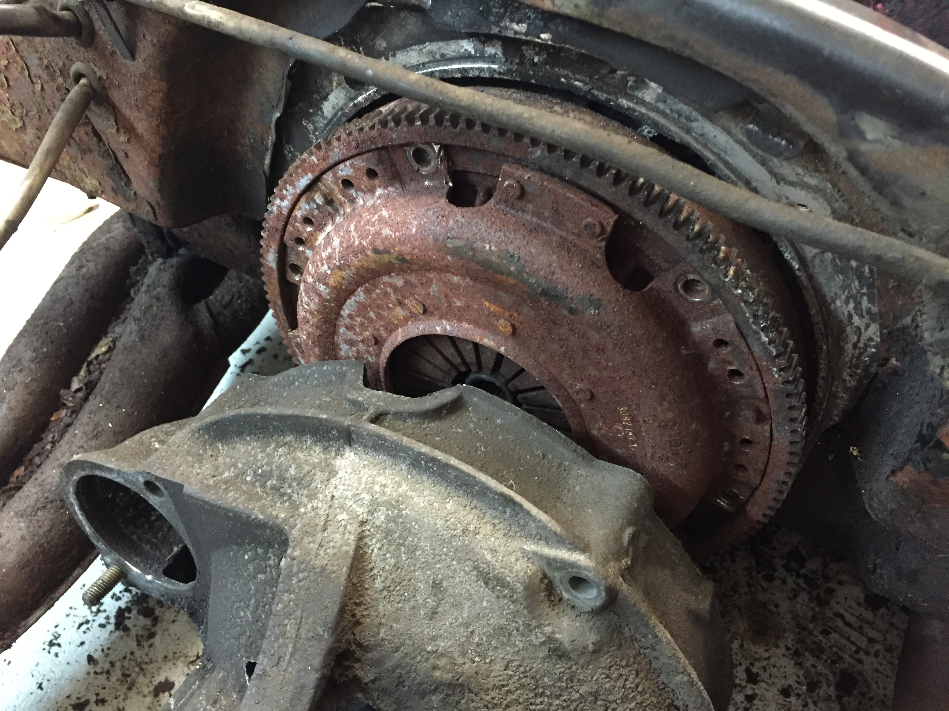

Update:
When I put in any gear the driveshafts just turns around just like there is no gear in place.
This makes me believe that the clutch is corroded in "engaged" position, correct assumption?
I can with a big hammer turn the flywheel so I can reach every 13mm nut through the starter hole. Should I remove these 13 mm nuts?

QUOTE(mitche @ Aug 6 2016, 07:28 AM) *
I dont understand that you can turn the FW with a big hammer...
What is stopping you from just leaving the engine stationary (and the FW) and just twisting the trans while it is stuck to the back of the engine?
Cant you just rotate the trans case to reach all the Clutch plate bolts?
If the clutch is engaged (stuck even) and the driveshaft is stuck into the clutch disk, and all 4 bolts are out, what is stopping you from just twisting the trans while it is still attached? (unless the trans driveshaft is frozen too?)
I dont recall any large pins in the trans mating surface that protrude into the engine case.

Well the bottom two bolts are studs (correct word) so I cannot twist the whole transmission.
Now the 6 bolts from the flywheel are out, and I am going to try to separate the two of them.

QUOTE(mitche @ Aug 6 2016, 11:16 AM) *
QUOTE(stugray @ Aug 6 2016, 11:01 AM) *
Wish me luck
For those interested, I finally succeeded!
It was the axle from the gearbox going inside the engine (lost the word...) that was corroded.
So, how to move along and remove the flywheel?
Mike
