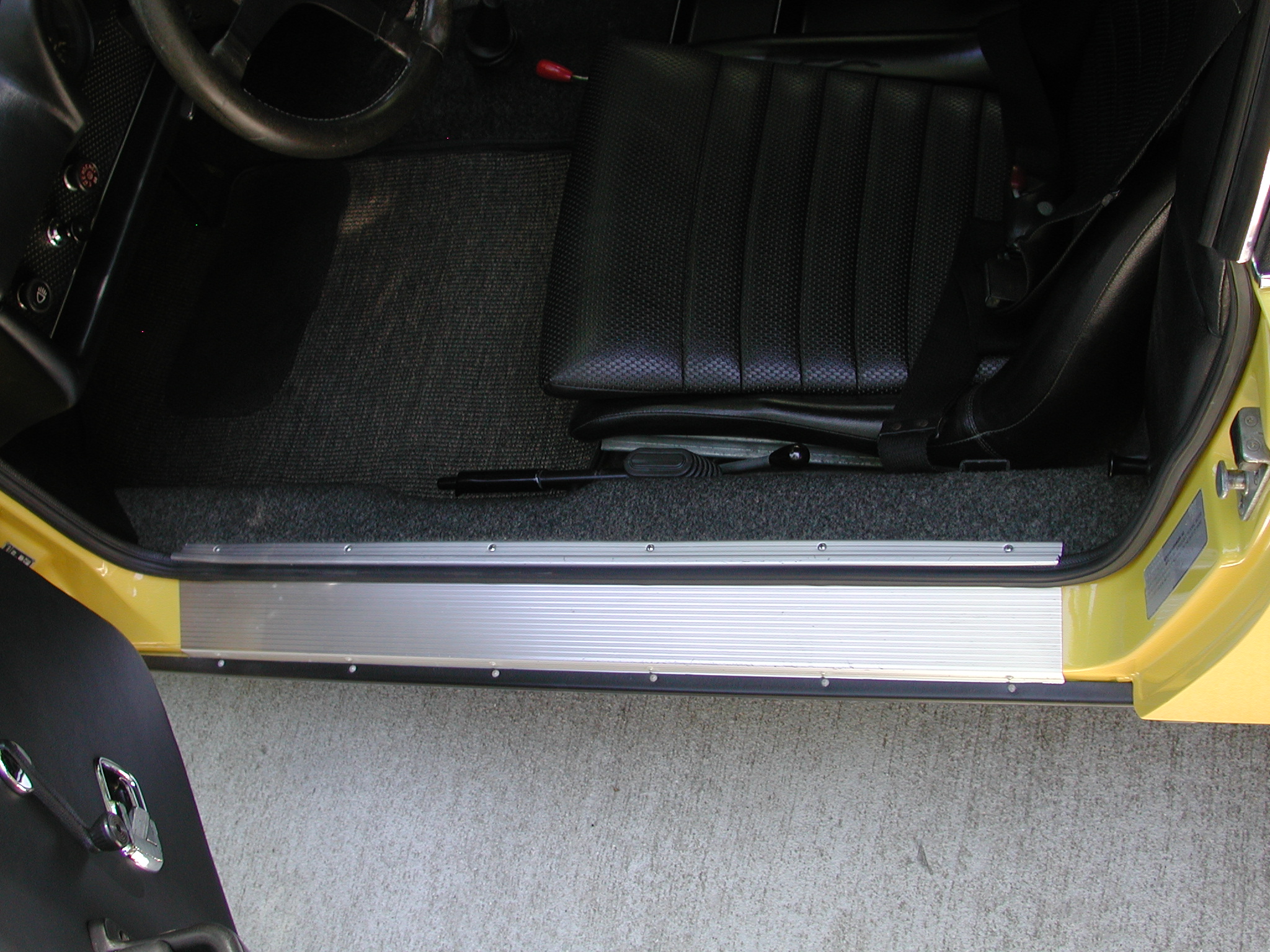

Screws or rivets to hold the exterior Threshold Sill Plates ?

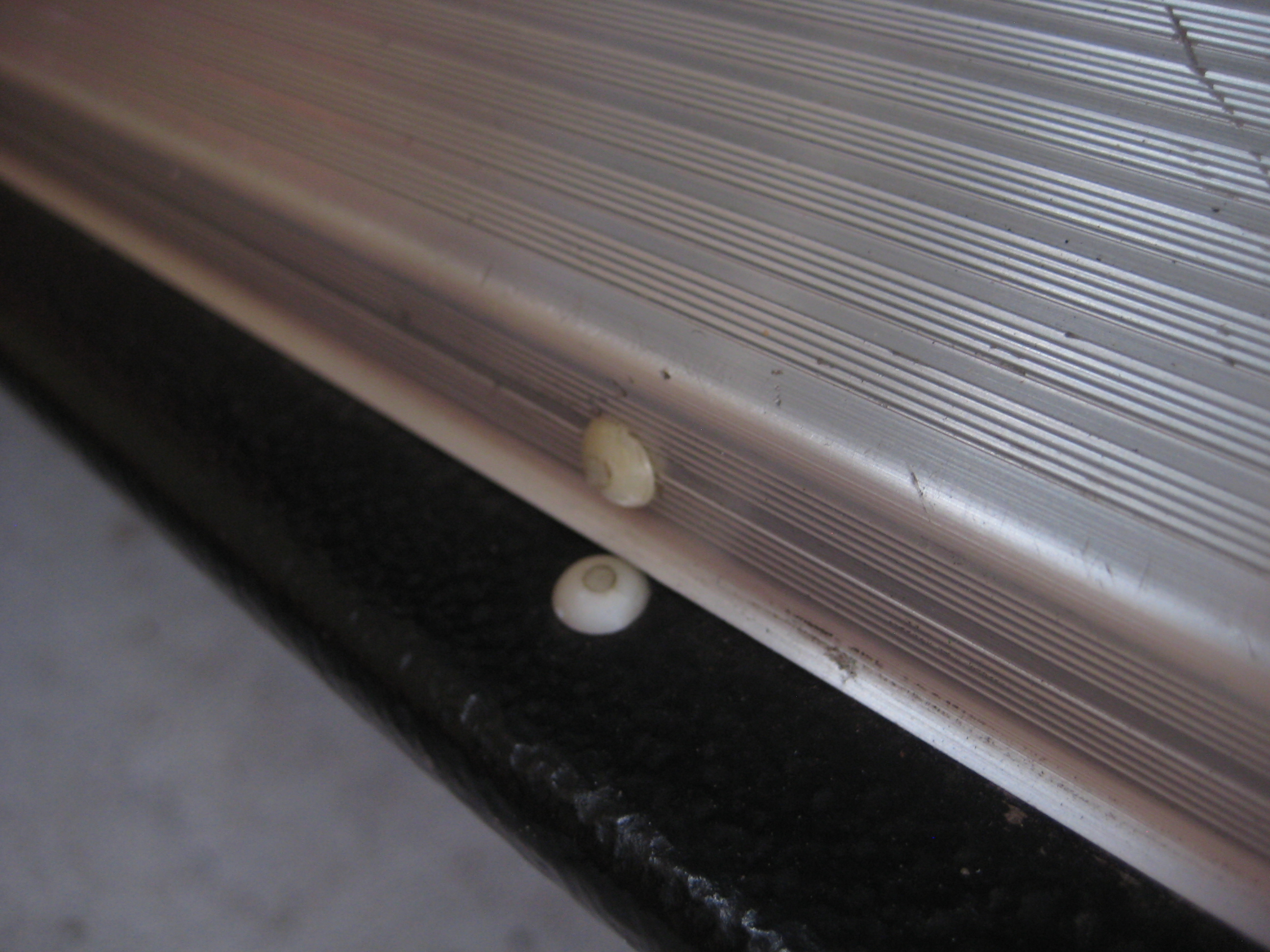

White (natural) push pin plastic rivets.

The white ones are long NLA, & a member on here used to sell aftermarket white ones which were a match, but his source dried up.
You can still get clear from Porsche & other sources as the next best match, unless you find a new source for the white plastic ones.
If you do find a source for white ones, then please do a FYI post in the Garage forum for members on here with 70-73 914s with the aluminum sill plates (74-76 they went with black plastic sill plates & used the black plastic rivets).

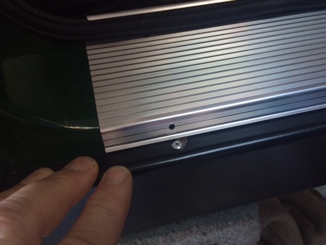

BTW - A lot of folks on here say that they also used the black plastic rivets on the rocker panels in your pic - although yours, my 2nd owner since 75 `73, & my OO buddies' 71, & a few others which have the original rockers are/were the metal rivets you show - so I'm not so sure that the plastic rivets at the rockers is correct.

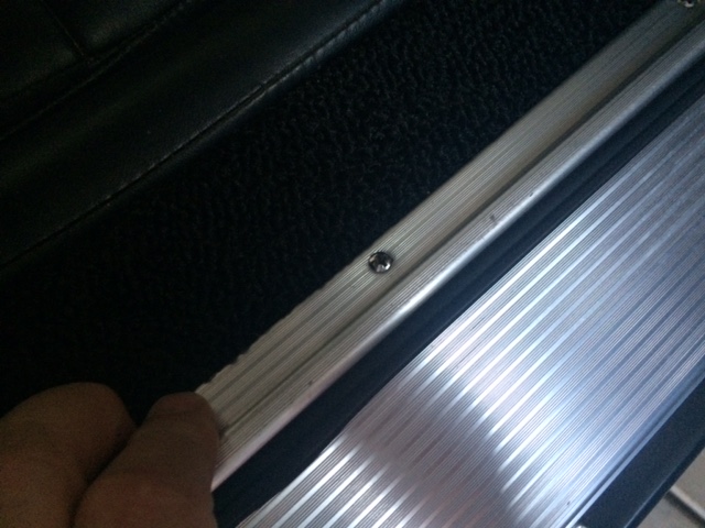

Ah....... $54. for 36 plastic rivets ?
Come with lube ?
No too sure about metal rivets.
I am sure of natural color nylon plastic push pin rivets (early) with alum. thresholds. Then changed color to black to go with black thresholds.
To me ? pop rivets look suspicious.

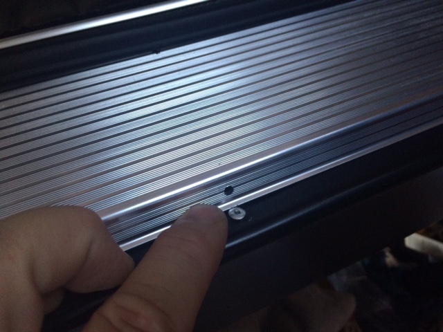

Metal rivets = incorrect

Hi guys. Regarding the outer rocker covers, I have seen metal rivets on 73+ original untampered with cars. I've had 4 low mileage original cars that all had metal rivets on the outer covers. Most of those cars I got from the original owners and discussed that matter with them.
I have also seen one owner late model cars (75-76) with metal rivets on the out rocker covers, other than my own. By rocker cover, I mean the piece that is painted black so there is no confusion. I discussed it with the owners, and their responses were that they never took the covers off, and that's the way the car was delivered to them.
You'll see a lot of those rivets with black paint on them due to a prior owner respraying the rocker without removing them. My light ivory 75 with 42,000 miles was like that. I ended up taking the covers off due to a bad jack point on that car. I replaced the metal with black plastic so I could easily take the covers off when needed. Actually I shaved the pins and stems so the rivet was only attached to the outer cover and not to the physical body of the car. The bottom hardware was enough to keep it secure.
With that said, I would say 73+ metal rivets for the out rocker covers. Black Plastic rivets on the later cars would certainly make it easier to maintain/clean under there. I would strongly advice against using sheet metal screws. You will deform the metal on the sill and widen the holes.

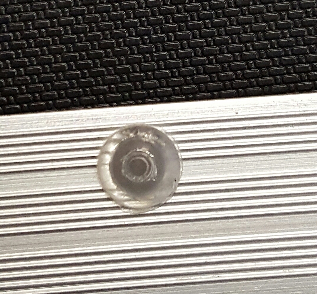

I did make the clear rivets .35 each if you buy all 28 or .50 each.
