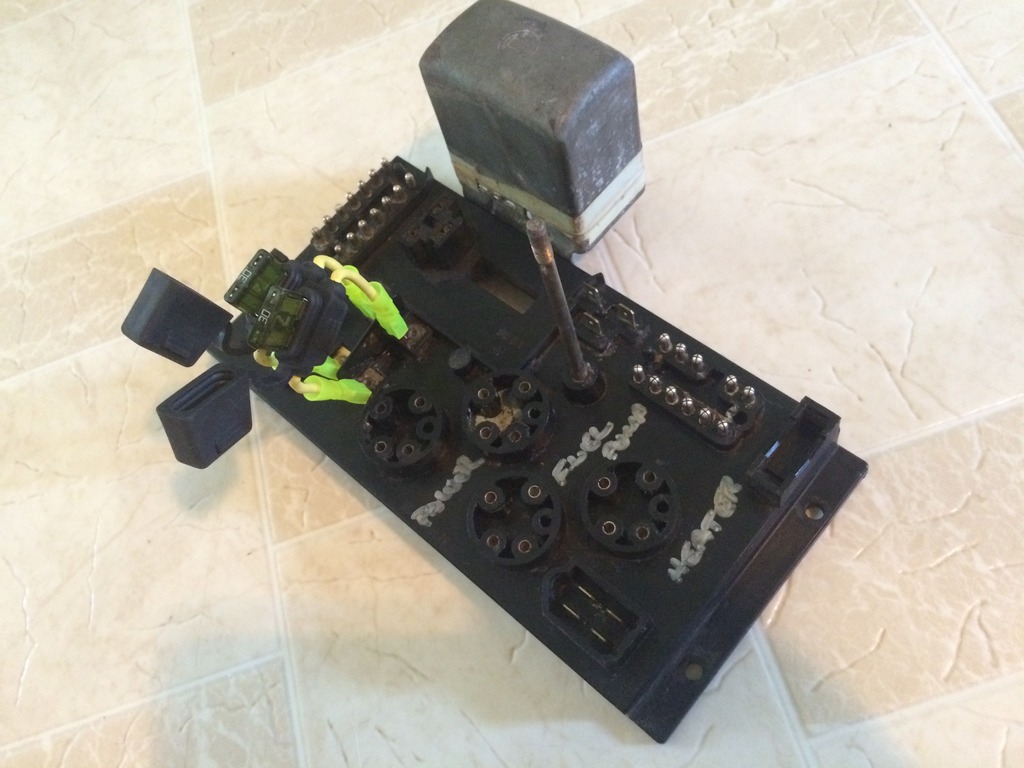

Clean connections and dielectric grease
All of these connections are 40 years old. Any loose or dirty connection causes heat from resistance. I removed all plugs, cleaned all terminals, used pipe cleaners on plugs harnesses, and used dielectric grease on everything.
Remote Locate Voltage Regulator
I moved relocated the voltage regulator. Given the harness plug is exactly the same and plugs right into the VR, I don't know why Porsche decided to run that current through the relay plate. Maybe just ease of production and mounting? Regardless, mine is no longer mounted in the stock location; easiest way was to flip it around so it was off the board and plugging the harness straight into the VR itself. You can tie-wrap it if you think the harness might vibrate off.
A solid state relay is in my near future, too.
Relocate fuses
I've never been a fan of those old ceramic (now plastic) fuses. Many a time in this car and its VW air-cooled predecessors I've had to spin the fuses to get them to re-engage with the rest of reality. That resistance is, no doubt, causing heat. So I bought a couple of ATC fuse holders from NAPA and used some female push-on connectors to replace those old fuses.
I had to trim the fuse holder blades slightly with shears to fit inside the standard female connector, just a touch each side, and those old fuses can still be installed.
Better yet, it still fits within the standard relay plate cover.
Ignore the double 30A fuses in there, it's for the photo only. I'll get the right ones for installation (8A and 25A, right?)
Let's see if we can make this guy last a bit longer.
Greg
(IMG:http://www.914world.com/bbs2/uploads_offsite/i1201.photobucket.com-15565-1471706817.1.jpg)

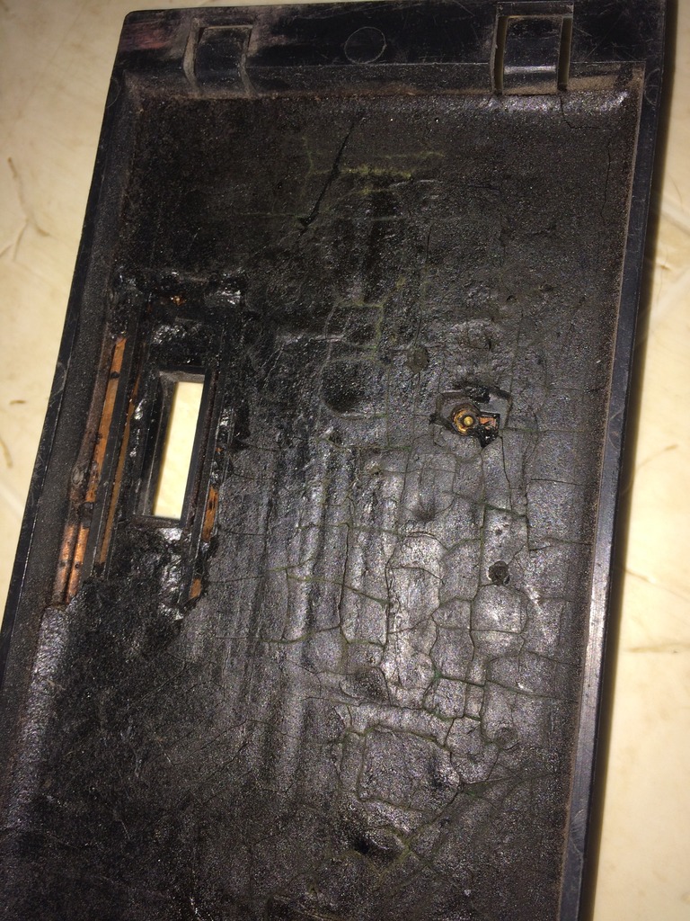

Below is a photo of mine after the swap; not so surprisingly, failures below the VR and fuel pump fuse.
Still fighting an intermittent connection from T14-14 to the fuel pump fuse, the power for the fuel pump. I don't think the problem was there before, because the blower uses the same power source and I did not have a problem with it (I used the blower motor as a test for power, and it always worked). So I either have a bad replacement board, or there's just a gimpy connection or terminal in the wiring harness. It's running now, so I'll get it sorted.
Thanks!
(IMG:http://www.914world.com/bbs2/uploads_offsite/i1201.photobucket.com-15565-1471711690.1.jpg)

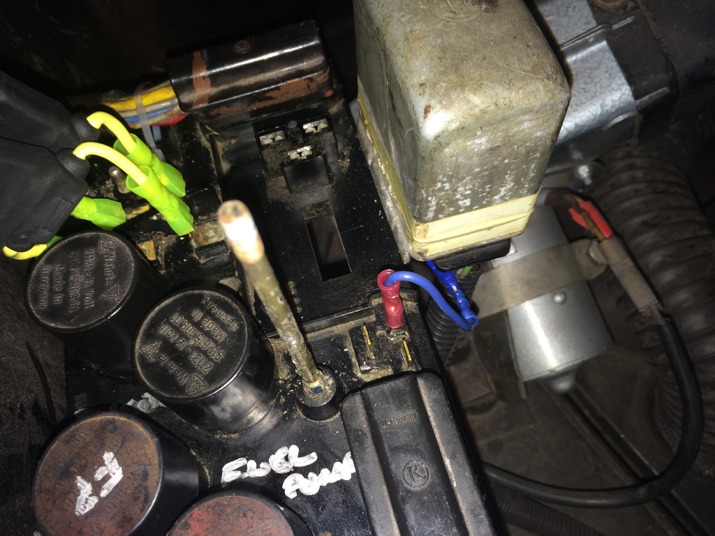

Don't forget the connection to the warning light is thru the relay board
GregAmy
post Aug 20 2016, 12:59 PM
Posts: 2,508
Joined: 22-February 13
From: Middletown CT
Member No.: 15,565
QUOTE(ejm @ Aug 20 2016, 02:32 PM) *
Ok, that's something I hadn't realized. I see it now on the wiring diagrams: T14-2 goes to one side of the light.
I'm running a voltmeter in the center console and the GEN light fails off, so I'm OK. But for others that aren't you can piggyback a jumper from the red wire on the harness to the D+ pin on either board plug, the one on the upper right of the triangle (where the red wire plugged in). That will connect through the trace to the T14 wiring harness and your GEN light will continue to work.
EDIT: A bit inelegant, but GEN light is working again.
(IMG:http://www.914world.com/bbs2/uploads_offsite/i1201.photobucket.com-15565-1471729978.1.jpg)
