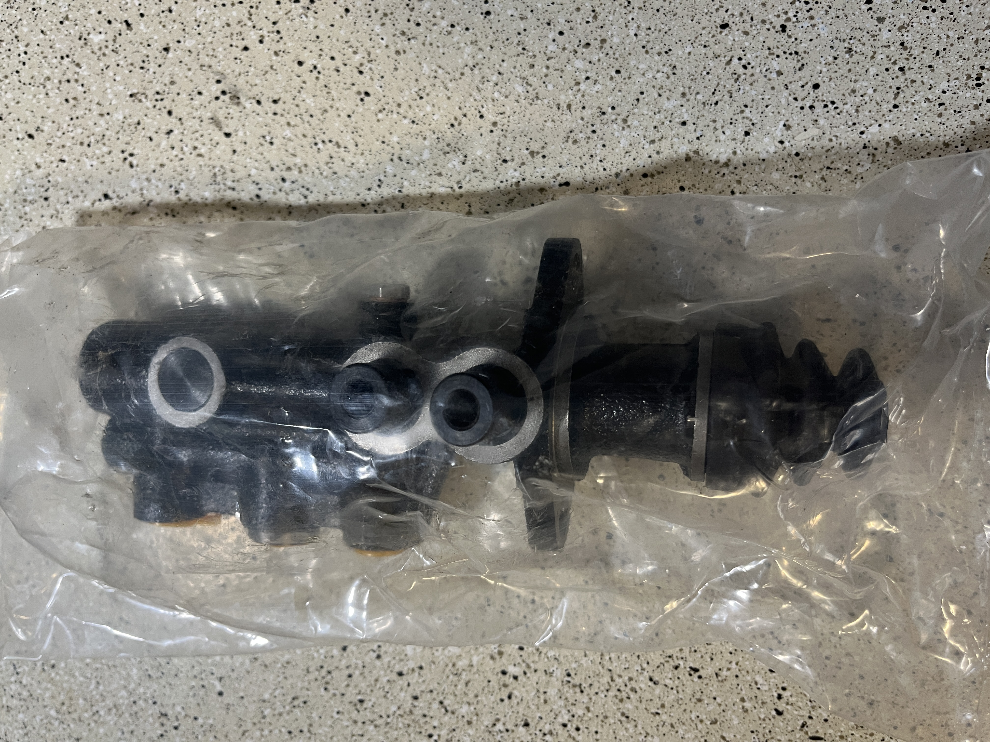

Kemo   im bringing up this old thread because im having a...   Jun 13 2026, 01:02 PM
emerygt350   im bringing up this old thread because im having ...   Jun 13 2026, 01:15 PM
emerygt350   And to answer the 10 year old question... Here yo...   Jun 13 2026, 01:19 PM
Kemo   thanks for the response...my car has the same 2 po...   Jun 13 2026, 05:24 PM
DeanBob   So I am piling onto this long-in-tooth post with a...   Aug 7 2026, 11:16 PM
emerygt350   Not to suggest a MC but I am using the 19mm from p...   Aug 8 2026, 06:34 AM
914Sixer   I have NEW German made 17mm master cylinders. ...   Aug 8 2026, 06:35 AM
