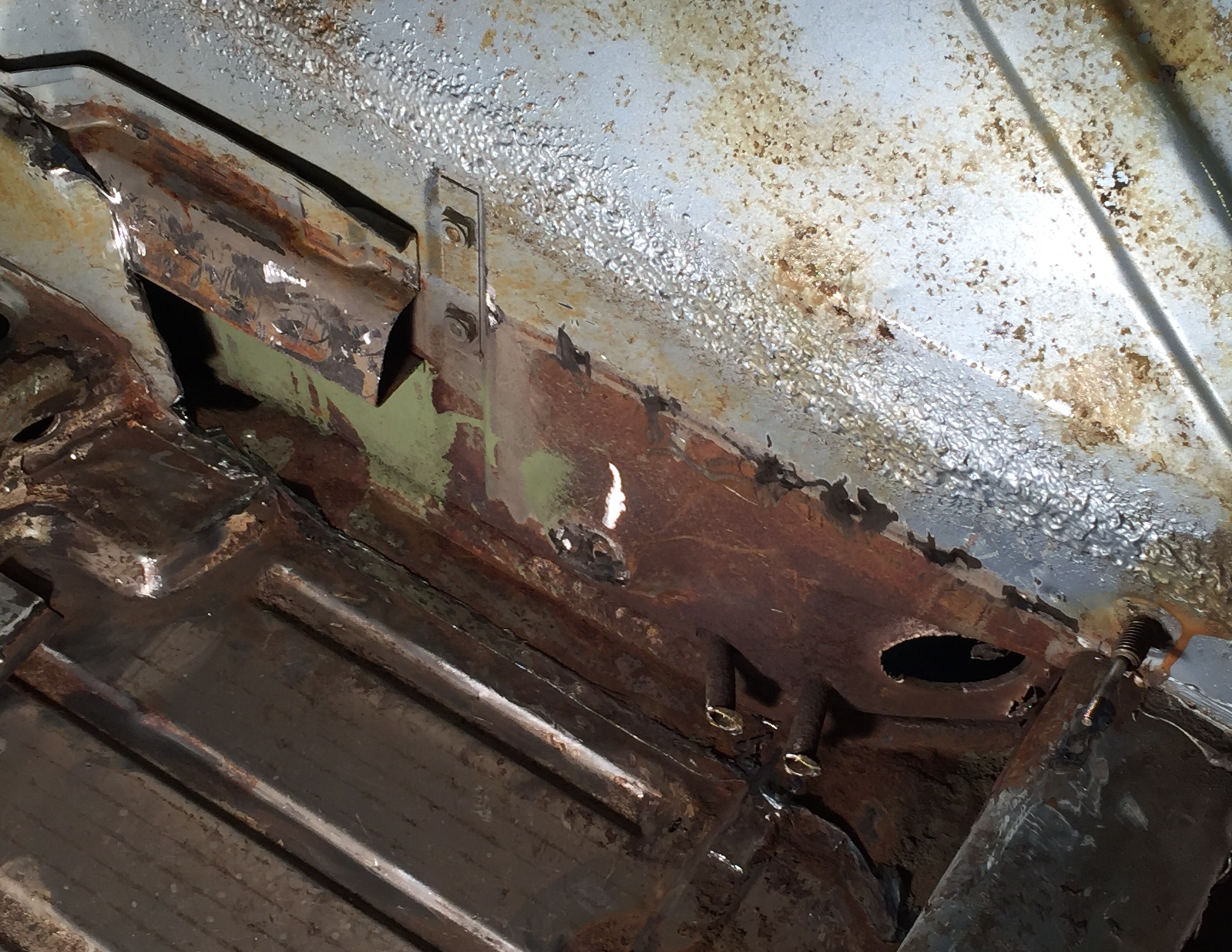

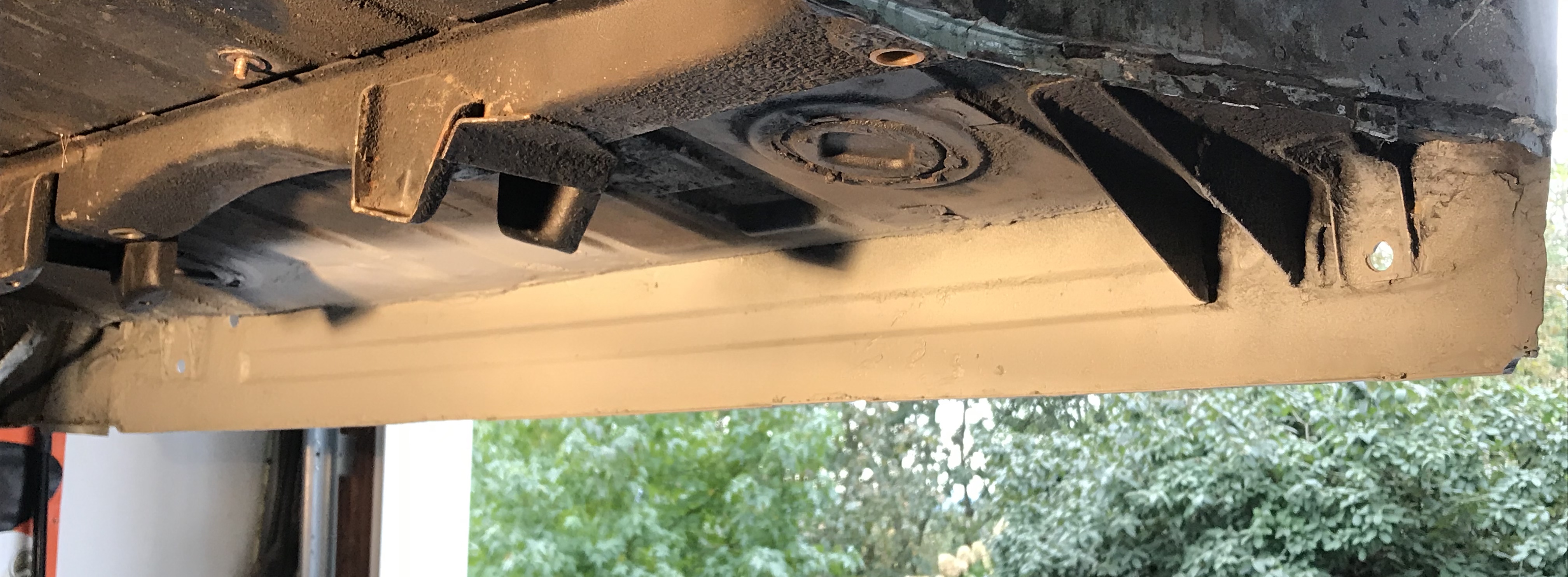

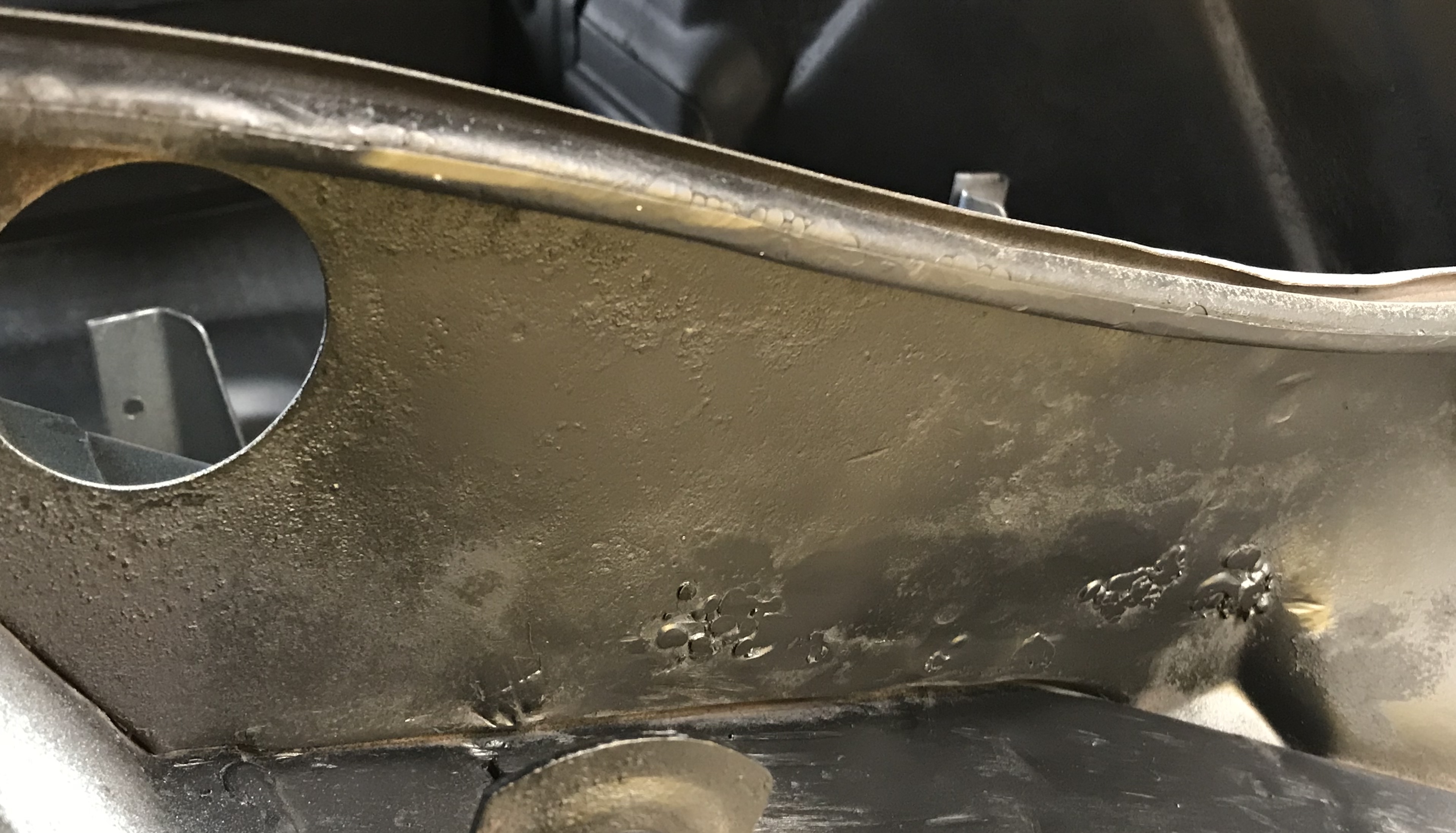

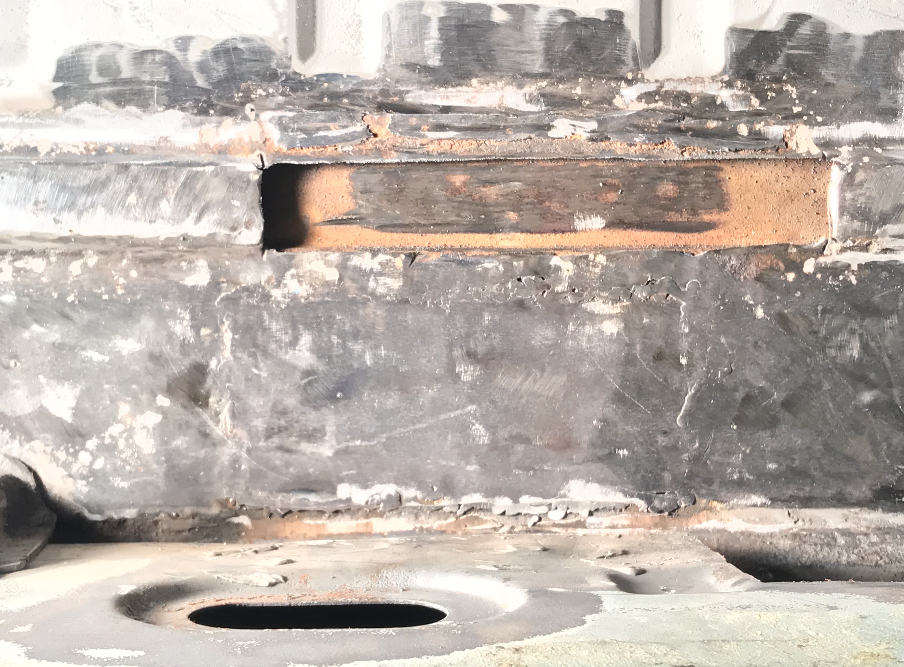

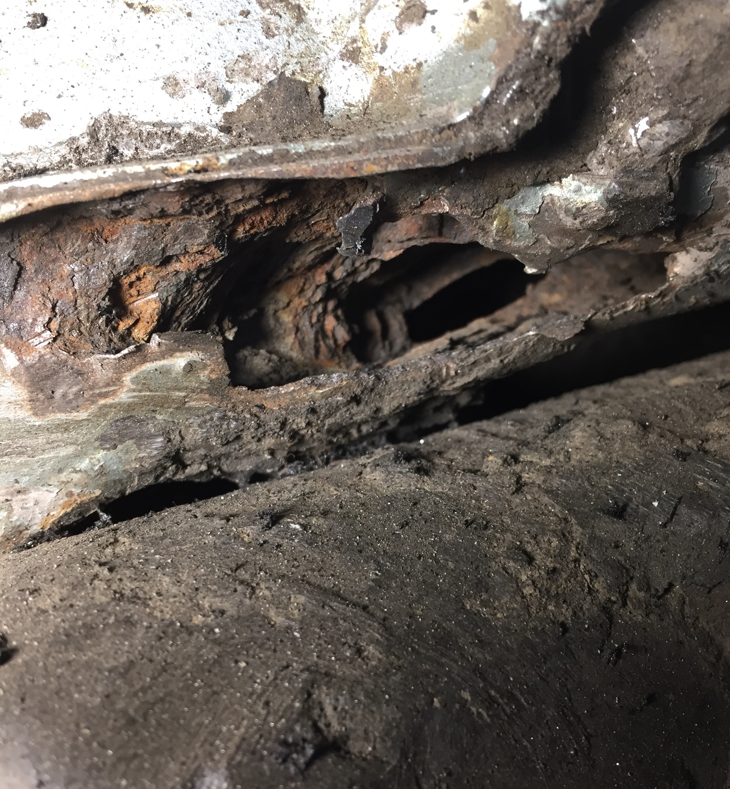

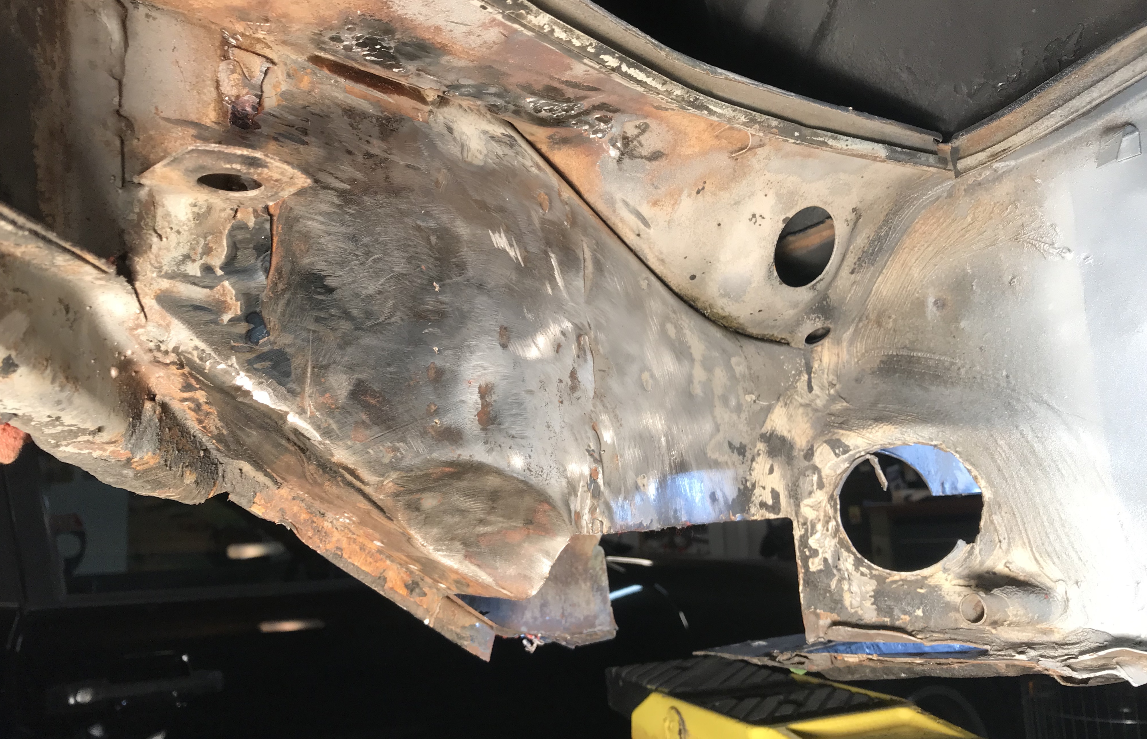

Well I've started the process of preparing for
my 2056 GT to 2.4L six "rallye tribute" auto.
Tearing into the interior I discovered some rust mites have been eating for a while.
Doesn't look too extensive but will be probing some more. The exterior left long was
patched a long time ago, albeit incorrectly. This was done by shop
that wasn't fully up to speed on these cars and I was still a novice, well
still am. I'll be doing some exploratory surgery on this left side inside and out. So I'll get this addressed before any engine install takes place. Would like to
have it buttoned up for Hershey 2017. Wish me luck.

Dion   E brake area top: Exterior long near door sill bot...   Sep 9 2016, 10:28 AM
mepstein   Doesn't look bad. Grab a multi tool and get ri...   Sep 9 2016, 11:16 AM
914dave   Doesn't look bad. Grab a multi tool and get r...   Sep 9 2016, 11:47 AM
rgalla9146   Doesn't look bad. Grab a multi tool and get ...   Sep 9 2016, 12:25 PM
mepstein   [quote name='914dave' post='2396059' date='Sep 9 ...   Sep 9 2016, 12:32 PM
Dion   I intend to Mark. As always Dave has my back! ...   Sep 9 2016, 12:16 PM
Dion   At what point do I go to Earl Schreib & Zeibar...   Sep 9 2016, 12:49 PM
914dave   Right after the foil. If you want it proper.   Sep 9 2016, 01:10 PM
mepstein   All you need to do a pro repair- no metal work...   Sep 9 2016, 01:43 PM
Dion   I knew this club would payoff in its wealth of kno...   Sep 9 2016, 02:54 PM
flippa   It's a VW. The proper method is to steal som...   Sep 9 2016, 04:22 PM
wndsnd   It's a VW. The proper method is to steal so...   Sep 9 2016, 05:23 PM
bretth   What, no pop rivets? :huh: Yeah one pop rivet o...   Sep 9 2016, 05:14 PM
Dion   You guys are great. This is gonna be fun. :beer3:   Sep 9 2016, 05:30 PM
jmitro   looks like you got a little work to do. Good luck...   Sep 9 2016, 07:56 PM
rgalla9146   Paint it Red. Very important.   Sep 10 2016, 03:25 AM
cary   The problem your going to run into is the degradat...   Sep 10 2016, 08:10 AM
Dion   Hey Cary, The jack point was completely cut out....   Sep 10 2016, 10:25 AM

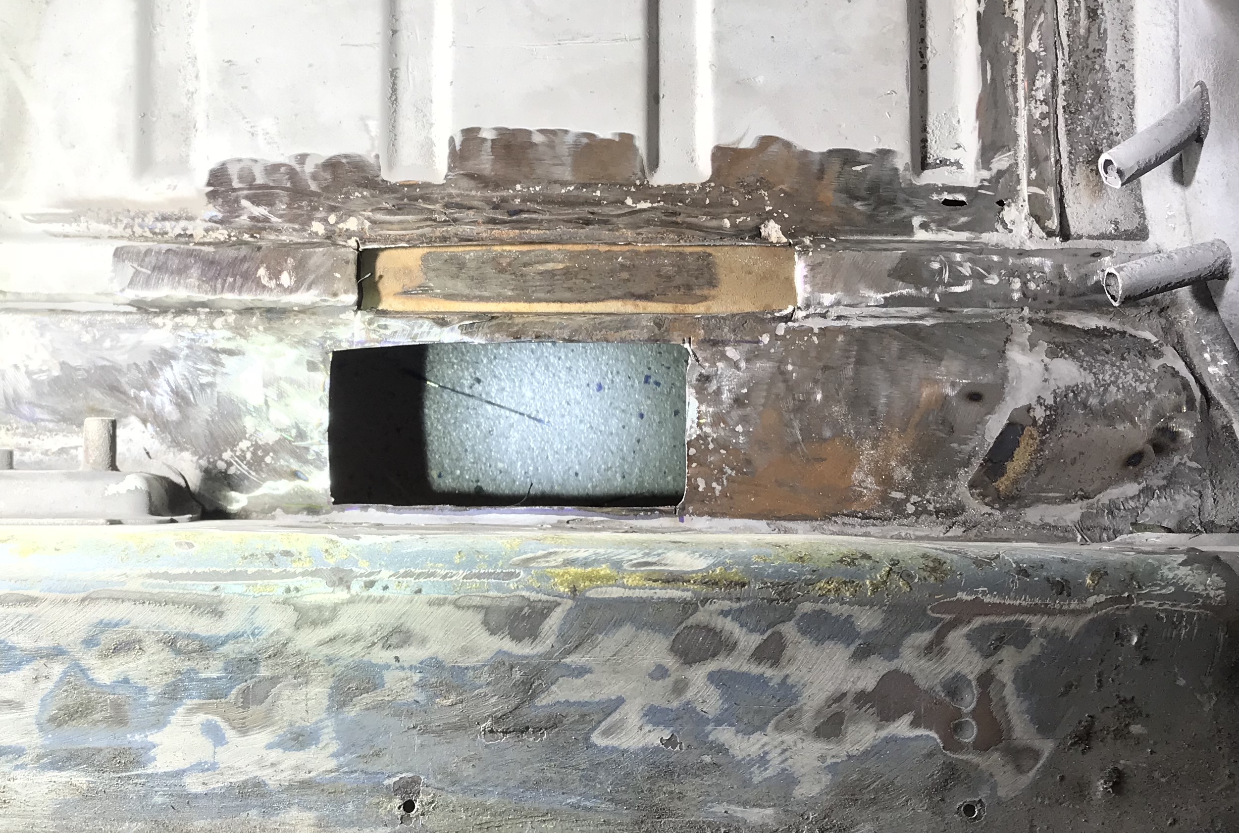

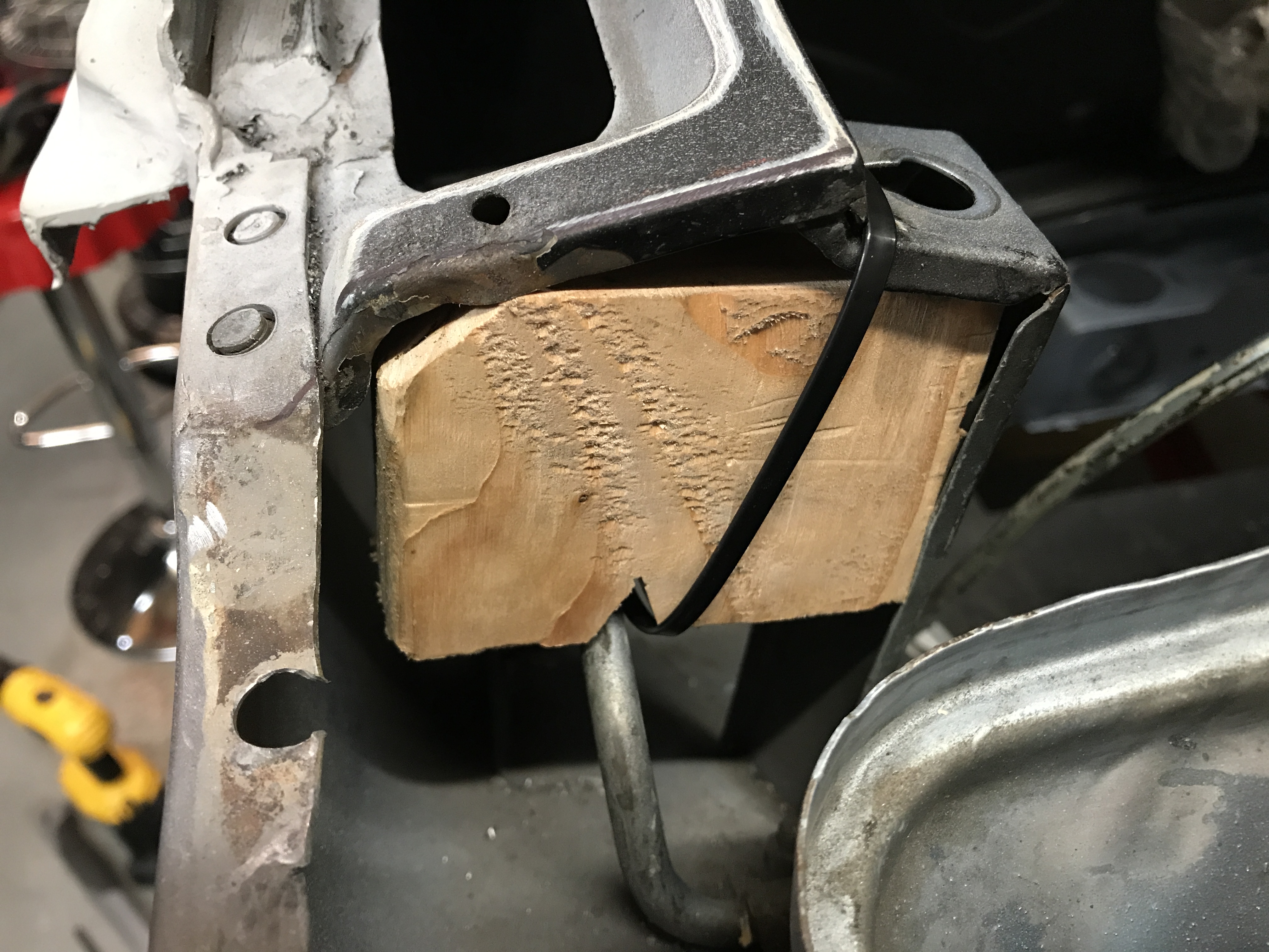

Dion   Ok, tar all scraped out. Door braces in place. Tim...   Oct 2 2016, 05:27 PM

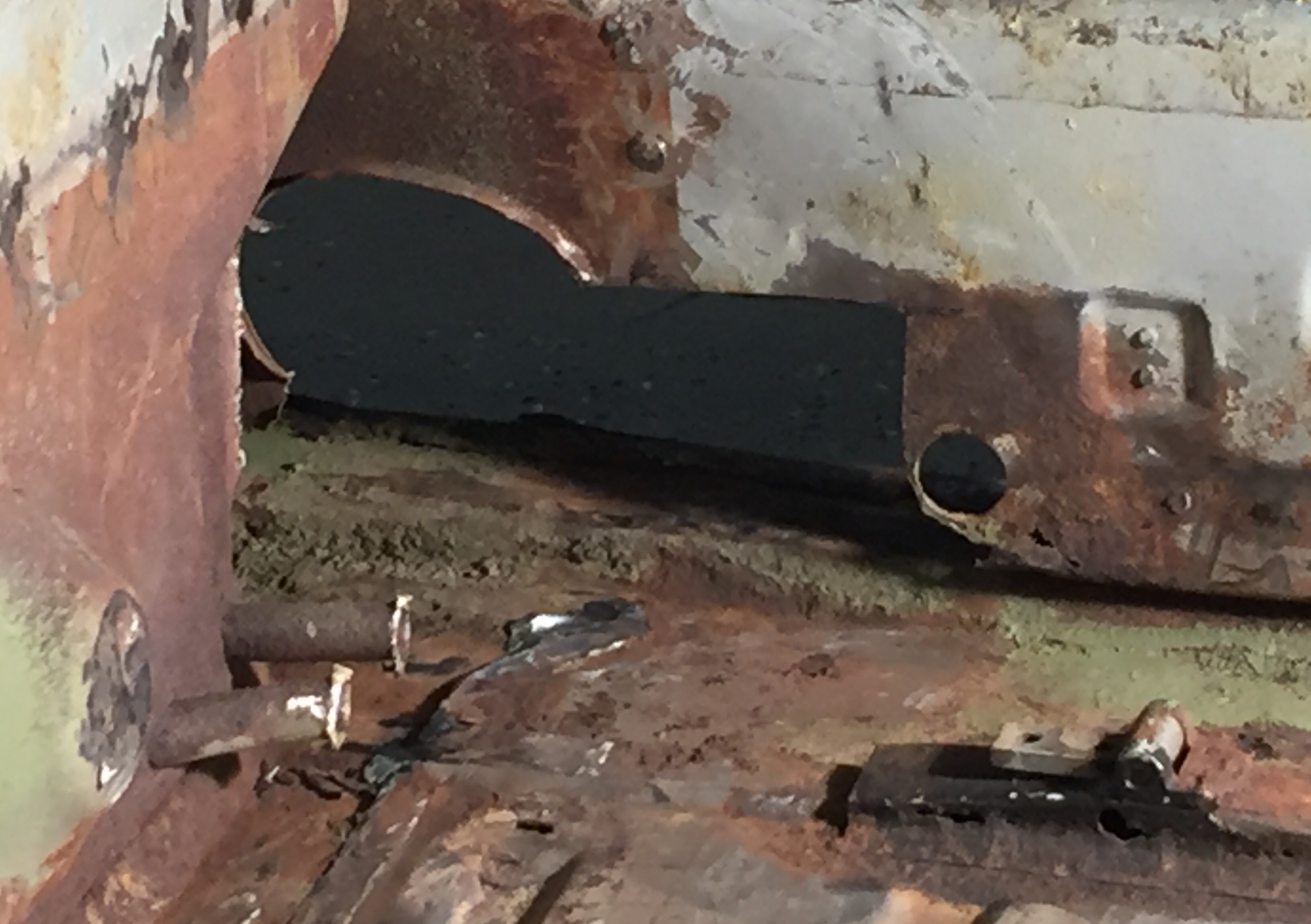

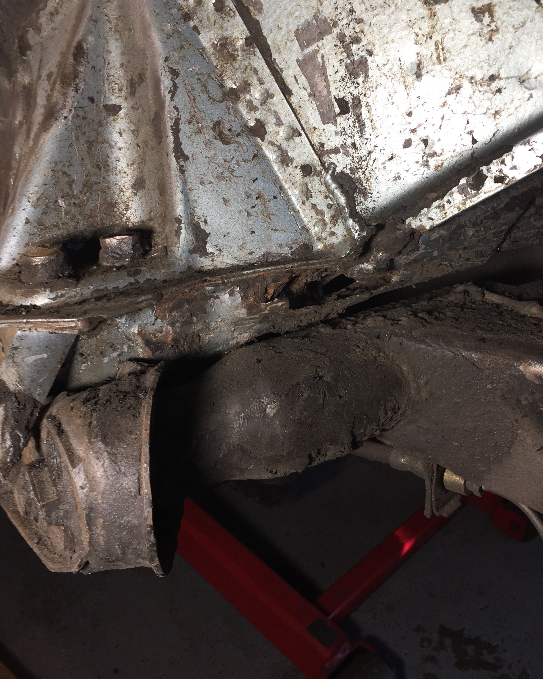

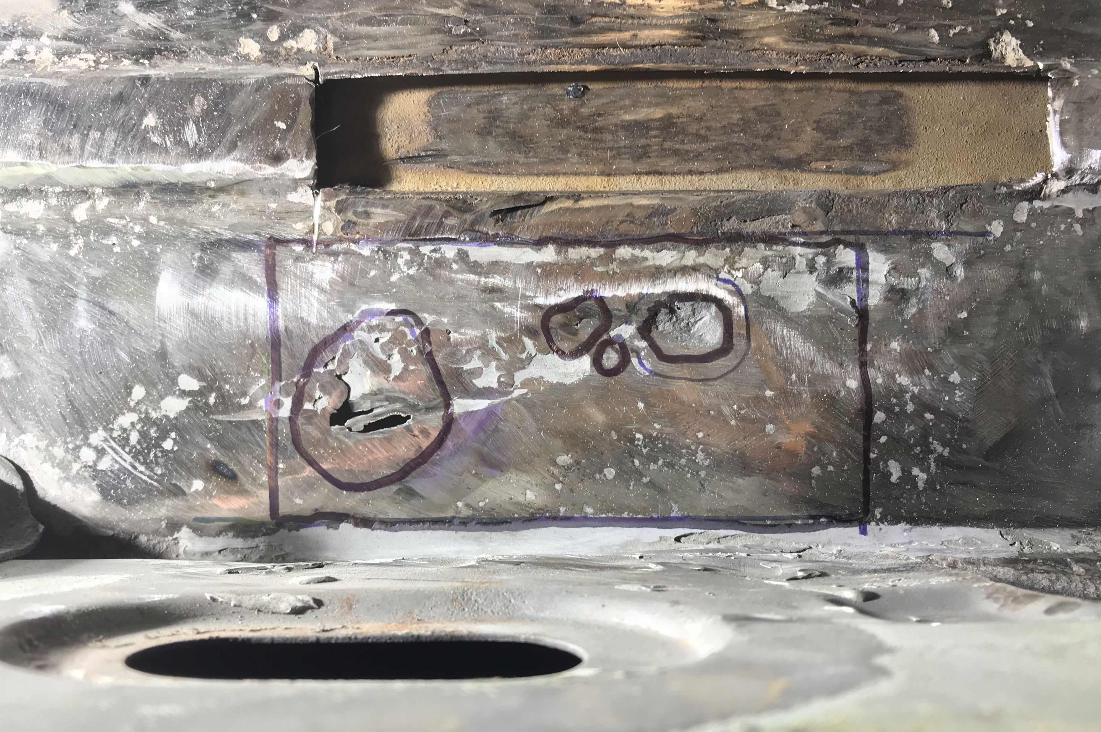

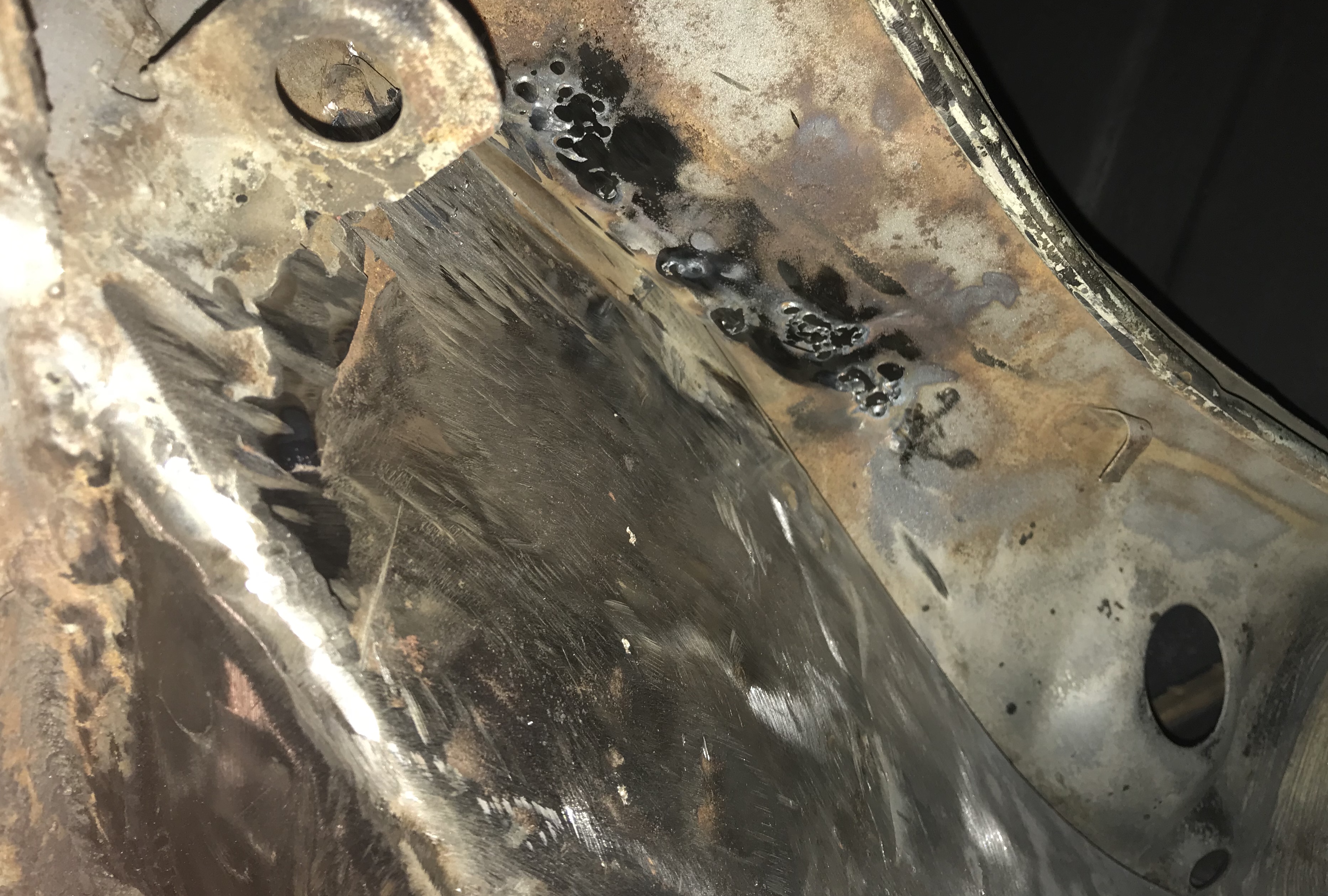

Dion   Well did more exploratory surgery and it's ugl...   Oct 4 2016, 06:01 PM
Dion   Ugly   Oct 4 2016, 06:02 PM
Dion   :blink:   Oct 4 2016, 06:03 PM
Dion   <_<   Oct 4 2016, 06:05 PM

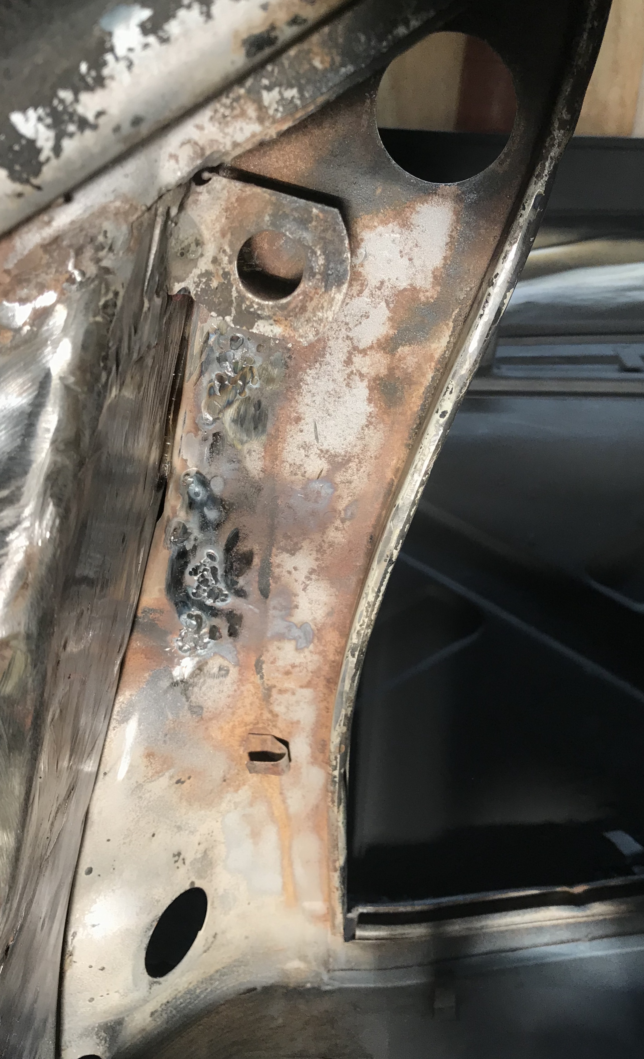

Dion   Opened up whole of left longitudinal today. I...   Oct 5 2016, 09:34 PM

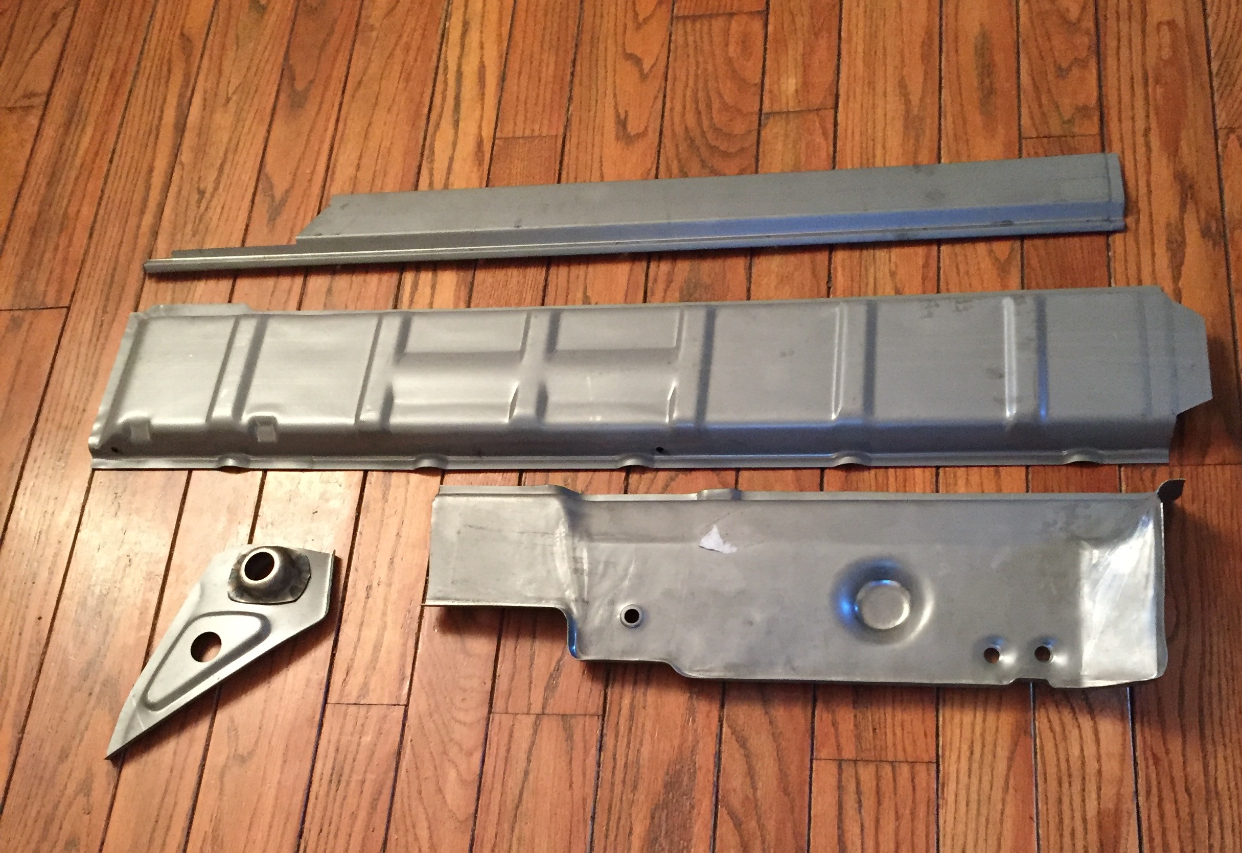

Dion   Fed ex truck dropped off some goods today. Thanks ...   Oct 28 2016, 03:04 PM

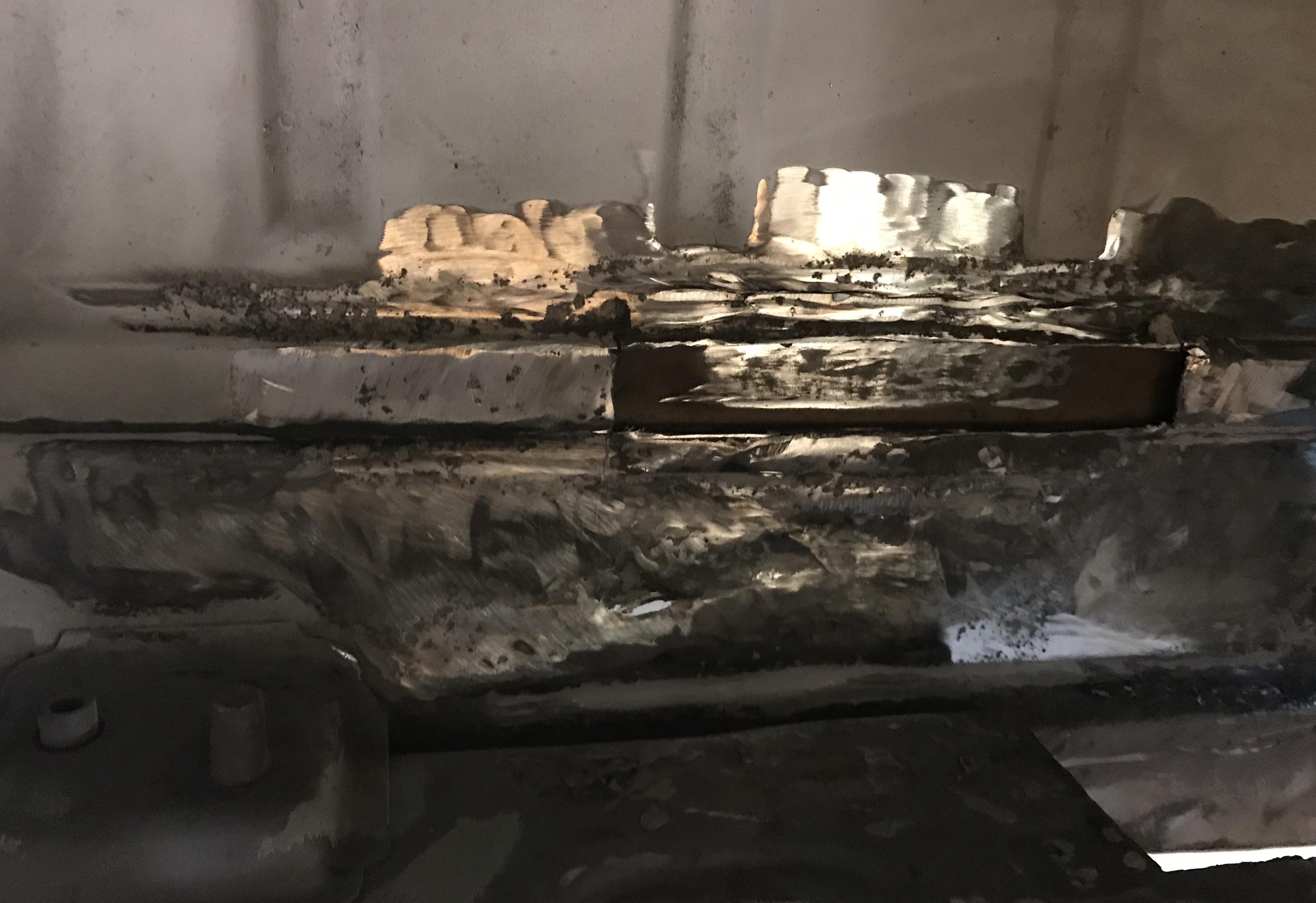

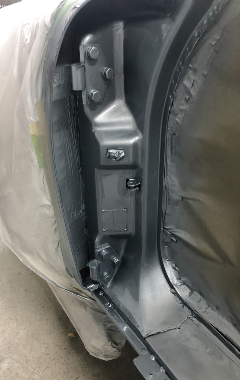

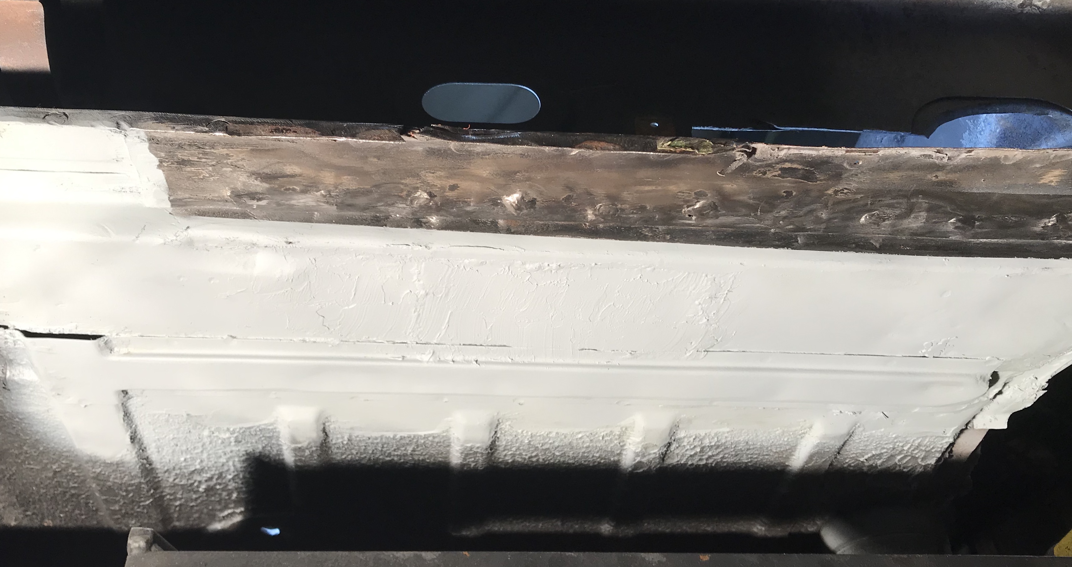

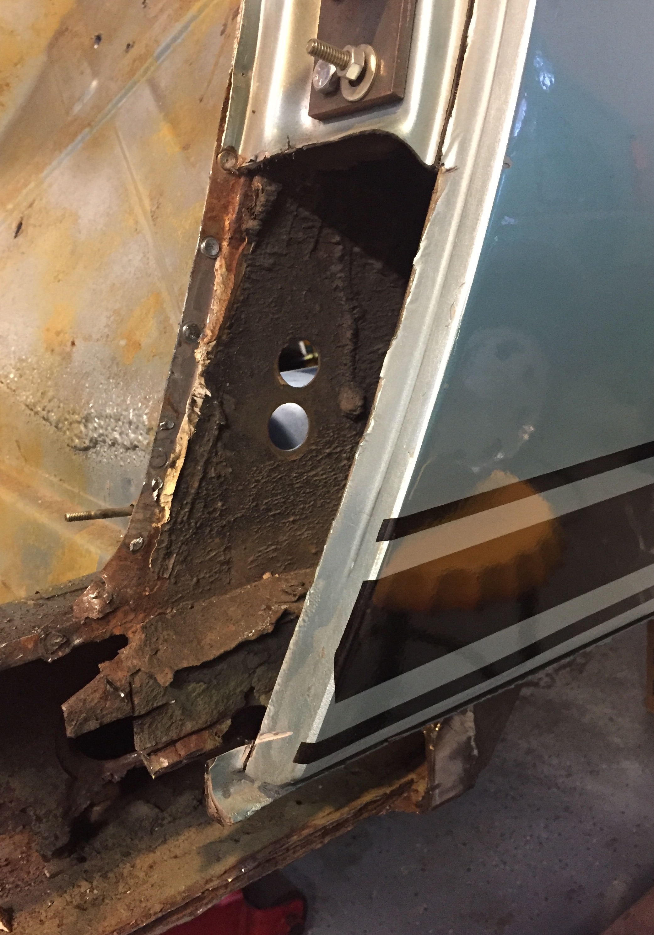

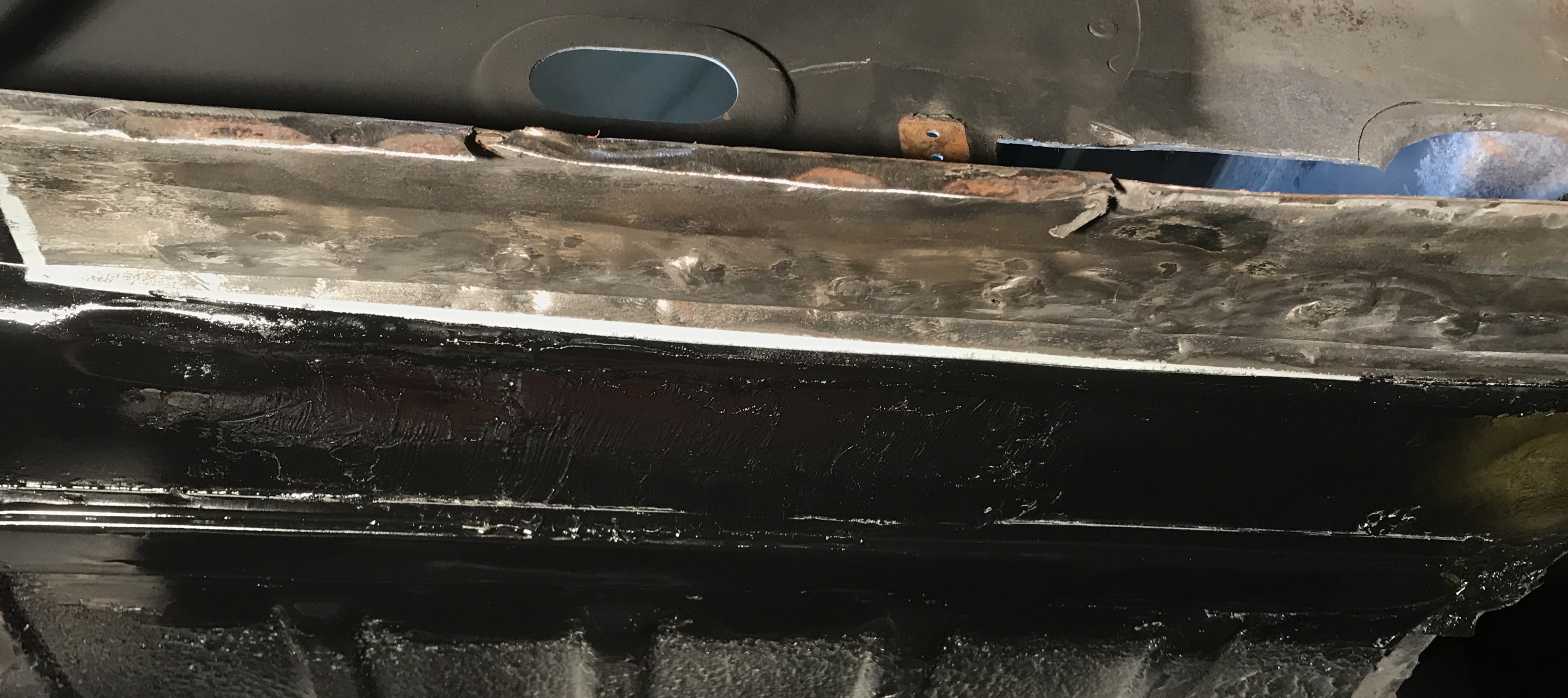

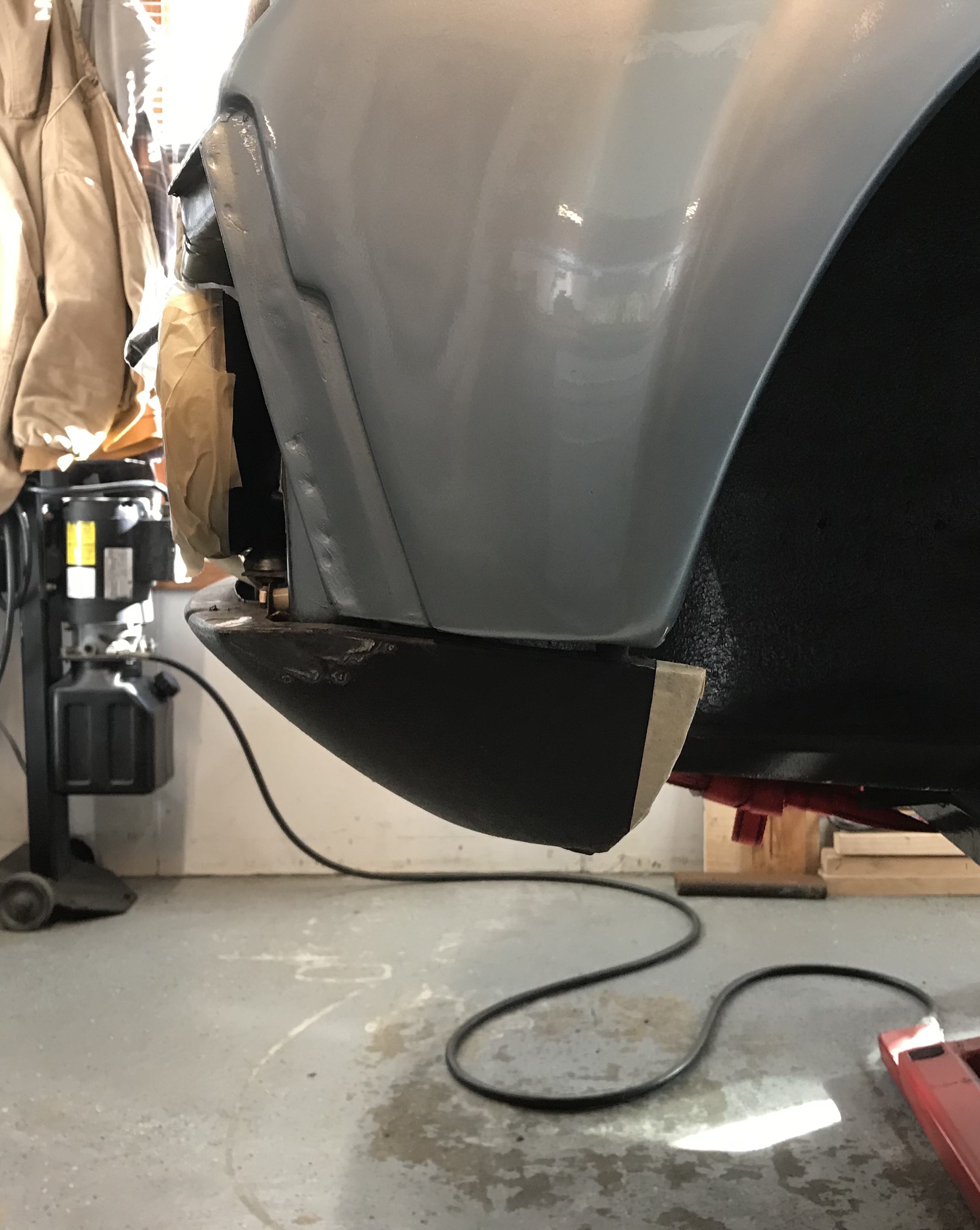

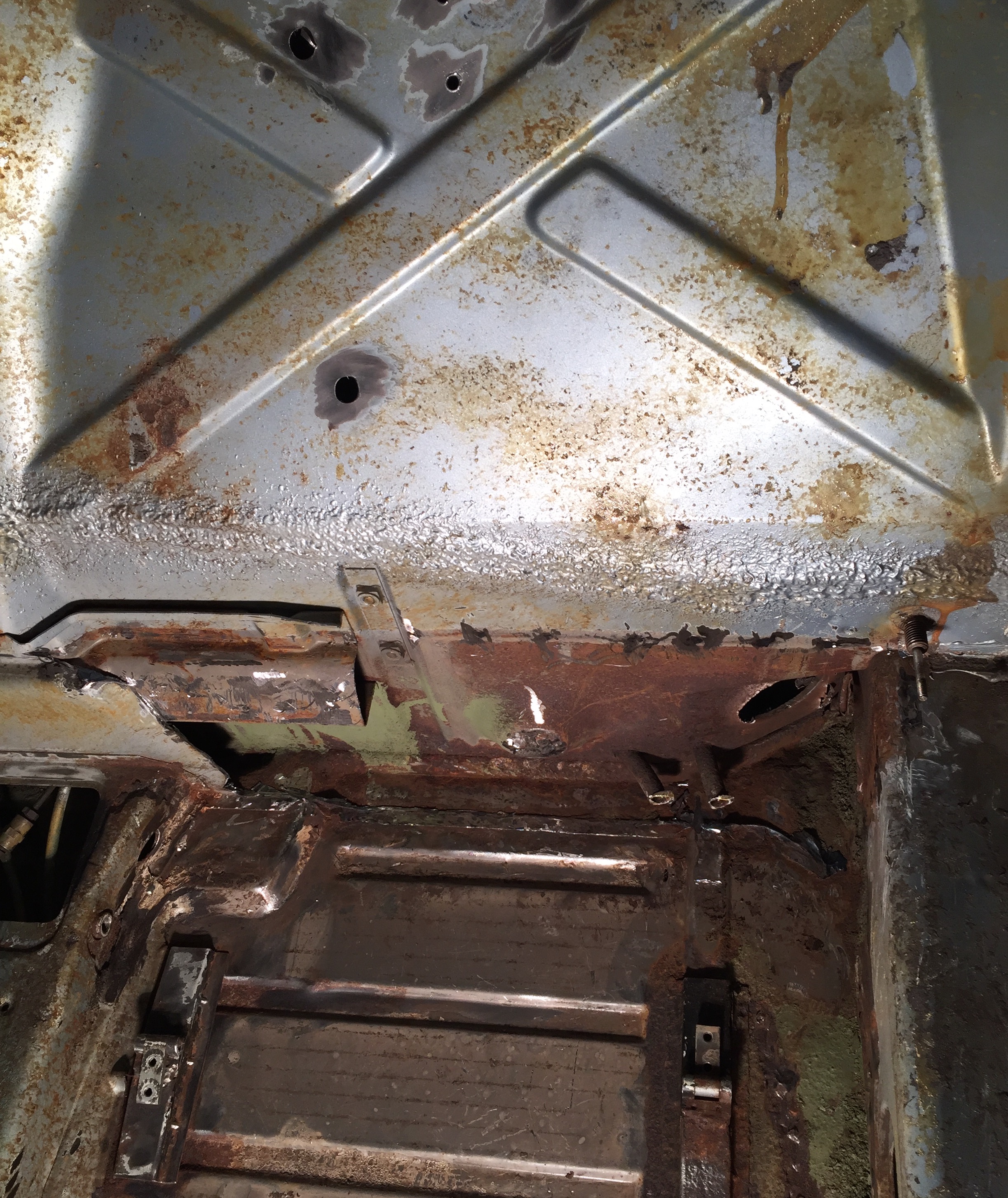

Dion   Ok finally removed rear quarter. It's really ...   Nov 5 2016, 07:15 PM
Dion   Panel off   Nov 5 2016, 07:17 PM
Dion   So this will get fresh paint   Nov 5 2016, 07:22 PM
tygaboy   So this will get fresh paint I love pics like t...   Nov 6 2016, 07:43 AM

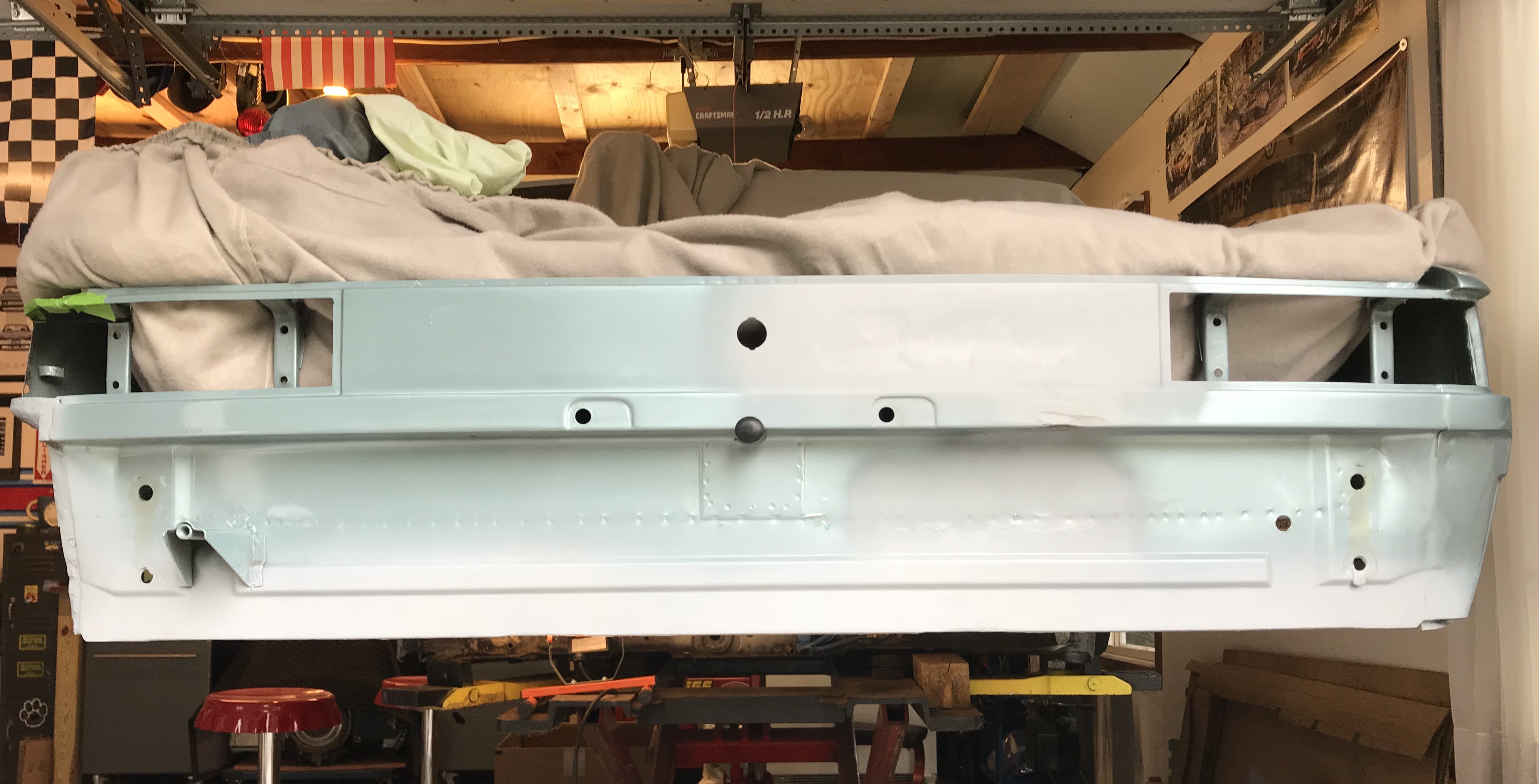

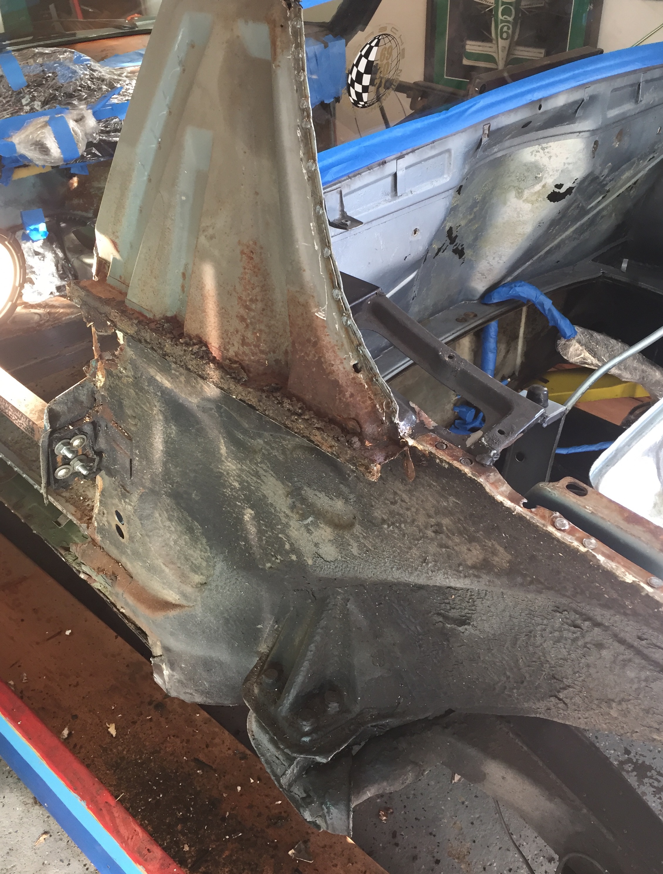

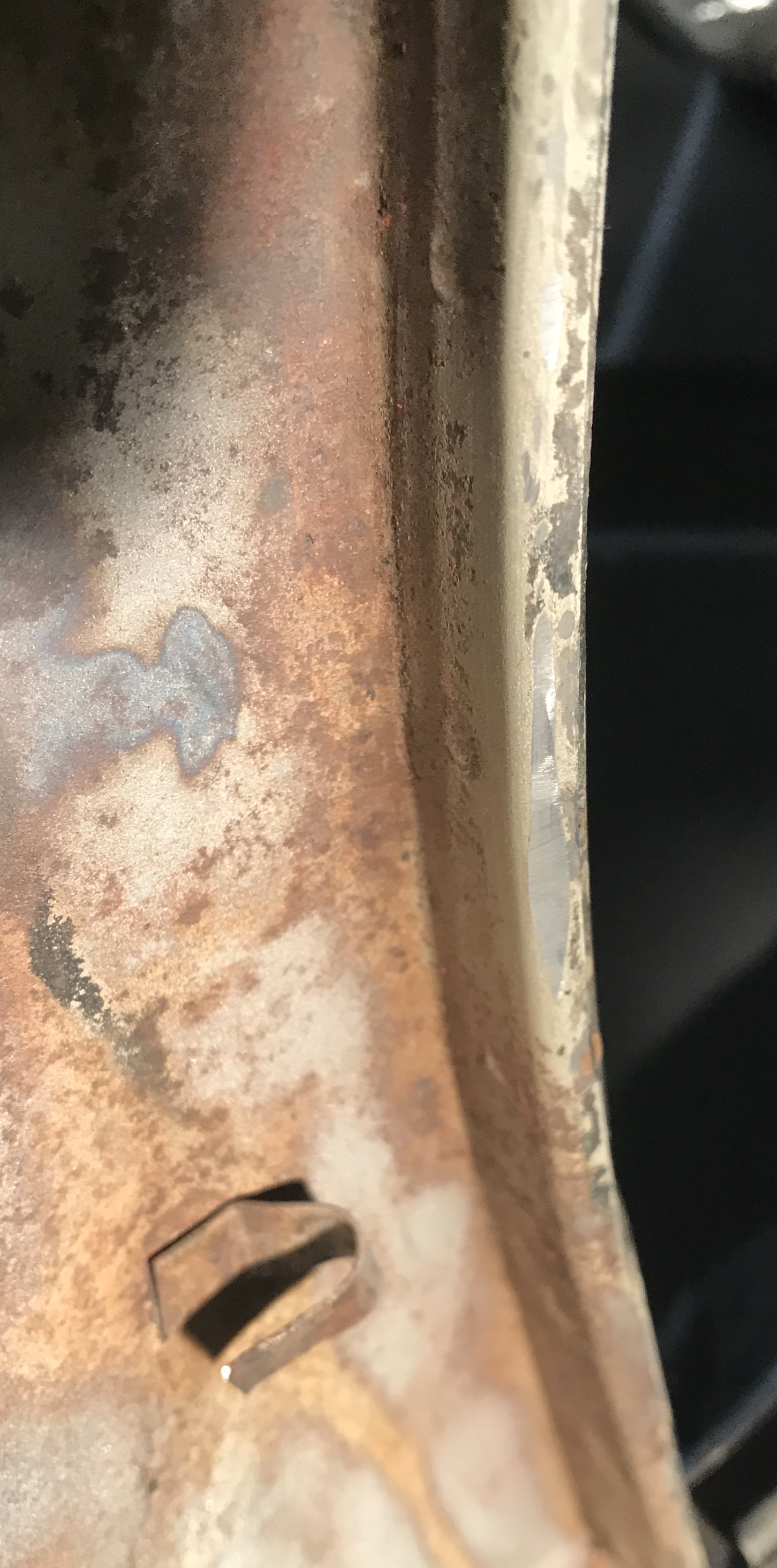

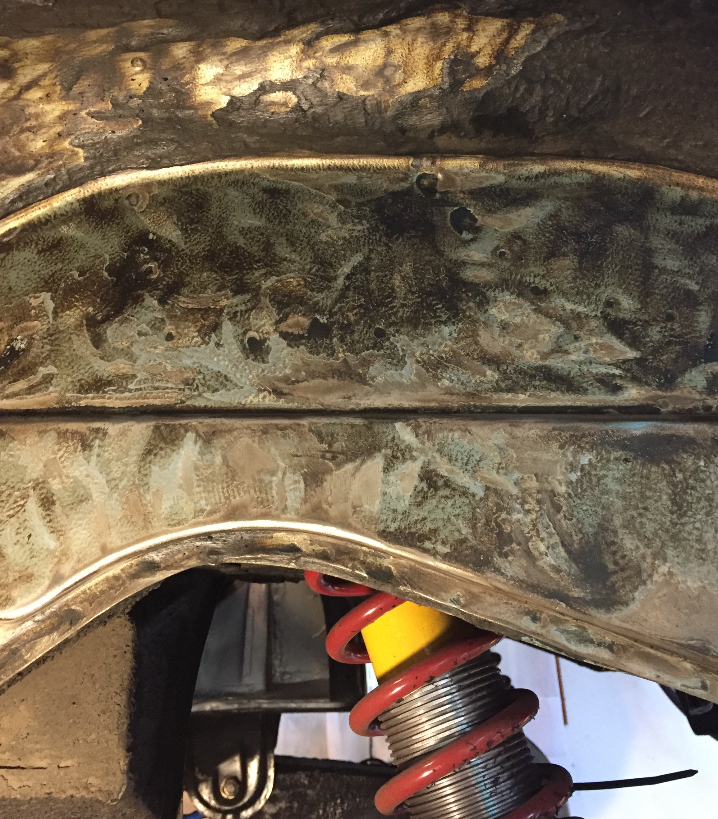

Dion   So with the rear panel off was better able to acce...   Nov 13 2016, 04:13 PM
Dion   Deterioration   Nov 13 2016, 04:14 PM
tygaboy   Dion - I have a '72 donor car that is virtuall...   Nov 13 2016, 07:43 PM

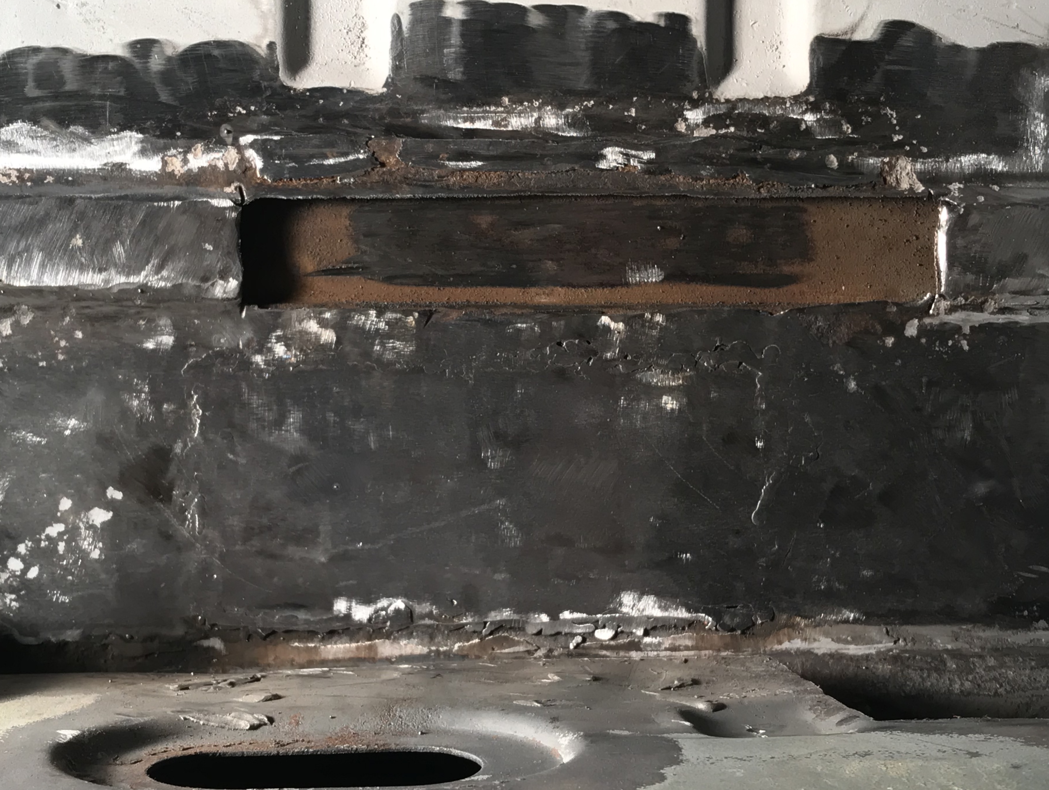

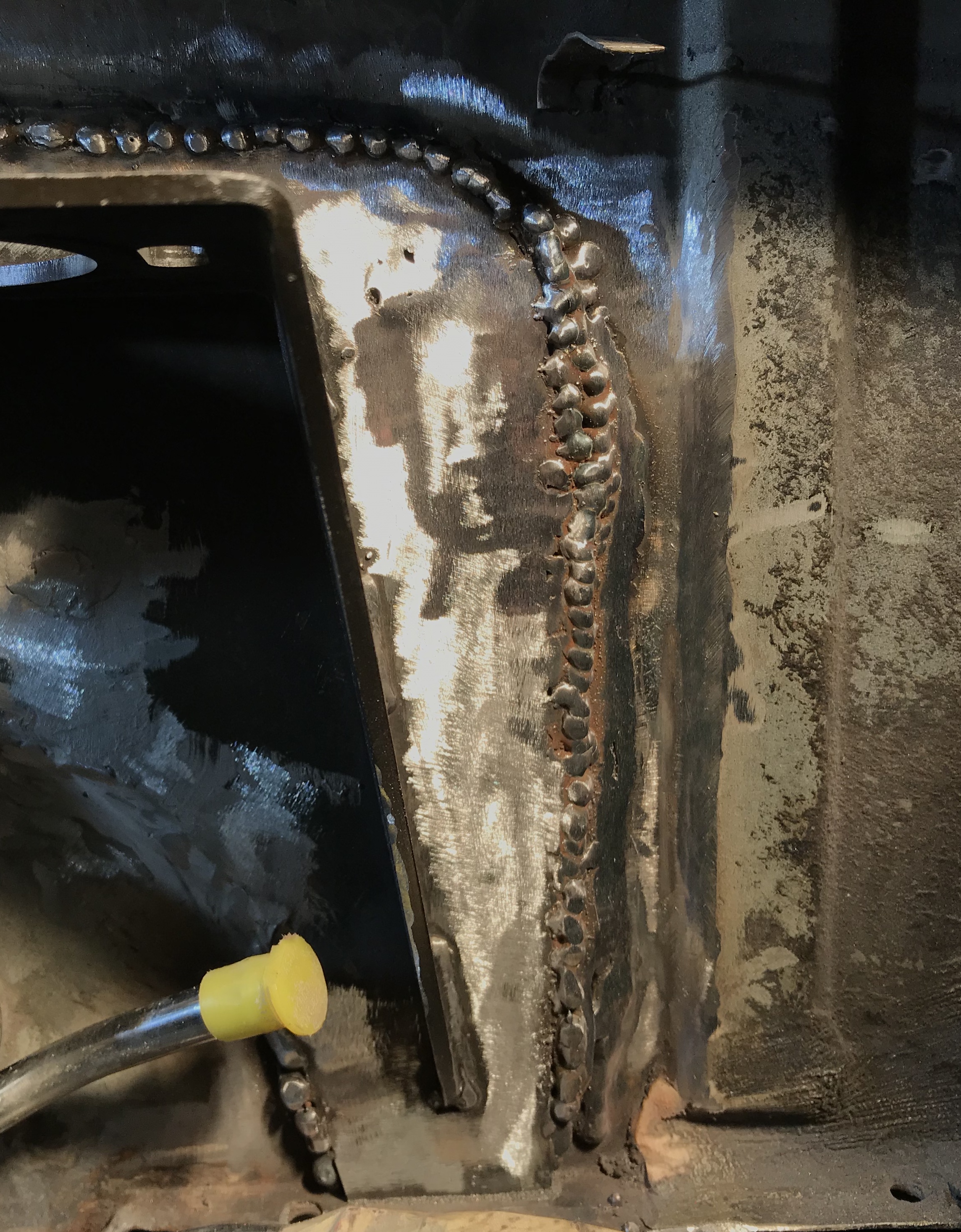

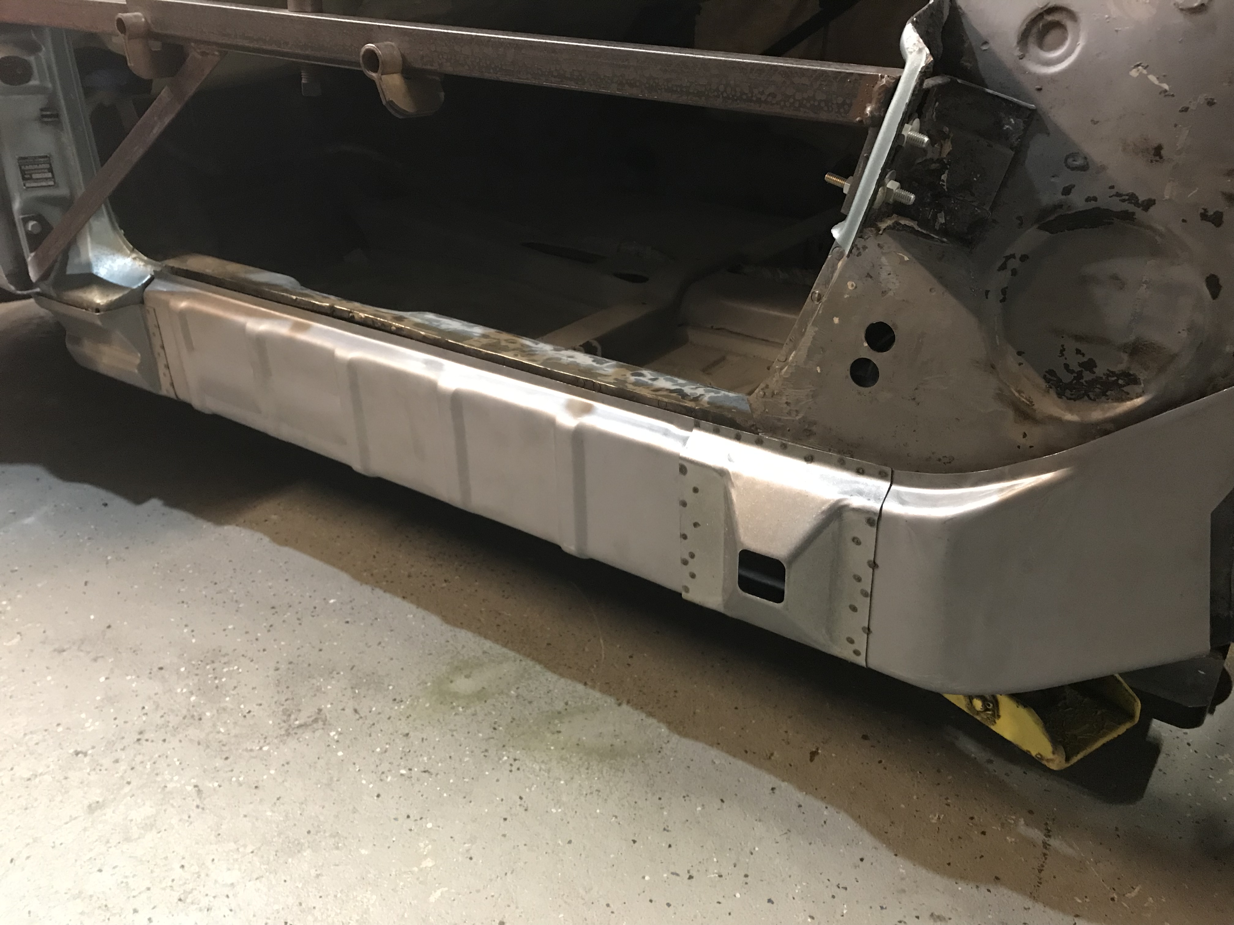

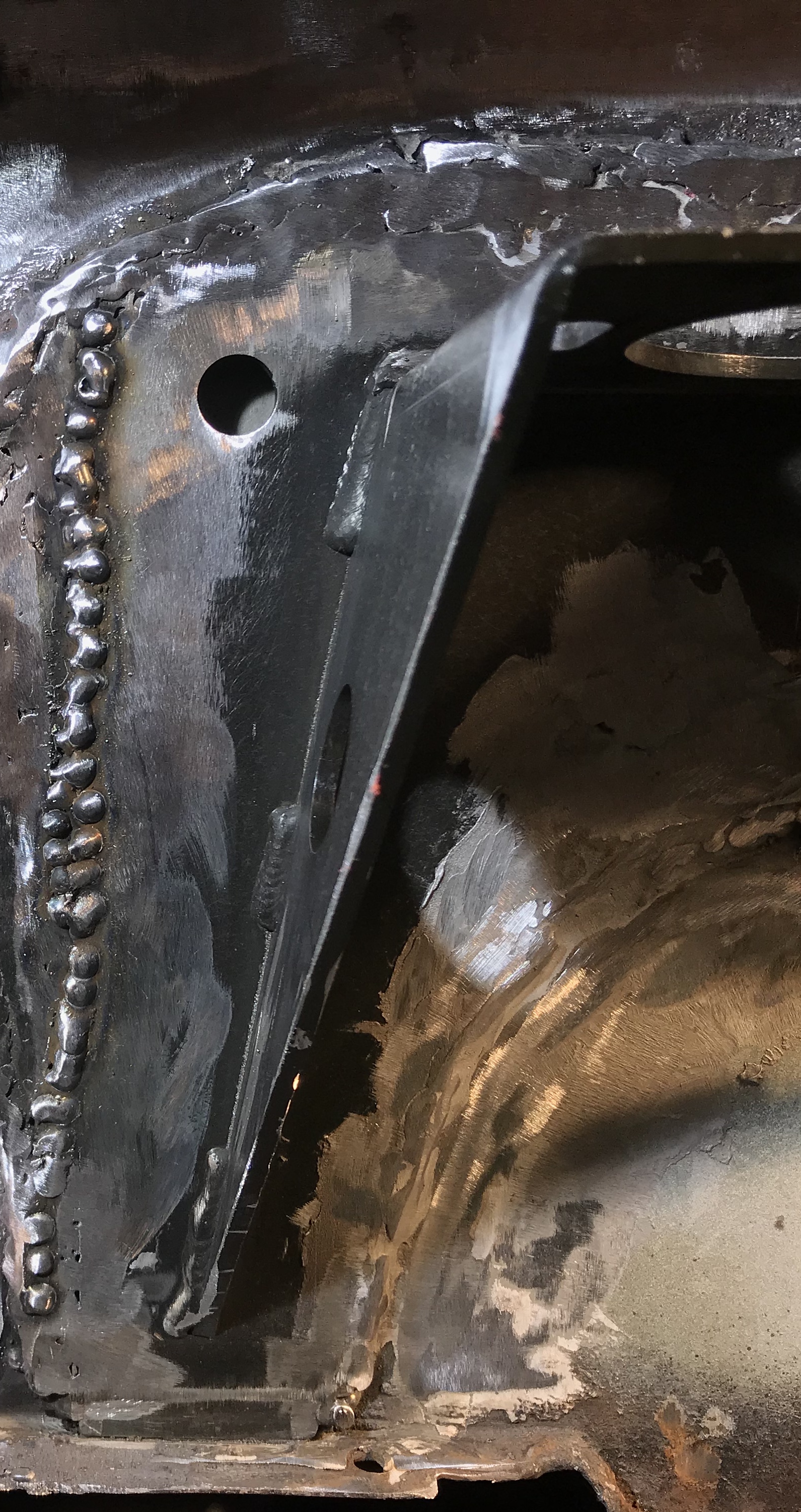

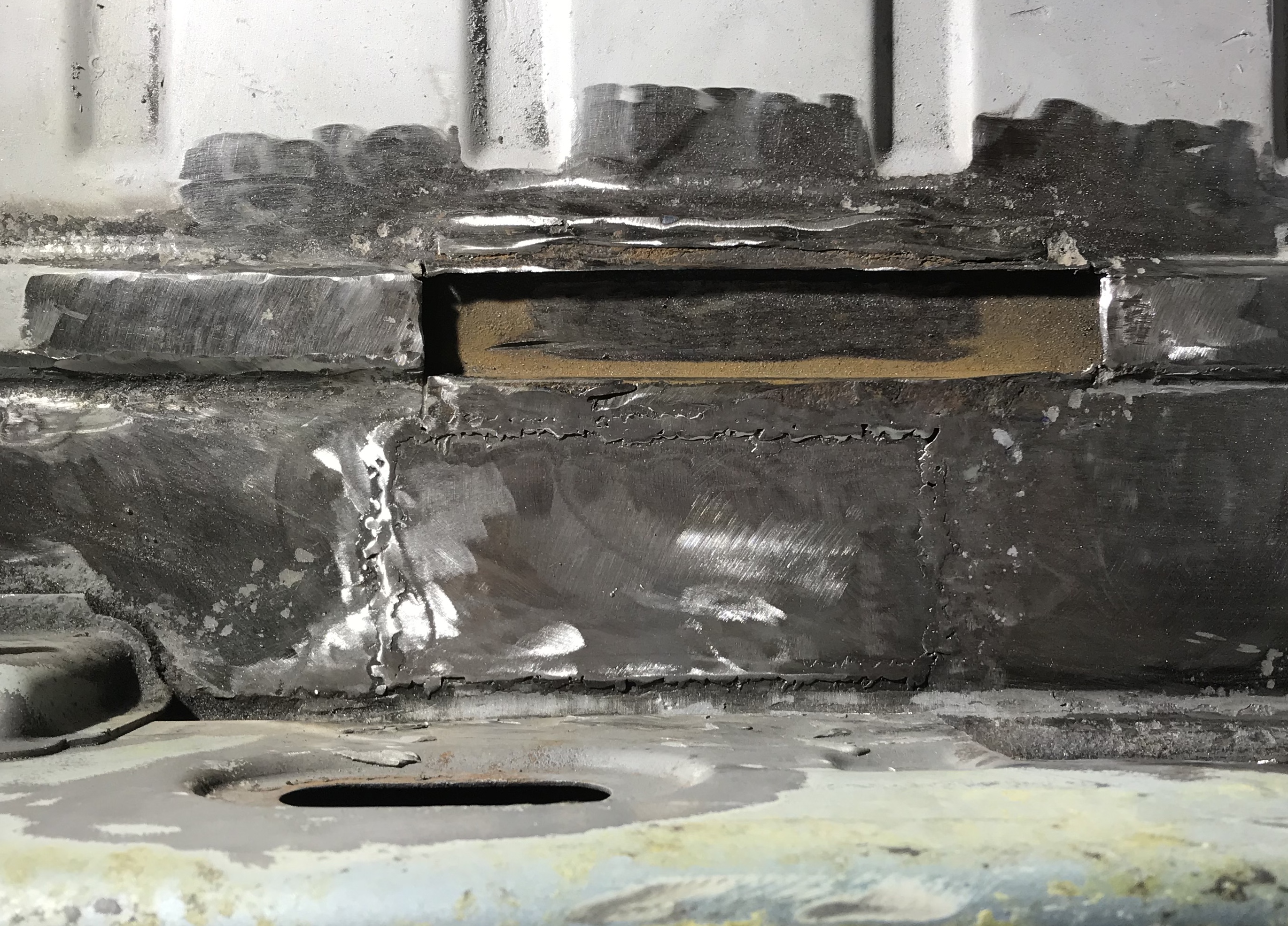

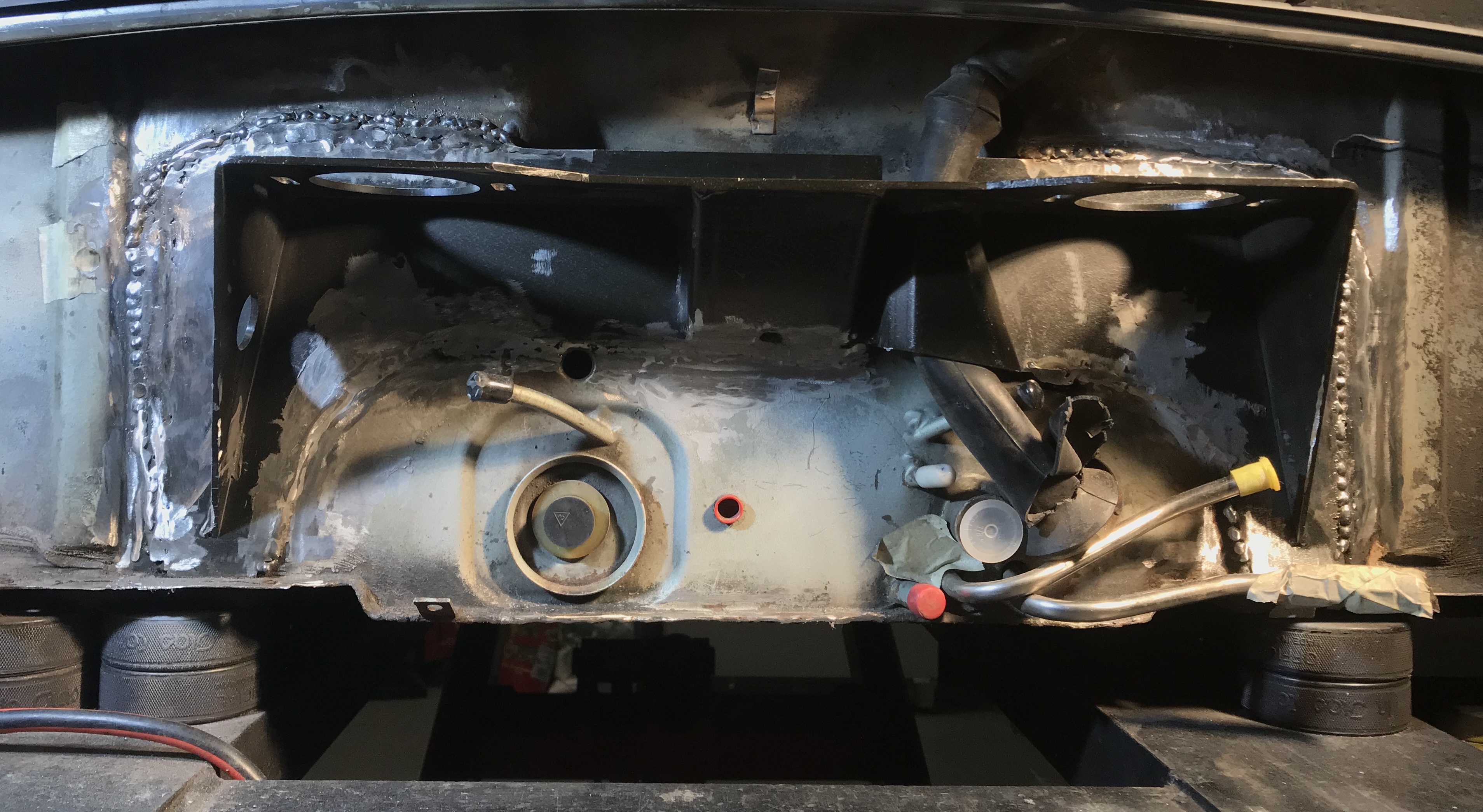

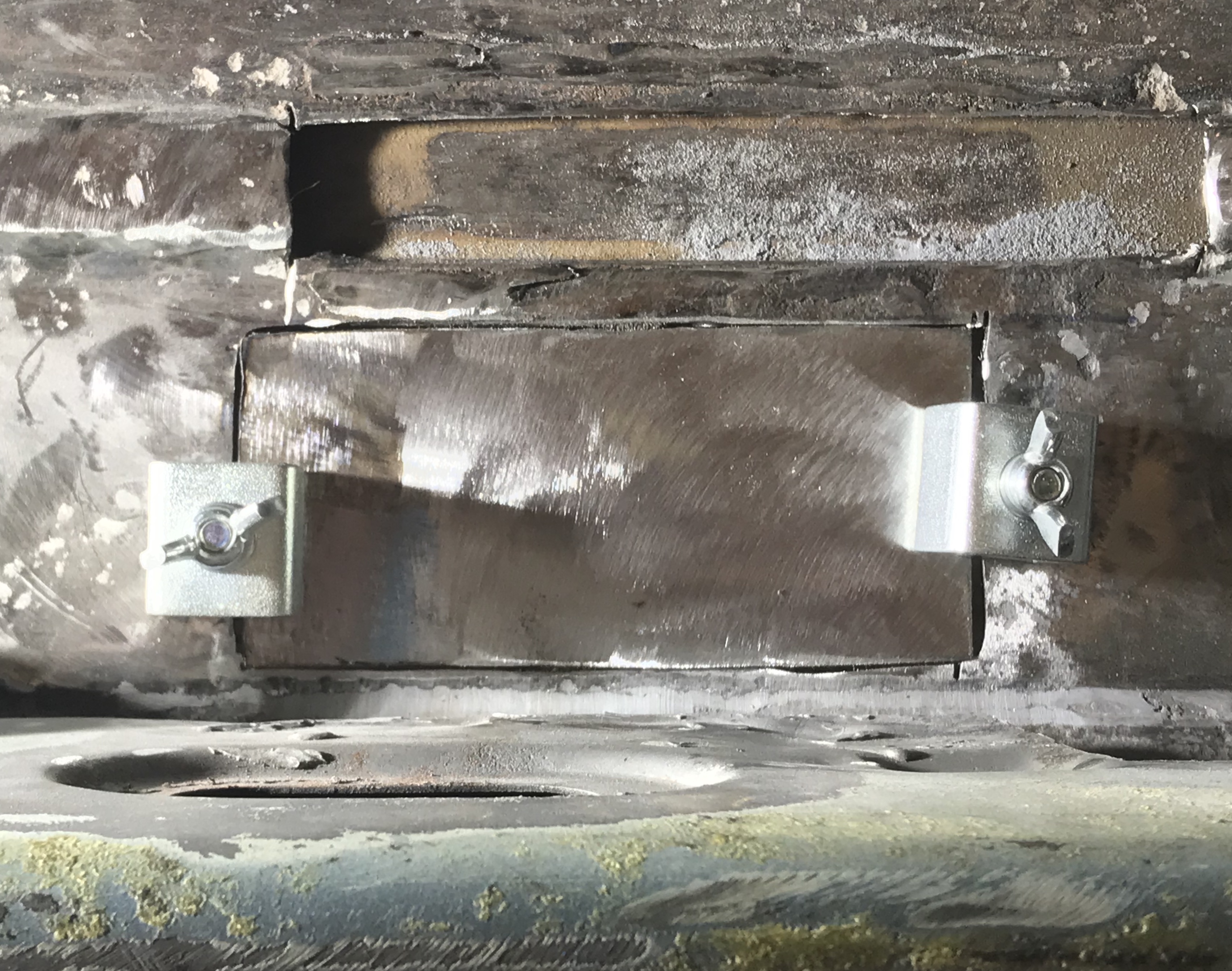

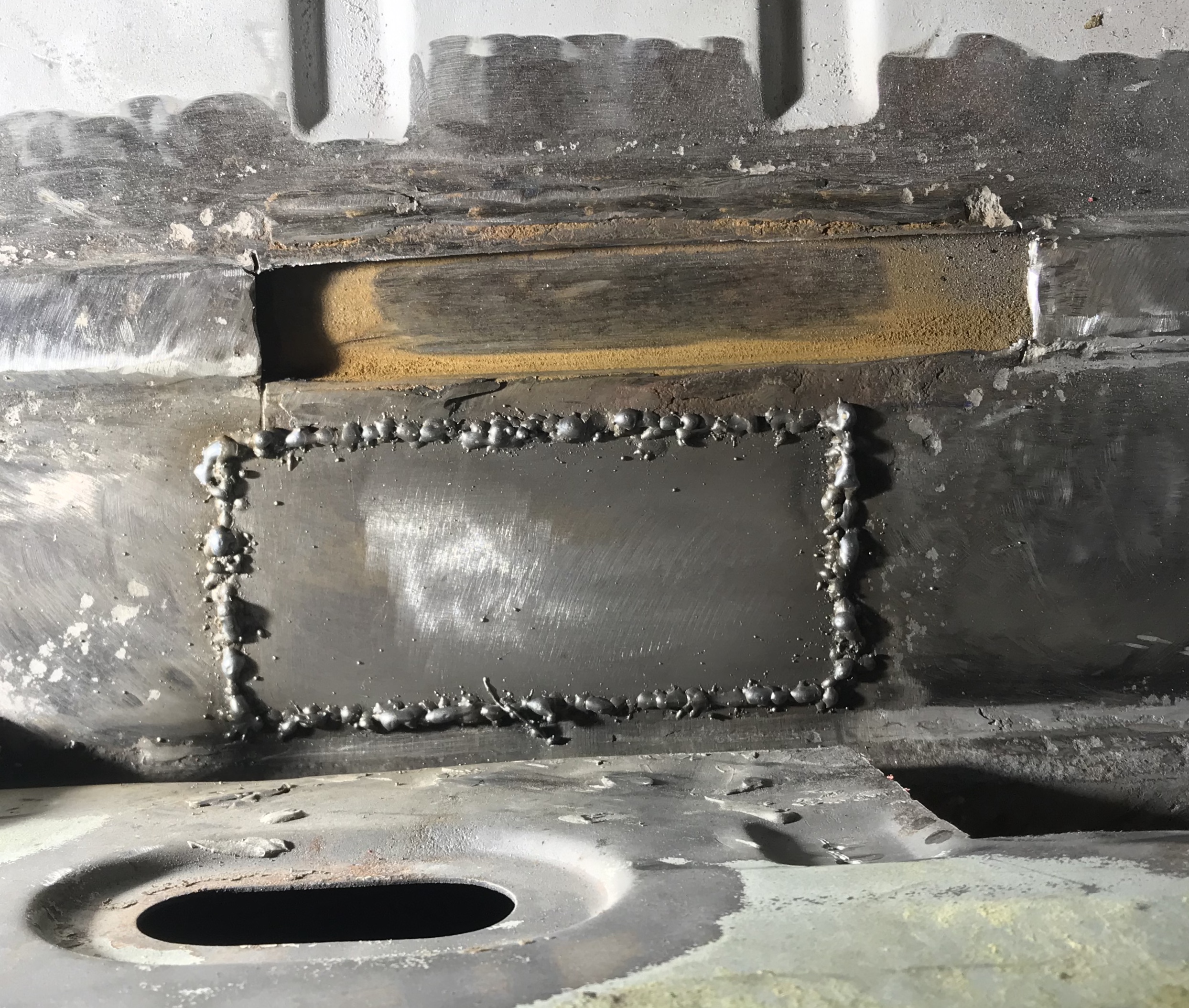

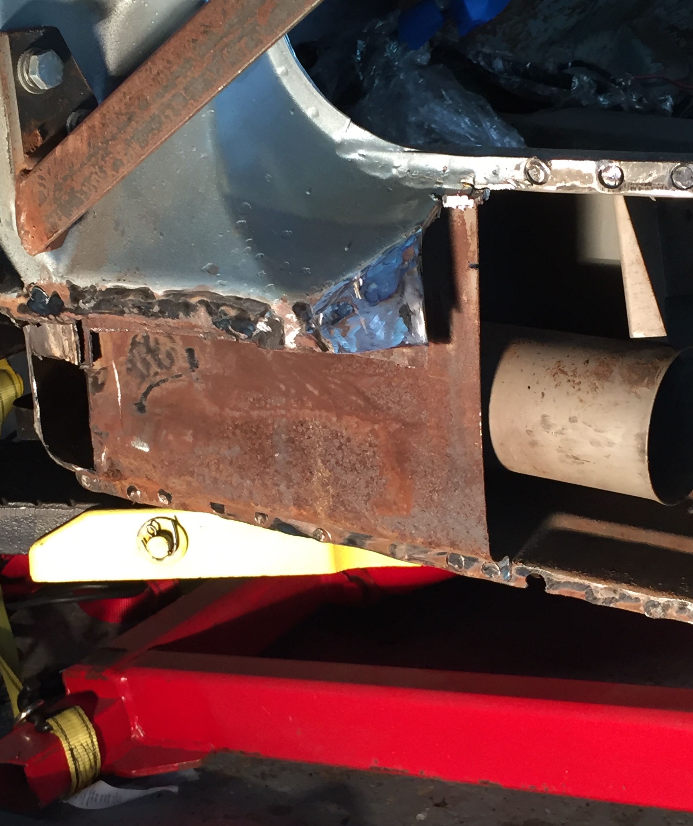

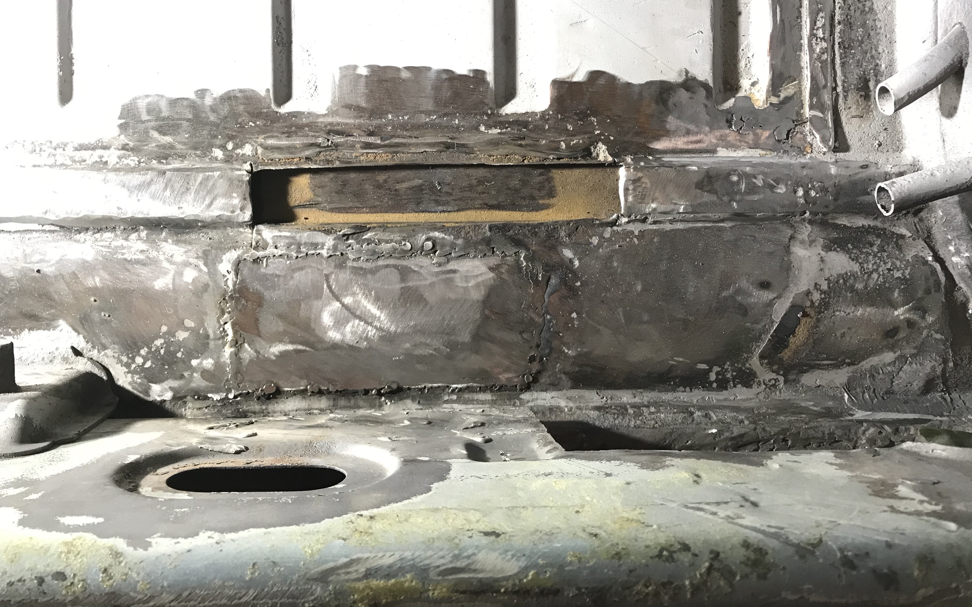

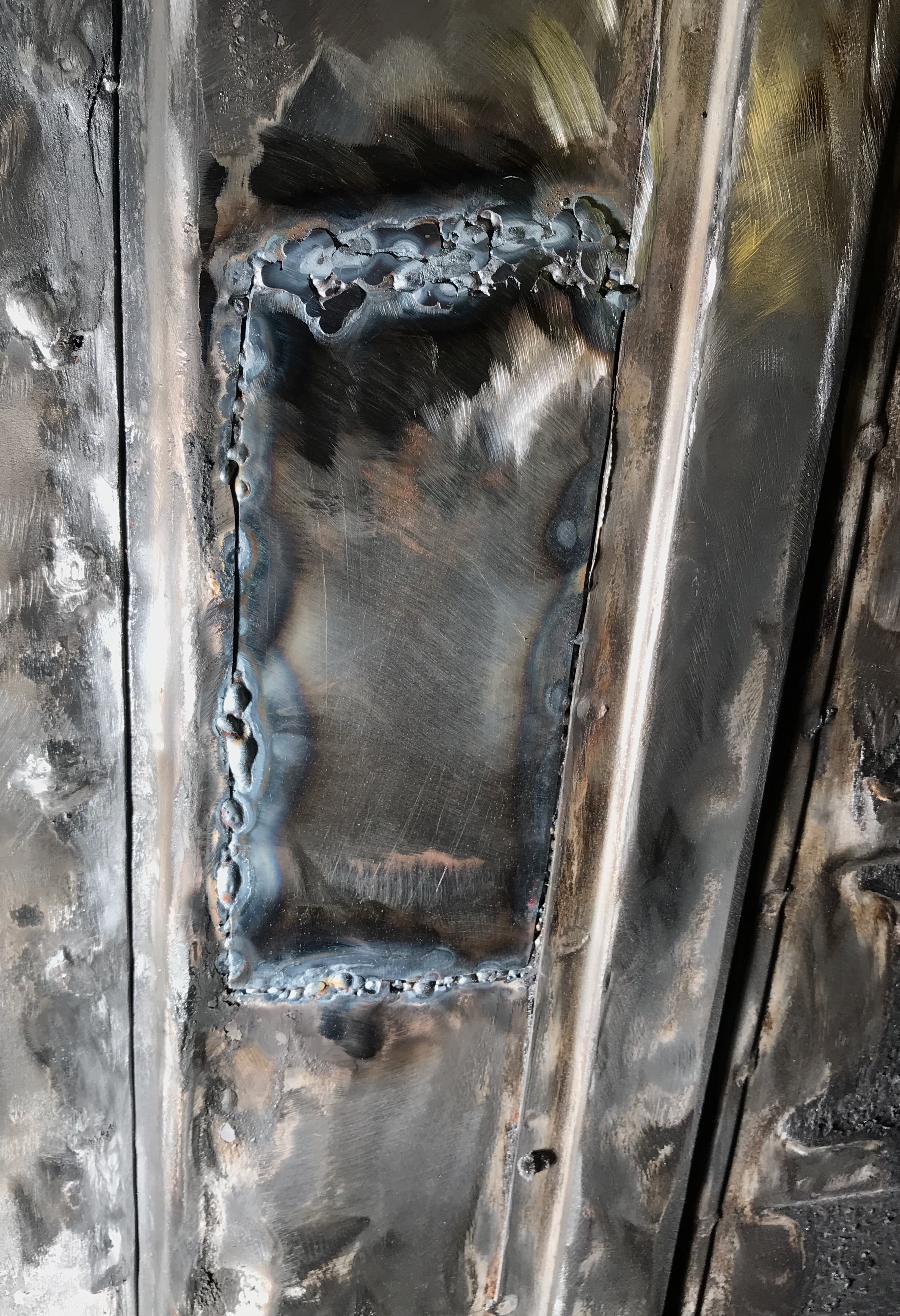

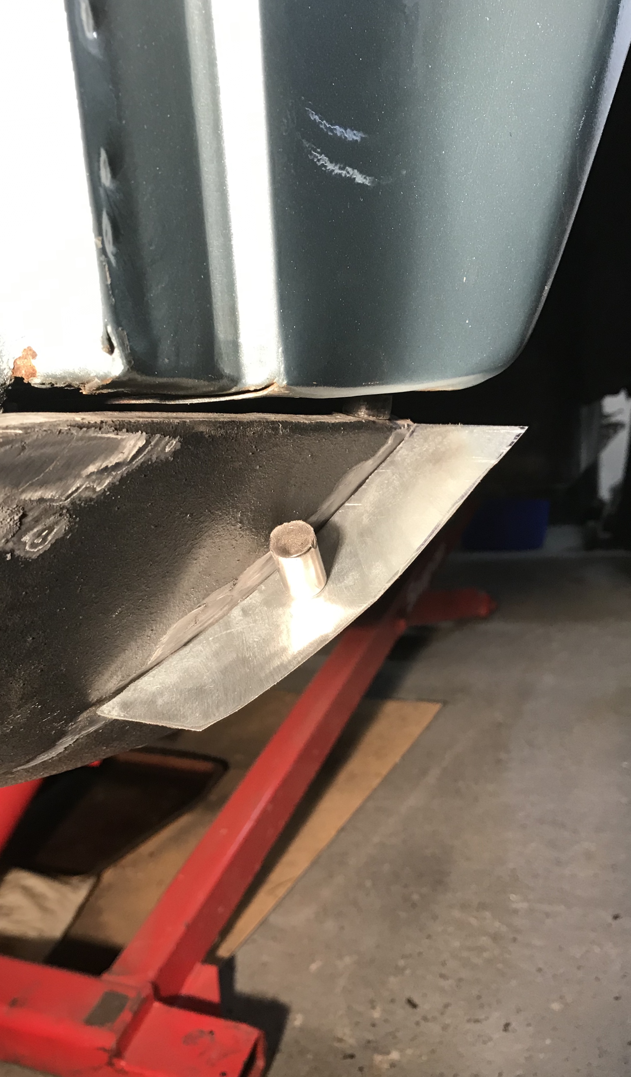

Dion   Cut away the remainder of the sill panel. Surface ...   Dec 1 2016, 01:29 PM
Dion   Removed more of the door jamb except for brace are...   Dec 1 2016, 01:37 PM
Dion   Pics   Dec 1 2016, 01:41 PM
Dion   Pics   Dec 1 2016, 01:43 PM

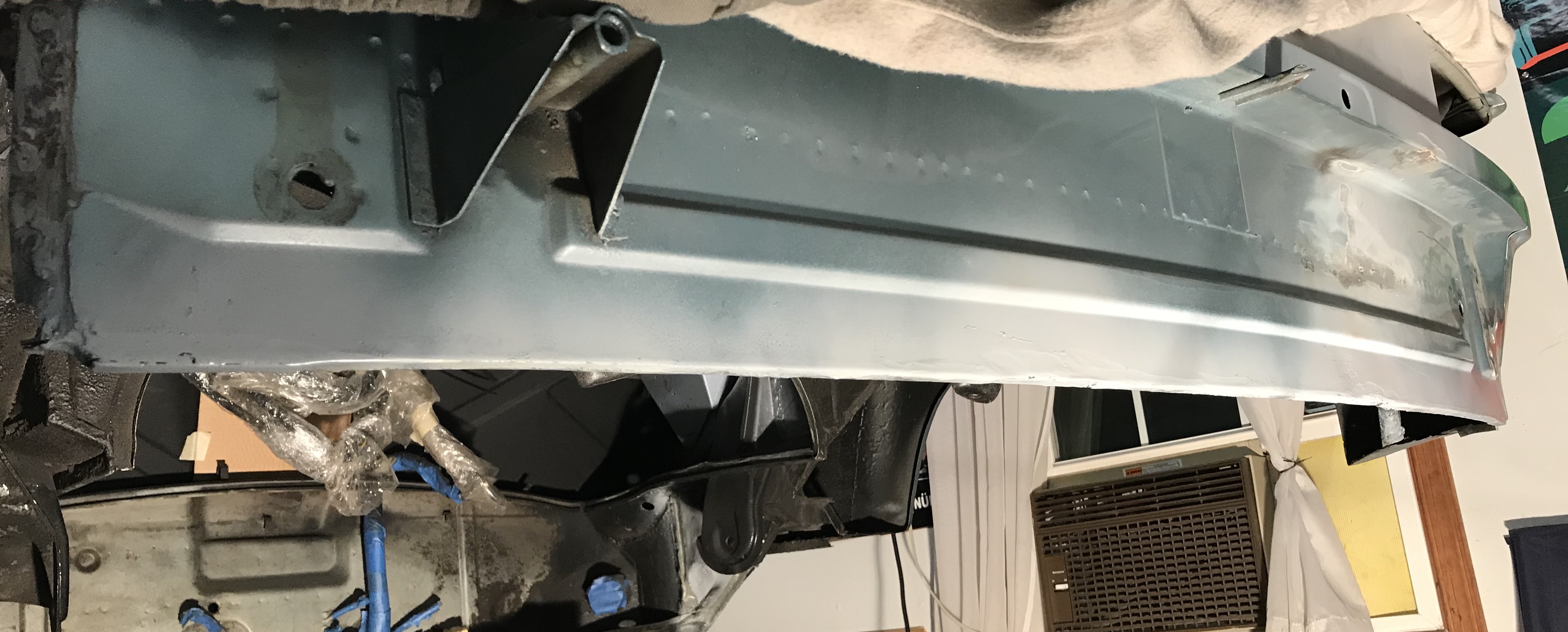

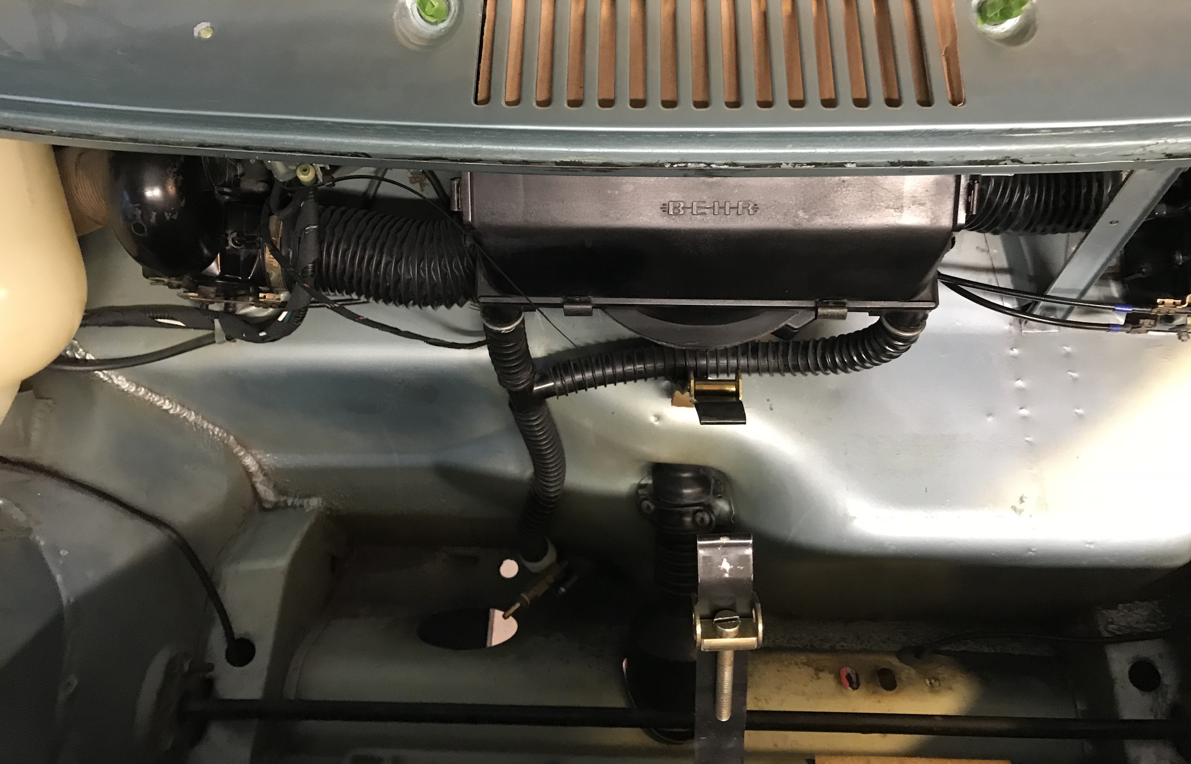

Dion   New firewall panel test-fit & de-brazed E-brak...   Dec 1 2016, 01:44 PM
tygaboy   I'm amazed at the level and extent of :sawzal...   Dec 1 2016, 01:46 PM

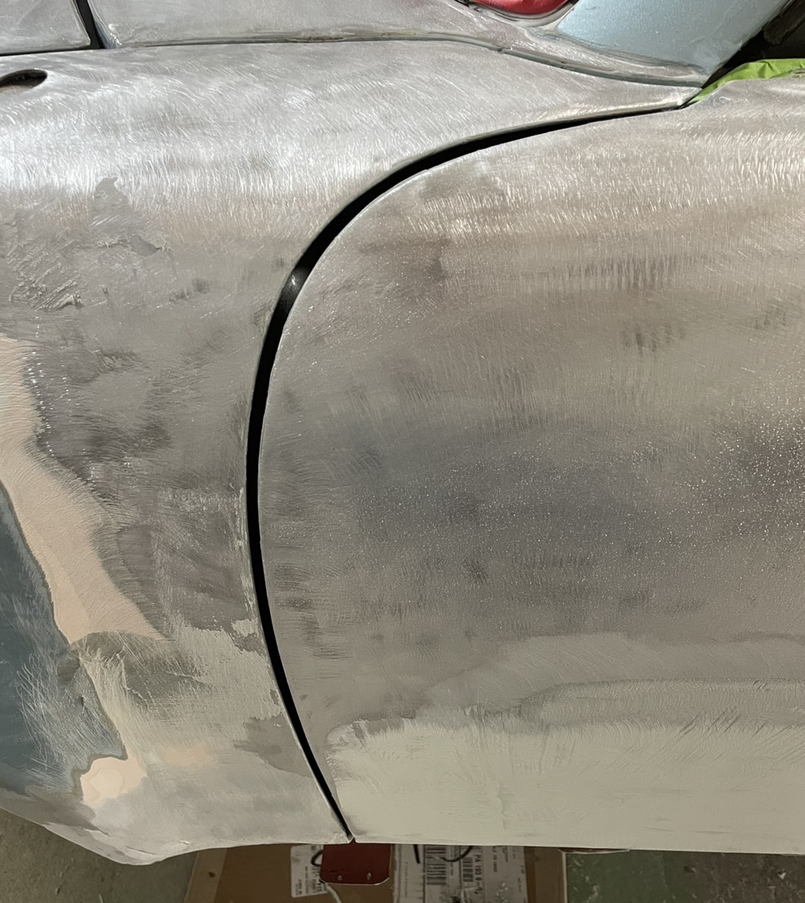

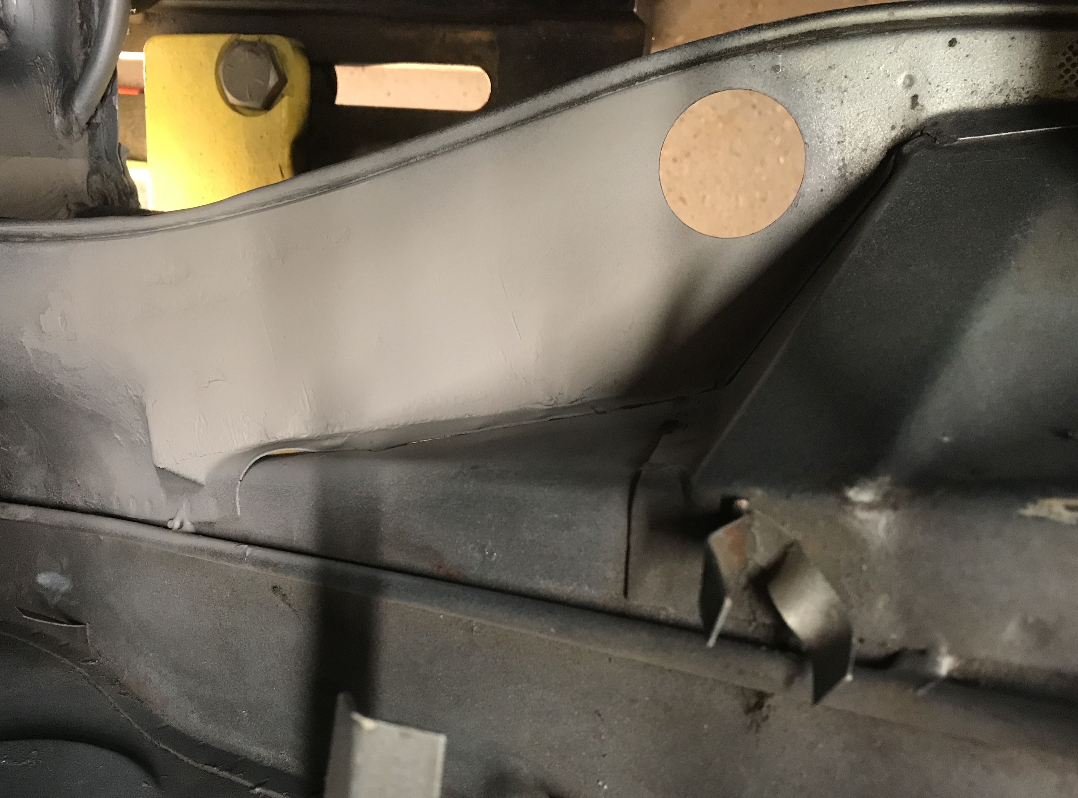

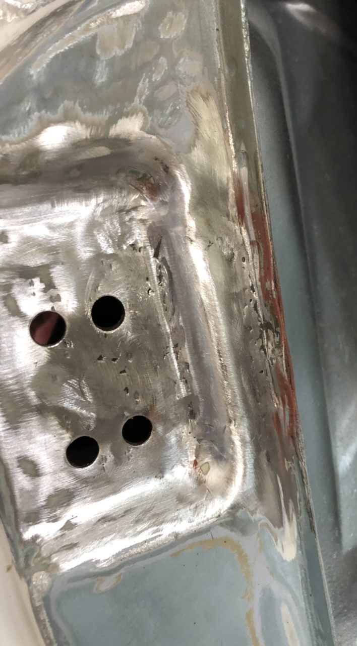

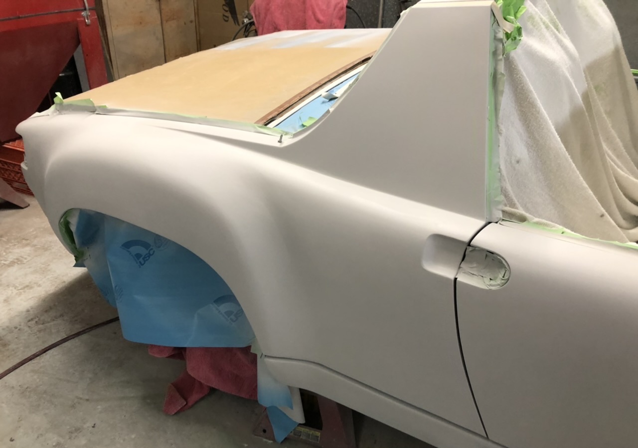

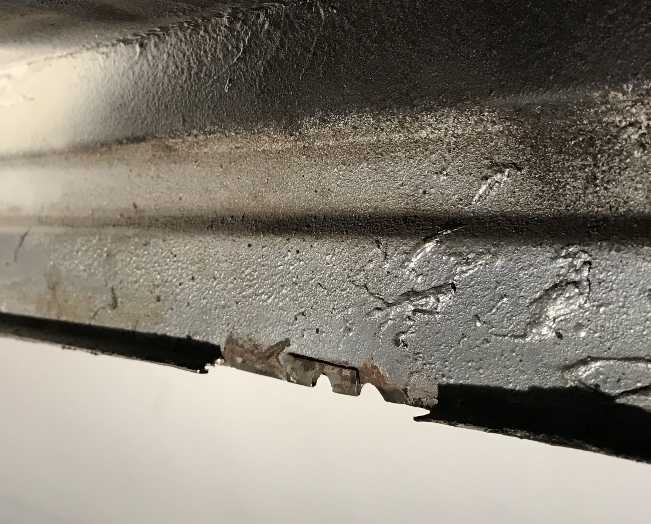

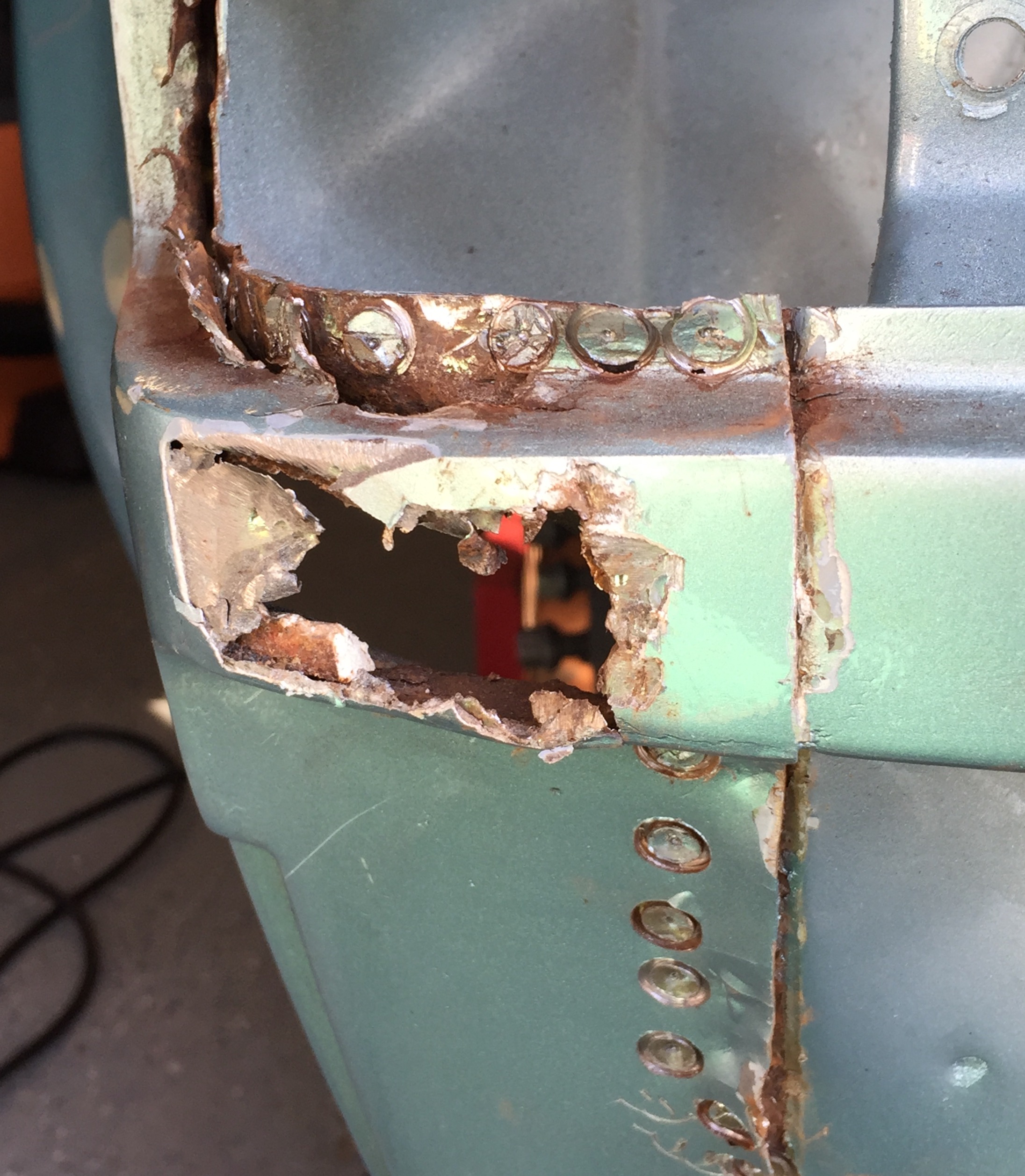

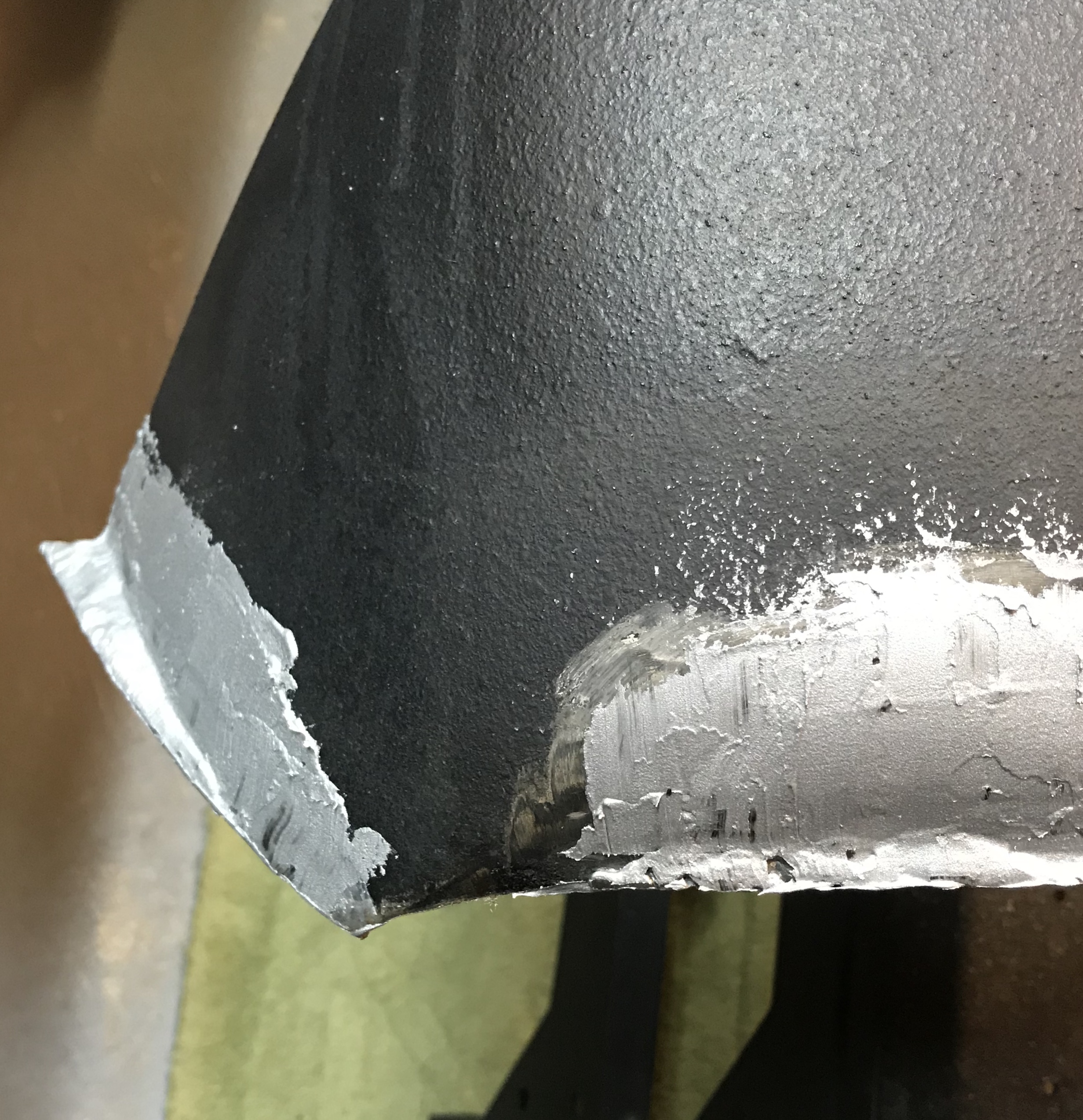

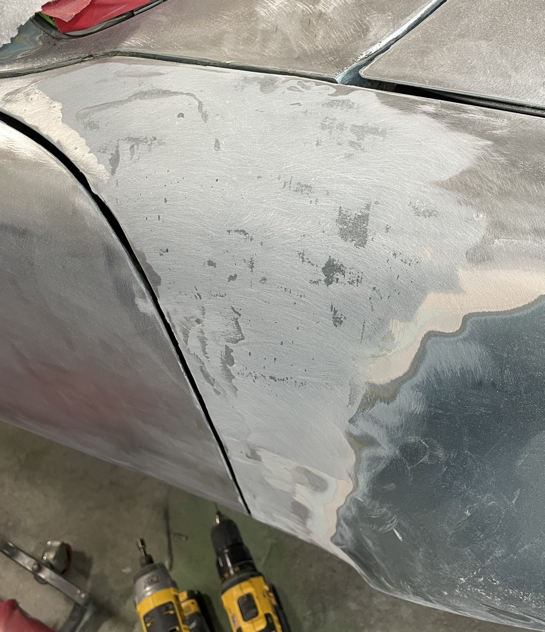

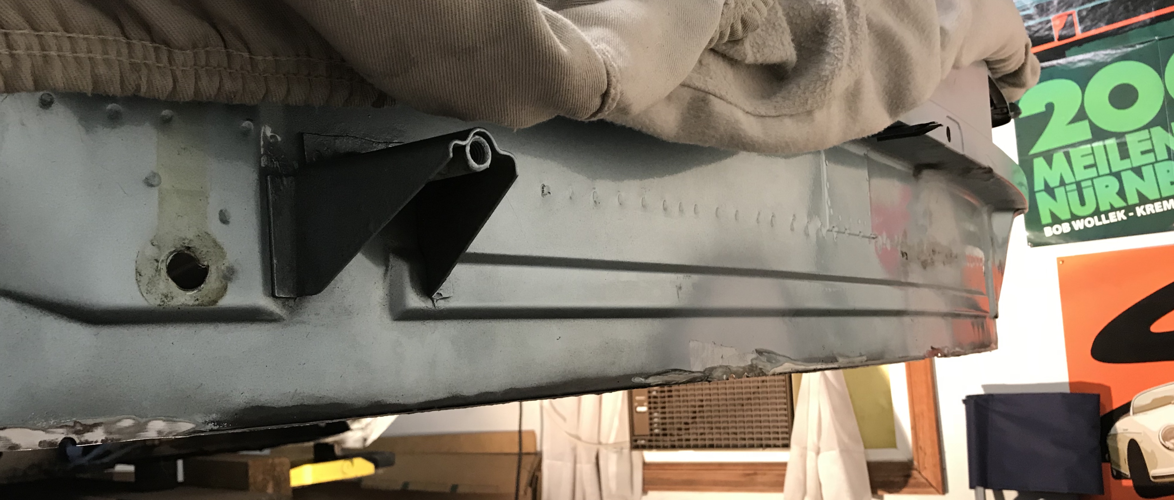

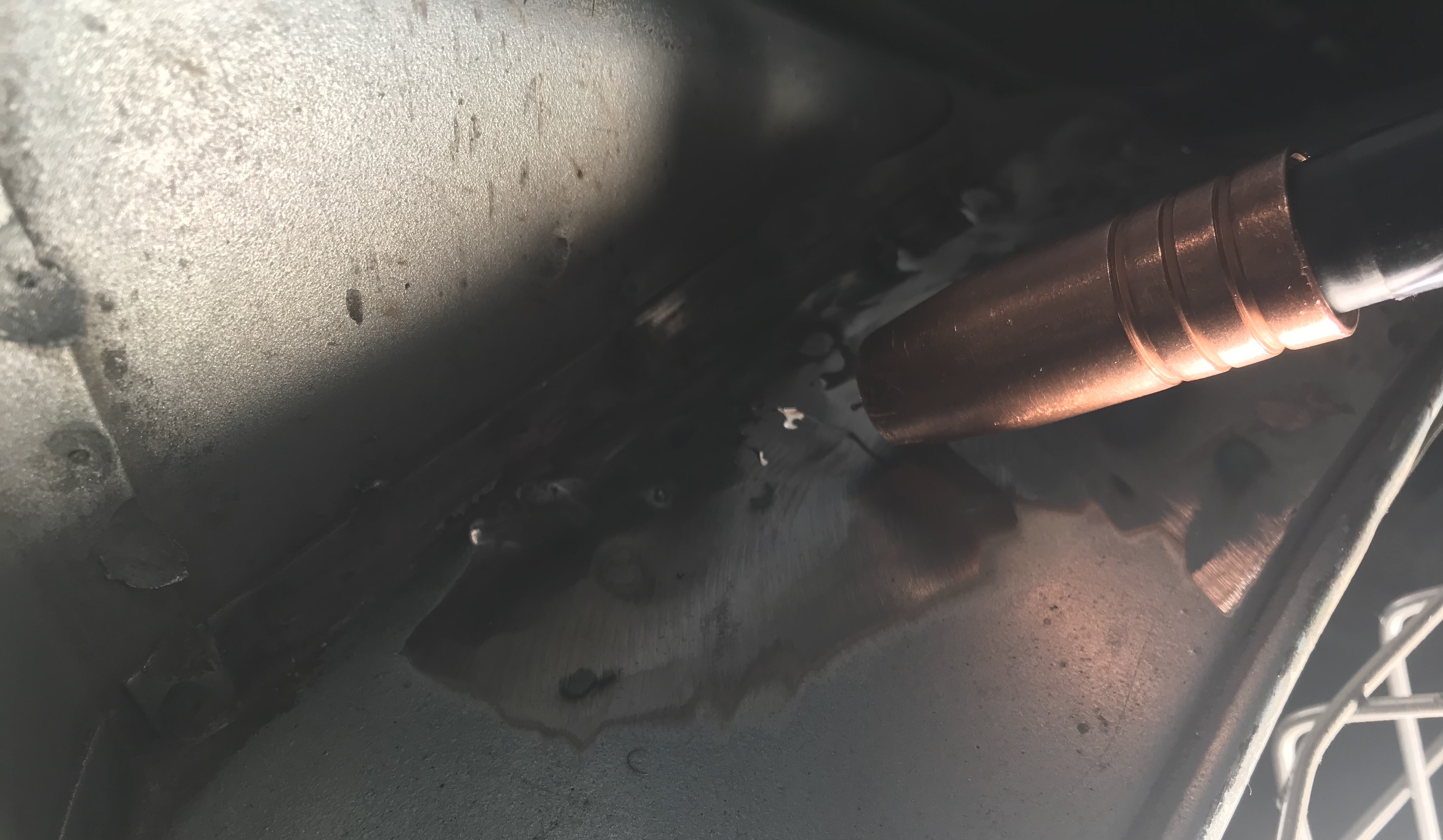

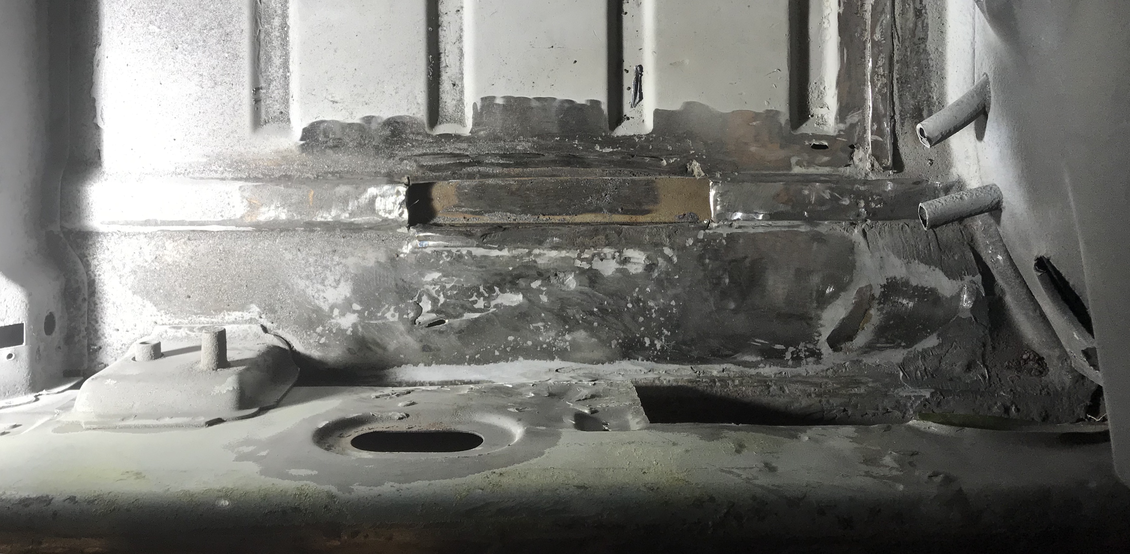

Dion   Some garage time this afternoon. Started prepping ...   Jan 26 2017, 04:23 PM

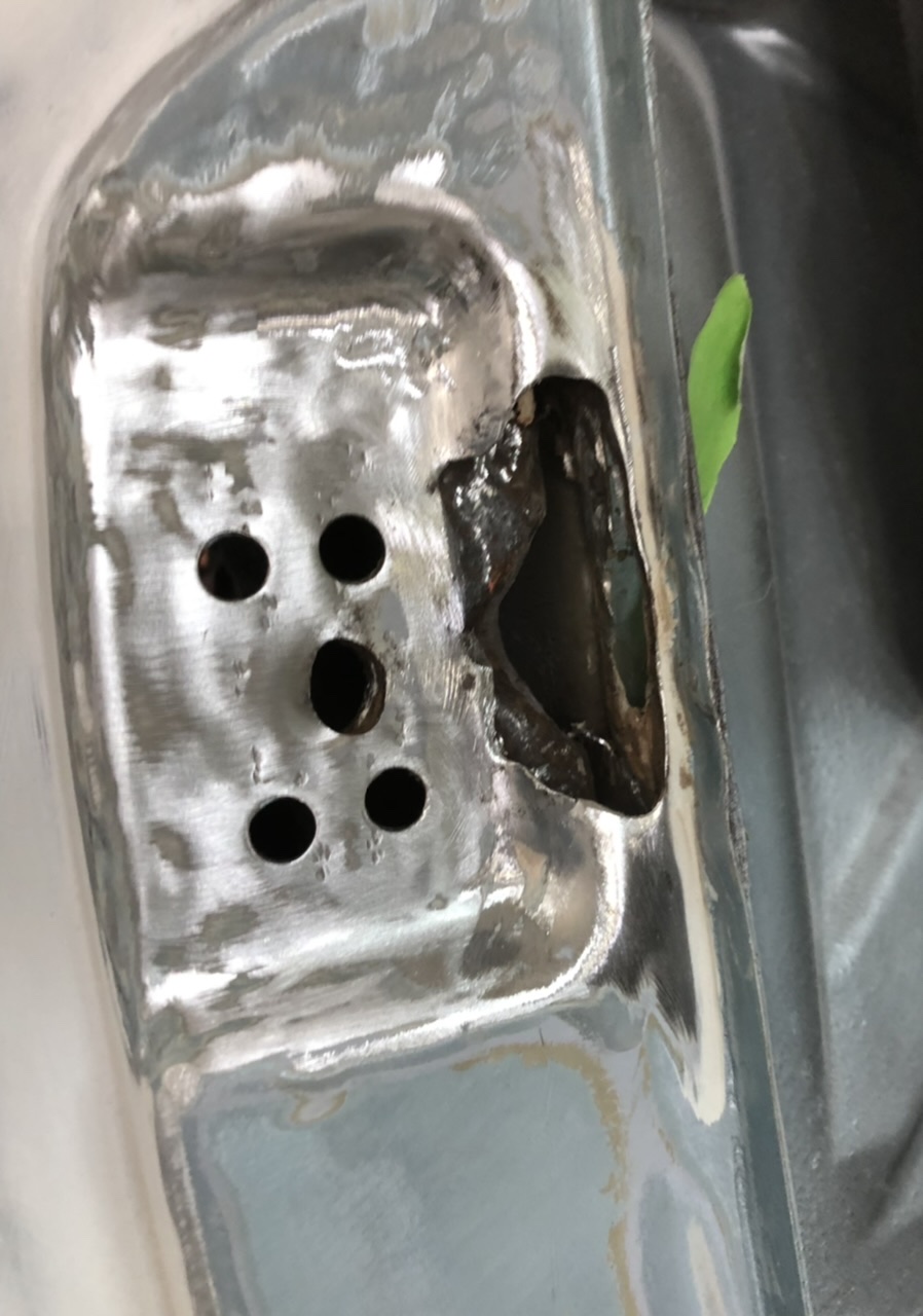

Dion   Also some body filler escaped proper contouring fr...   Jan 26 2017, 04:27 PM
Dion   Hammered.   Jan 26 2017, 04:27 PM

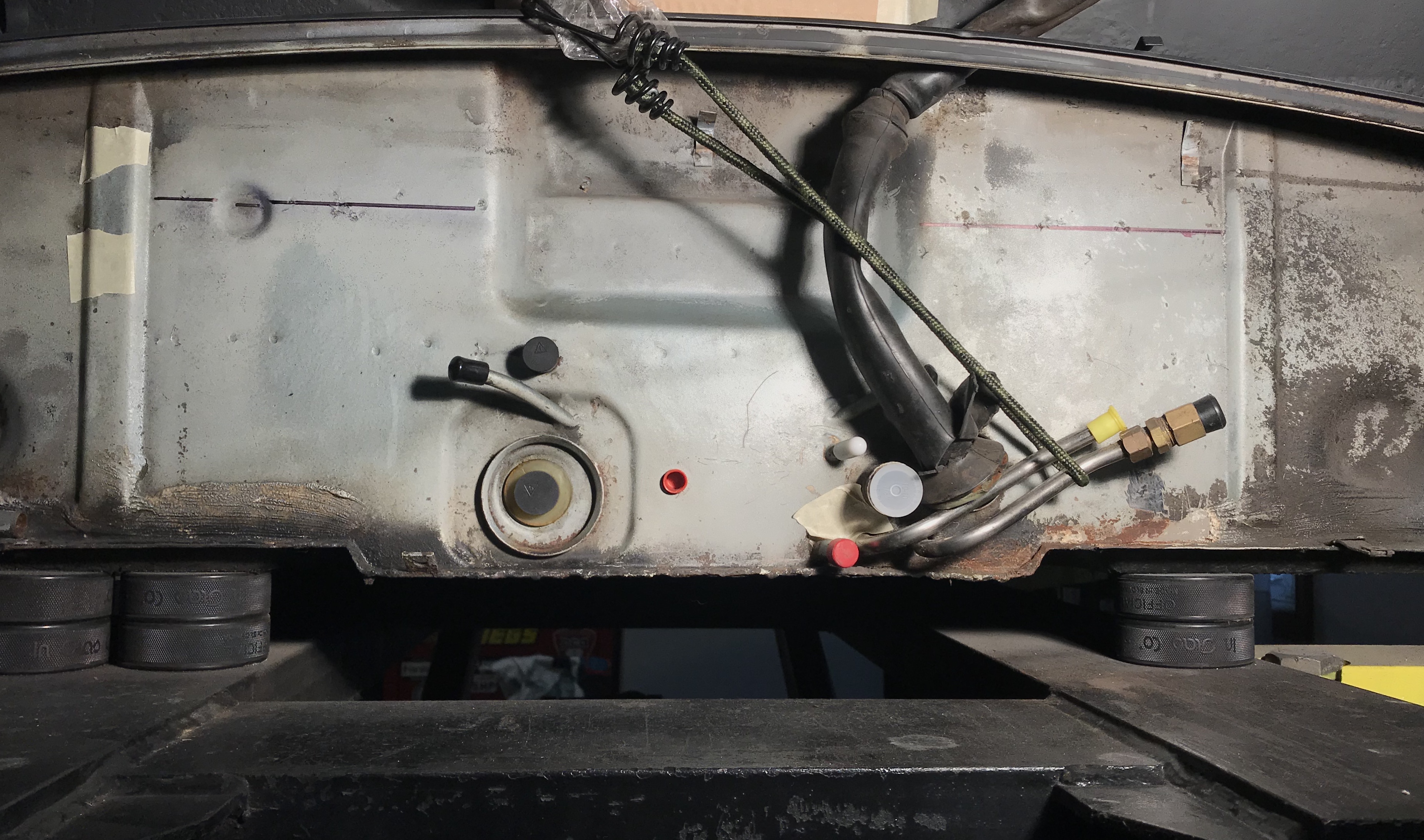

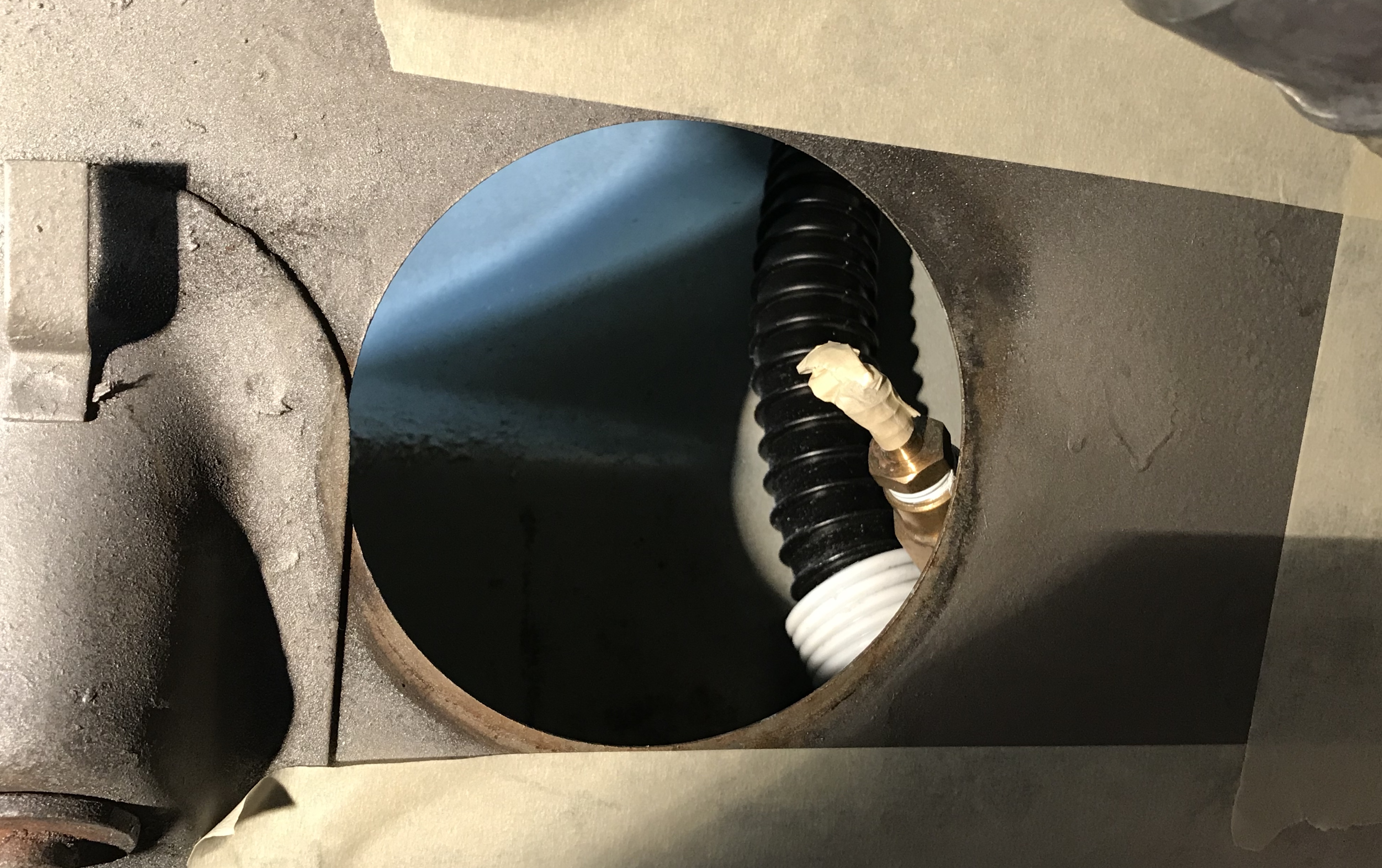

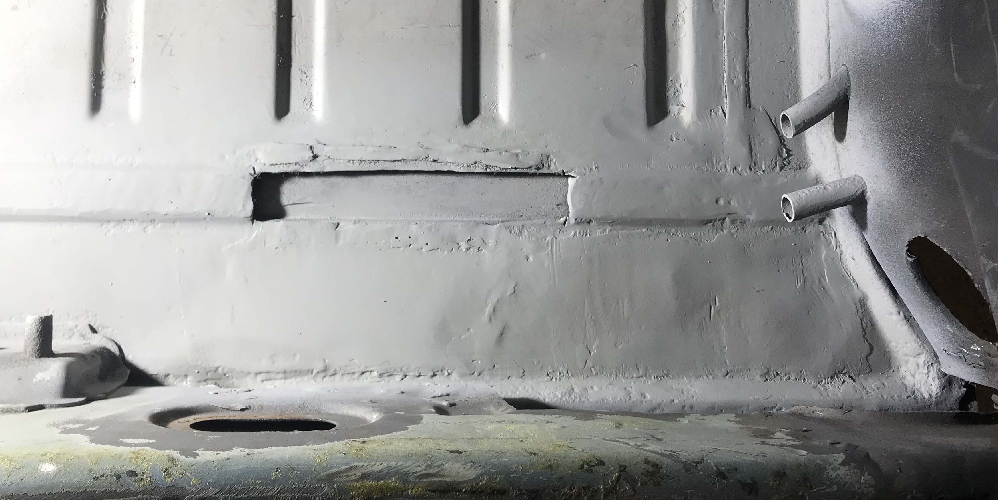

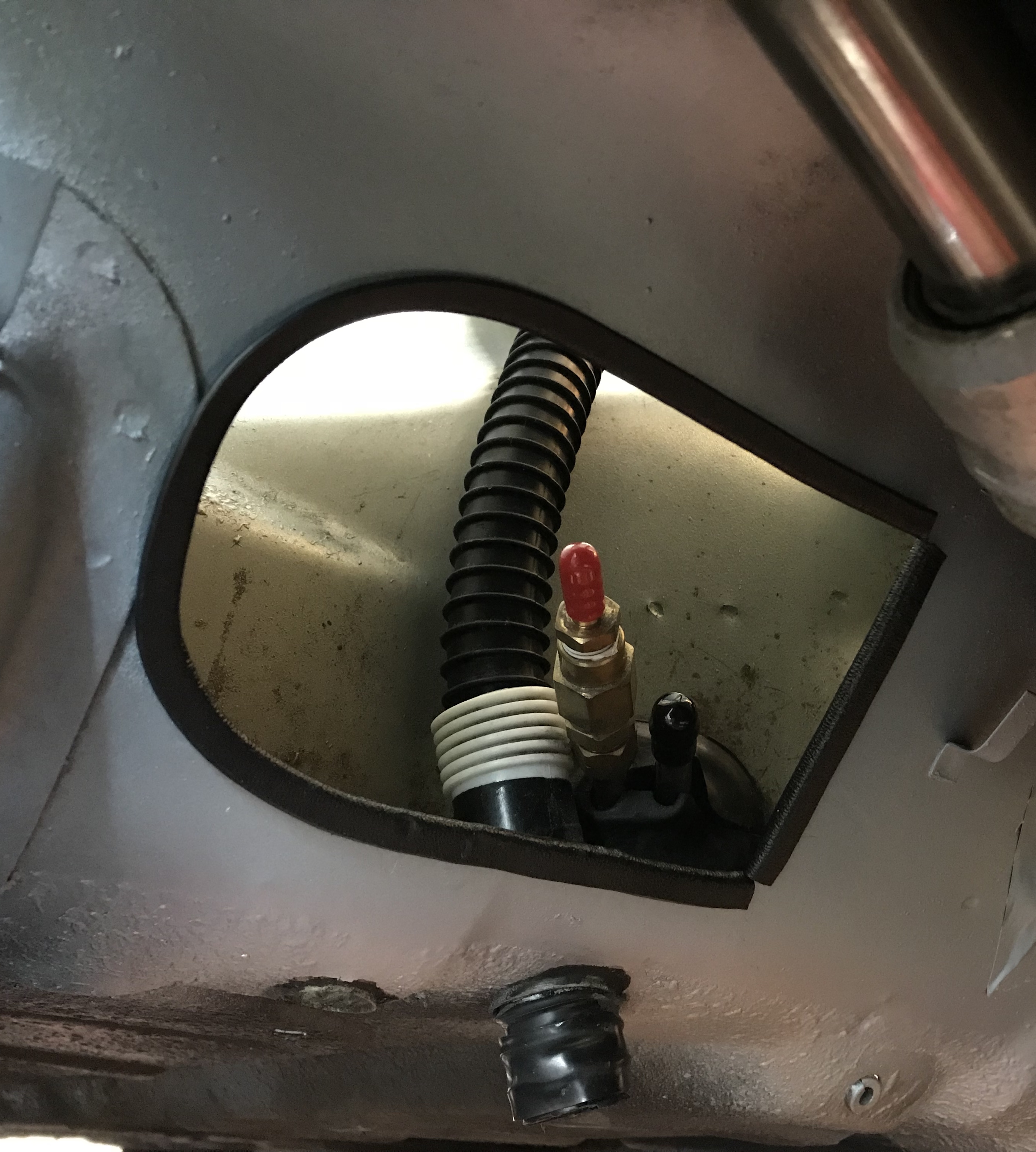

Dion   Curious? Anyone have a "proper" hole on ...   Jan 26 2017, 04:31 PM
altitude411   Curious? Anyone have a "proper" hole on...   Jan 26 2017, 04:49 PM
Dion   Tow hook spot?   Jan 26 2017, 04:32 PM
914dave   Mine has the same hole. No idea what it's for.   Jan 26 2017, 04:49 PM
tom.esh   My replacement pan has that hole. I don't thin...   Jan 26 2017, 06:29 PM

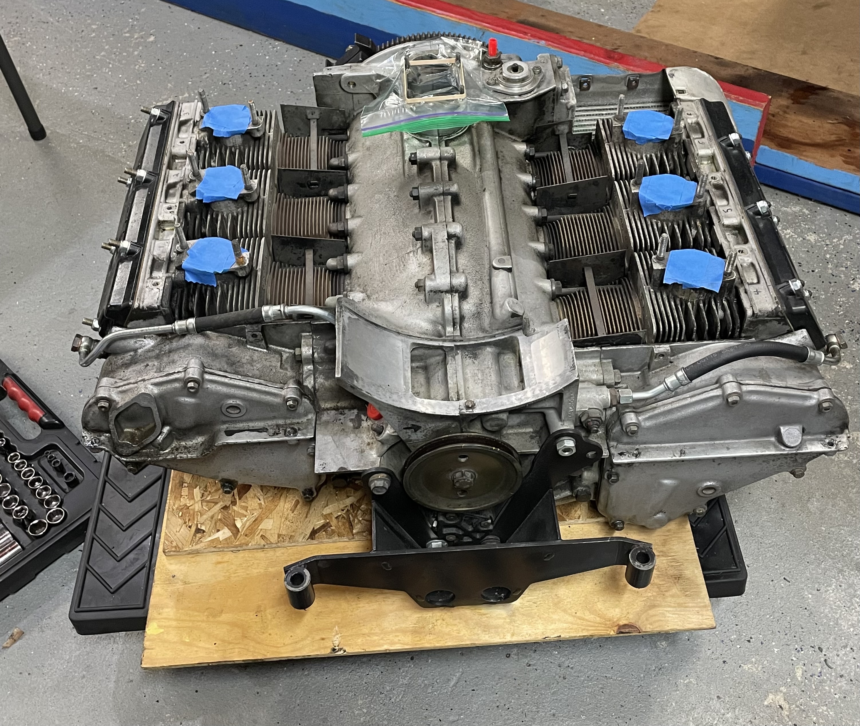

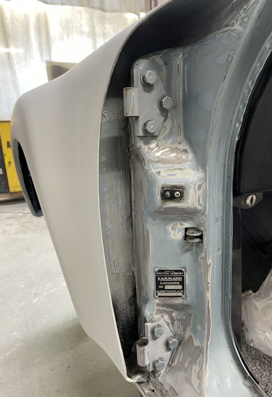

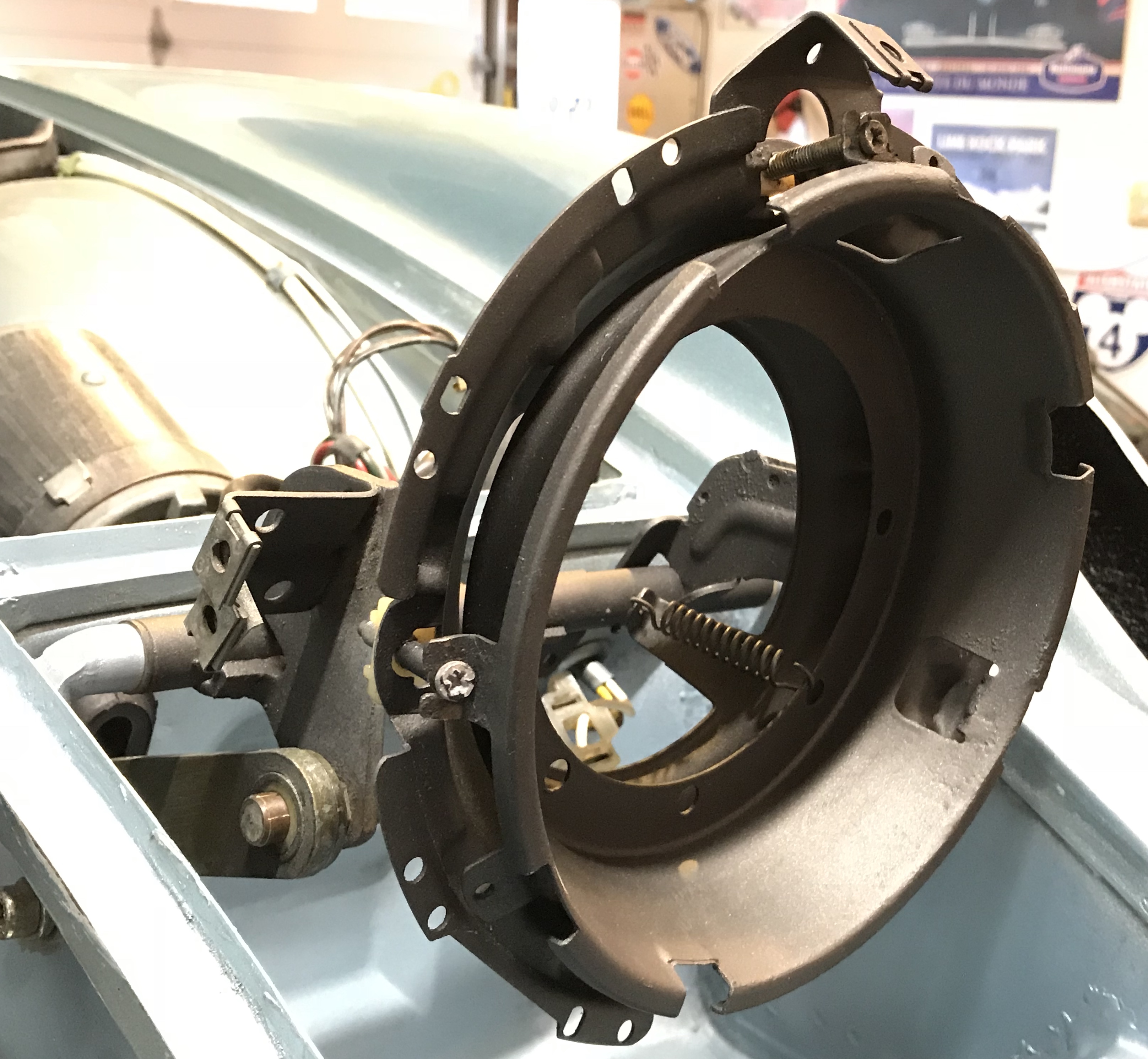

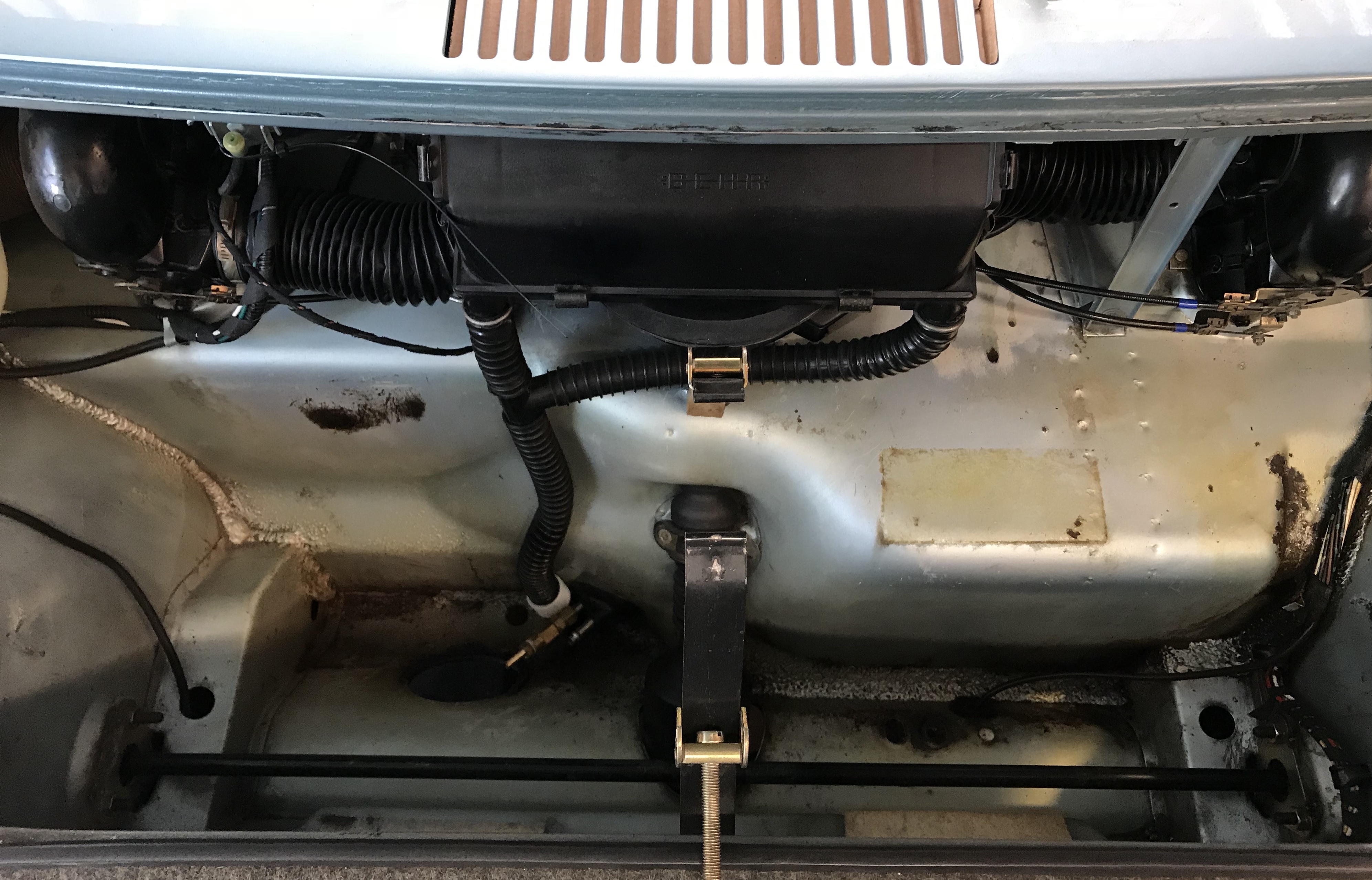

Dion   Bodywork has come full stop for now. Temps are in ...   Feb 5 2017, 10:26 AM
Dion   Took the carbs off for cleaning and replaced all t...   Feb 5 2017, 10:28 AM
Dion   Found the ball that was supposed to be on the spri...   Feb 5 2017, 10:30 AM
Dion   Replaced the alternator and painted the fan and s...   Feb 5 2017, 10:43 AM
Dion   Shroud   Feb 5 2017, 10:47 AM
Dion   Fan installed   Feb 5 2017, 10:51 AM

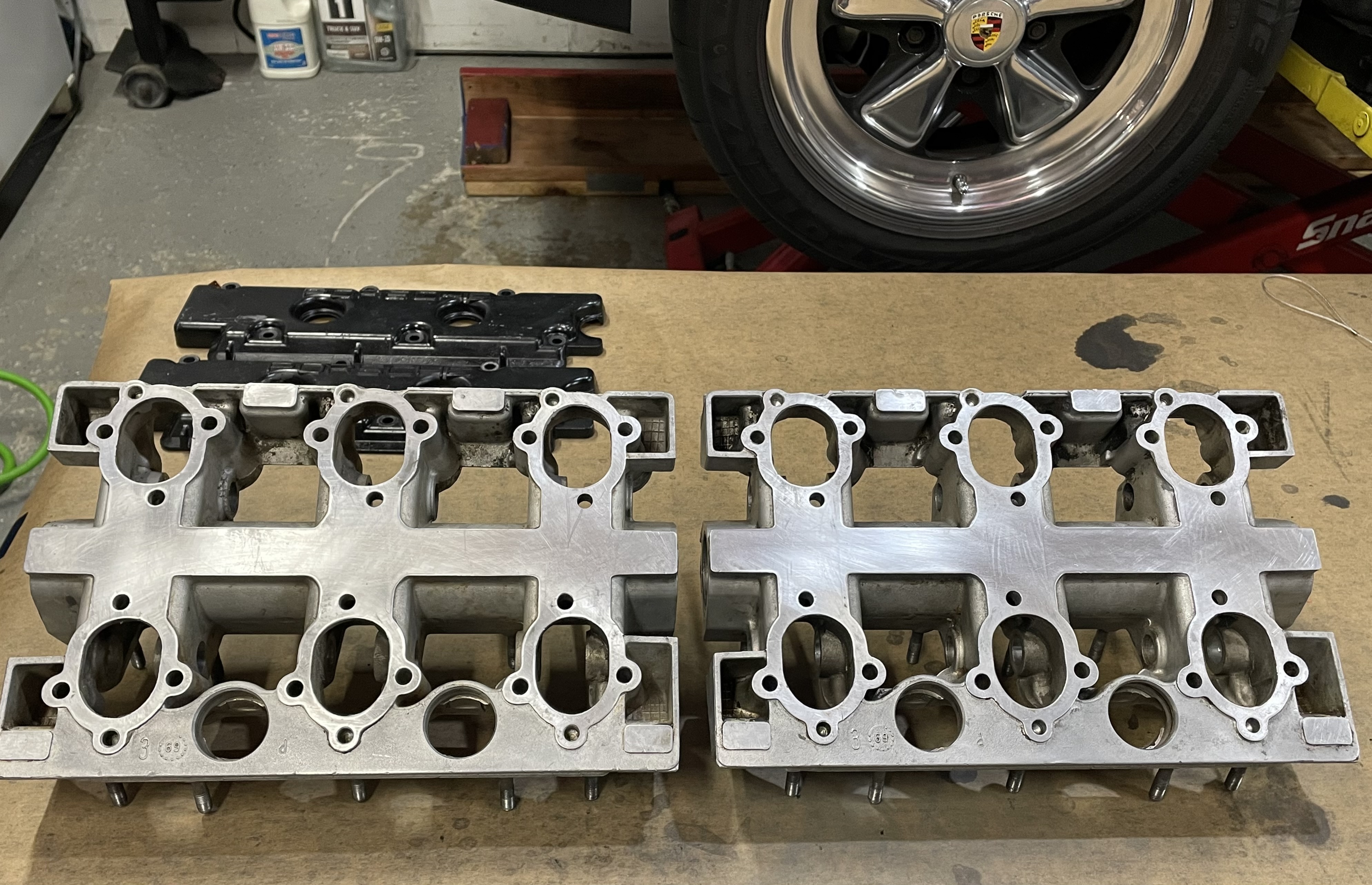

Dion   So the upper valve covers that I did in silver pai...   Feb 5 2017, 11:00 AM
Dion   Put the carbs back on. Added the surrounding sheet...   Feb 5 2017, 11:04 AM
Dion   Engine tin   Feb 5 2017, 11:06 AM

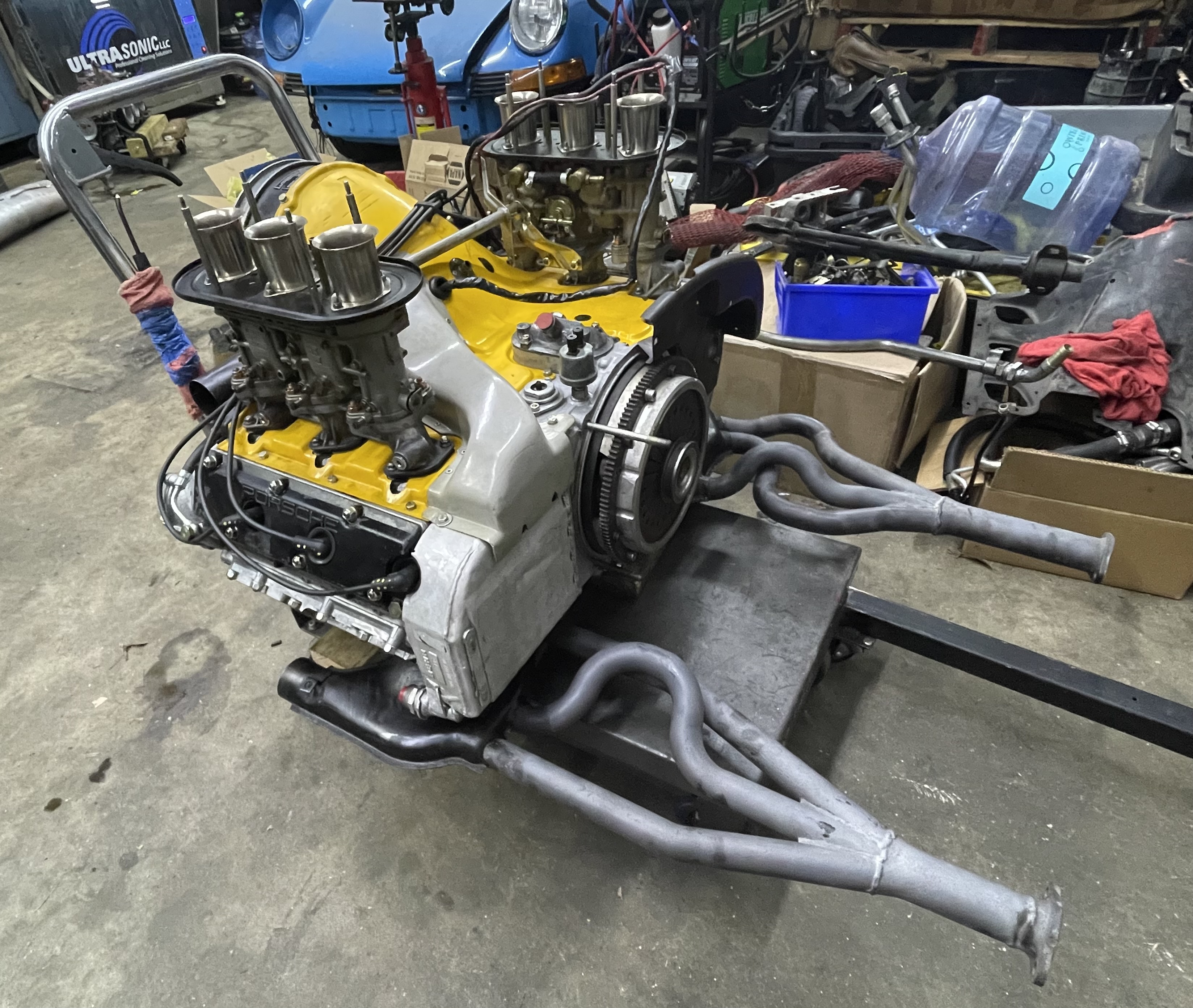

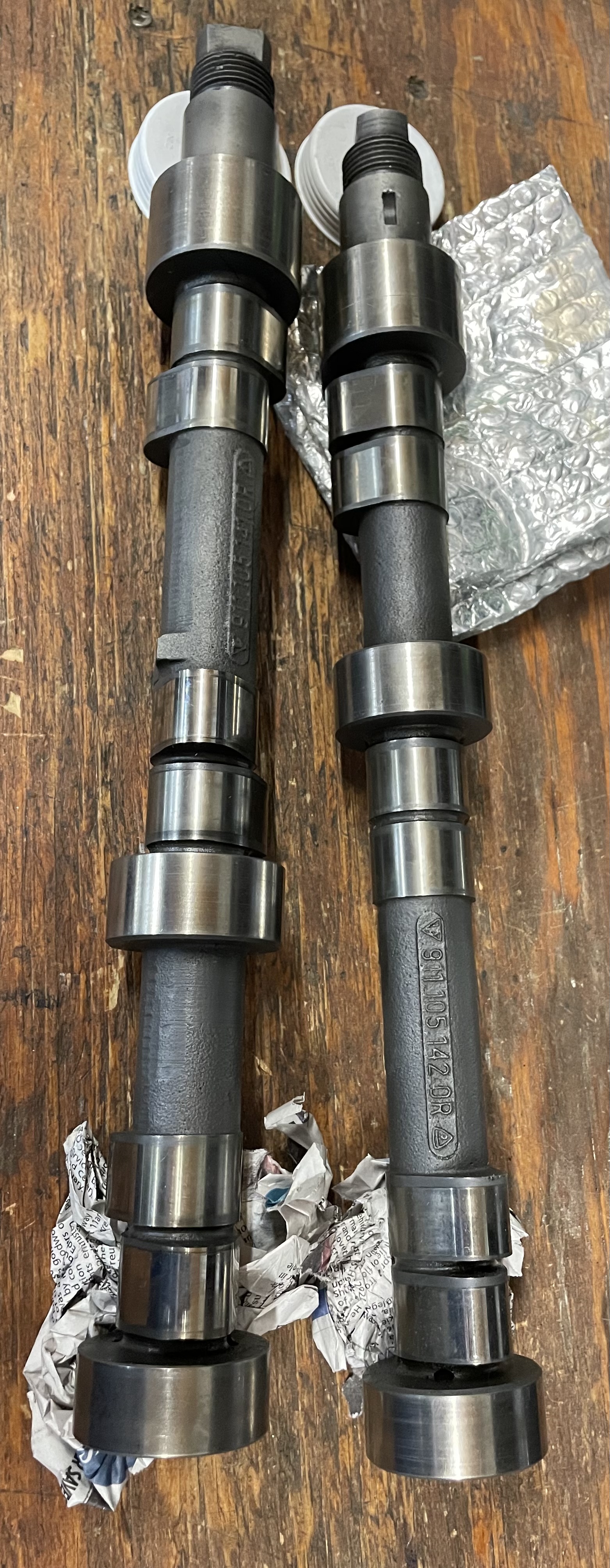

porschetub   Nice work on the motor Dion,what history do you ha...   Mar 19 2017, 02:37 PM
Dion   Hey Dean, thanks for the compliments. I can't ...   Mar 19 2017, 03:41 PM

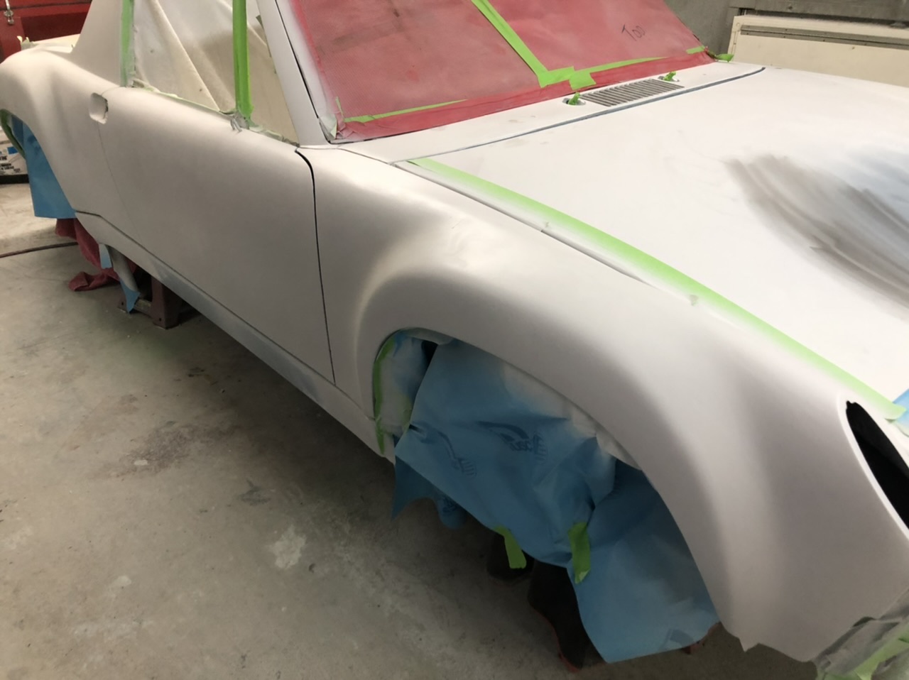

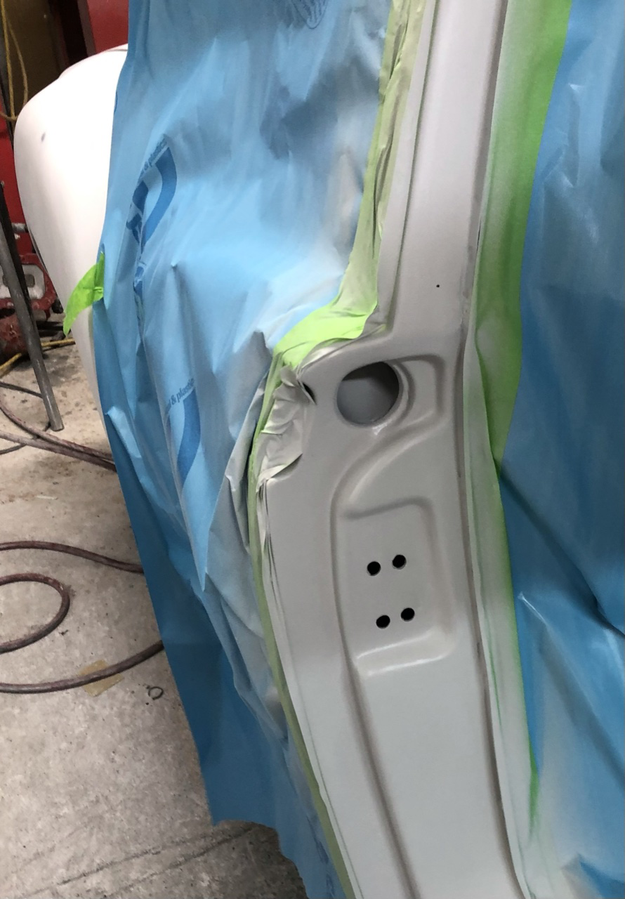

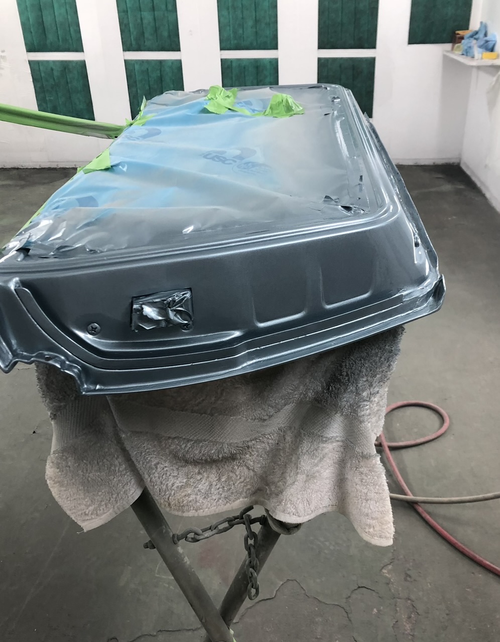

Dion   So it's sort of warming up here. Did a little ...   Mar 19 2017, 03:45 PM
Dion   Primer & paint.   Mar 19 2017, 03:46 PM
porschetub   Cool sounds like a nice engine with great mods,you...   Mar 19 2017, 06:18 PM
Dion   Dean, I wish I could say E cams but alas it's ...   Mar 19 2017, 06:53 PM
