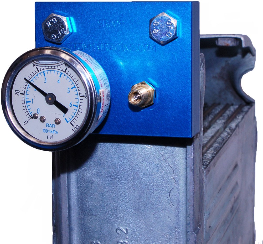

If you want I will ship you our Stompski pressure tester. It's super easy to use and will confirm if the cooler is good or not.

QUOTE(mepstein @ Sep 12 2016, 10:03 AM) *
Thanks. I presume I pull the cooler and test it? Wayne Dempsey mentions the possibility of the seals going cocked and recommends oiling them. Not sure I did that, but the engine was on a stand at the time. Wondering if my tig failed somewhere too. Problem with oil leaks is there is usually oil all over and finding them when you cannot see everything can be tricky. I will let you know as the story develops. If anyone else has advice please chime in. I may have to import the mouse piss.

Yes. You have to pull cooler completely to test.
