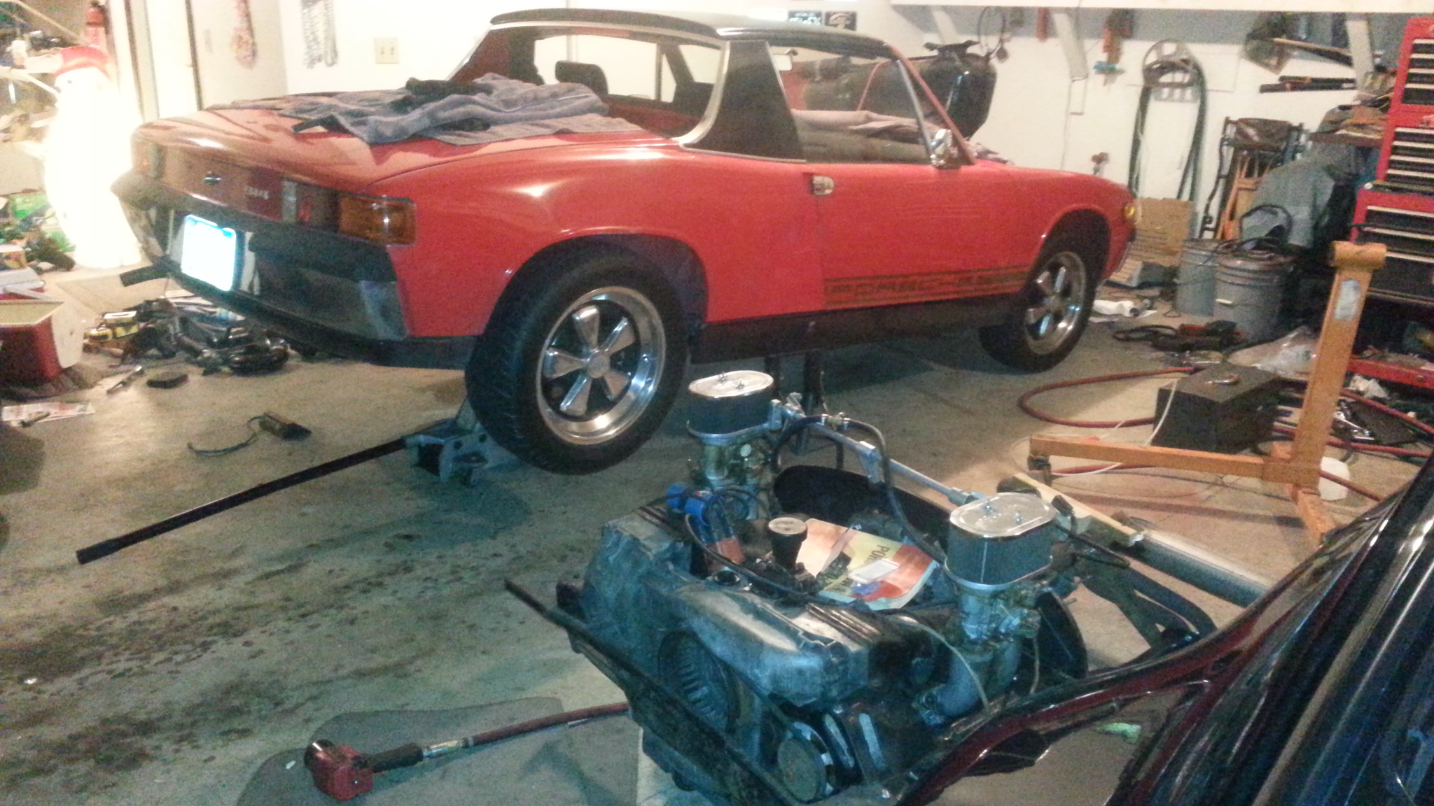

I bought this allegedly running-when-it-was-pulled 2L engine last year to upgrade to 2.056L just to find out it already had 96mm P&C.
Internals turns smoothly so I thought I'd do the flame test and clean the engine and put it back together. The engine runs strong and smooth.
As I started driving it harder I noticed on fast deceleration the oil light would come on.
If I let the engine speed come down naturally from about 2k, the oil light doesn't come on.
Last night coming off the highway running about 3.2k, I immediately shifted into neutral to let the engine slow on its own, the oil light came on for a few seconds as the engine was now idling.
I don't have an oil pressure gauge on it to see where the oil pressure is during operation.
Any ideas of what to look at?
