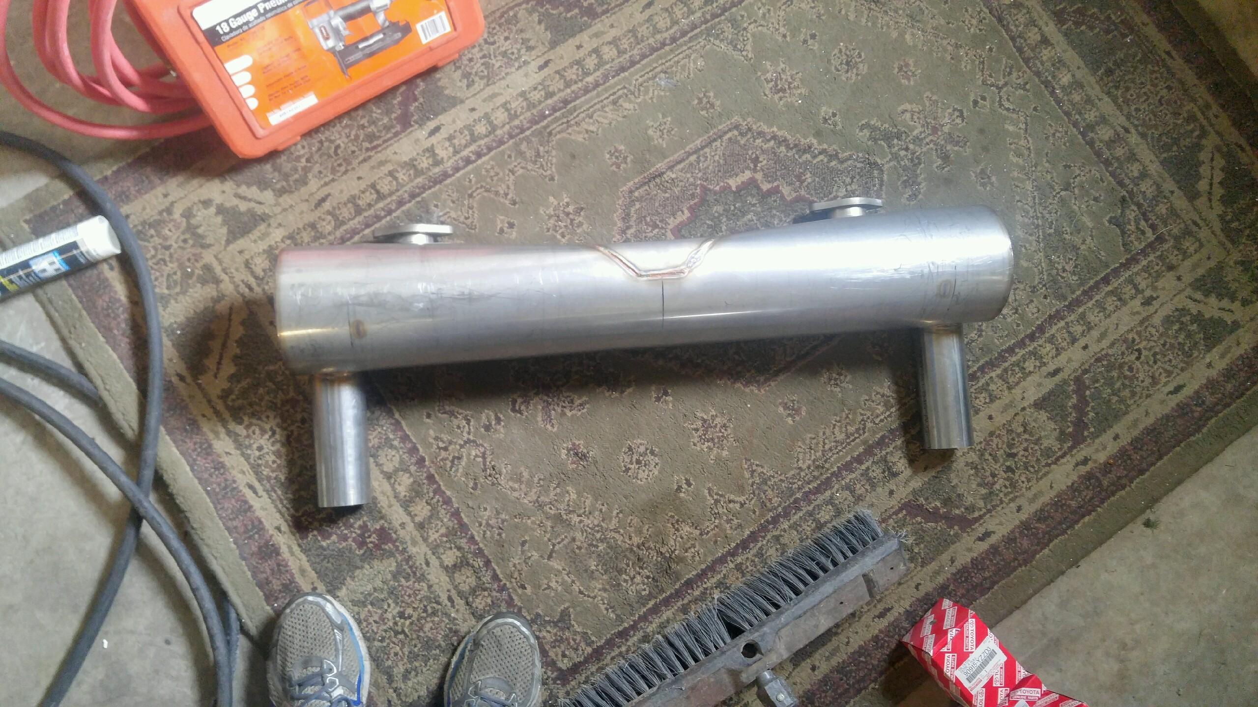

mb911
post Sep 13 2016, 02:28 PM
Posts: 7,613
Joined: 2-January 09
From: Burlington wi
Member No.: 9,892
This what I am referring to although this is with 911 heatexchanger s

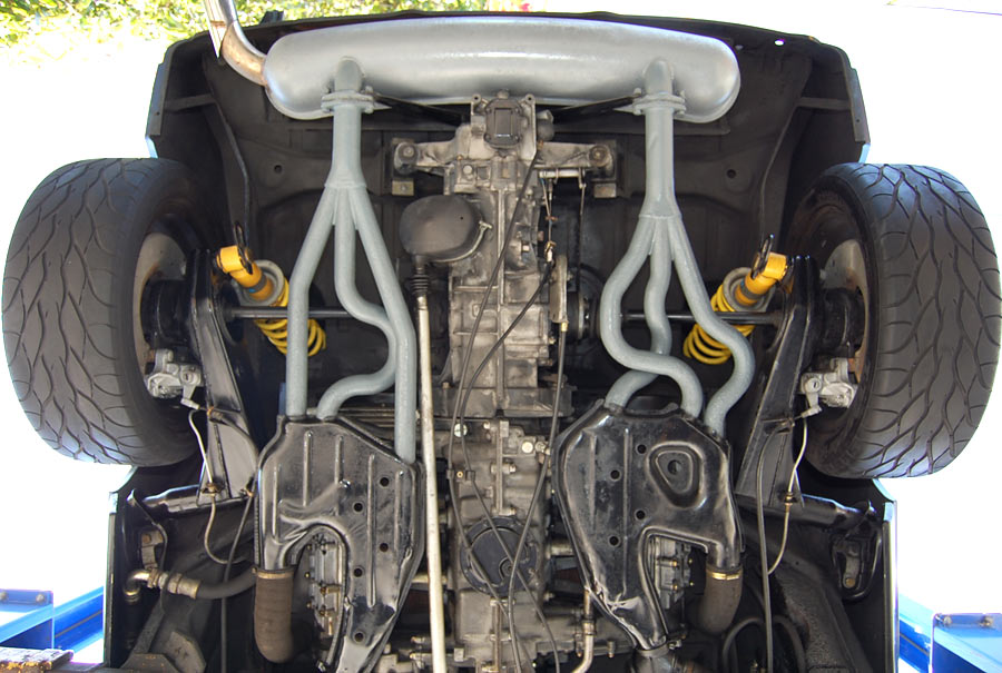

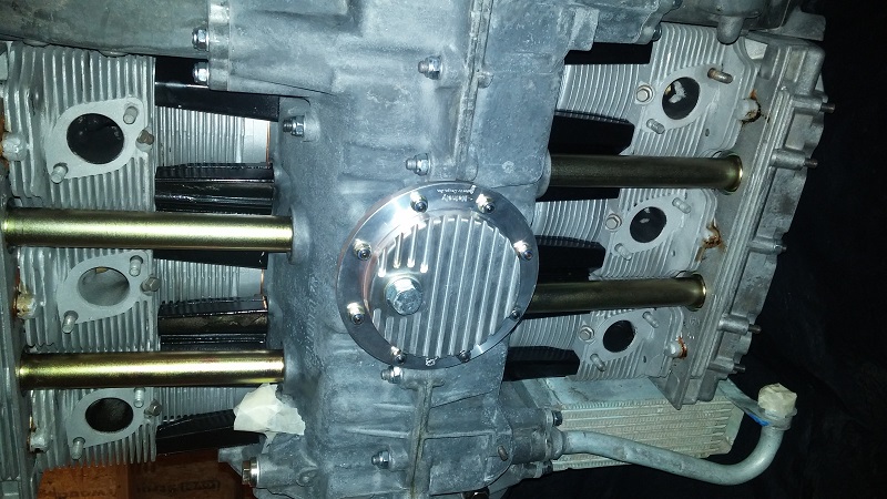

Luke M
post Sep 13 2016, 04:36 PM
Posts: 1,416
Joined: 8-February 05
From: WNY
Member No.: 3,574
QUOTE(mb911 @ Sep 13 2016, 01:28 PM) *
I think I know what you're asking here....
Now if you look at the 911 engine the cylinder heads do not align from side to side.
They are off so that makes one header longer then the other...
Is that what you're asking?
I added a few pics so you can see what I'm talking about.

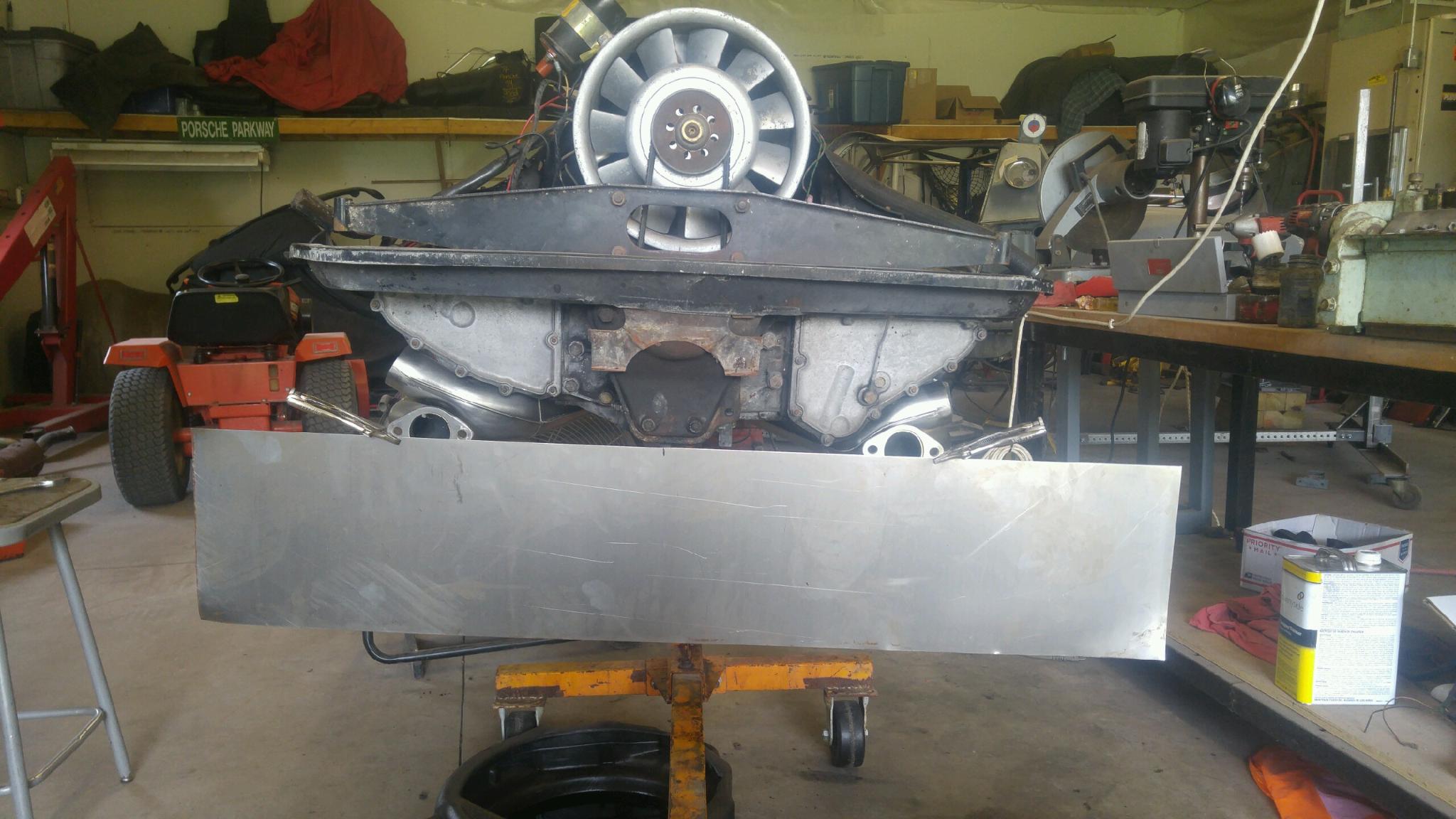

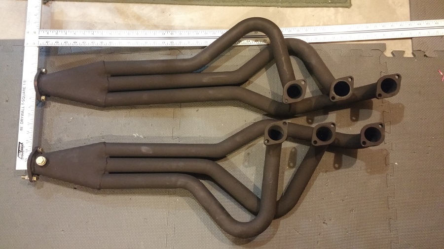

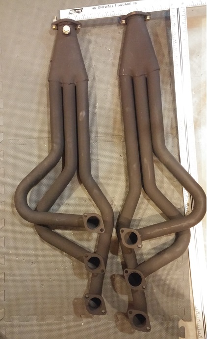

mb911
post Sep 13 2016, 04:44 PM
Posts: 7,613
From: Burlington wi
Member No.: 9,892
I guess to clarify. Look at the picture of the engine in my shop and see how the straight edge lines up with all the bolt holes. This does not happen with the exchangers I have for a 914-6. Sample.. They are rotated.
Luke M
post Sep 13 2016, 04:53 PM
Posts: 1,416
From: WNY
Member No.: 3,574
QUOTE(mb911 @ Sep 13 2016, 03:44 PM) *
Ok, I see what you're saying now. It could be one of your test headers is bent or repaired in the past ?
I would need to mount my headers on the engine to see if things align. I can do that if you need another look at things. Let me know..
