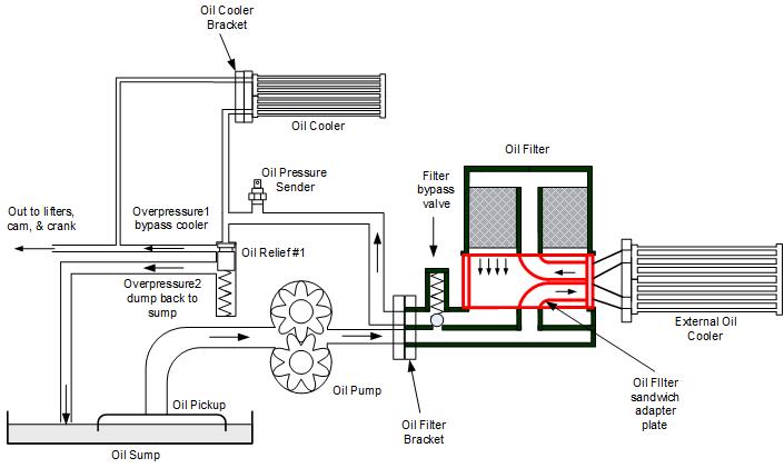

This is the focus of the OP I believe:
(IMG:http://www.914world.com/bbs2/uploads_offsite/i366.photobucket.com-10819-1474721992.1.jpg) I considered drilling & tapping the hole for a plug. Since I run a K&P oil filter, & clean it frequently I didnt see it ever getting clogged enough to trigger that valve. But if you have a OC loop in between the bracket and the filter and the oil is really cold and the oil doesnt want to flow towards the oil cooler (yet) I thought leaving the ball valve stock was sort of a thermostat. This might help: (IMG:http://www.914world.com/bbs2/uploads_offsite/i366.photobucket.com-10819-1474722504.1.jpg) |

Thanks for the input and flow diagrams.
It is clear from the flow diagrams that the filter relief valve has the ability to reduce the flow to an outside in series filter and cooler that is connected directly to the stock oil filter console. This confirms the explains the experienced advice. Unfortunately it is also clear that while there are several ways to eliminate this by pass valve function, they require removing the engine to either; 1) access the upper oil filter console nut to remove the console for modification, or 2) to connect the external filter/cooler system to the galley plugs next to the oil pump. |

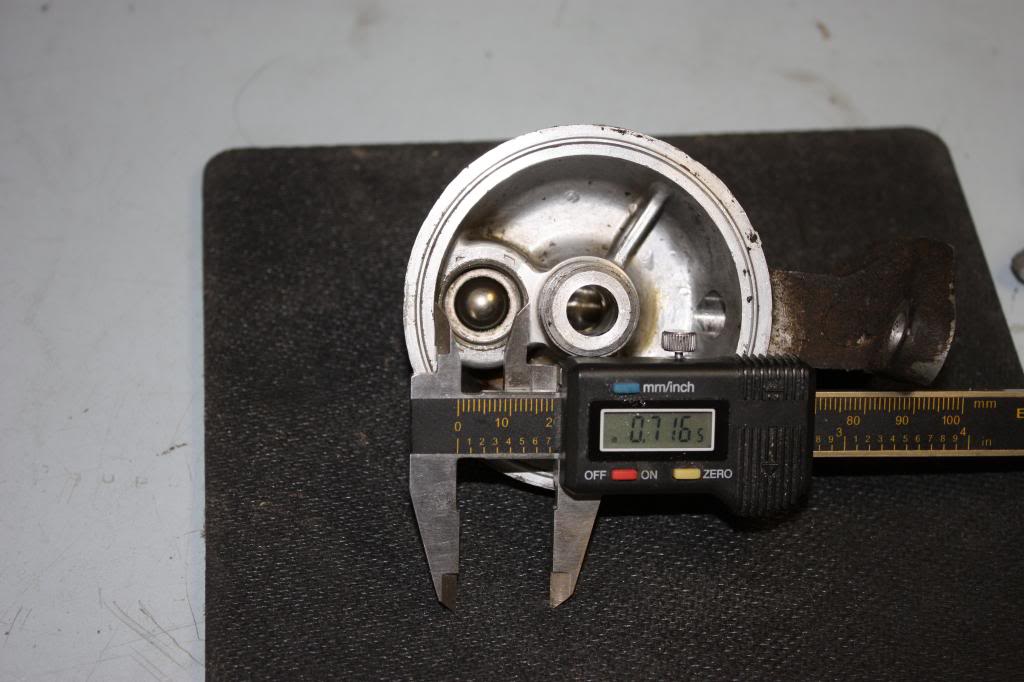

| stugray |
Nov 3 2016, 02:26 PM
#18
Advanced Member ![]() ![]() ![]() ![]() Group: Members Posts: 3,825 Joined: 17-September 09 From: Longmont, CO Member No.: 10,819 Region Association: None |
| jim_hoyland |
