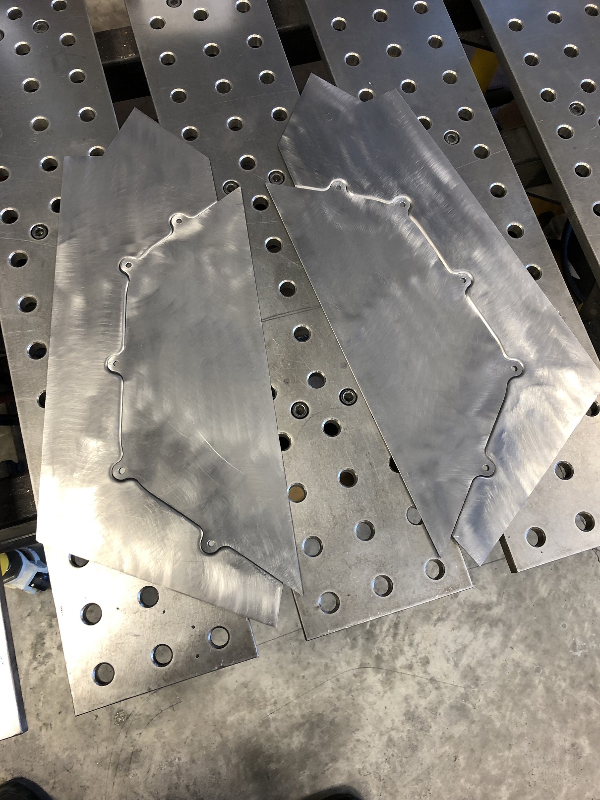

Today I cut V1 of the dog house side panels. Next is to design something to stamp in these to add some stiffening and visual appeal.

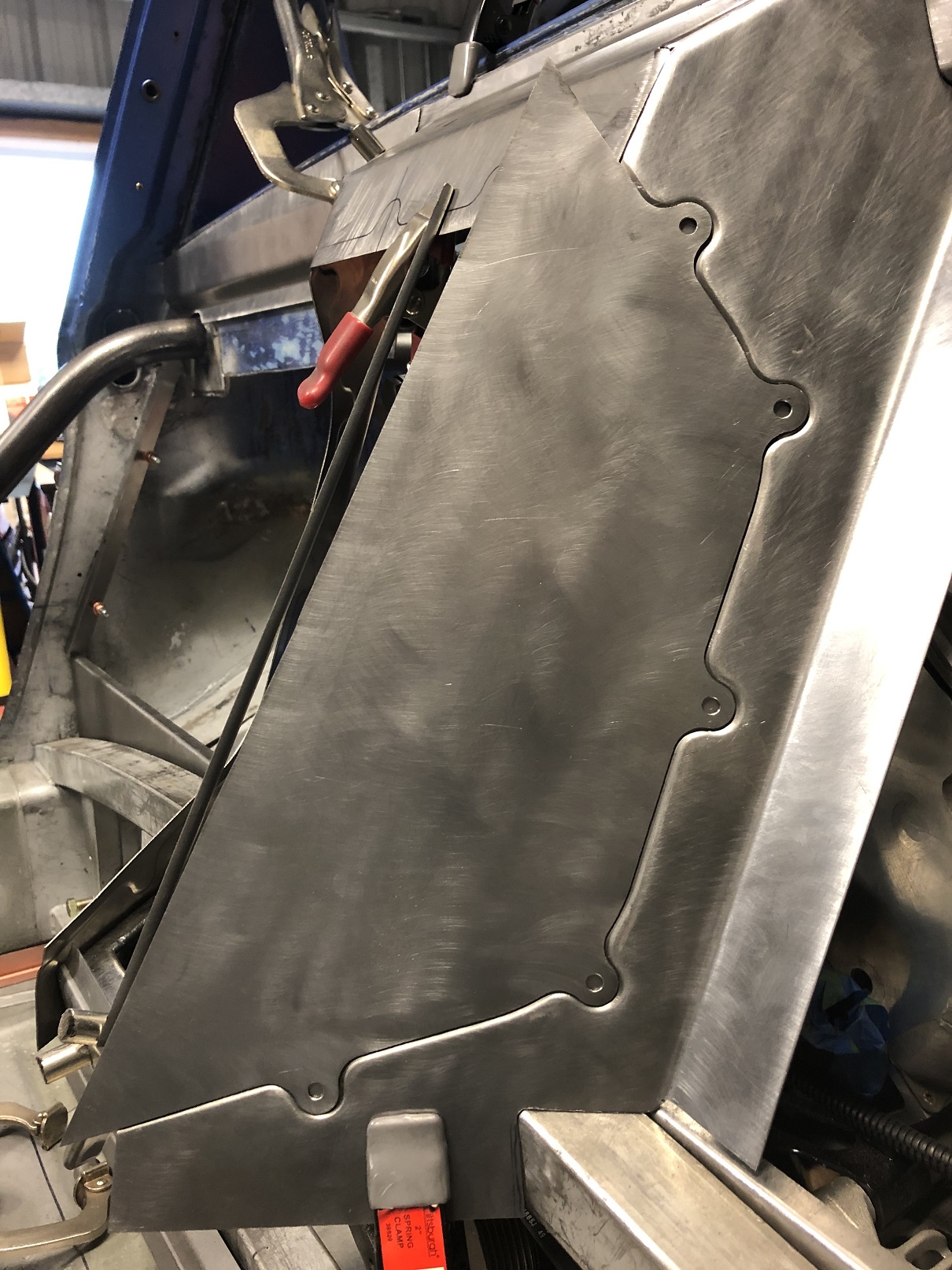

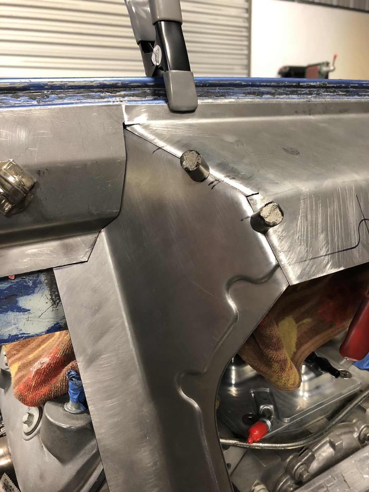

Today was fitting the stamped recess side panels.
I first have to get them to fit at the upper part of the dog house. A lot of fit, trim, fit, sand, fit to sneak up on it. It is a bit tricky, what with the all the angles, but this turned out better than the earlier effort.

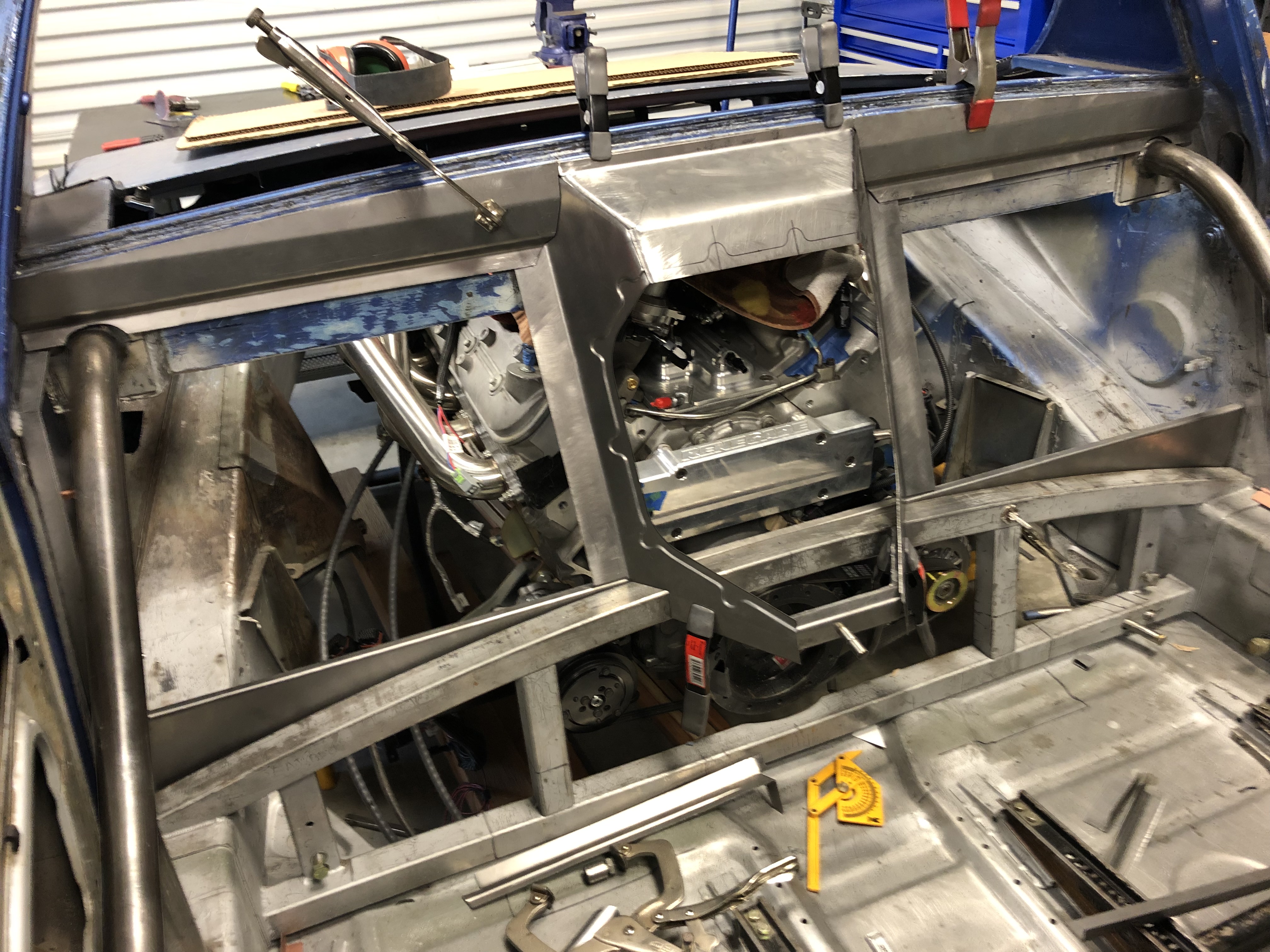

Once that panel is fit, I have to fold the outer edge and create the inner vertical landing area for the main fire wall panel. This is also lots of fun as this fold has to place this part of the panel in alignment with angles on two other separate pieces.
The fab gods were smiling on me today and I got it right where I wanted it.
This pic shows how it aligns with the corner area of that upper piece, to the left of the dog house top.

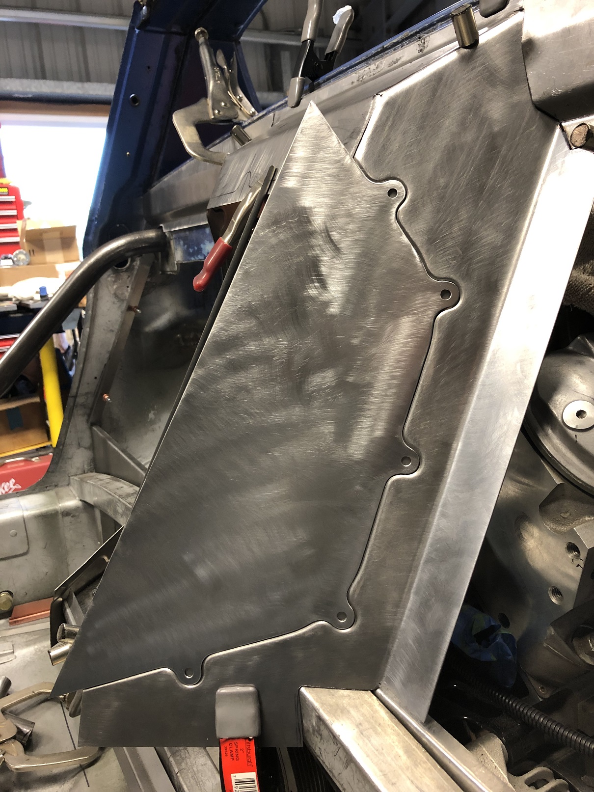

Then just do it all again on the other side! Here you can see how the side panel has to fit at the bottom.

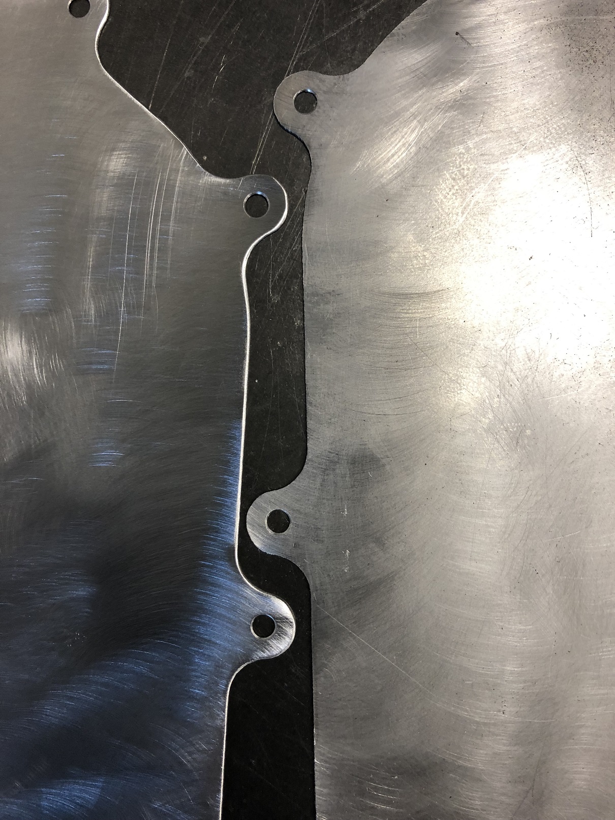

One thing the plasma table doesn't do is leave any sort of nice radius edge.
So I tried out using a conditioning pad on the angle grinder to see if I could soften the radius of the removable cover parts.
You can see how sharp the raw edge (right) is vs. the left one, which is after hitting it with the conditioning pad. I'll need to tune the edge a bit more and see if I can get it more consistent.

But even a first try makes a noticeable difference.
Raw edge:
post Dec 9 2018, 05:22 PM
Post #1390
Posts: 5,847
Massaged edge.

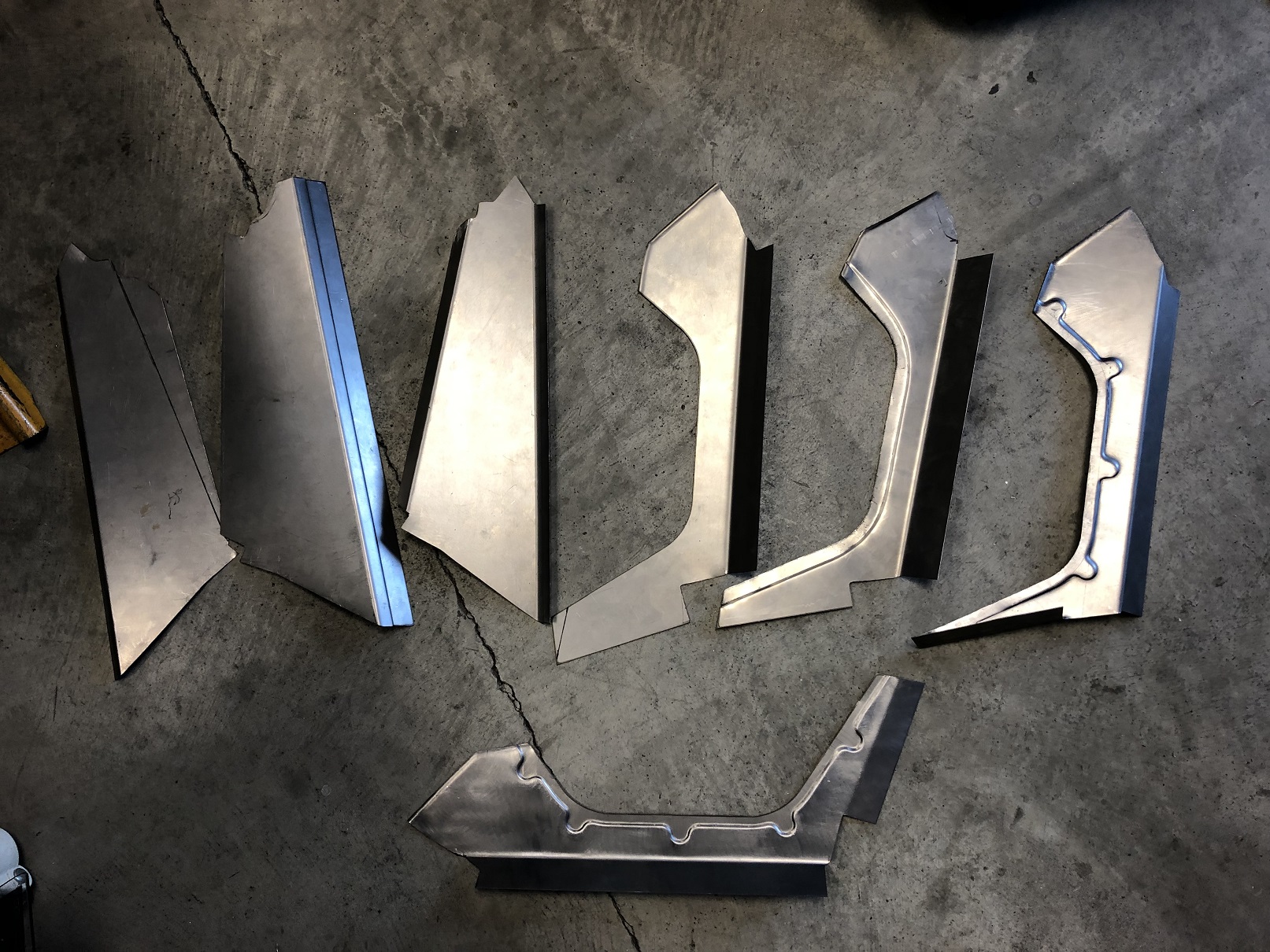

And so no one thinks this part came together any easier or faster than other parts of this build, here's the "evolution" of the side panel designs. Read from left to right, with the current "final" design at the bottom. (And this isn't even all of them... but you get the idea.)
On a related topic, I just finished "Grit" by Angela Duckworth. A good read, if you're looking for one. I came away from it with insight into some of the reasons I tend to do the things I do, like redoing things multiple times. Quite interesting...

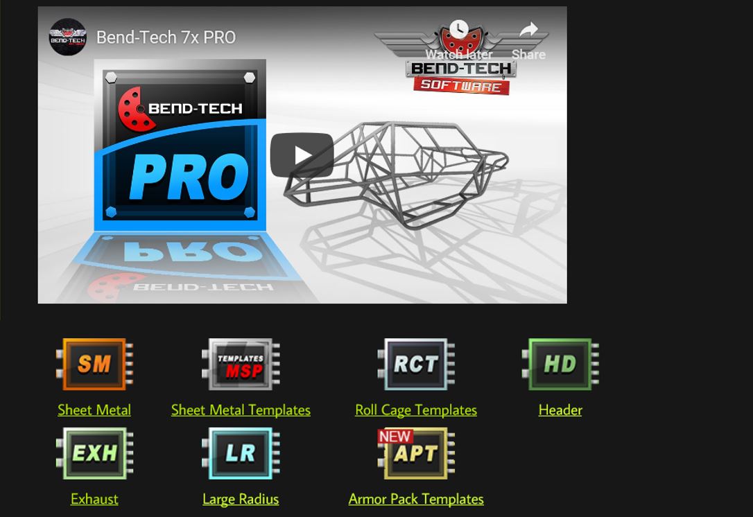

Ah, well. But it helped me realize it was time I get serious about computer designing more things. I've wasted too much time and material with my not-so-rapid prototyping.
So, I upgraded my digital toolbox. Any guesses what this may portend? (IMG:style_emoticons/default/shades.gif) So far, the BendTech tools seem pretty capable and easy to use. Anyone else using BendTech? I'd be interested in talking with you... @Mueller ?
So hey @Andyrew - let's design and bend up the rest of your cage!
And seriously, if I can help anyone with what these tools can do, please let me know.

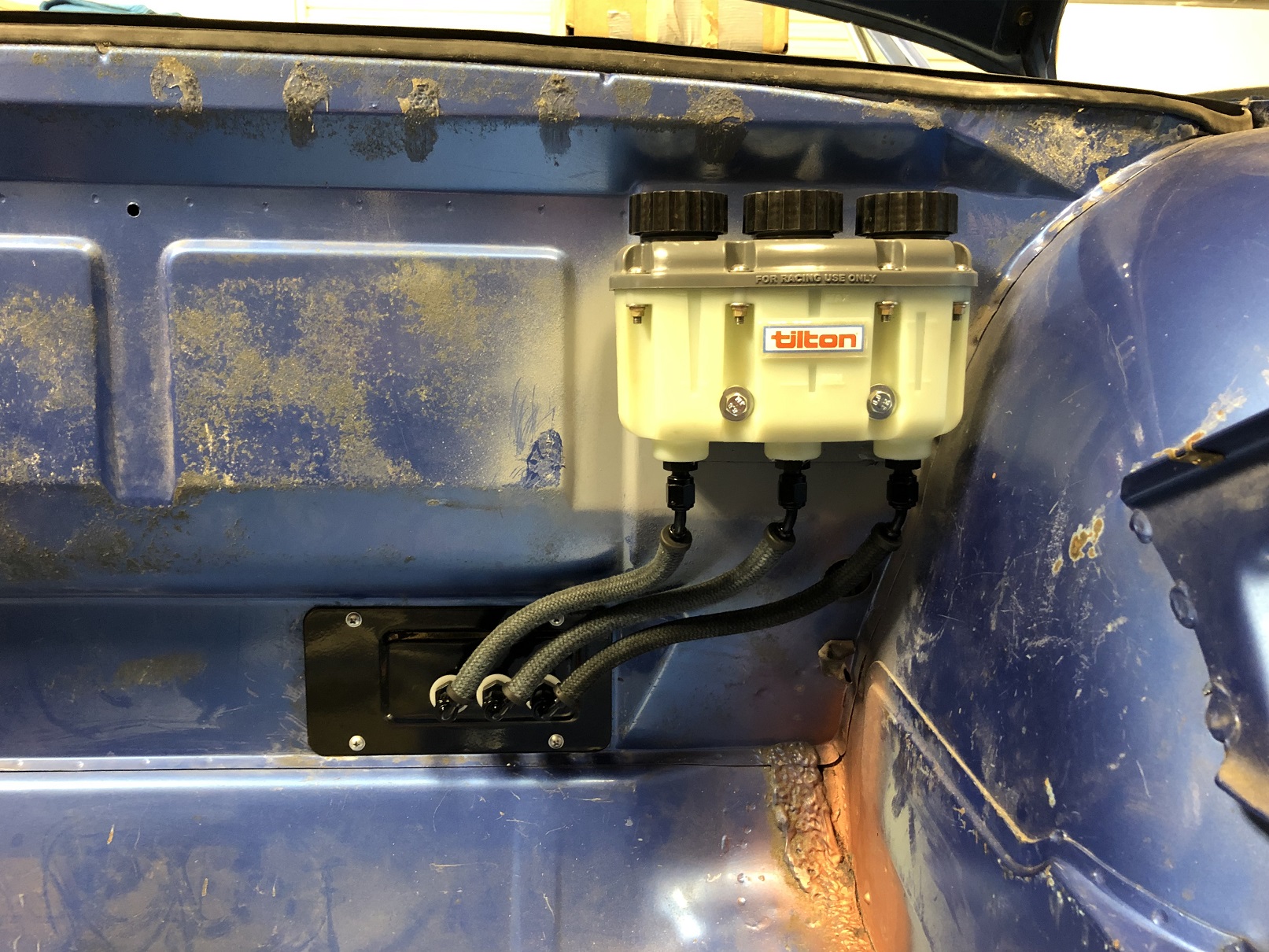

So today I made the last hose for the reservoir. Turned out pretty nicely.
I can't wait 'til all this new stuff is attached to a painted tub. It's gonna look lots better.
Hopefully soon.

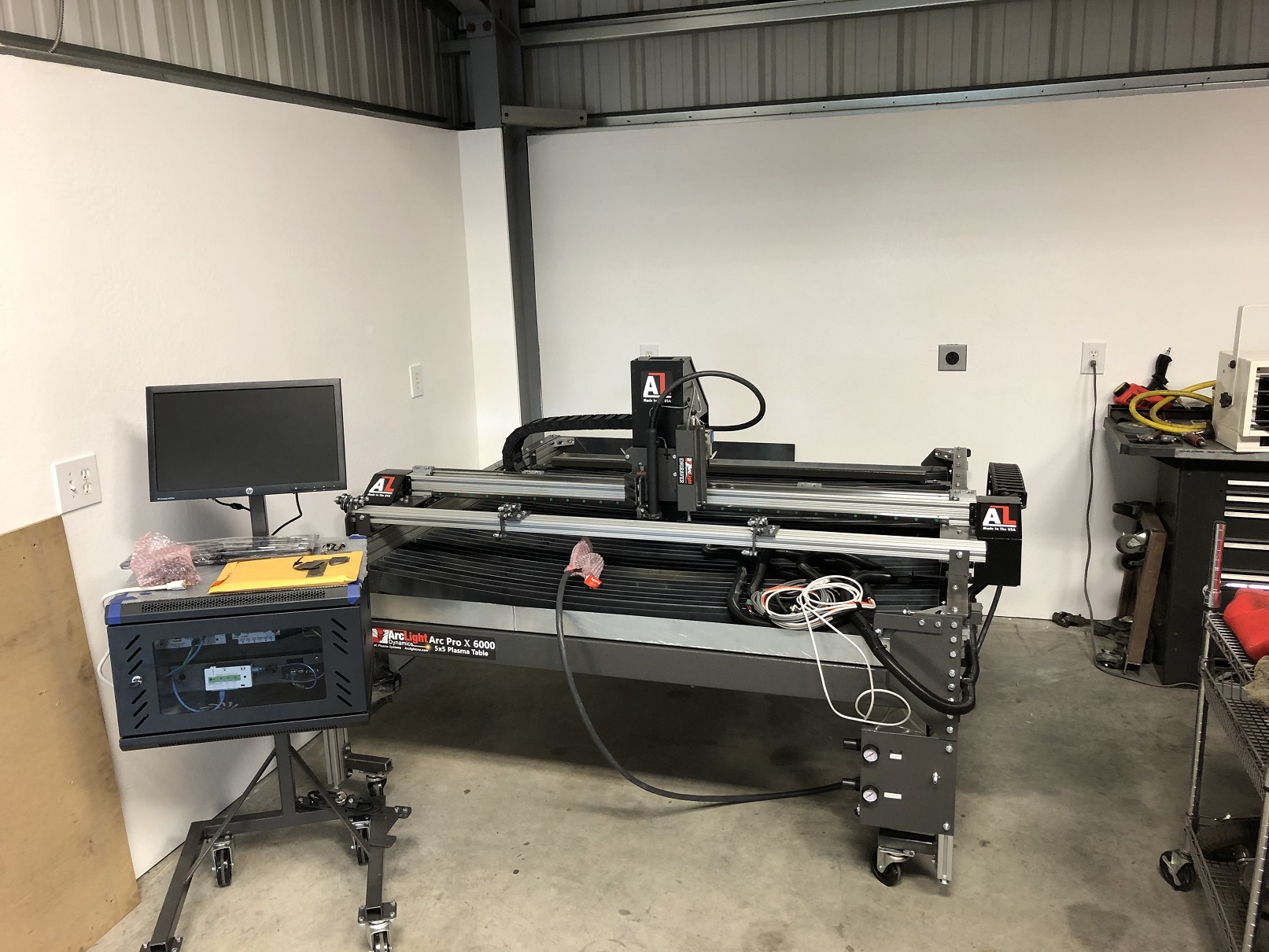

After a 3 day trip, driving to and from Bend, OR... It's here, in place and almost ready to go!
And a BIG thanks to Dan ( @Dan10101 ) and Becky for being super host and hostess and putting me up on Tuesday evening! It made the trip much less stressful.
As a bonus, I got to see his car up close: it's a beast! He's done a fabulous job on a very challenging chassis repair. Much of it you can't even tell is a repair! Very nice. (Now hurry up and get it done! (IMG:style_emoticons/default/poke.gif) (IMG:style_emoticons/default/laugh.gif) )
Back to my world: If anyone needs me, I'll be in the shop learning this incredible new tool!

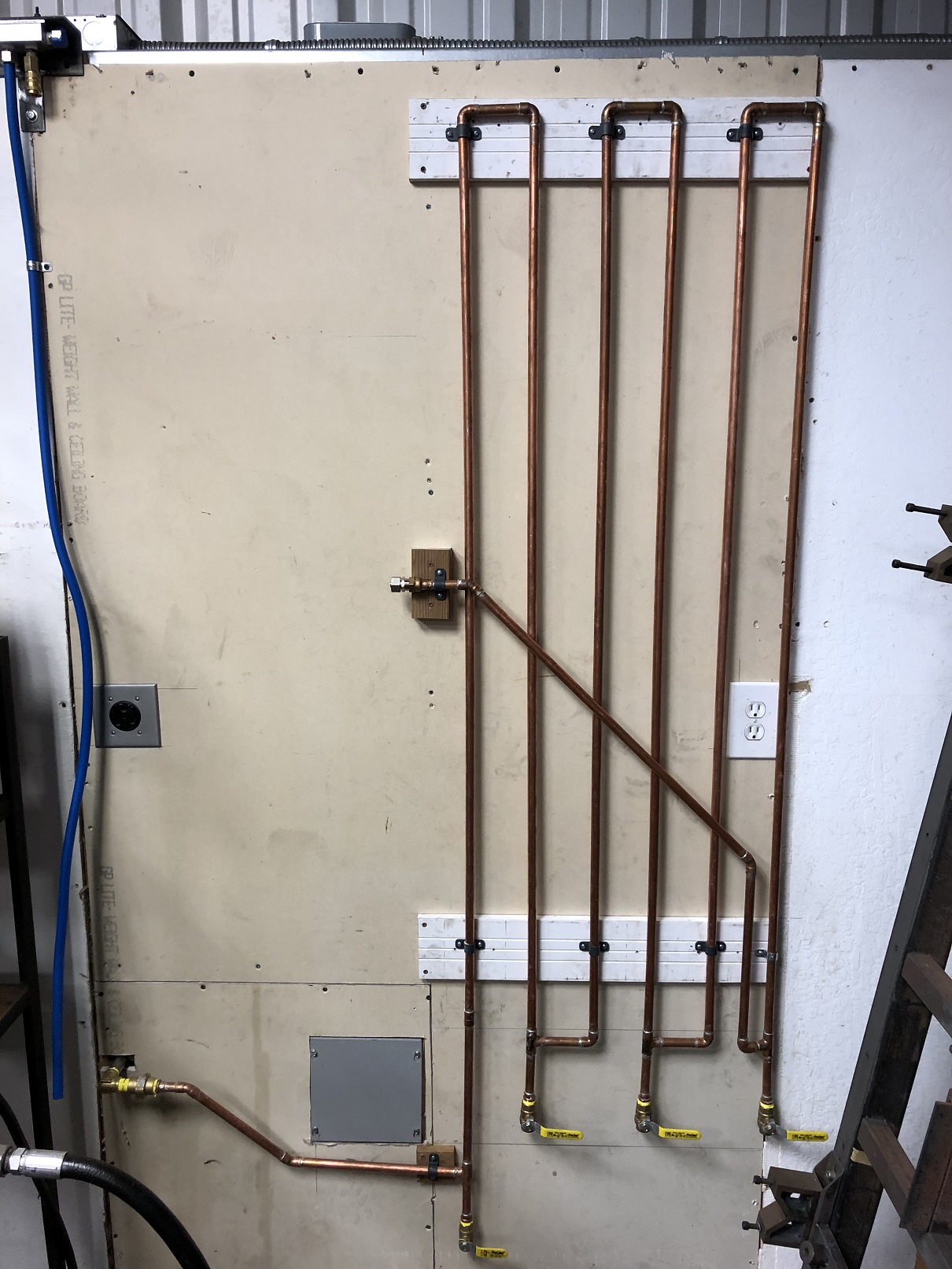

I decided to go all in on my air system so I built a "compressor shed" on the back of my shop to free up more space inside. Next, I started plumbing in a RapidAir line system.
As part of that, I made up this water separator. Air comes into it right off the compressor and the vertical runs help force the water to condense and each set of legs has a drain valve.
The end of the 45 degree run will plumb in to a 5-stage air filter/dryer set up. I run another 4-stage filter dryer just before it heads into the plasma system.
In all, I should have PERFECTLY clean and dry air throughout the shop and super duper awesome air for the plasma table.
Now to patch up the sheet rock and get things painted...
