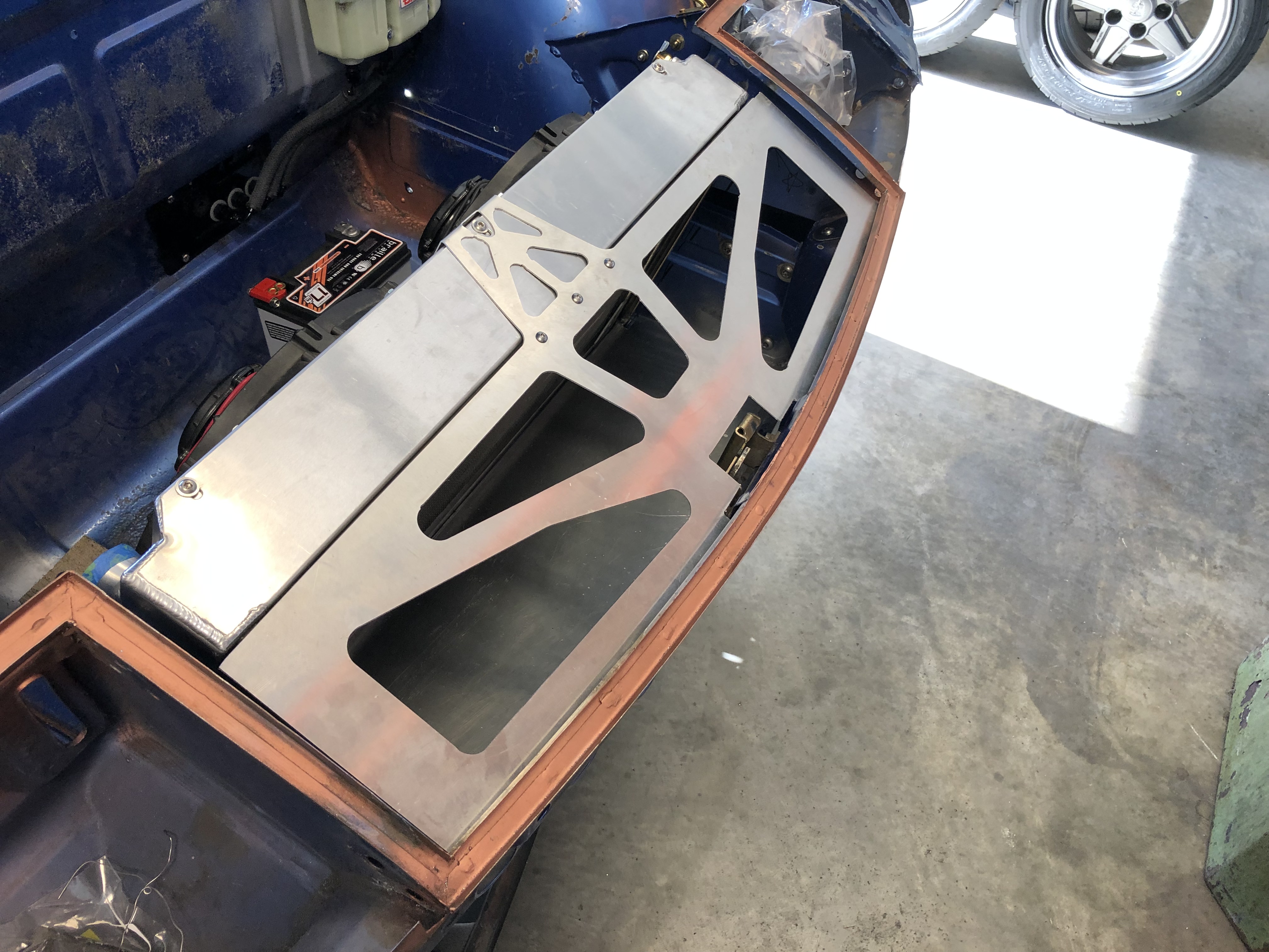

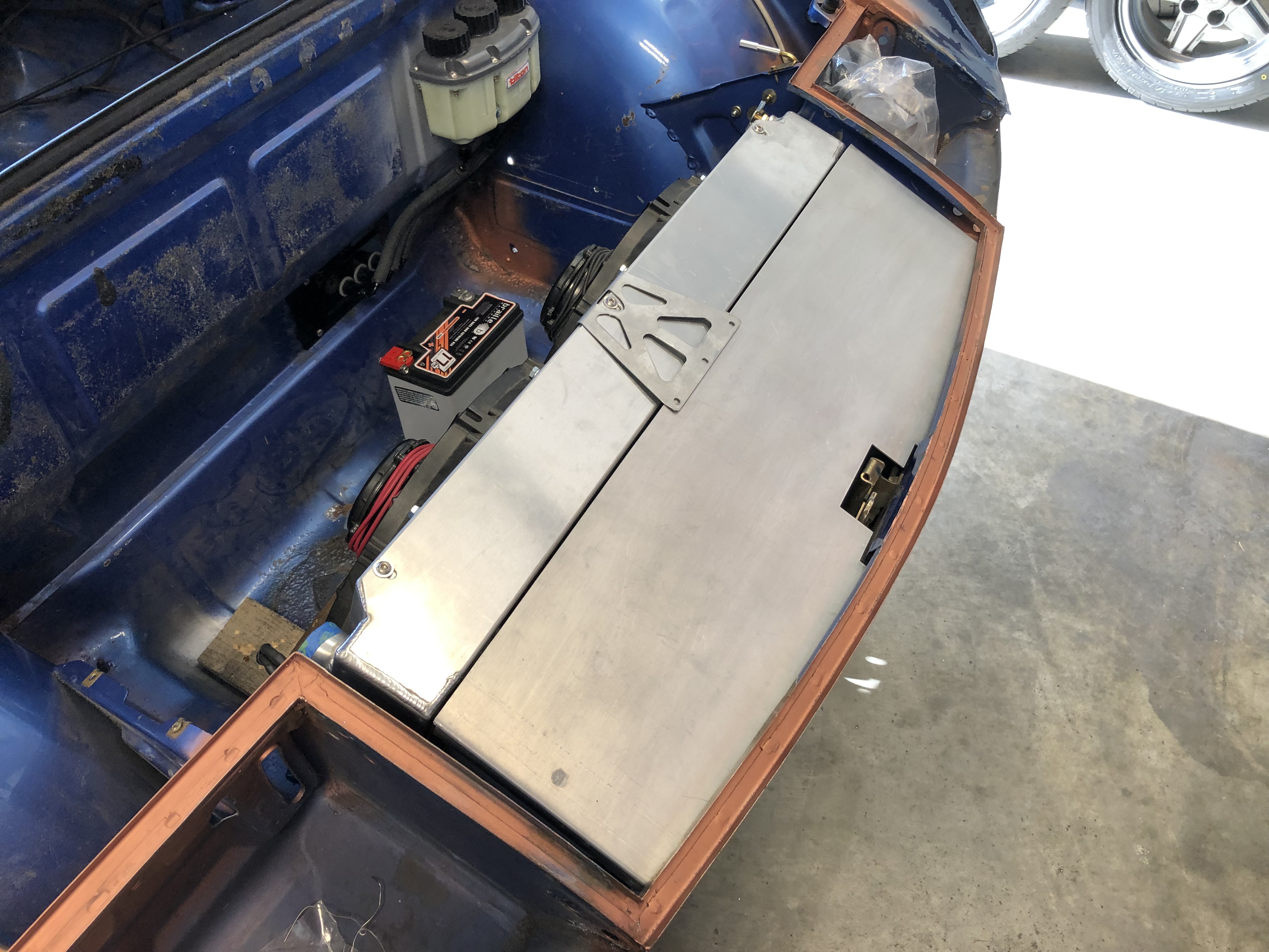

Then, it was the top shroud. Hmmm, looks like I'd have to trim the shroud to clear around the retainer plate. That likely won't do.

Do-over #2! (IMG:style_emoticons/default/laugh.gif)
I think I like this more. A target for design / engineering is to have a single part that performs more than one function. So here's my top shroud/retainer!
I'll back this up with carbon fiber to keep the overall design theme I have in the interior.

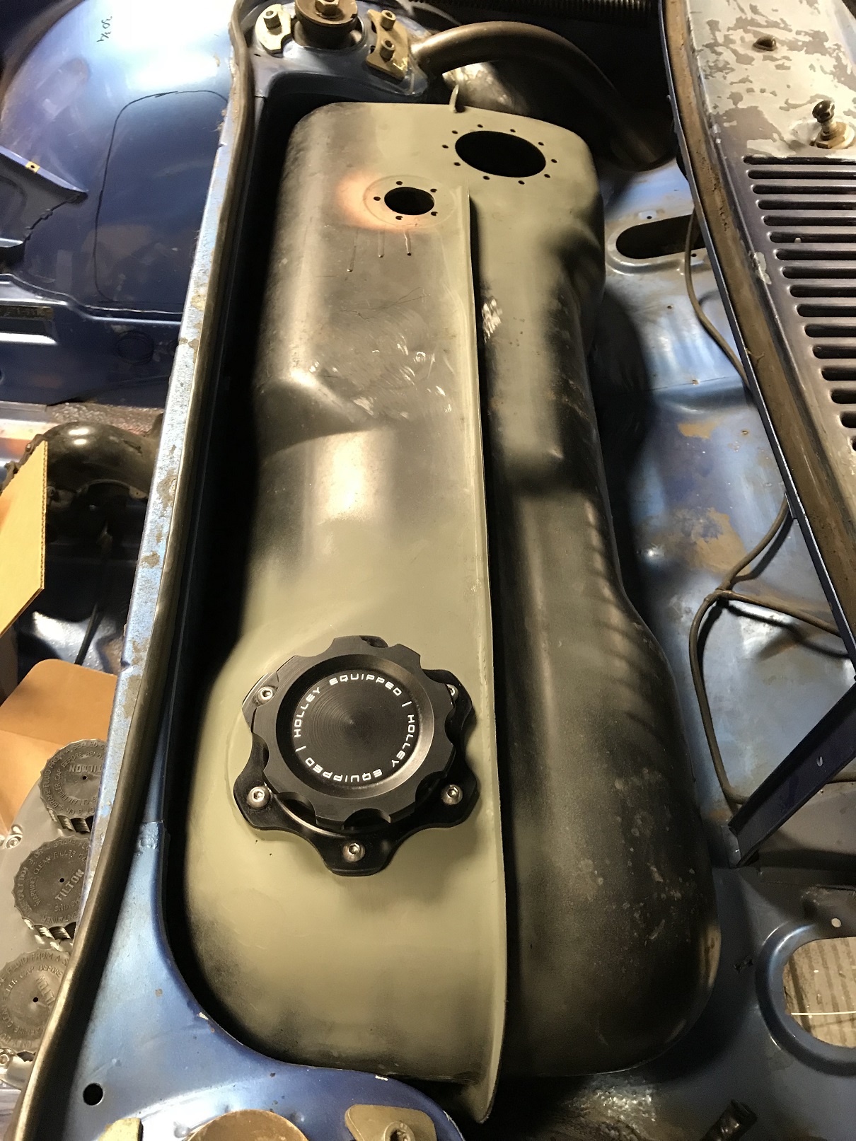

For months, I've been staring at the hole where the fuel tank sits so today I opted to make up the first of the lines.
Yet another example of cool new components hanging out with this ratty looking chassis and other older items.
I can't hardly wait to see what all this will look like once things are powder coated, anodized and painted.

I like the new top shroud but agree it needs some bead roller detail to make it fit the theme. (IMG:style_emoticons/default/beerchug.gif)

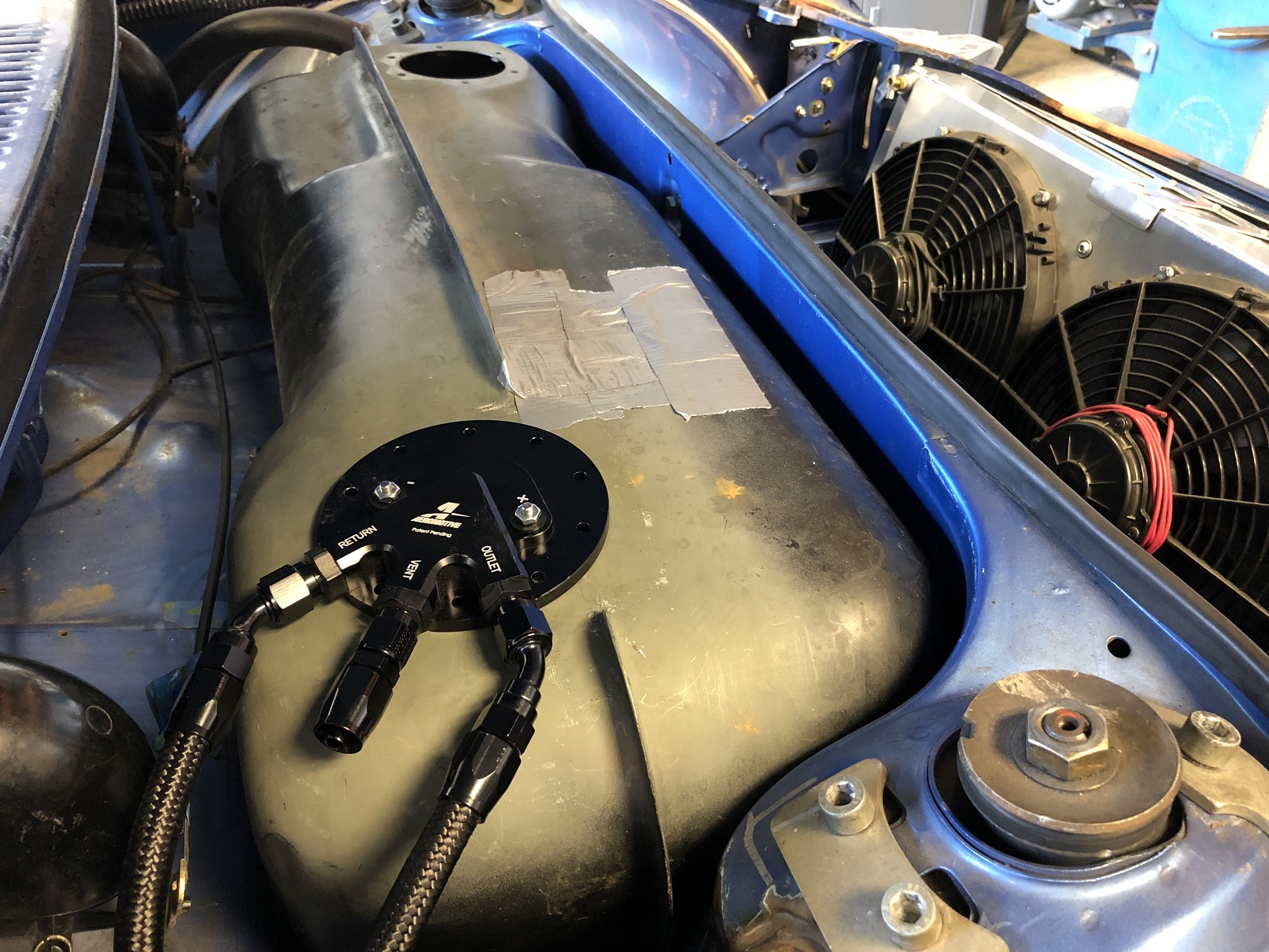

QUOTE(sixnotfour @ Aug 21 2019, 02:36 PM) *
are you doing drivers side fill..??
@sixnotfour What? You mean you haven't poured over all 90 + pages and committed everything to memory? (IMG:style_emoticons/default/av-943.gif)
Yes, driver side fill. The pump needed to drop into the tank's sump so I had to move the filler. Here's the planned set up, from an earlier post.

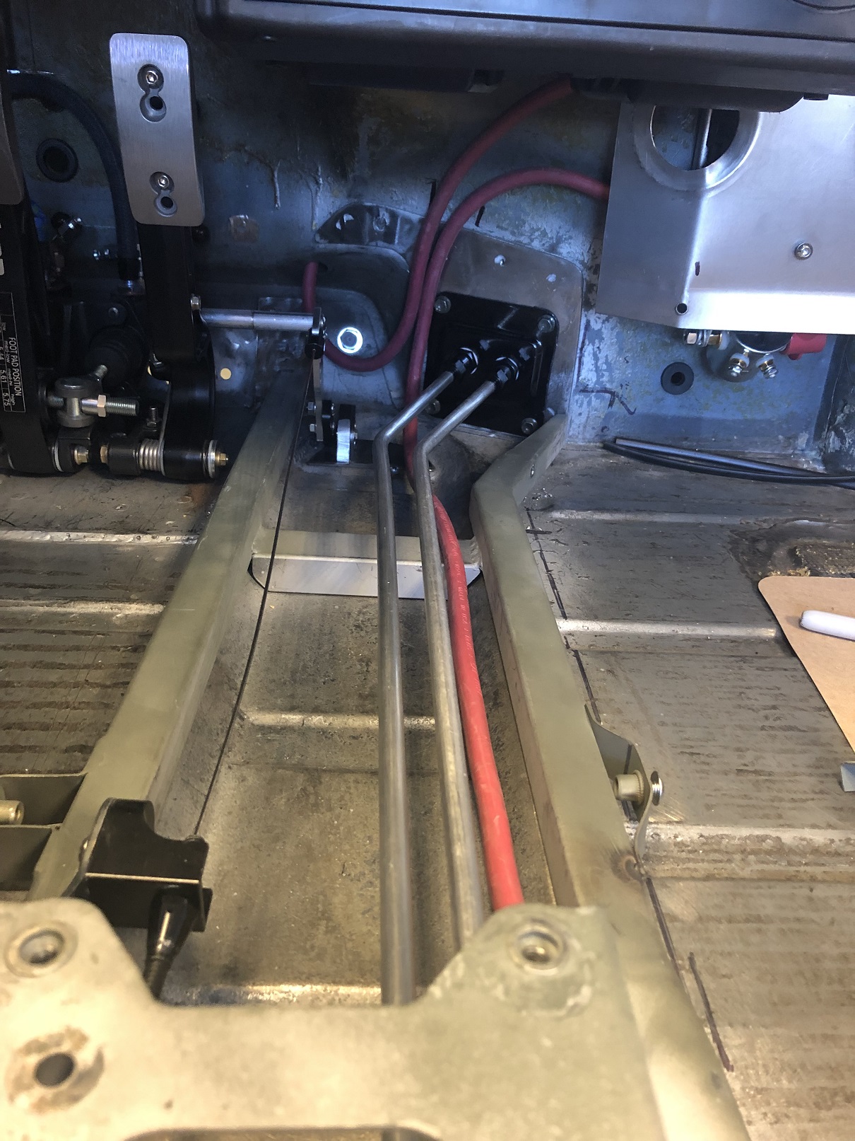

Hard fuel lines competed at the front bulkhead, so 1/2 way done! Now on to making them connect to the rear bulkhead.
I'll also fab a couple of supports for these.

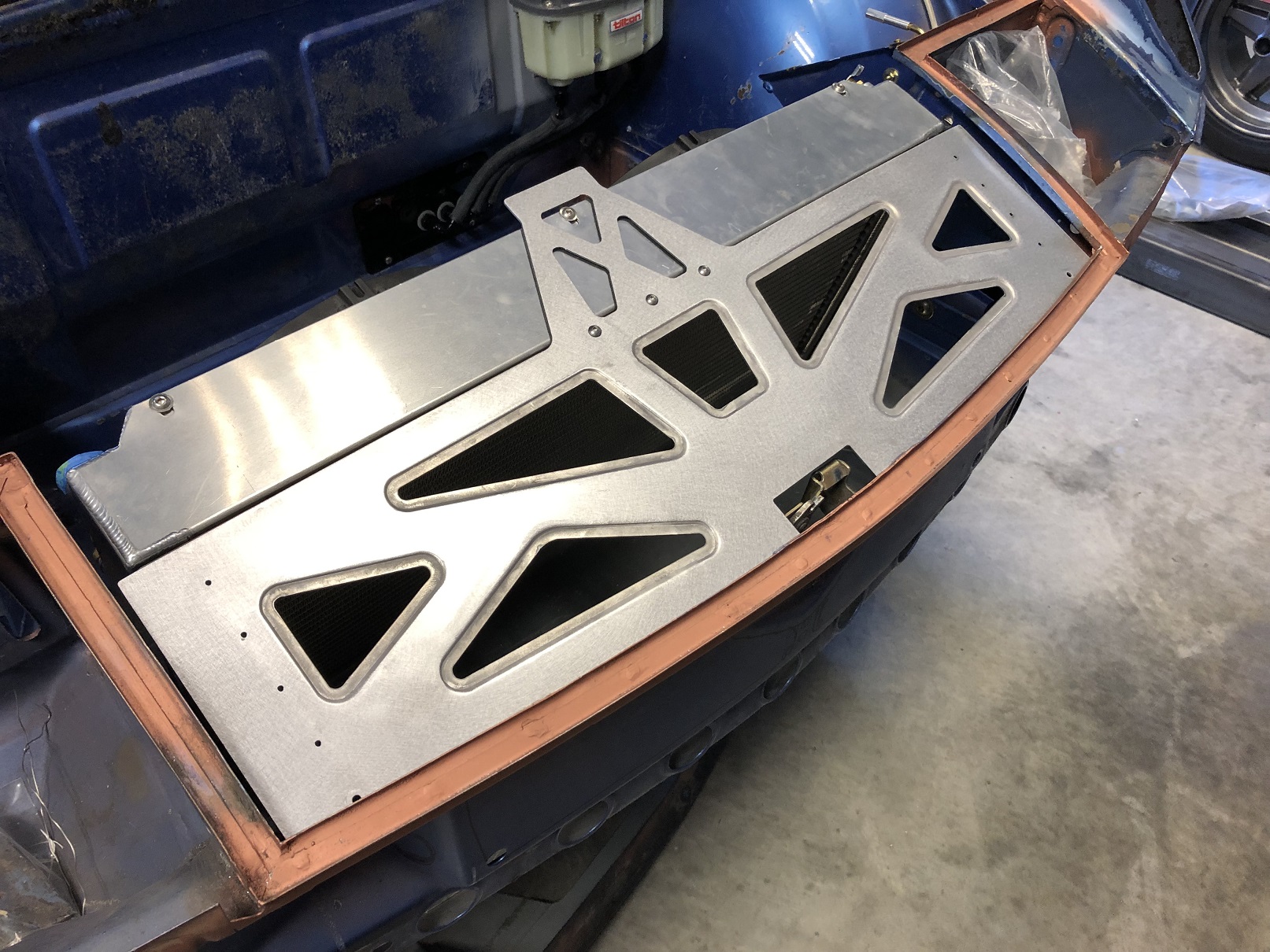

Stamped. And yes, I changed the design.
The retainer tab cut outs are a flipped/scaled down replica of the front of the removable doghouse cover design.
I also tightened up the clearances around the hood latch.
Now all the panels are matchy match!
Y'all happy now @Cairo94507 and @914forme ? (IMG:style_emoticons/default/poke.gif) (IMG:style_emoticons/default/lol-2.gif)
