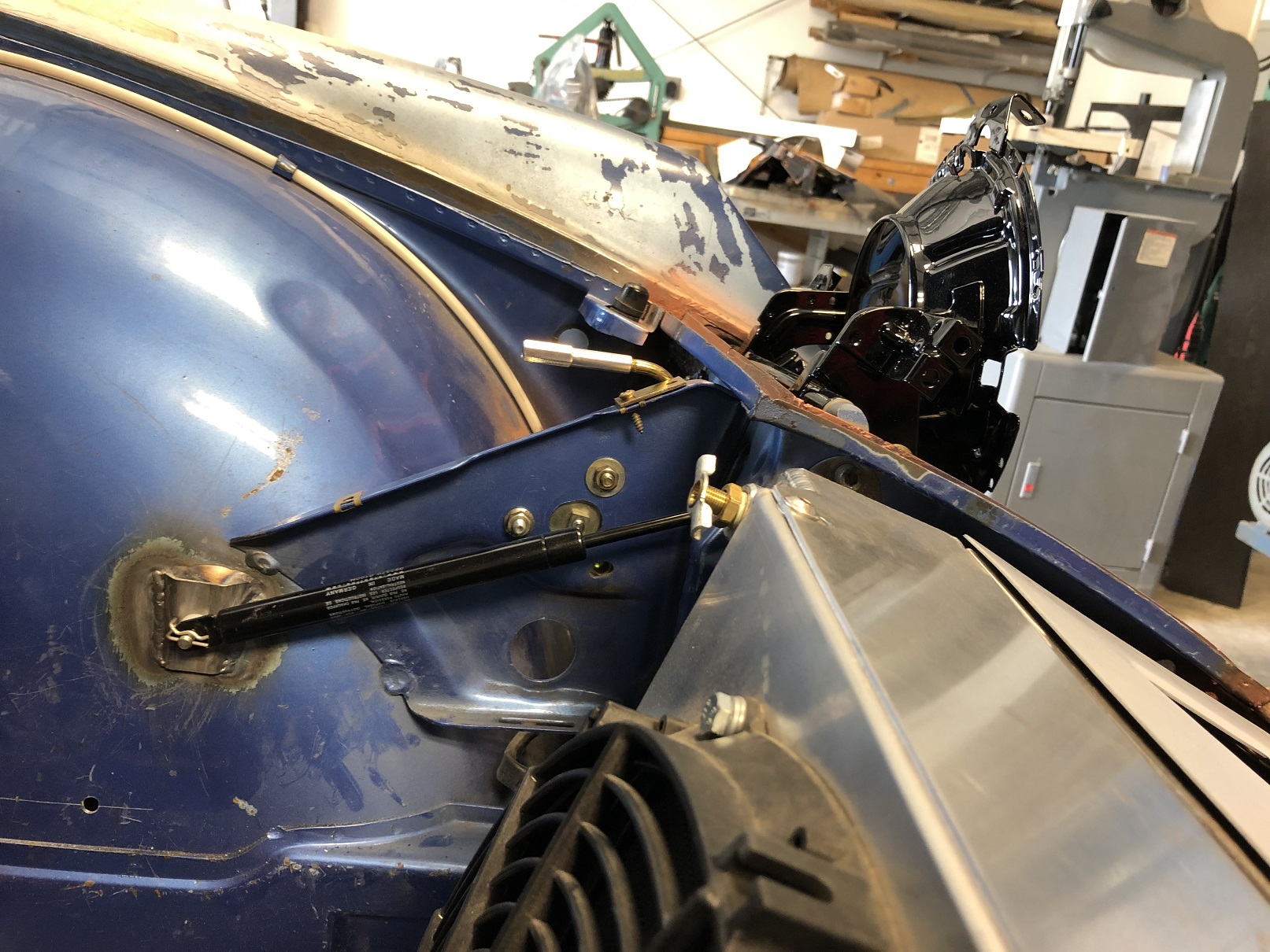

With all the time I've been spending in the frunk, the GT headlight kit started calling out to me so I got after it.

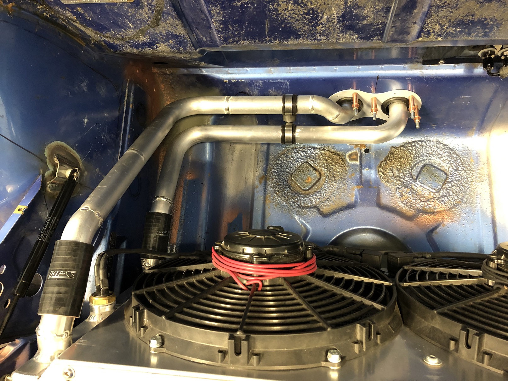

Progress on the hard lines. I got the grommets for the bulkhead plate but I'm not sure about the p-clamp, certainly not the white insulation. That's what I got when I ordered something that takes up to 300 degrees. I may just wrap the line under the clamp with black silicone tape. We'll see.
But I like how the lines are turning out.

QUOTE(tygaboy @ Sep 4 2019, 11:05 AM) *
What is this GT Headlight Kit you speak of? Pray Tell...

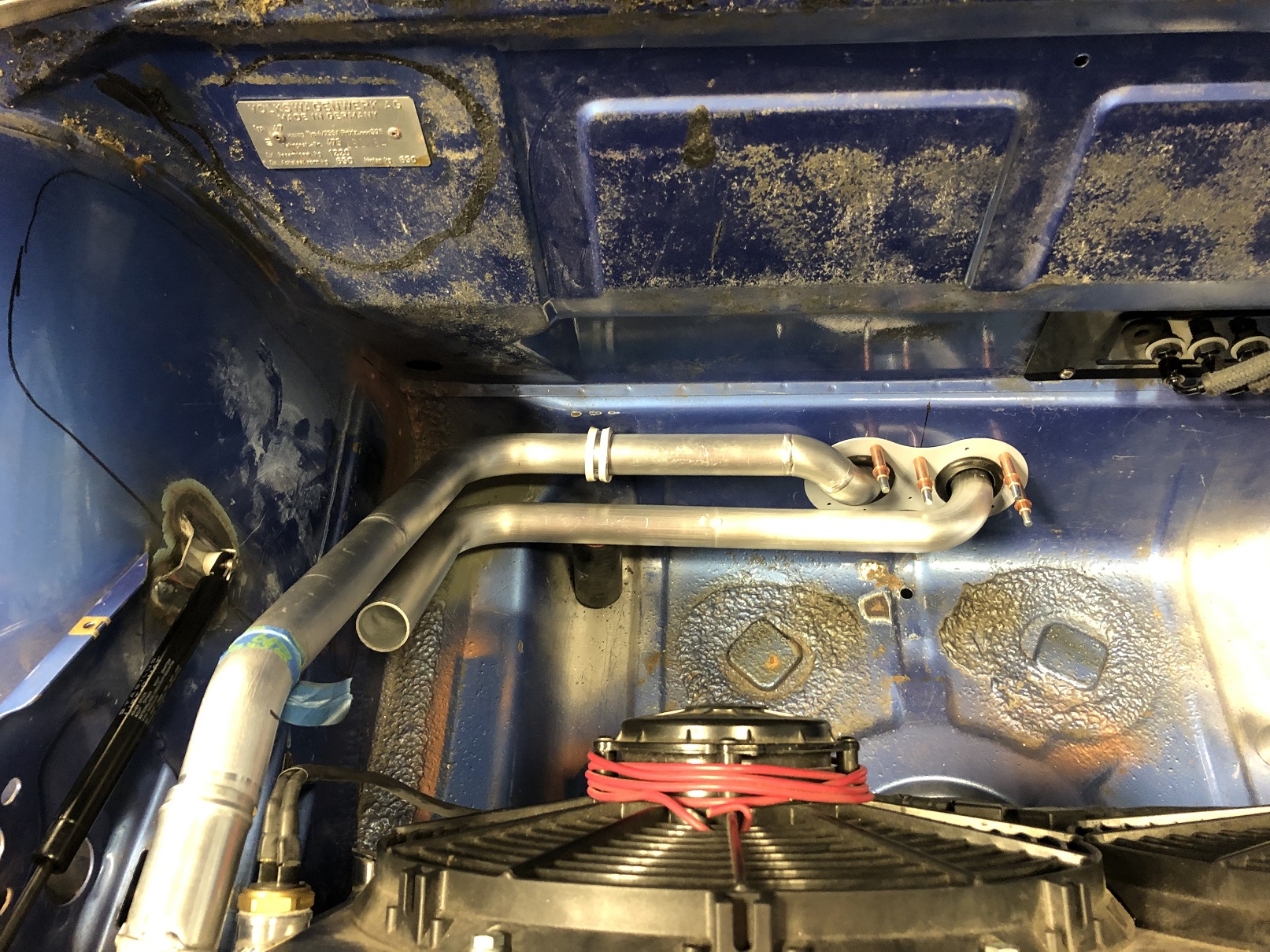

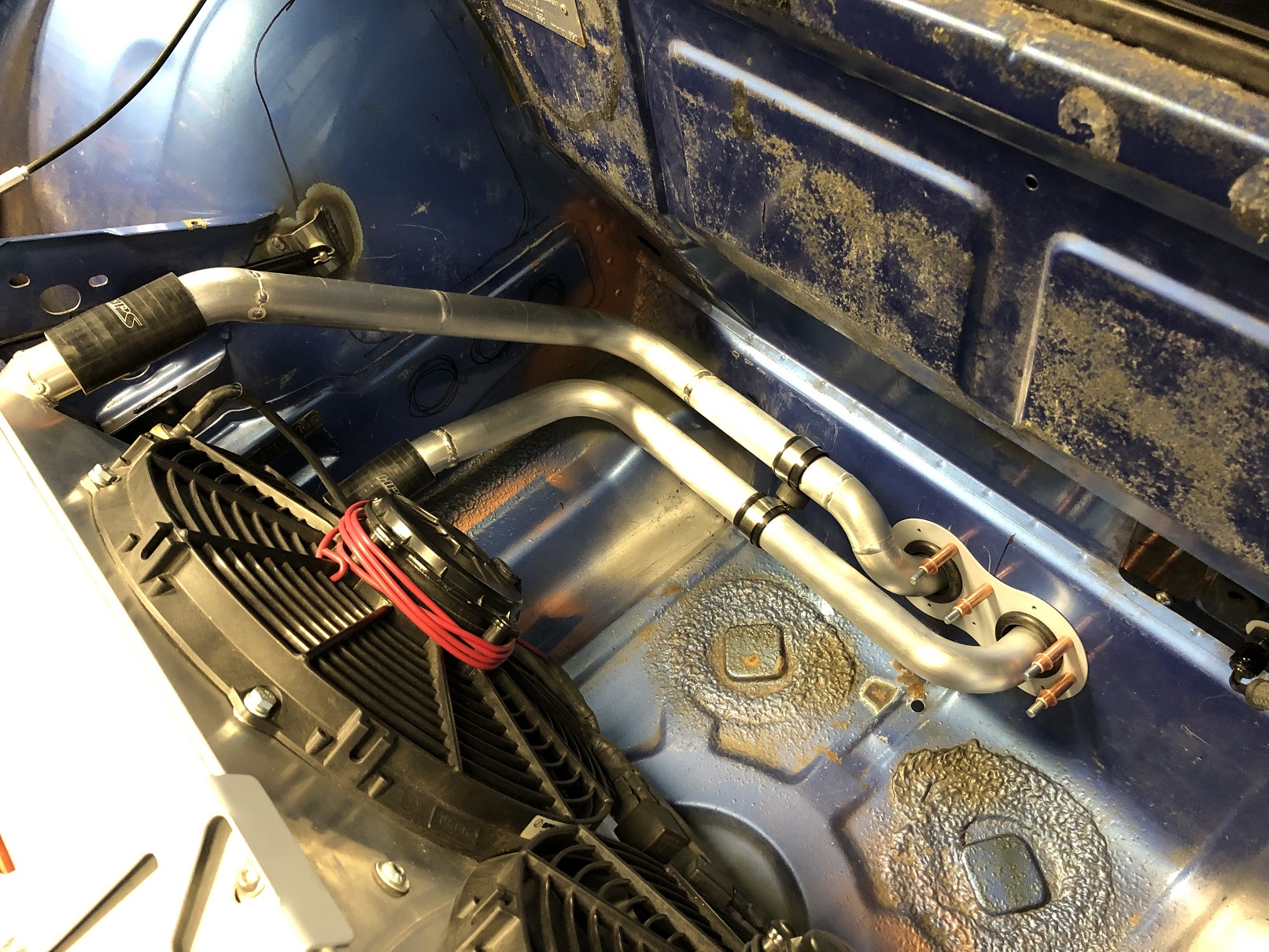

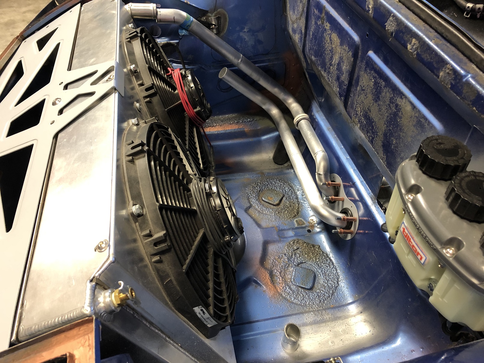

Radiator lines fab'd and fit. A couple joints to final weld and this gets checked off the to-do list.
I abandoned the "p-clamp bolted to the chassis". The latest is using the p-clamps but bolting each one to opposite sides of a .5" rubber isolation mount. This does an OK job but I think I can come up with something that works a bit better.
And this effort was my first foray into TIG welding aluminum. I found it far easier to get a nice result than welding steel. I don't know why I thought AL would be more difficult. That said, contamination of any sort and it all goes to hell instantly. Far more sensitive than steel.

QUOTE(tygaboy @ Sep 6 2019, 04:34 PM) *
I personally like doing aluminum too. For some reason I find it more satisfying.
If you think aluminum contaminates quickly, try to TIG Galvaneal. (IMG:style_emoticons/default/headbang.gif)

QUOTE(tygaboy @ Sep 6 2019, 01:34 PM) *
Gorgeous pieces!!!!

QUOTE(FourBlades @ Sep 7 2019, 08:26 AM) *
TIG welding aluminum is a holy grail skill!
I am still trying to learn to TIG steel.
Did you run a purge line inside the pipes?
John
@FourBlades - No back purging. I think that's only absolutely required on Ti. Not that total shielding isn't "better" but it worked fine without it.

QUOTE(tygaboy @ Sep 7 2019, 11:48 AM) *
Don't need to backpurge aluminum. Highly recommended on mild/stainless steel tube/pipe (req. if doing code welding) and like Chris said absolutely necessary on Ti. The drawn tubing used in cages is normally pretty nasty inside in in my experience really benefits from a backpurge.

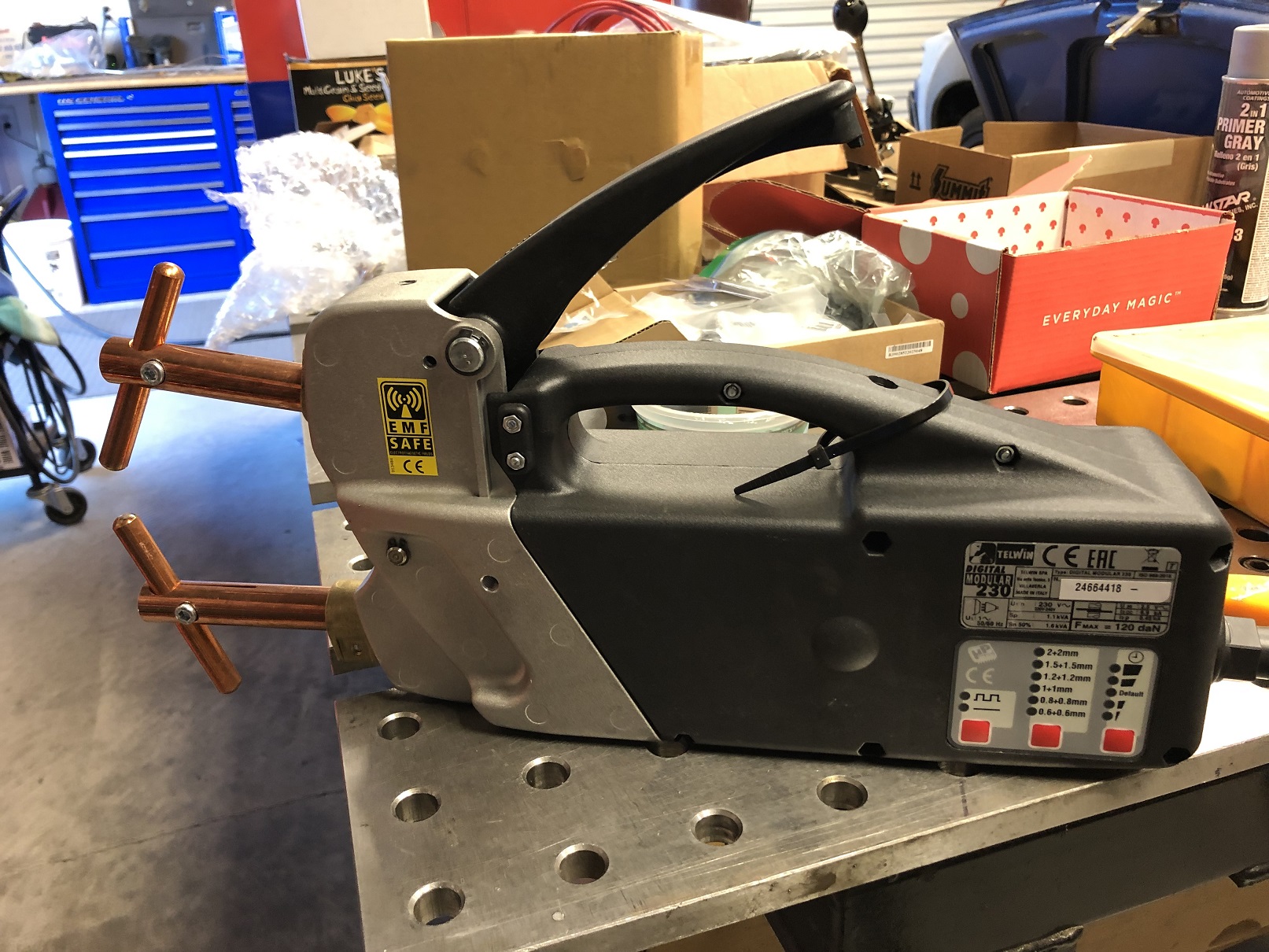

One for the tool whores: I treated myself to a "real" spot welder. Having checked out the Harbor Freight version, I opted for this one. Really nice.
If anyone local to me needs/wants to borrow this, please don't hesitate to let me know. It's pretty incredible.

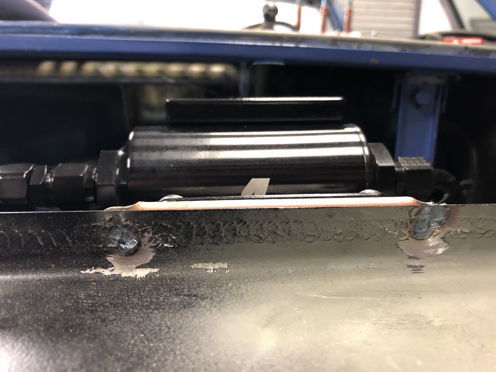

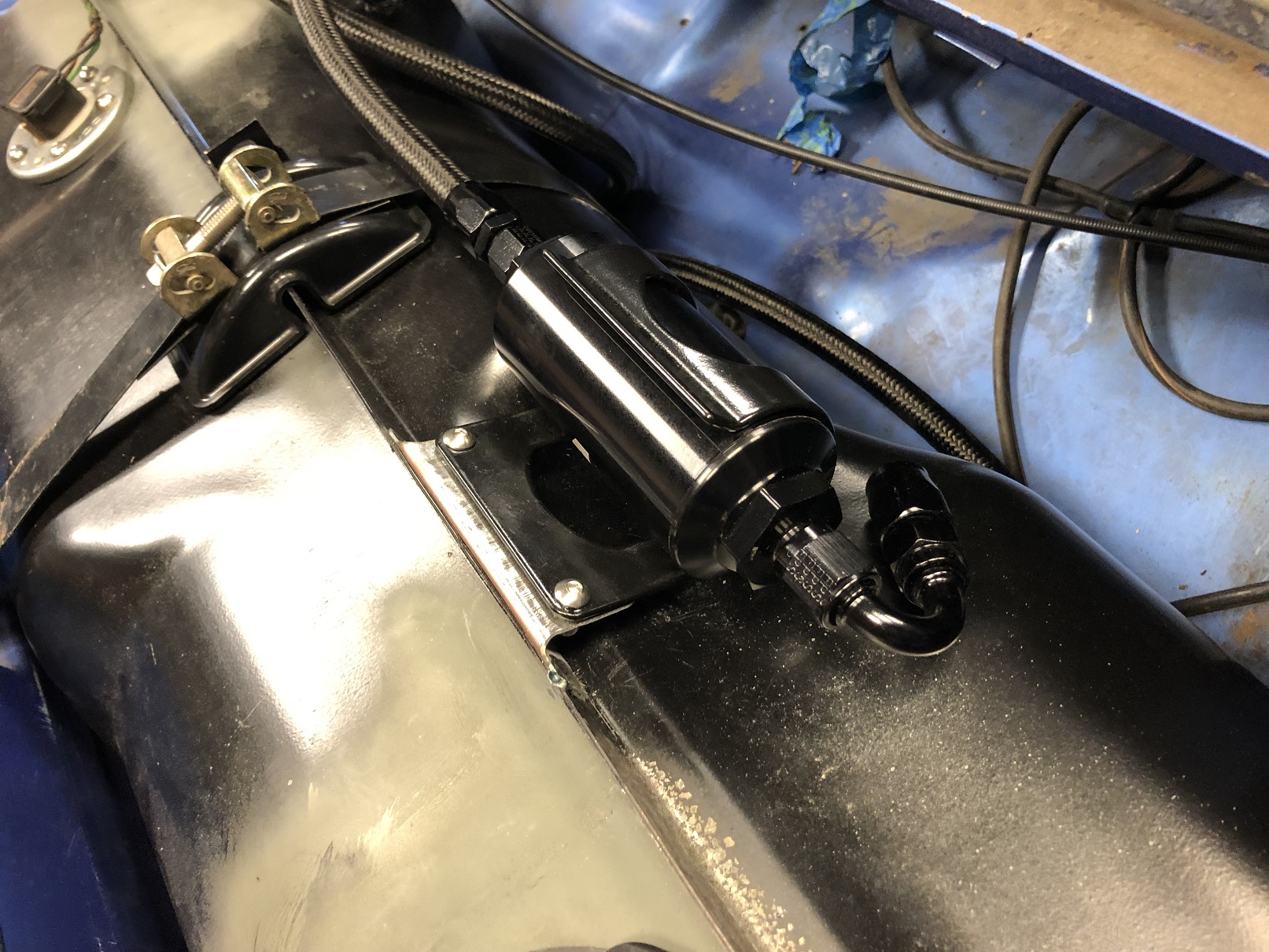

I used the magic spot welder to attach a little bracket to which the fuel filter mounts.
The lower part of the fuel filter mount rests on a small rubber pad on top of the fuel tank.

914forme
post Sep 16 2019, 07:17 PM
Post #1918
Posts: 3,899
Joined: 24-July 04
From: Dayton, Ohio
Member No.: 2,388
Telwin digital 230, nice unit. Have not seen them for sale in the US, I know what they cost, but who was the US supplier?
They make a great spot welder, enjoy it. Been looking for a used one for a long time.

QUOTE(914forme @ Sep 16 2019, 06:17 PM) *
Here is a used one for sale

@914forme Stephen, I got mine here, at USA Weld:
https://www.usaweld.com/Quick-Spot-II-p/60501.htm
I did add the zipadeedooda angled arms. It comes with a set that point the electrodes directly at each other.
