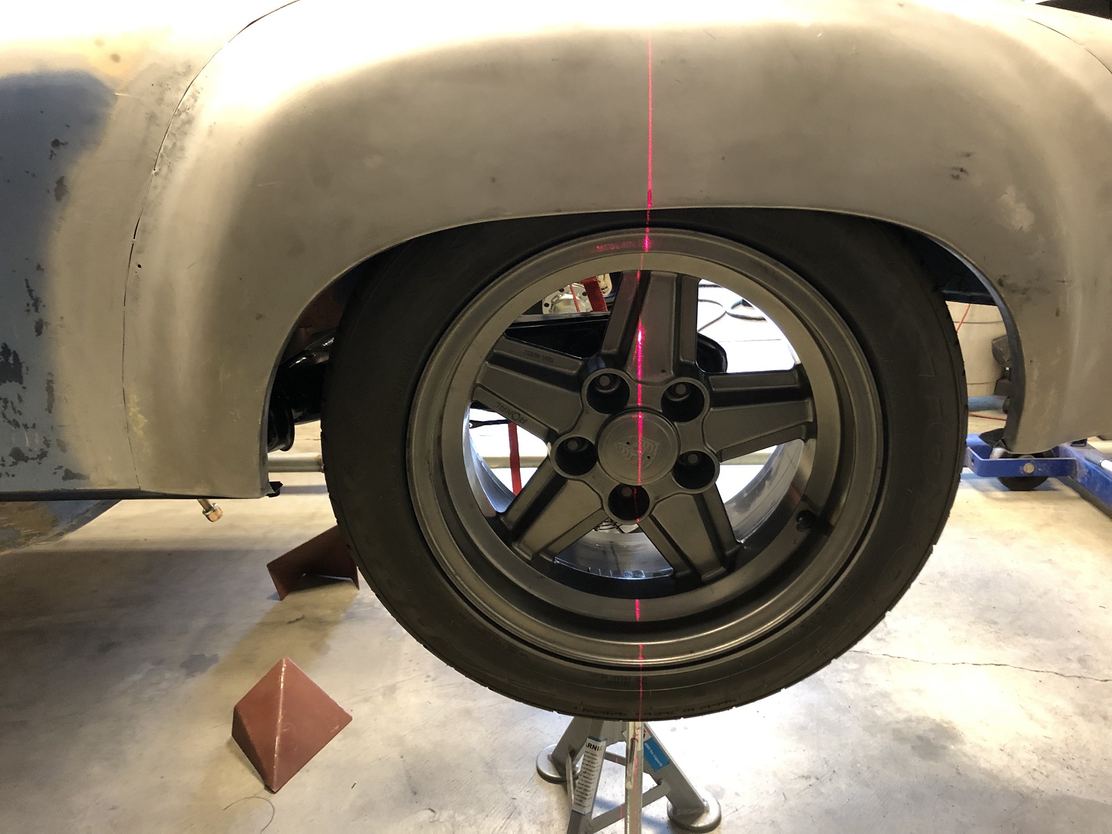

Trial fitting of the driver's side. The wheel position in the flare is virtually perfect on this side too!
And as Jeff Hail mentioned, it's more important that the chassis numbers are correct - and my suspension pick-up points are square. As well, I achieved a nice fore/aft fit so, apparently, my chants and prayers to the fabrication gods were answered.

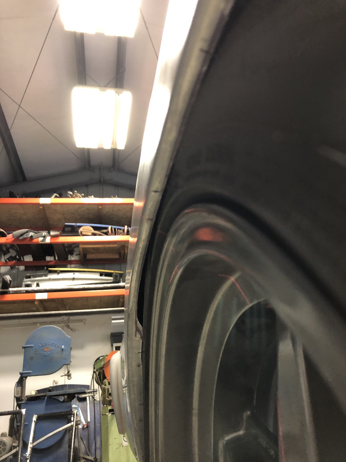

Well, so much for perfect symmetry. It seems the "tighter on one side" gene was passed on to my chassis so additional clearance will be required here.
I'm running the Elephant Racing poly bronze bushing set up and they use a "large stainless washer" between the shaft and trailing arm mount/chassis. I may fab a thinner one for each inside one and move the arms in a bit.
And it looks like I will roll the flare lip, too.
Awesome work Chris. Good luck with the biopsy. Oddly I had one the same day, had a small cherry on my clavicle cauterized.
If the height is approximate to how you want the car to sit set static toe at zero for the mock up. Will make life easier in the distant future.
I built a dummy shock from an all-screw (doubles as my hub installer) set at 20-1/2 inches with flexibility to shorten it another 2 inches as a setup tool when I installed the pickups during the final burn in.
Have the same ERP bushings and shafts. The ERP shafts use a threaded stud, the studs come loose fairly easily which I found after installing/ removing the trailing assemblies multiple times. Double check them preferably Lock-tite them into the shaft. Consider drilling the nylock nuts/ shafts to add safety wire as the nuts have been known to loosen also. Don't install the zerk fittings until last, I snapped two with all the trial fitting letting the trailing arm hang down.

QUOTE(Jeff Hail @ Nov 16 2019, 03:31 PM) *
Jeff - Thanks for the kind words. Same suspension kit, same day biopsy, tool whores... wonder what else we have in common. (IMG:style_emoticons/default/biggrin.gif)
I also discovered that threaded stud thing! I was trying to remove the arm after one of the mock ups and I'm thinking "why the hell does it feel like the other end of the shaft isn't spinning when I loosen this bolt?" All of a sudden the stud comes out! So yes, planning Loctite.
And I appreciate the guidance on the toe setting. I was planning on just validating I have +/- range of motion at ride height so I'll take your advice on this, too. Seems easier to work to a fixed value.
Finally, yes, I've been planning all along to shamelessly steal your all-thread dummy shock approach. And let me save you some time on future posts: I plan to copy virtually all of what you did, including your Rocket Science buddy's suggestion for plating farther up the long.
I revisit your thread ALL THE TIME, and not just re: the pick ups. You schooled me on the sleeve approach for inner/outer long repairs (I stole that approach, too) and a bunch of other stuff. Many of us are following in your footsteps, and let me say, them be some big shoe prints to try and fill! (IMG:style_emoticons/default/pray.gif) (IMG:style_emoticons/default/pray.gif)

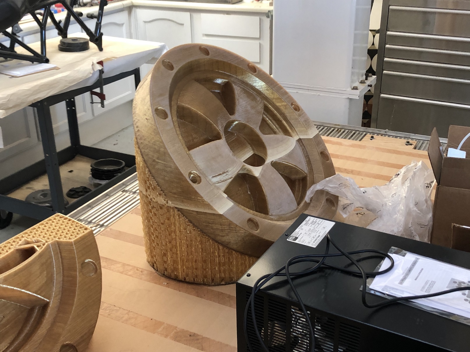

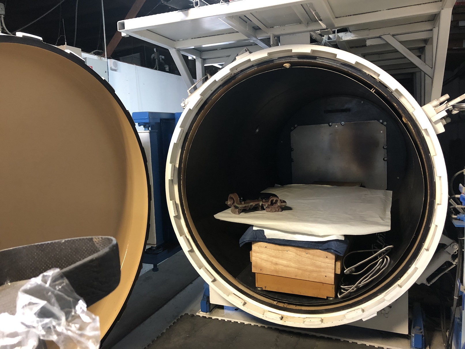

I spent today doing what will likely become a "project extender".
I have a new acquaintance.
He owns a composite company.
He has some "interesting" capabilities.
I'm thinking I need to take advantage of them:
A 5' x 5' (you read that right) 3D printer that is used to print the molds. For things like carbon f-ing wheels!
tygaboy
post Nov 18 2019, 07:24 PM
Post #2033
Posts: 5,859
Joined: 6-October 15
From: Petaluma, CA
Member No.: 19,241

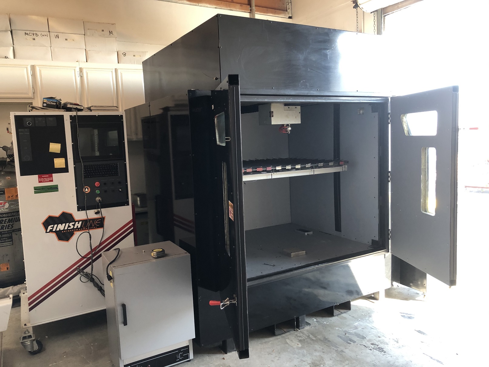

An autoclave you can almost drive into with your auto! (IMG:style_emoticons/default/laugh.gif)
Seriously, this thing is like 5' tall/wide and 10' long.
tygaboy
post Nov 18 2019, 07:27 PM
Post #2034
Posts: 5,859
From: Petaluma, CA
Member No.: 19,241

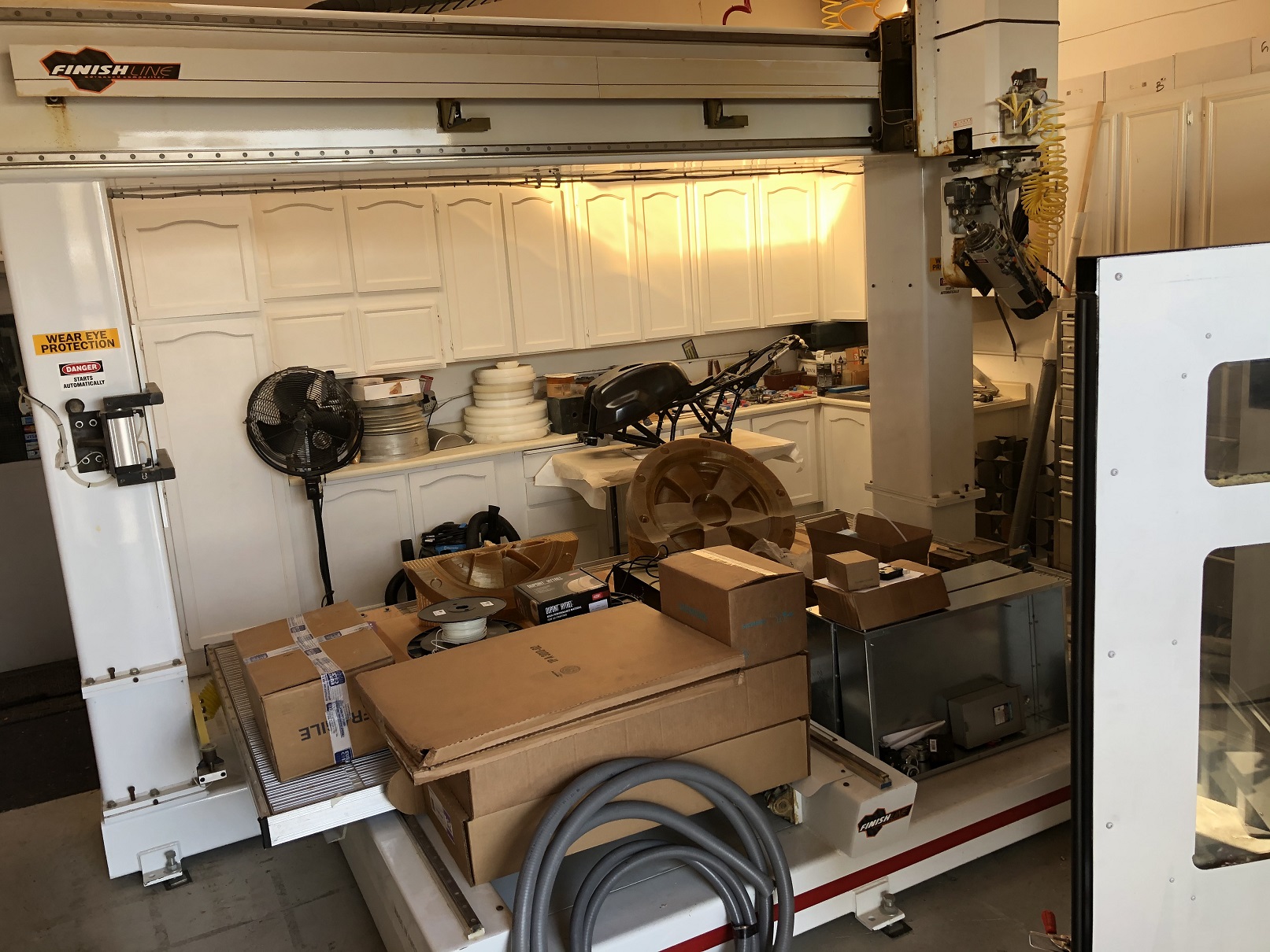

And my favorite: a 5-axis mill that can carve things like, oh, I don't know... car body panels?
I'm taking a set of doors, bumpers, hood and trunk lid over to see what we might do...
Carbon 914 parts anyone?
