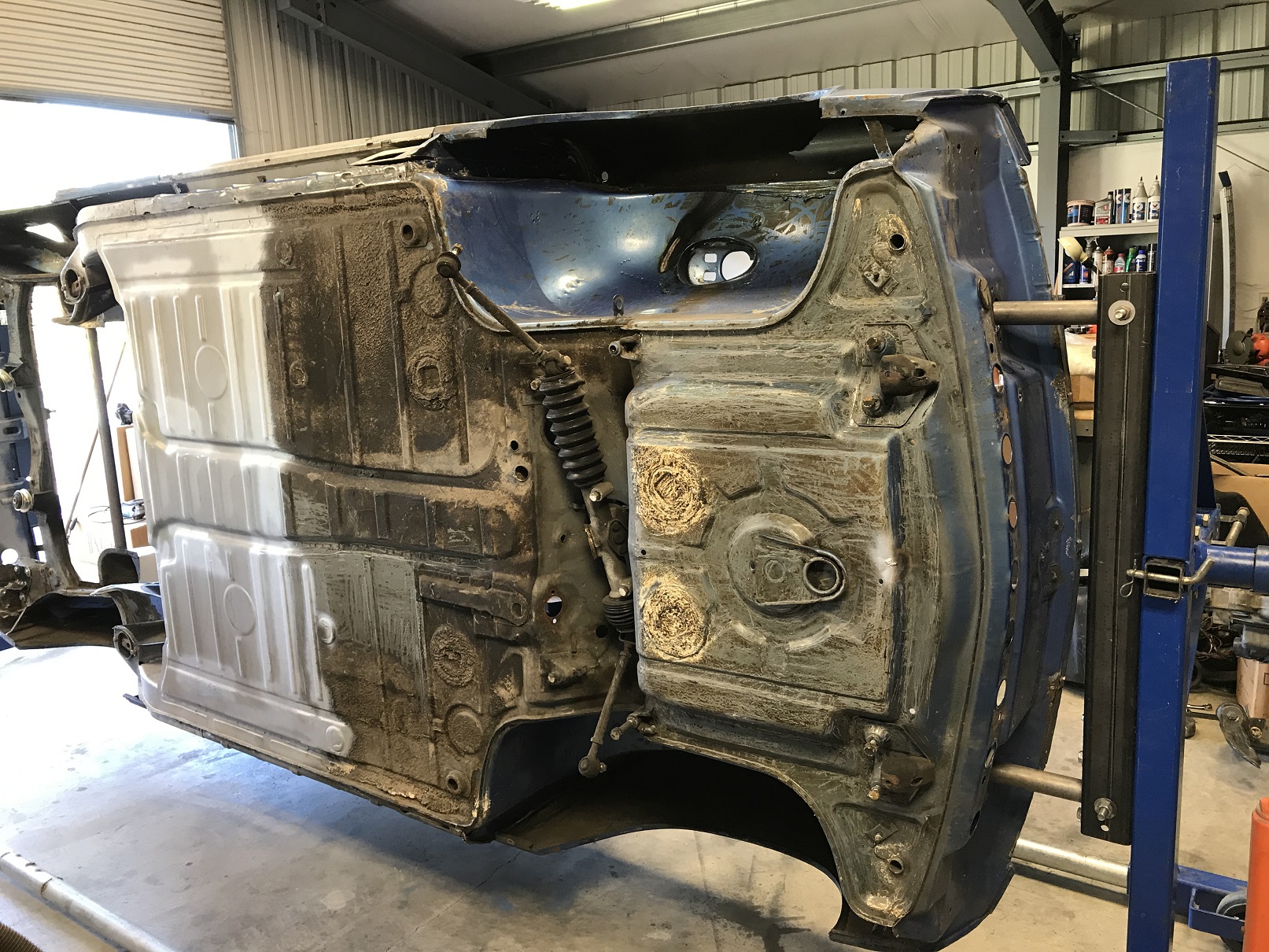

BACKGROUND:
I got this as a roller that was purported to be "dry and accident free". And it was!
Except for all the rust and the place where it was hit. Yeah, yeah... But it's all good. The seller and I worked everything out. (IMG:style_emoticons/default/beerchug.gif)
But our little 914s are full of surprises and isn't that half the fun? So, first up is rust repair time! (IMG:style_emoticons/default/sawzall-smiley.gif) (IMG:style_emoticons/default/sawzall-smiley.gif) (IMG:style_emoticons/default/welder.gif) (IMG:style_emoticons/default/welder.gif)

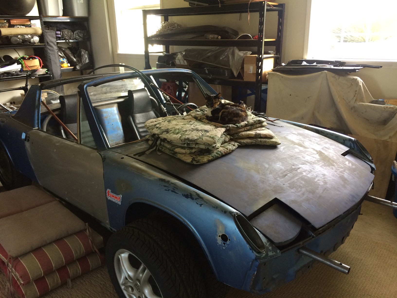

Let's begin with some pics of what I started with. Wish me luck! Wait, forget the luck, wish me SKILL!!!

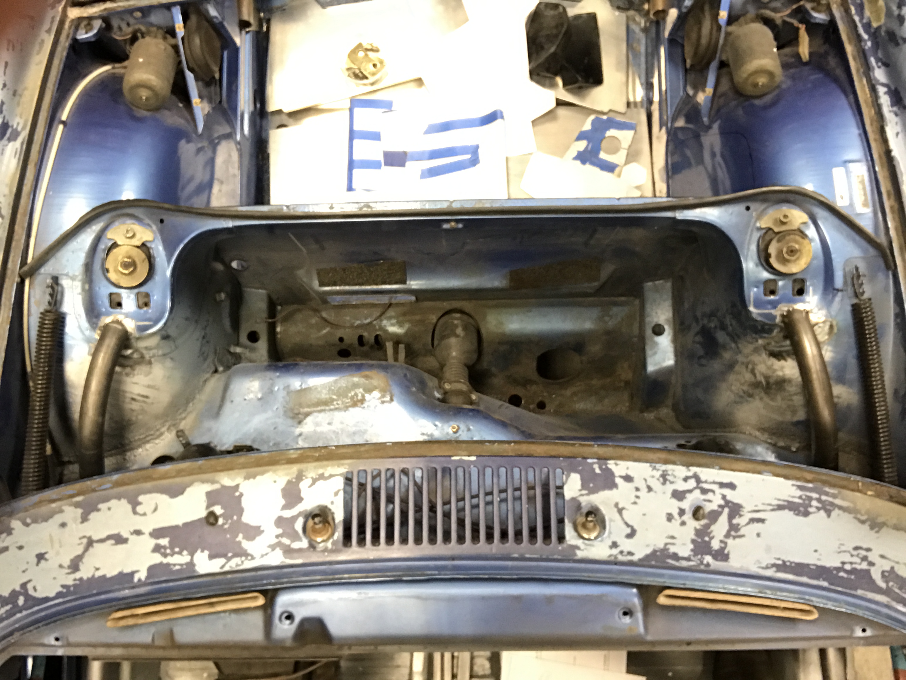

tygaboy   How about the hell hole? Hmmm.   Oct 17 2016, 11:00 AM

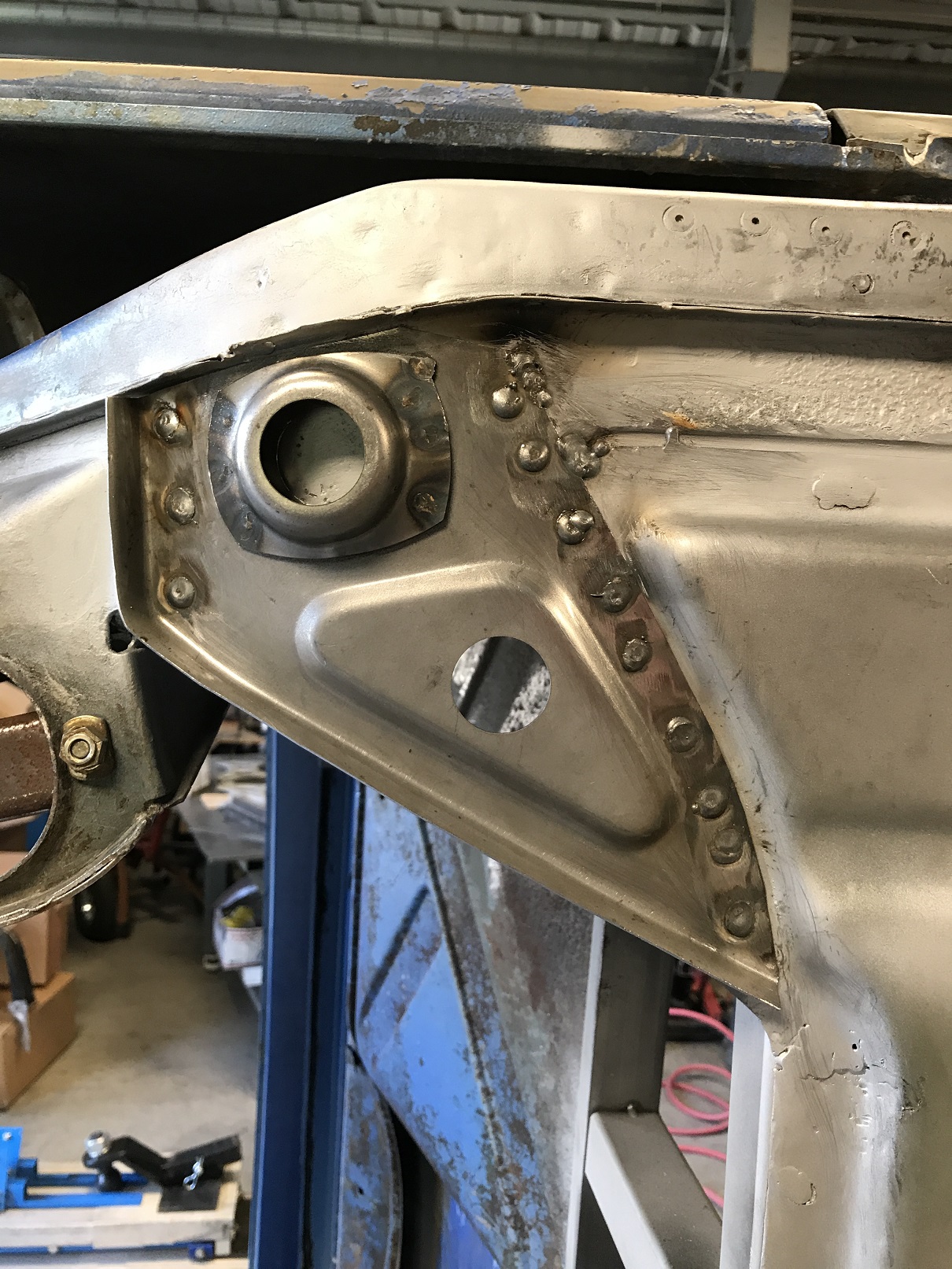

tygaboy   In planning the fabrication of the sleeves needed ...   Oct 17 2016, 01:00 PM
tygaboy   I sliced the longitudinal repair section out of my...   Oct 17 2016, 01:11 PM

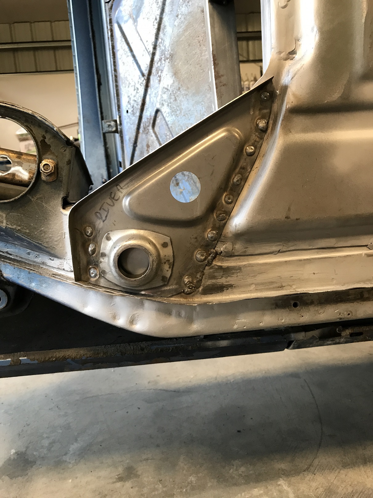

tygaboy   Hell hole/long repair welding nearly completed...   Oct 17 2016, 02:01 PM
tygaboy   My paranoia paid off and another Tangerine product...   Oct 17 2016, 02:10 PM

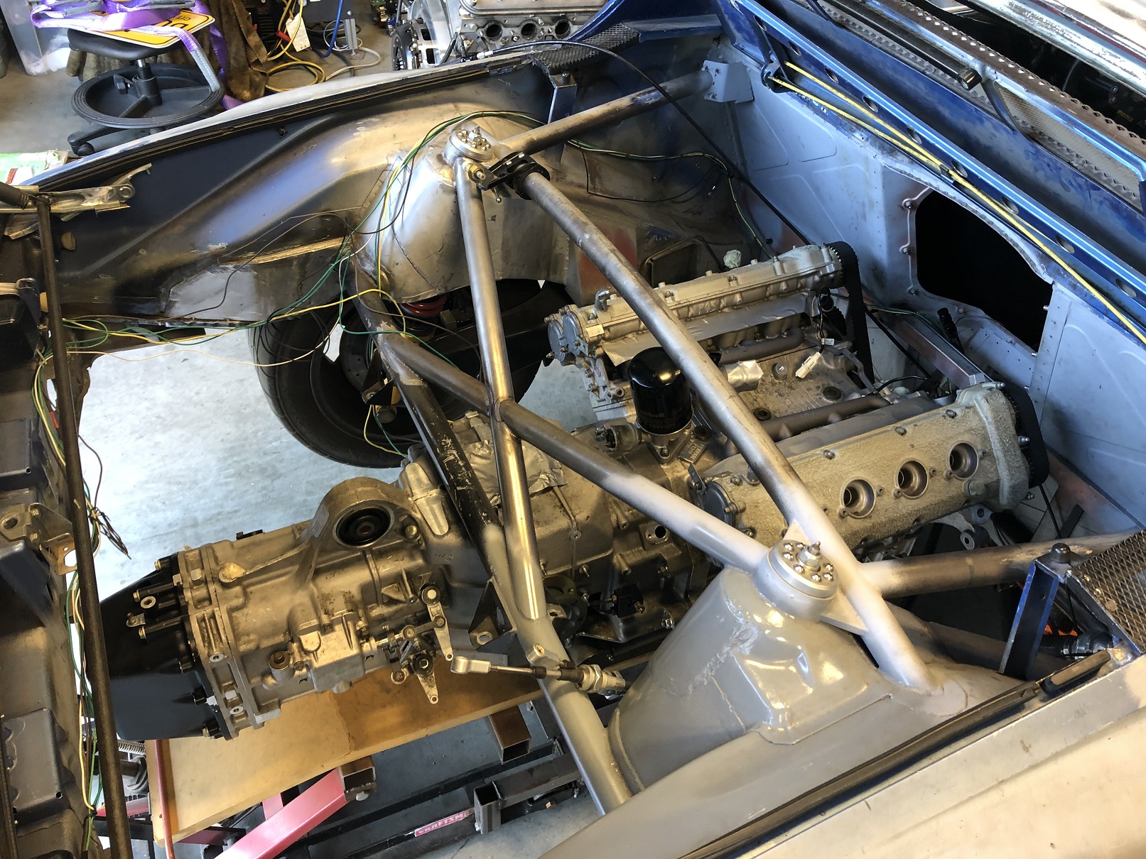

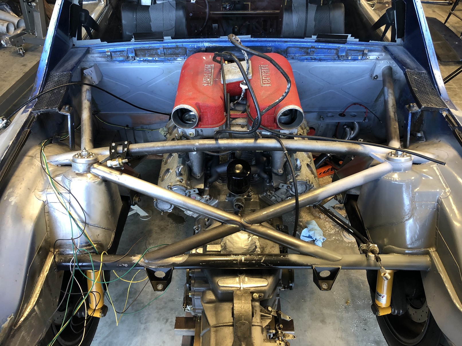

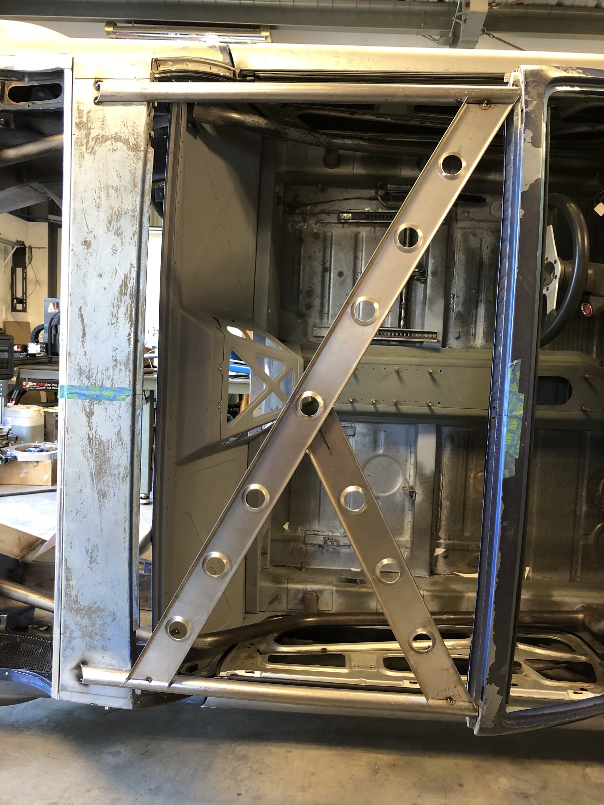

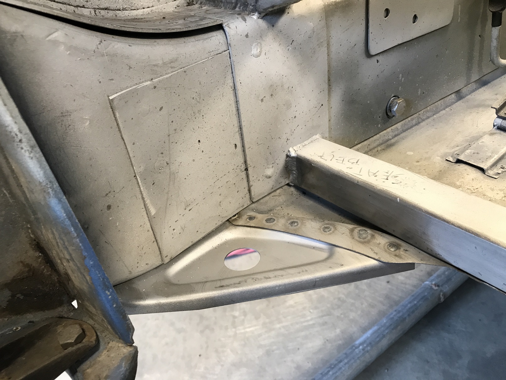

tygaboy   CHASSIS STIFFENING: Version 1 LS3 = I need to sti...   Oct 20 2016, 11:27 AM
tygaboy   CHASSIS STIFFENING:Version 1 From a design perspe...   Oct 20 2016, 11:35 AM

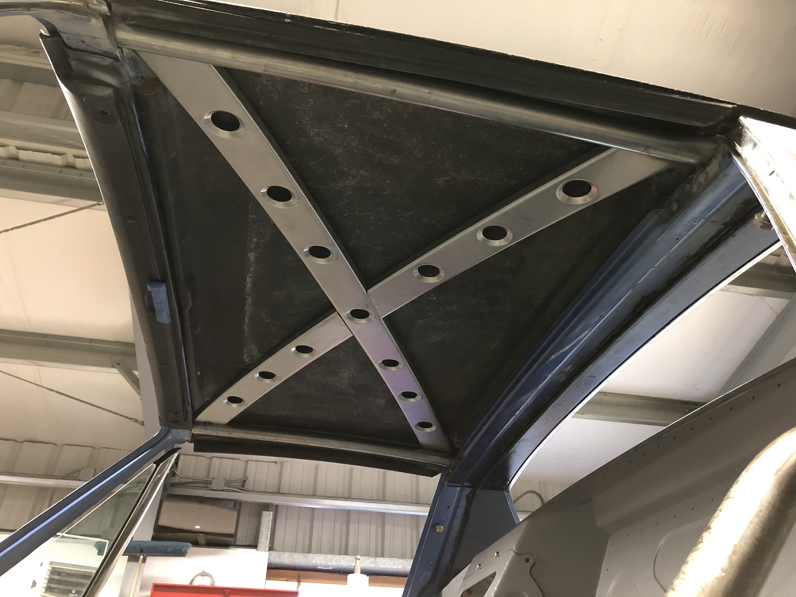

tygaboy   CHASSIS STIFFENING: Version II - Change of Plan A...   Oct 20 2016, 11:51 AM
worn   That said, I also wanted to hide as much of this...   Oct 20 2016, 01:09 PM
stevegm   Interesting idea. It should provide some stiffness...   Oct 20 2016, 12:15 PM
Cairo94507   Now that is a very cool way to stiffen the car and...   Oct 20 2016, 12:42 PM
Cracker   Very nice Chris...have it running at WCR! :sh...   Oct 20 2016, 12:49 PM
914forme   Very nice bar tuck. If your not planning on runni...   Oct 23 2016, 09:48 AM
tygaboy   Very nice bar tuck. If your not planning on runn...   Oct 23 2016, 01:25 PM

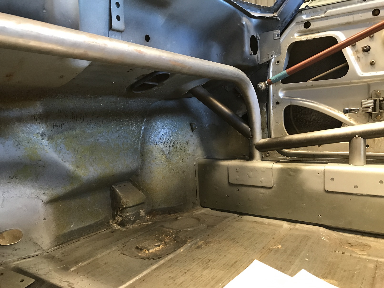

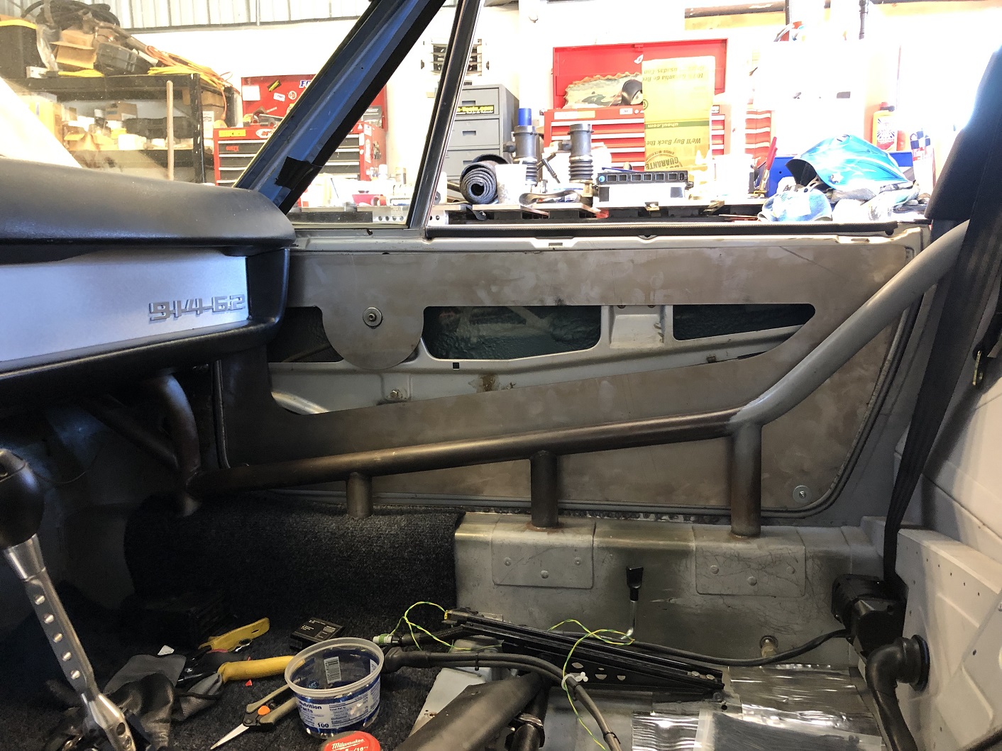

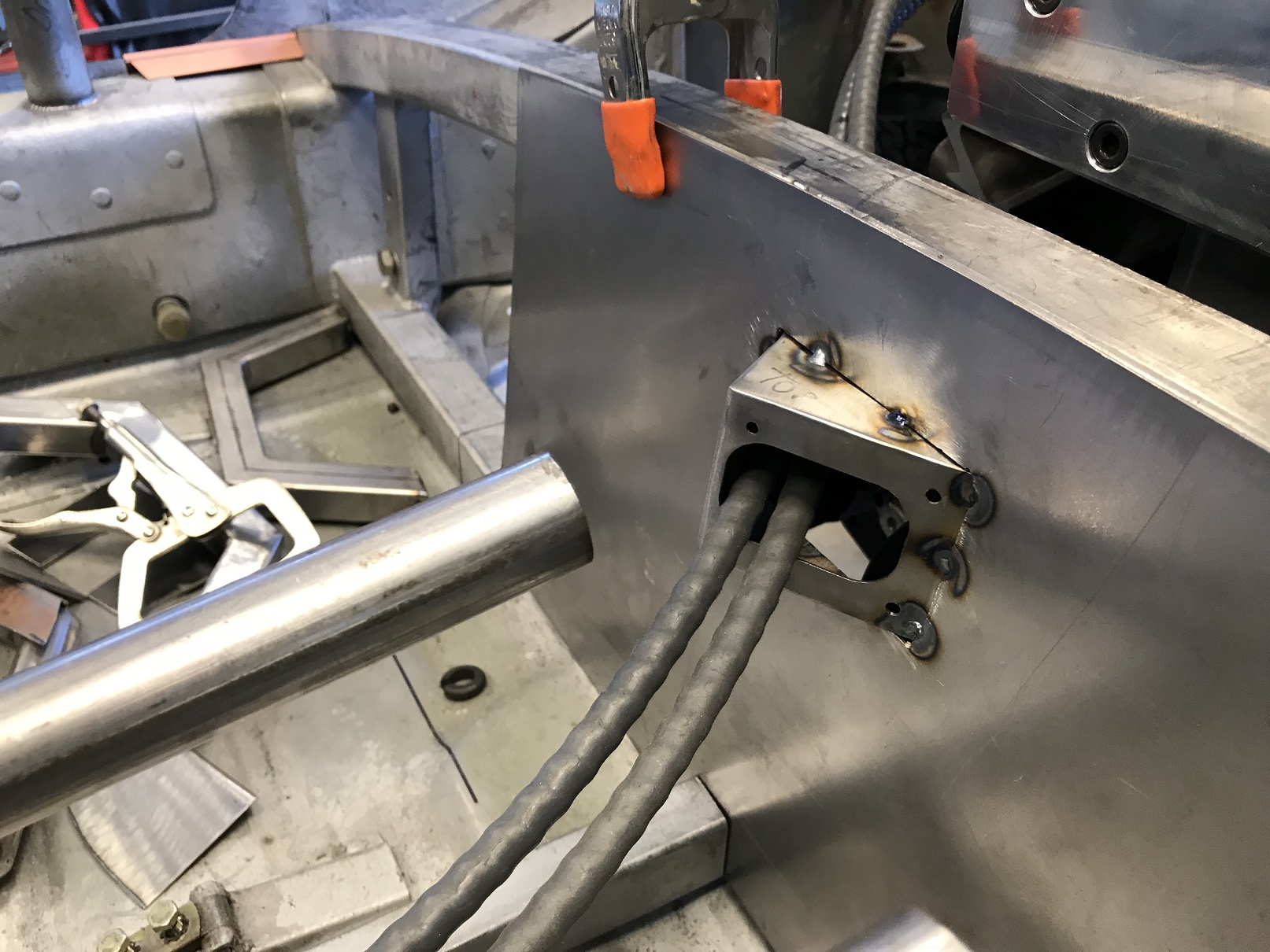

tygaboy   CHASSIS STIFFENING: Front Hoop/Door Bars In keepi...   Oct 23 2016, 01:42 PM
tygaboy   CHASSIS STIFFENING: Con'd Next, I started on ...   Oct 23 2016, 01:51 PM
Rand   I don't think you need three verts. My choice ...   Oct 23 2016, 02:00 PM
Cracker   Chris - You don't need to have your bar that h...   Oct 23 2016, 03:39 PM
tygaboy   Chris - You don't need to have your bar that ...   Oct 23 2016, 05:26 PM
Rand   Curious what your thoughts are on simply running...   Oct 28 2016, 06:17 PM
tygaboy   Curious what your thoughts are on simply runnin...   Oct 28 2016, 06:21 PM
Rand   I'm pretty sure that angle would make it toug...   Oct 28 2016, 06:33 PM
tygaboy   [quote name='tygaboy' post='2417024' date='Oct 28...   Oct 28 2016, 08:12 PM
mgp4591   [quote name='tygaboy' post='2417024' date='Oct 28...   Nov 5 2016, 03:31 AM
tygaboy   Oh boy. oh boy... is this going to be a full weeke...   Oct 28 2016, 05:58 PM
Mueller   I'd throw a seat in there 1st and test how muc...   Oct 28 2016, 06:07 PM
tygaboy   I'd throw a seat in there 1st and test how mu...   Oct 28 2016, 06:22 PM
Mueller   I'd throw a seat in there 1st and test how m...   Oct 28 2016, 07:17 PM
Dion   Fantastic fabrication. Way to go Chris. I'm ...   Oct 28 2016, 06:56 PM
Cracker   Something else to consider when designing your str...   Oct 28 2016, 08:37 PM

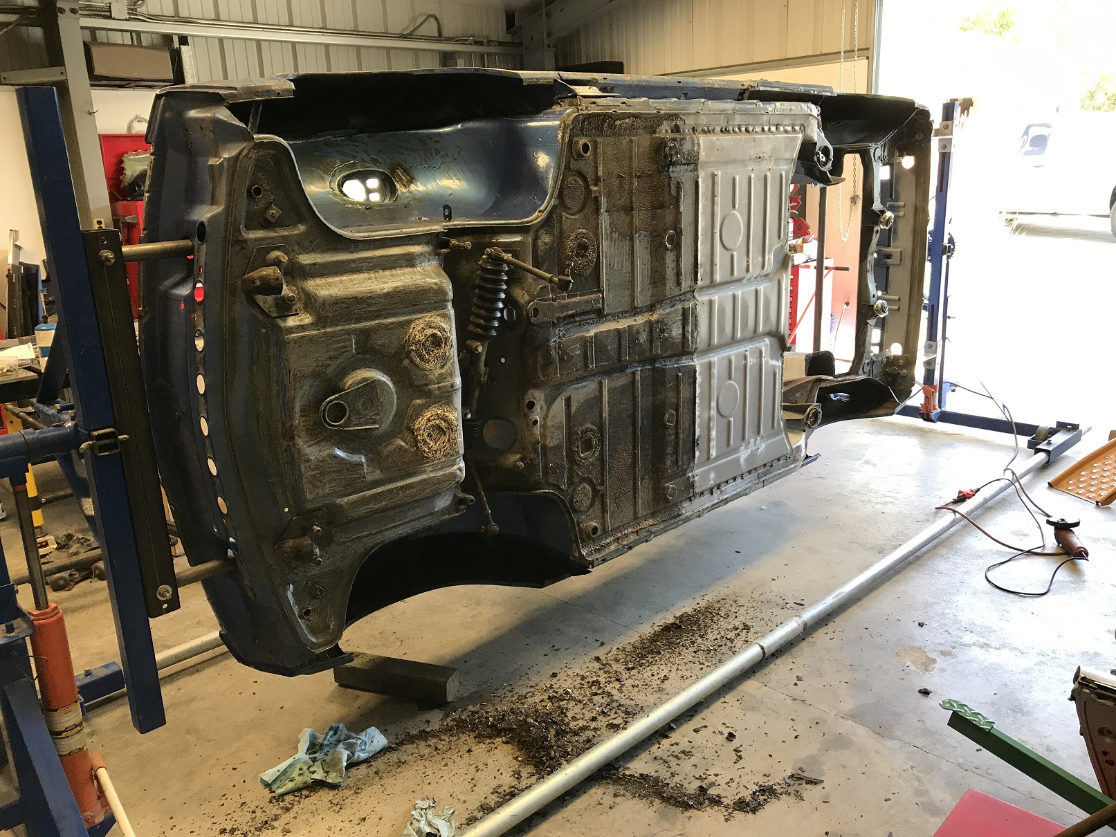

tygaboy   CHASSIS STIFFENING: Lower Firewall Today's re...   Oct 30 2016, 09:53 AM
tygaboy   Then it's roll, check, roll, check. Manual rol...   Oct 30 2016, 09:55 AM
tygaboy   Looks good to me!   Oct 30 2016, 09:56 AM

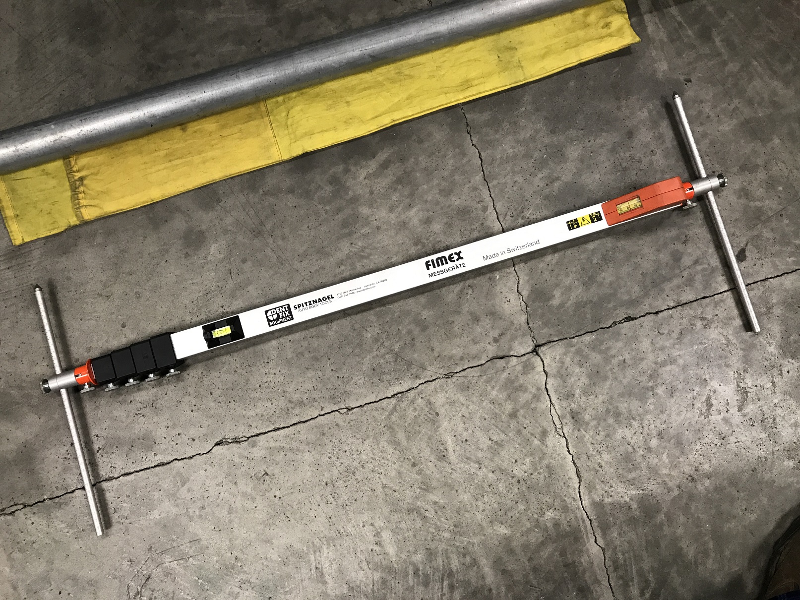

tygaboy   I'm not so confident that I trust my measureme...   Oct 30 2016, 03:30 PM
tygaboy   In the pics above, the rear floor is just held in ...   Oct 30 2016, 03:36 PM

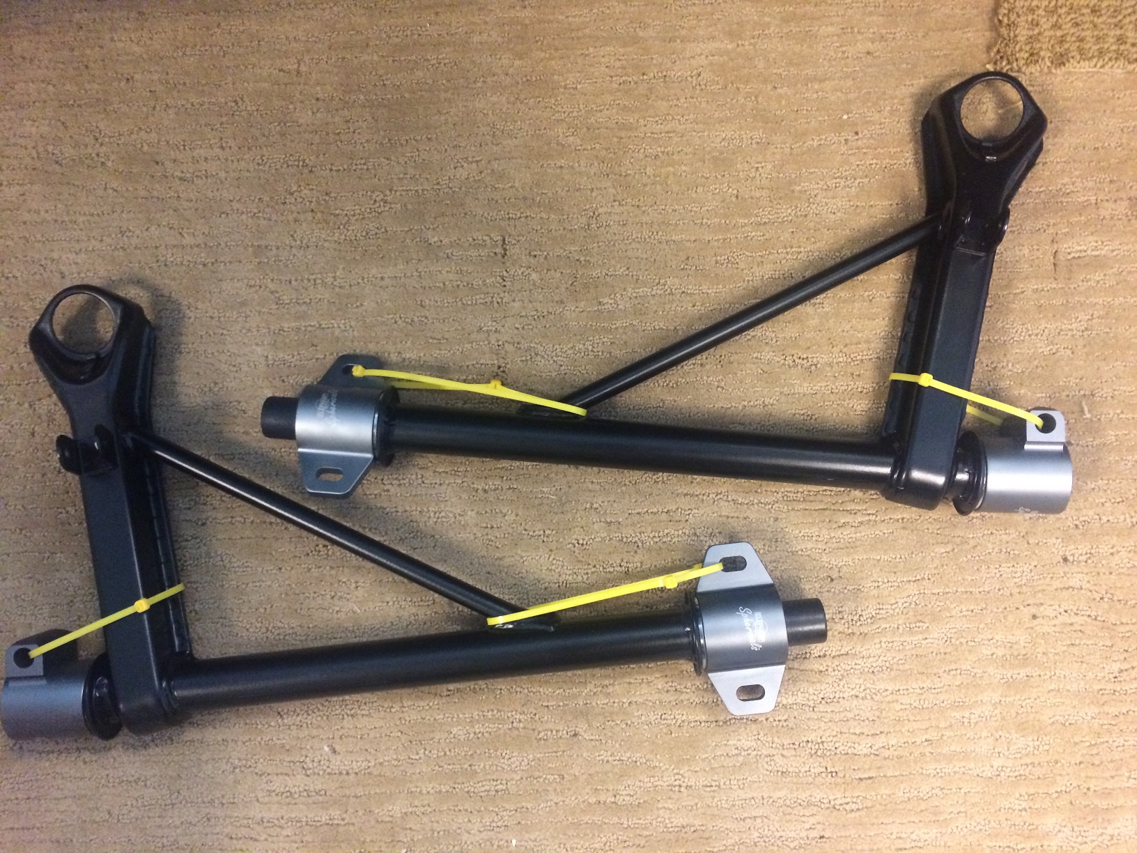

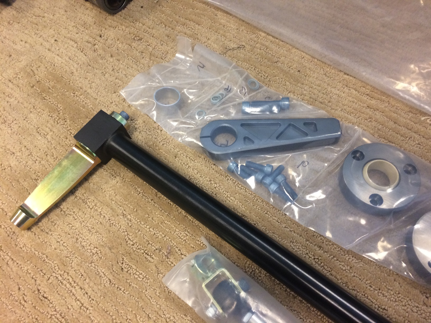

tygaboy   Suspension porn! Got my trailing arms back fro...   Oct 30 2016, 06:37 PM
Cracker   Damn right those are slick...Foley does excellent ...   Oct 30 2016, 06:47 PM

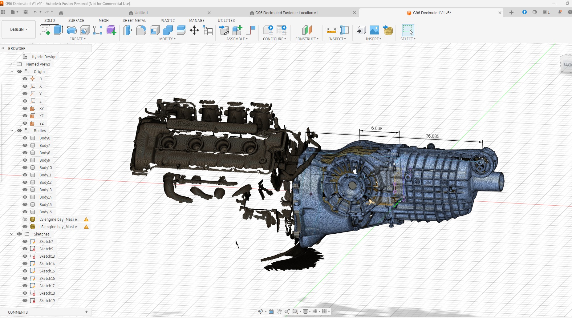

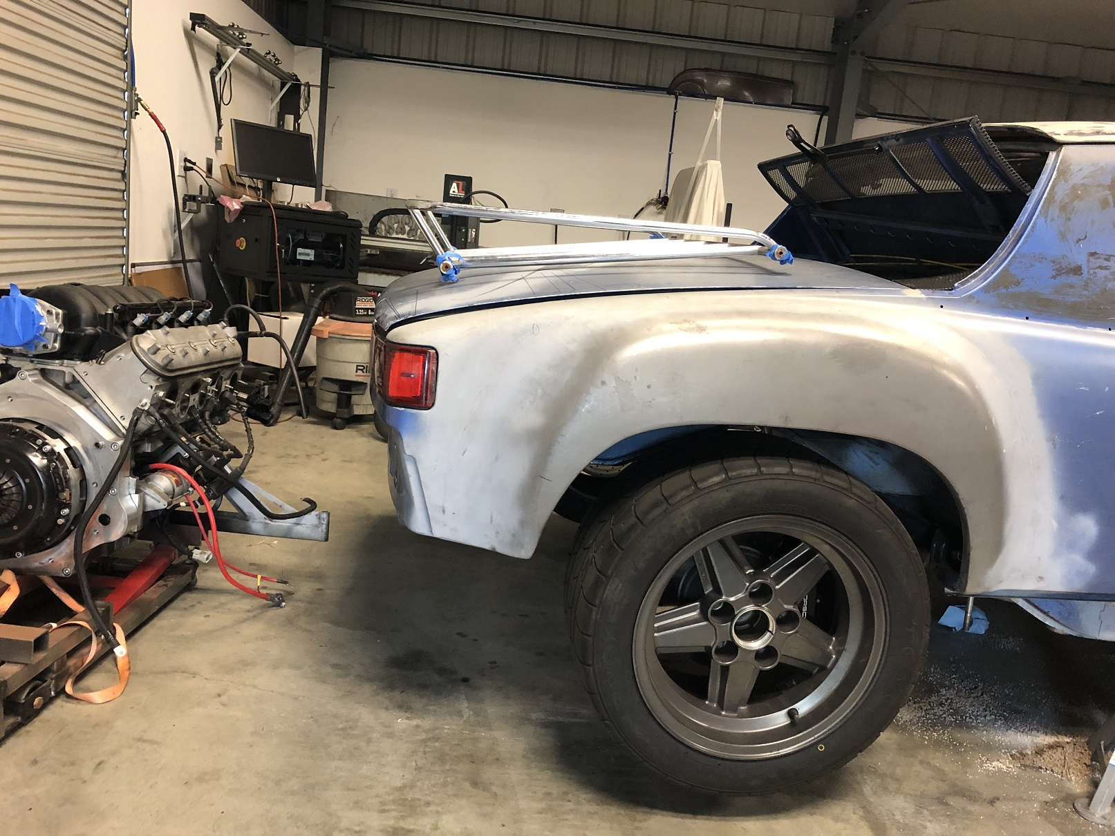

tygaboy   Engine & Trans: Mock Up November activities c...   Nov 4 2016, 05:22 PM
tygaboy   As I'm looking at this wild set up, I leaned u...   Nov 4 2016, 05:27 PM

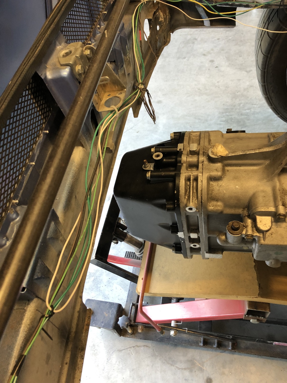

tygaboy   Major milestone! Got the engine and trans mock...   Nov 20 2016, 06:41 PM

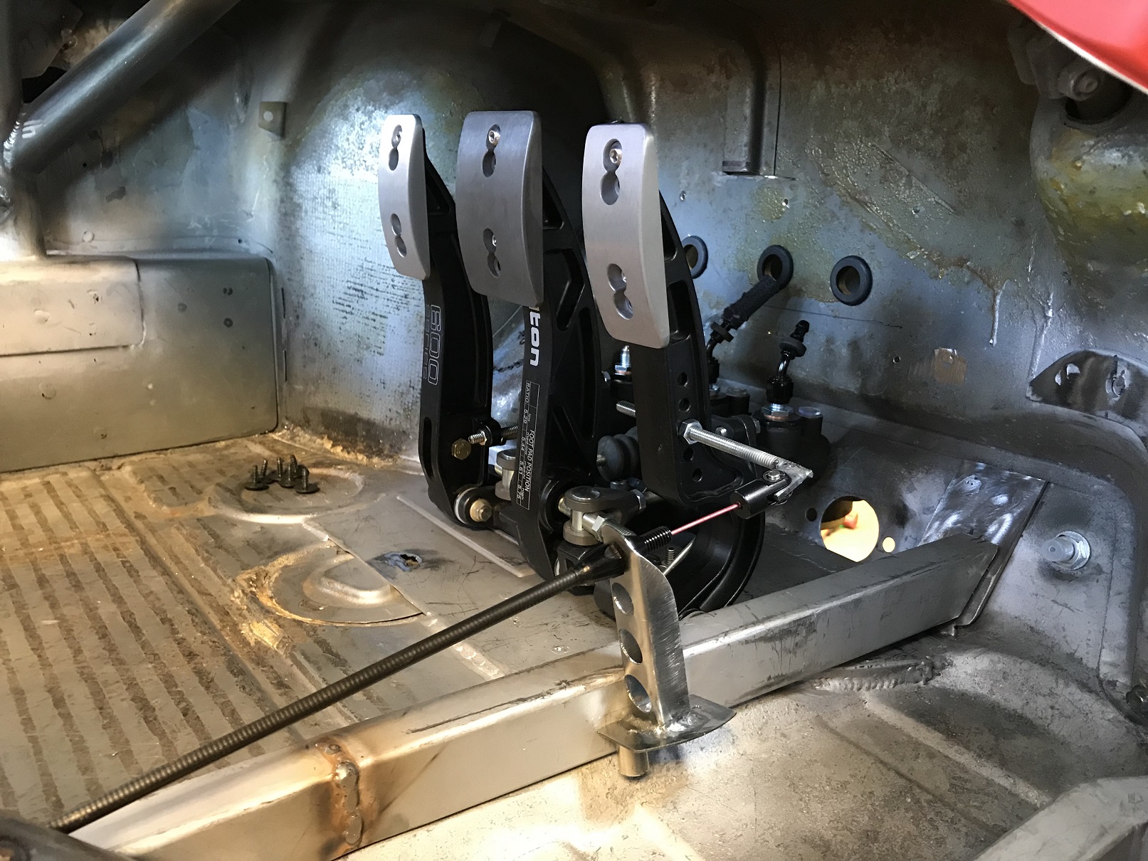

tygaboy   With the trans located, I could verify the shifter...   Nov 22 2016, 12:57 PM

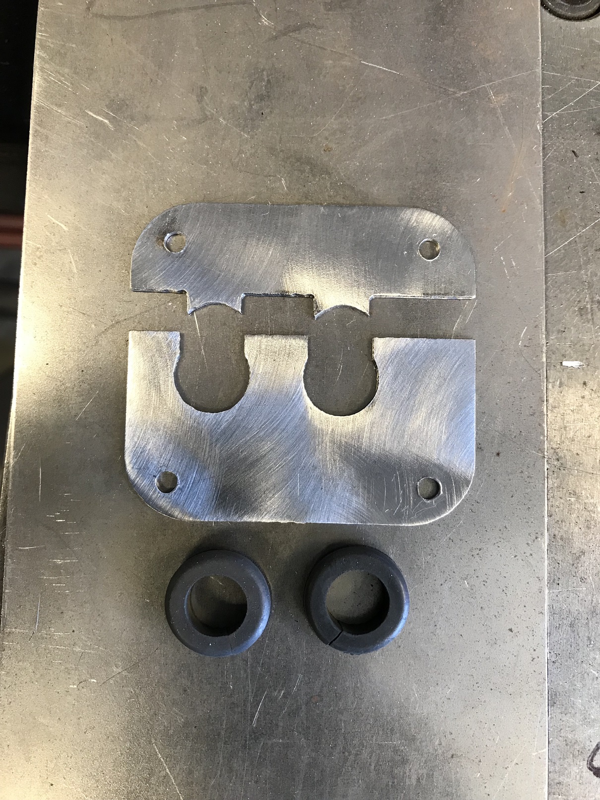

tygaboy   Some of this fab work isn't the most exciting ...   Nov 25 2016, 07:30 PM
