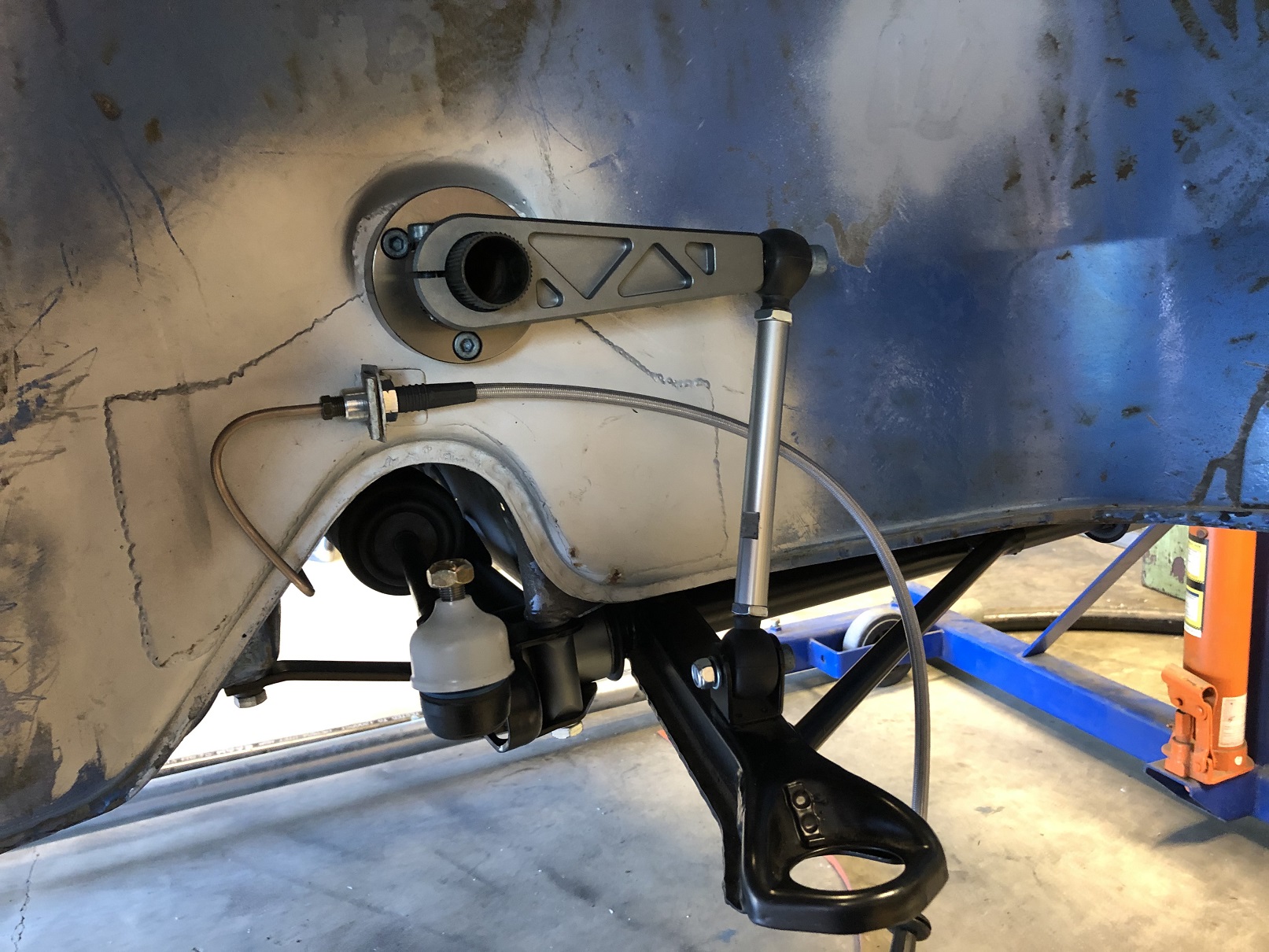

I made the formal decision to get this thing running and dialed in, then blow it apart for paint.

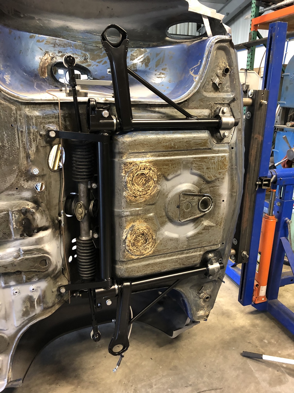

I dubbed today "Juxtaposition - Old Meets New" as I installed parts that I had done and waiting for like 3+ years. Old car, tired paint and all the new, shiny suspension porn!
Boy, what a difference working with clean, new stuff that bolts on without having to fab anything...
Anyway, here's the refurb'd front end with Turbo tie rods, Elephant spherical, misalignment bearings and bladed sway bar. I have to say, their stuff is beautiful.
And the triangular mill work goes nicely with the theme of the car.

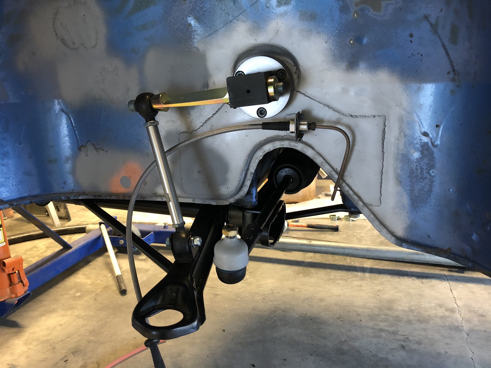

Here's a shot that shows the "blade" of the Elephant Quick Change bladed sway bar. The overall bar stiffness is easily and "quickly" adjusted by loosening the bolt on the rear face and rotating the blade. Horizontal is soft, vertical is firm. It's infinitely adjustable through that 90 degree range.
Note this is the "medium stiff" bar (.095 wall tube) vs their "heavy stiff (.120 wall).

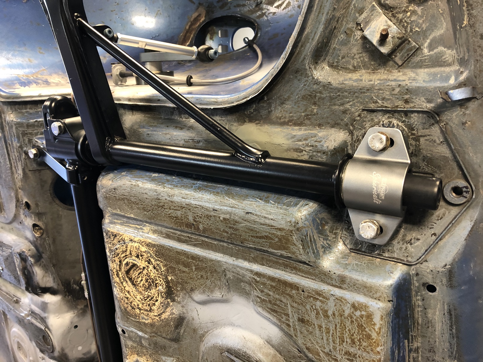

And my favorite part! It's a really nice piece... (IMG:style_emoticons/default/wub.gif)

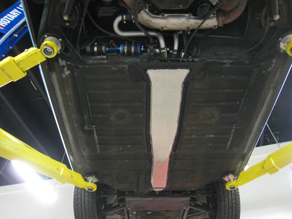

In case you are interested. My car has the cooling lines running through a custom cut center compartment. Here is a photo.Attached Image

QUOTE(Robarabian @ Apr 20 2020, 09:31 PM) *
That is what I was thinking of. It’s supposed to reduce drag.

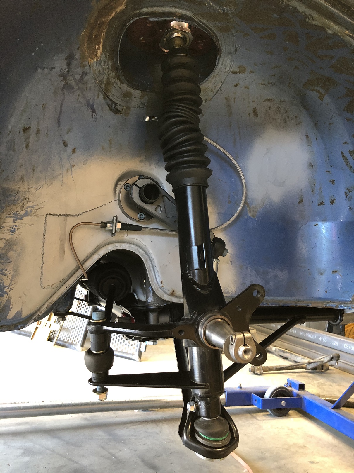

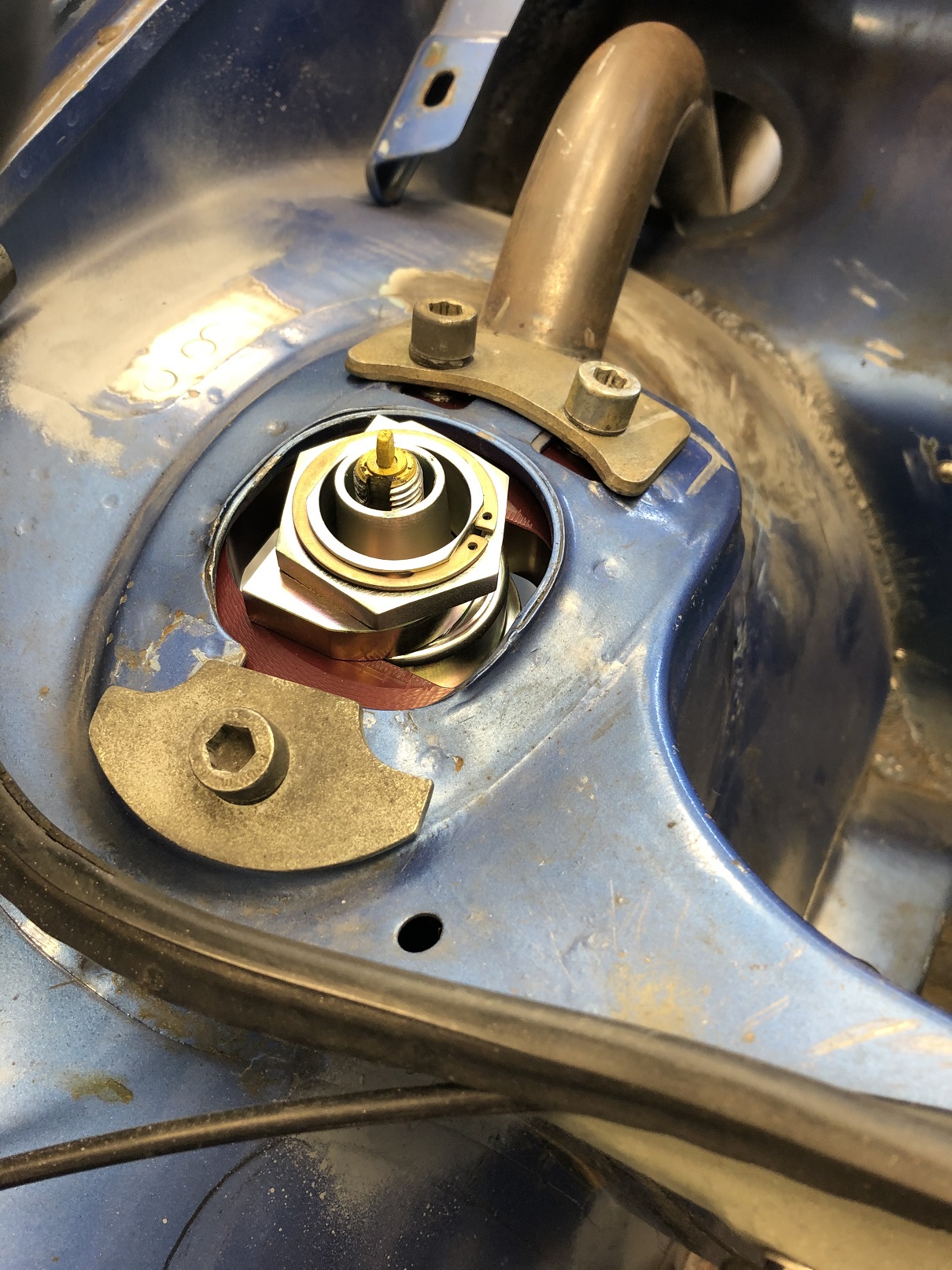

Elephant Racing QuickChange camber plates.

Raised spindles with the Elephant bump steer kit.
Getting there!
This is all in-process of being installed so yes, lots of loose fasteners and missing items.
BTW, the Elephant camber plates don't allow for the use of the standard metal dust protectors, hence the rubber gator.

@Robarabian @djway Yep, the "in the tunnel" routing is very tidy. As I've said, I have no room to accommodate routing in my tunnel and will be going with the "traditional" under body approach.

QUOTE(tygaboy @ Apr 21 2020, 11:20 AM) *
Getting there!
This looks cool. How low will the car sit with that? Can you explain what came in the kit in what was required to achieve this?

QUOTE(djway @ Apr 21 2020, 12:40 PM) *
Getting there!
@djway - It's less a question of how low it'll sit vs, once lowered to the desired height, I don't lose as much suspension travel or compromise the geometry. It's the same concept as the Tangerine raised rear suspension points I installed:
by raising the spindle, the car is lowered by that much with no/minimal changes to suspension geometry and travel. These were raised 16 mm so nothing radical. I could still run 15" wheels.

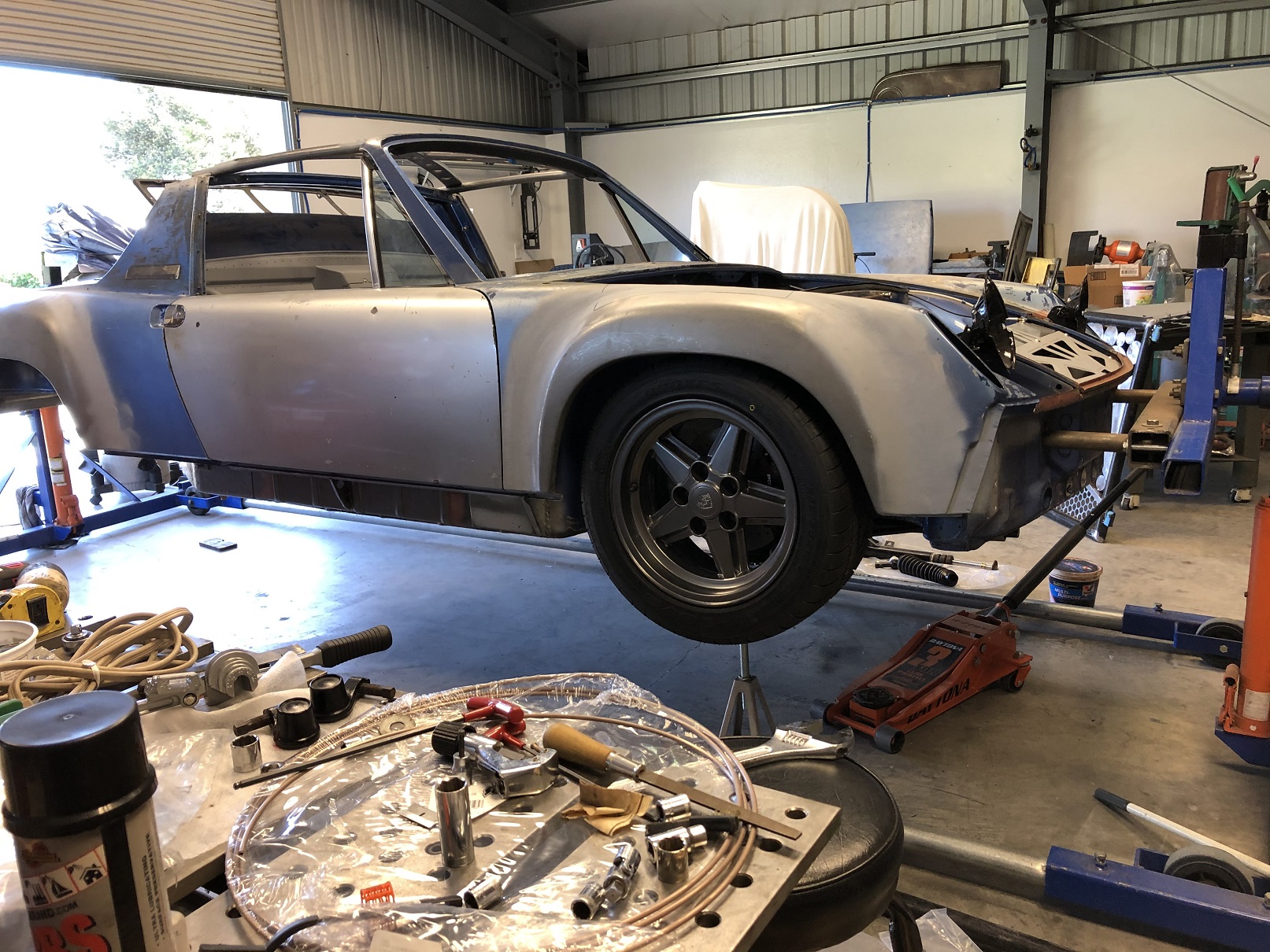

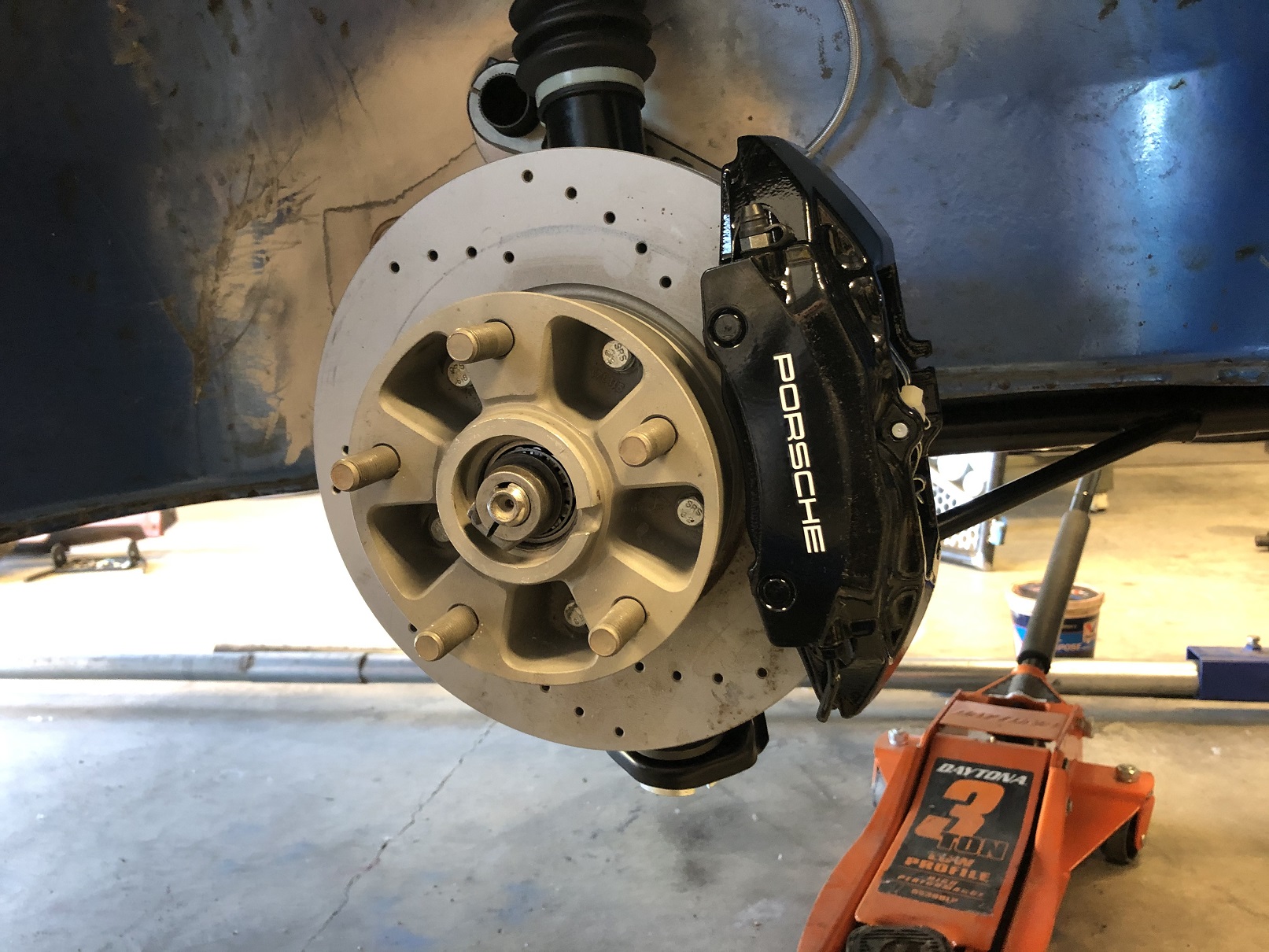

I couldn't resist a quick mock up!
These are standard Boxster calipers, not Boxster S. They work for Tony @Cracker and his LS 914 and he sees nearly 170 at Road Atlanta...
