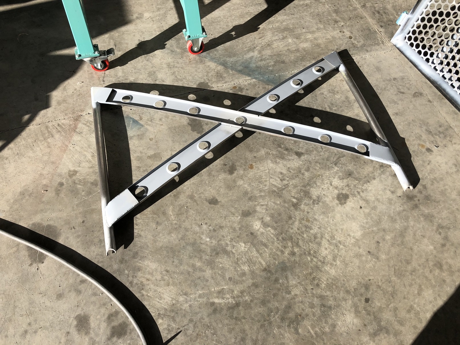

For those who may have noticed I had yet to final weld any of the roof structure to the car:
After looking at it and thinking about it for a couple weeks, I decided that a fixed roof doesn't make sense for this build. IMO, if I had done a regular full cage, then yes. But with no traditional front or rear hoop structure, or shoulder-ish cross bar, the idea of a fixed roof clashed with the "roadster cage" set up I currently have. I thought about ripping out what's there now and doing a full cage but that'd be going backwards a LONG ways. So no.
Perhaps on the next one...
Anyone want a "removable" hard top? (IMG:style_emoticons/default/lol-2.gif)
Krieger
post Apr 26 2020, 09:39 AM
Post #2548
Posts: 4,888
Joined: 24-May 04
From: Santa Rosa CA
Member No.: 2,104
(IMG:style_emoticons/default/huh.gif) Well, I think it's now safe to say this. Was anyone else reminded of the General Lee when it was installed? (IMG:style_emoticons/default/lol-2.gif) (IMG:style_emoticons/default/lol-2.gif)

QUOTE(Krieger @ Apr 26 2020, 08:39 AM) *
@Krieger Andy, that is sooo funny! I wasn't going to say anything but as soon as I punched the holes in it I thought, "Hmmm, that seems a little Confederate!"

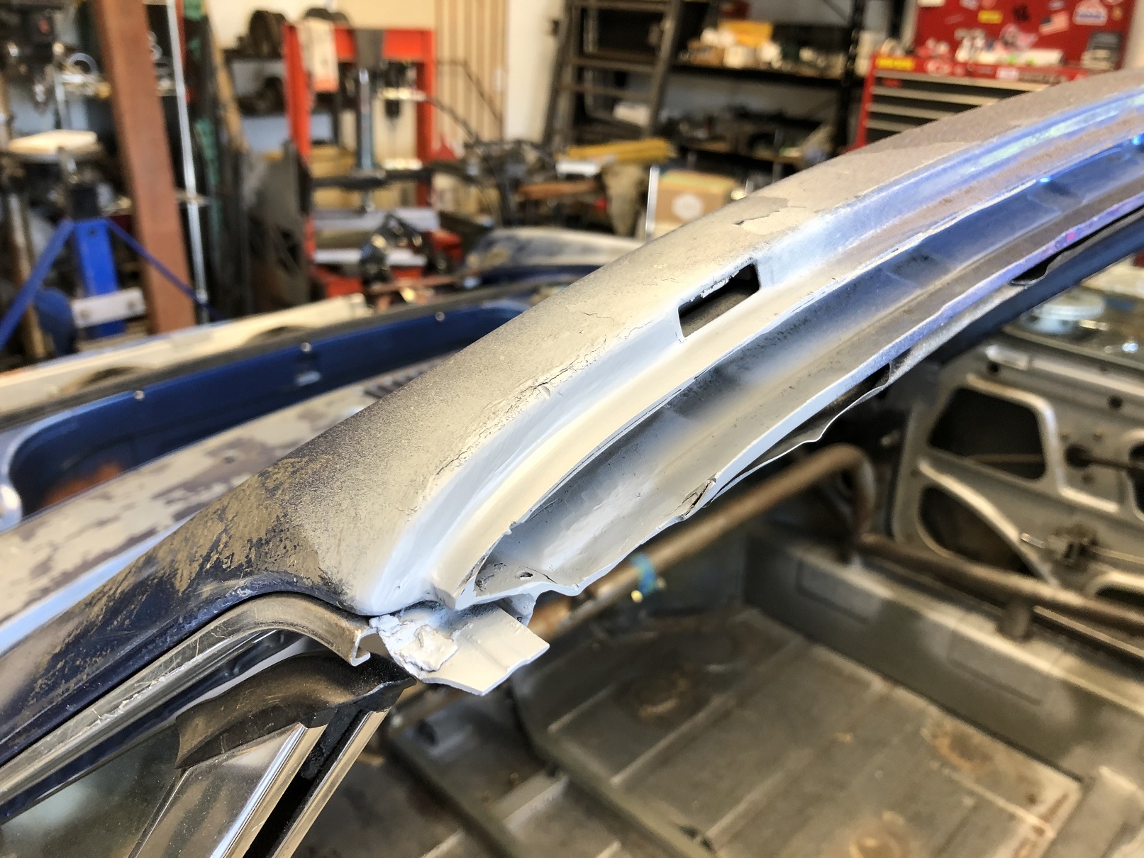

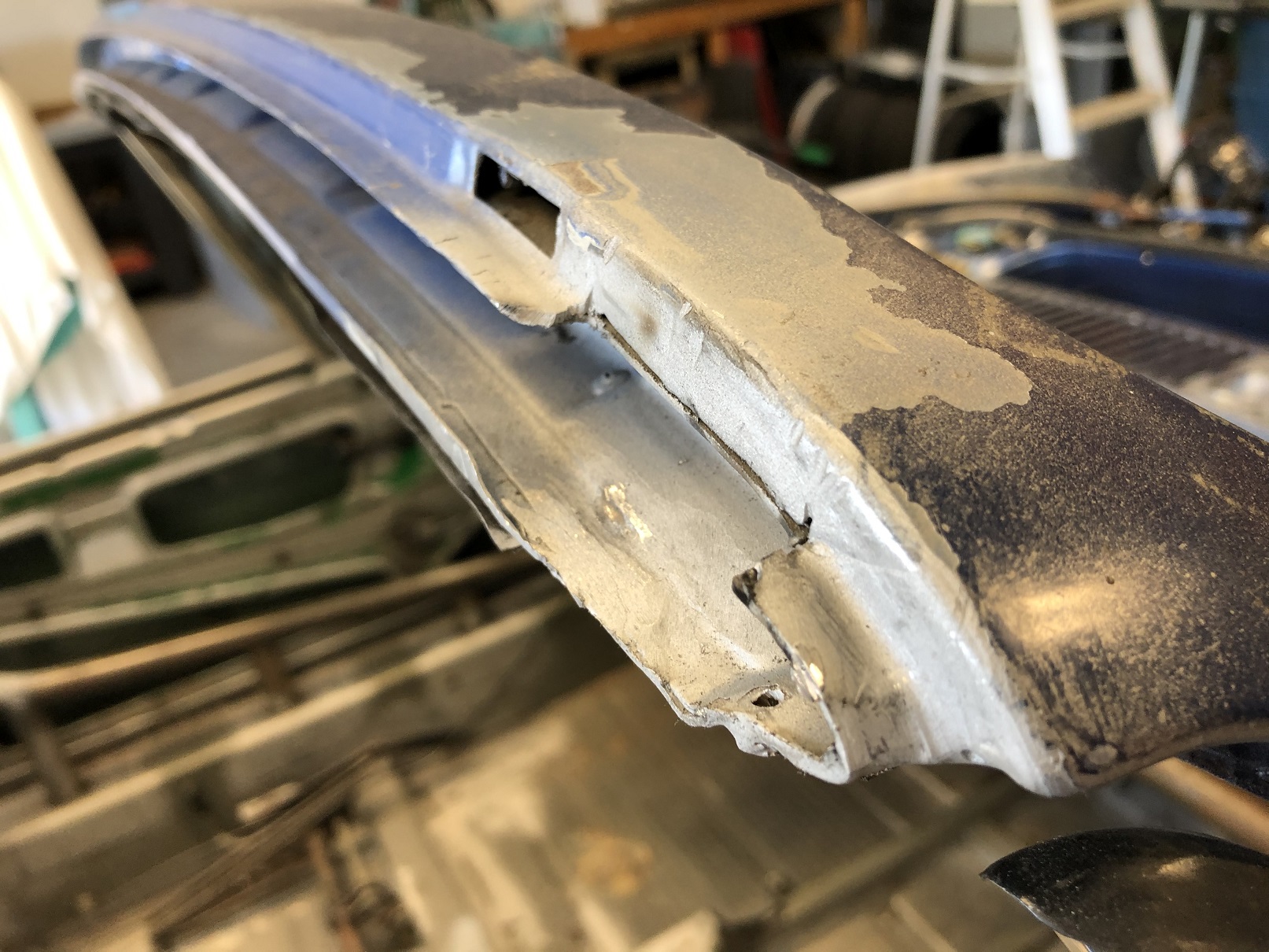

Now for the "repairs" to get it back to accept the standard seal. I need to patch in where I notched it for the side rails.
Here's the before on the passenger side and the after on the driver's.
Krieger
post Apr 26 2020, 11:20 AM
Post #2551
Posts: 4,888
Joined: 24-May 04
From: Santa Rosa CA
Member No.: 2,104
I'ma guessing there will be no sliding across the hood or hopping through the window to get in now?

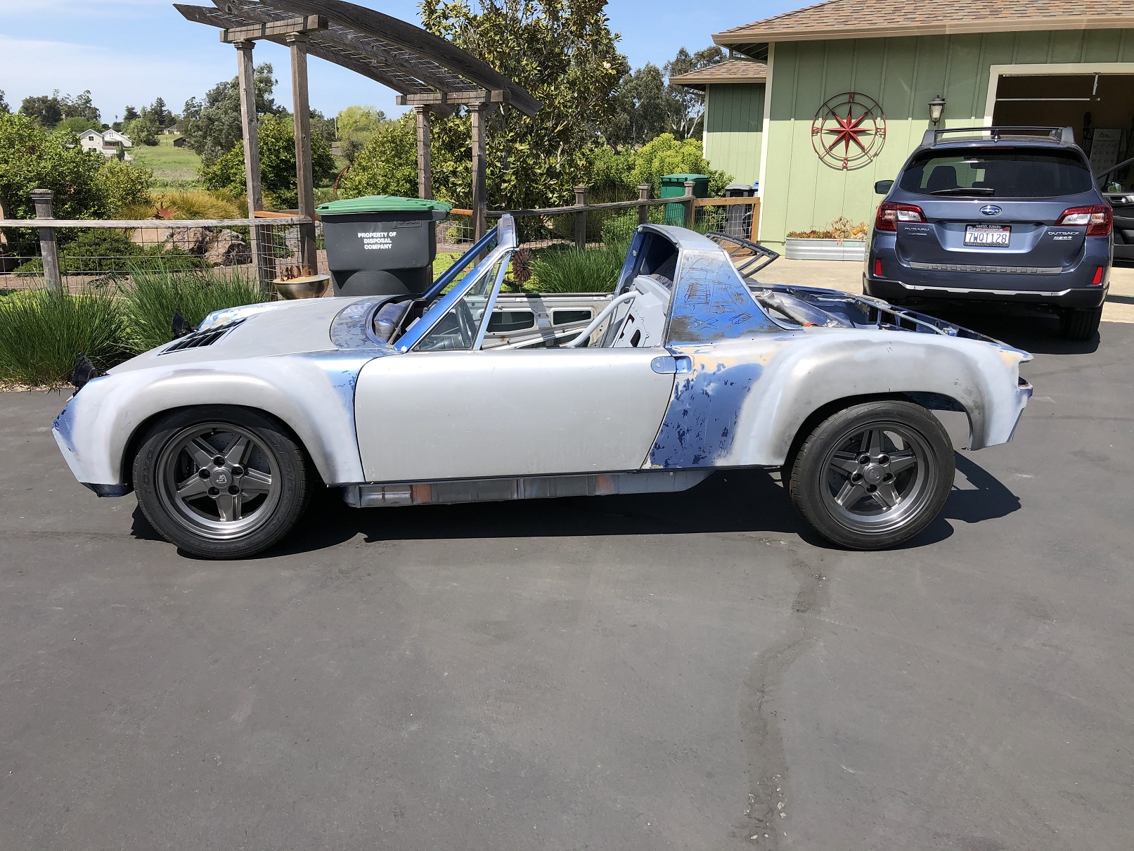

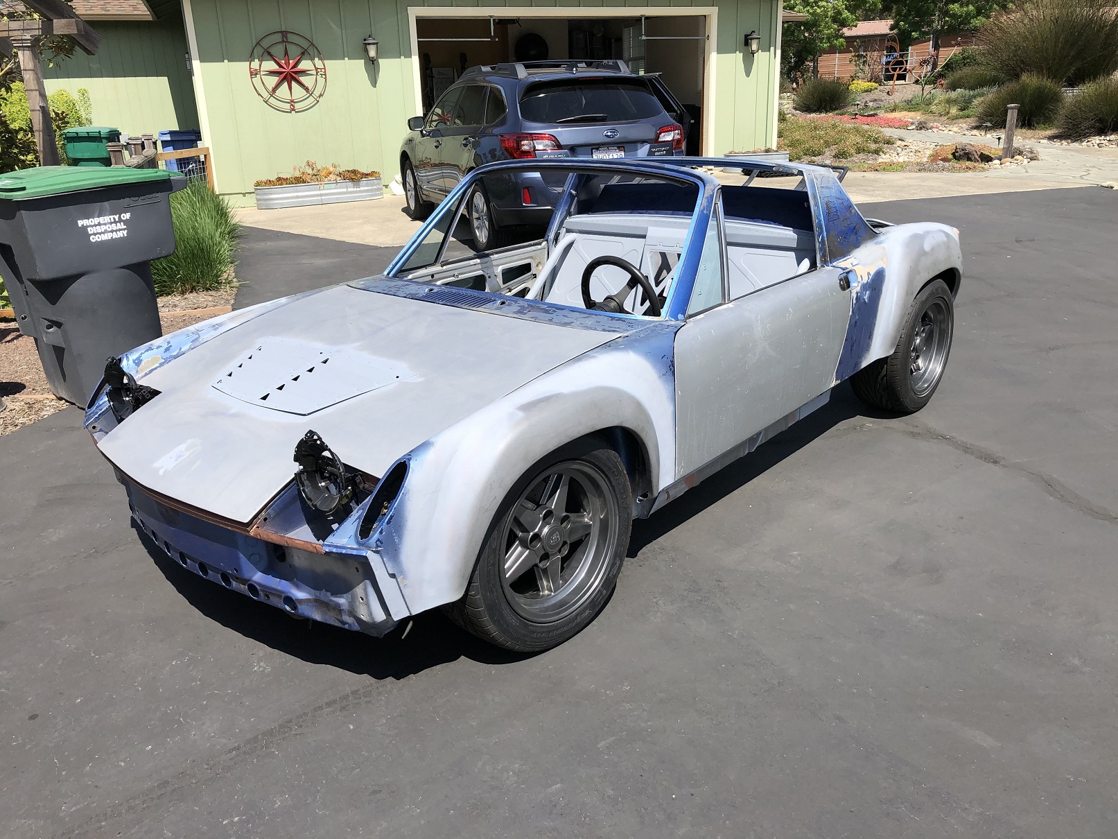

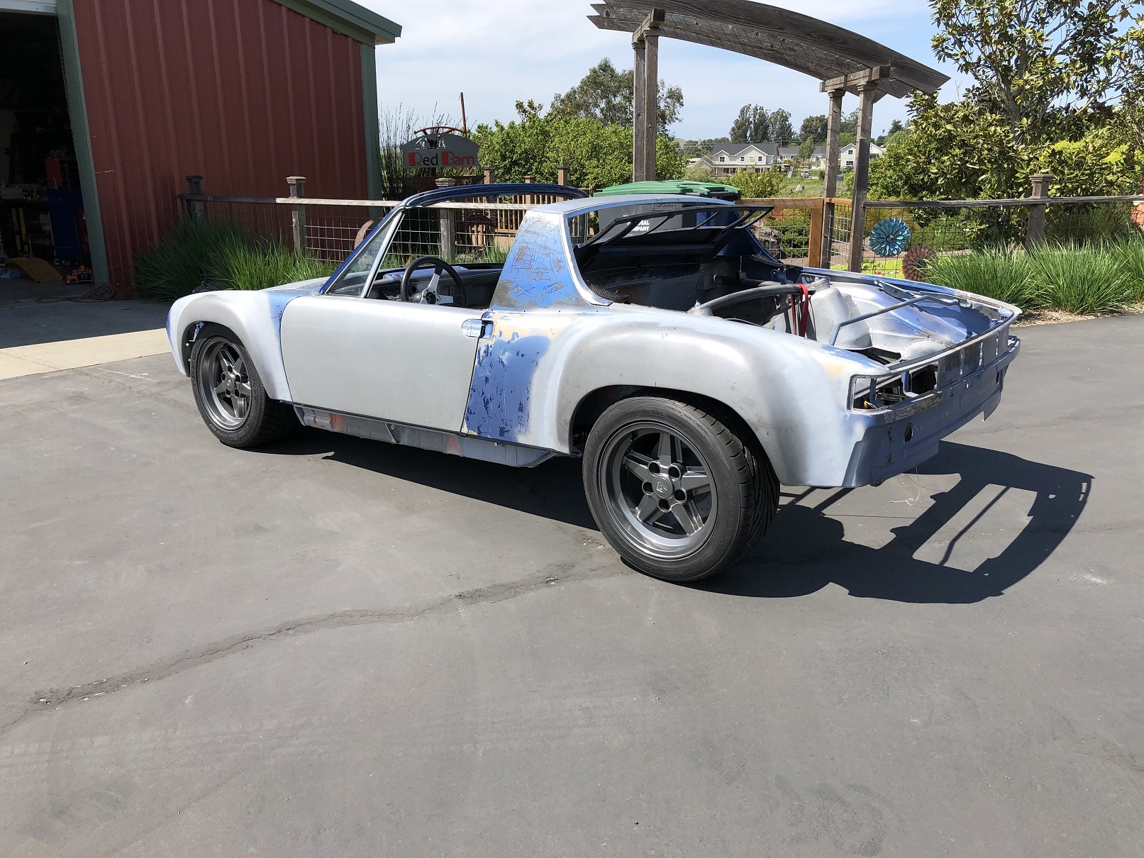

Off the rotisserie and on the ground with its "big boy wheels" for the first time ever.
Being able to see it like this after all these months, I'm reminded how small these cars are. It helps to see it in a more assembled state to get a better feel for how it's going to look.
Ride height aside, I'm happy with how it's turning out.
mbseto
post Apr 30 2020, 04:30 PM
Post #2553
Posts: 1,257
Joined: 6-August 14
From: Cincy
Member No.: 17,743
Bravo, that's gotta be a nice feeling.
Dion
post Apr 30 2020, 04:54 PM
Post #2554
RN
Posts: 2,935
Joined: 16-September 04
From: Shepherdstown, WV
Member No.: 2,766
That is looking mighty fine. I love those wheels, awesome with the flares.

Andyrew
post Apr 30 2020, 07:33 PM
Post #2557
Spooling.... Please wait
Posts: 13,381
Joined: 20-January 03
From: Riverbank, Ca
Member No.: 172
WAHOOO!!!!
Big step there! Congrats!

How did I miss that? Chris that is a huge milestone when you can see it back on the ground. Have you decided if that is the hood venting you are going with? (IMG:style_emoticons/default/beerchug.gif)
