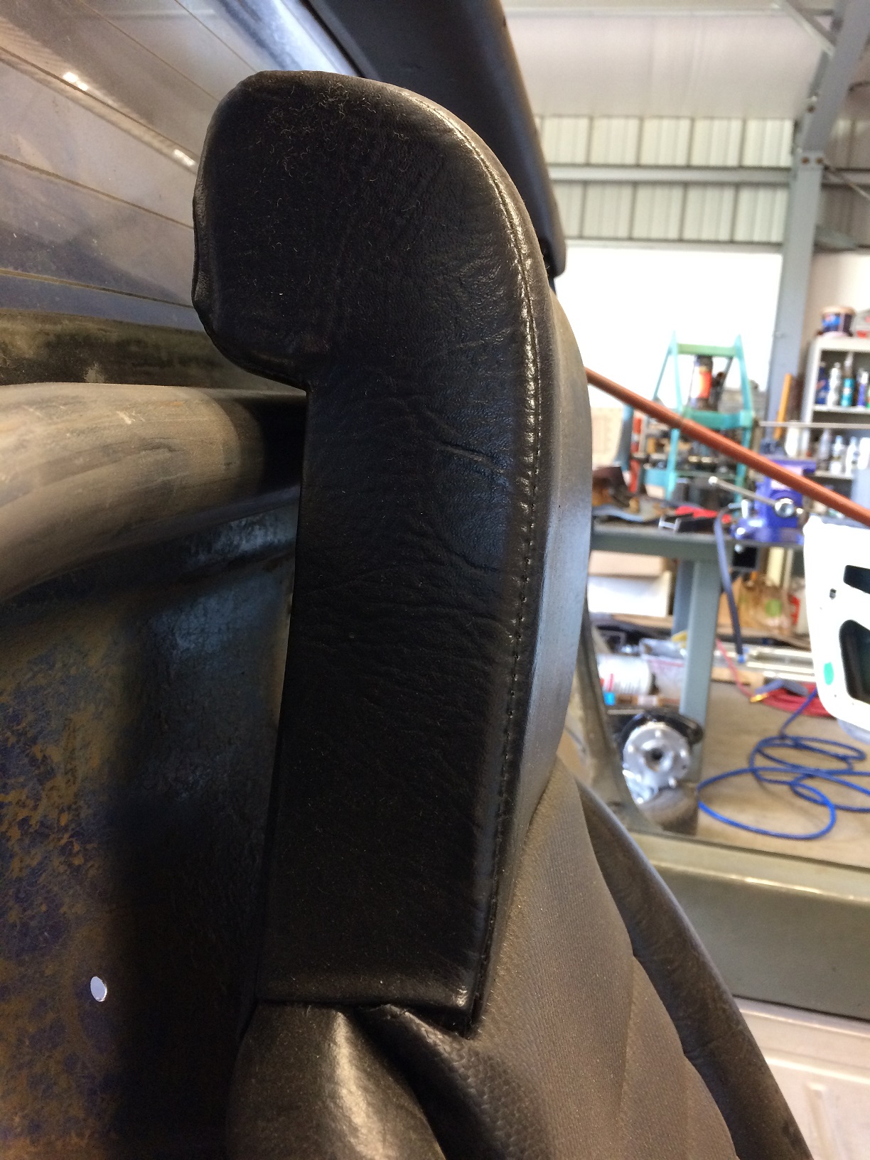

I love it when a plan comes together. How's this for a nice fit?
I'll claim this was all carefully calculated in my design specs... NOT.
Totally unplanned but come on, what are the odds?
I set the seat in place and noticed just how well my roadster cage hoop works with the stock seat. Too bad I'm not using them! Ah well.

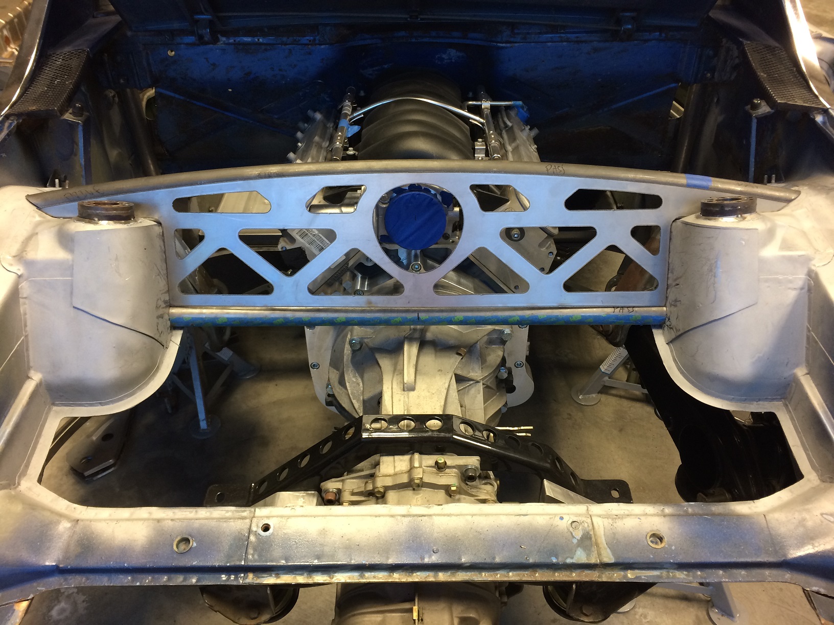

To quote David Bowie: "Ch-ch-ch-ch-changes..."
I think this is the winning version. I like the trellis look more than the holes.

I like the holes better...honestly. Its your build though...
PS: The REASON I like the dimple die holes is it looks more legit to me - the other looks like a plasma cutter made it - the holes look like it was crafted - more or less. I am being serious. (IMG:style_emoticons/default/beerchug.gif)

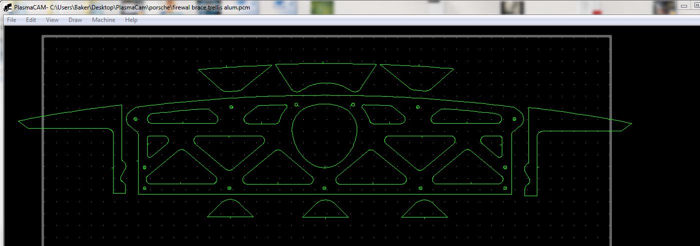

I agree that, as is, it doesn't look as "finished". But that was also the case with the other panel before I added the final dimples. The visual depth really makes a difference.
With that in mind, this latest design calls for the part to be water jet cut from 3/16 aluminum plate, like the shorty console plate. I can router all the edges to give it that same sort of look. Plus, it would be removable to ease servicing, etc.
It required a change to the "wing" area and the addition of some tabs to serve as the attachment points. Here's the current design where you can see the panel shape, along with the tabs.
It's all a work in progress so who knows what I'll actually do...

Chris,
I totally agree with Tony. The previous once with the holes looked purpose built. This, and please don't take it bad, looks gimmicky. Obviously, yours is the final decision and if you like it then that's all that really matters. We are just the peanut gallery.

I like 'em both. Which one fits the 914 you're creating? Which one are you most proud of? (IMG:style_emoticons/default/beerchug.gif)

The more I look at your cad/plasma work the more I want to say keep it simple and light. I like minimalist on a build like this. I'd love to see you keep as much metal as possible OUT of the design without sacrificing strength. Clean and functional before intricate extras that add weight without contributing to strength.
Not criticizing, just thinking out loud. Adding a pic below... Outside the green makes structural strength sense. Inside the red box, I'm not sure it adds anything except visual noise?

To everyone: I appreciate all the comments, opinions and perspectives. Your input helps me step away from my view and think about things differently. As I said earlier, I'm a brain-stormer who nearly always gets a better result when working with others.
Rand, "Visual noise" = great observation! I agree. The way the car is going to be used, I probably don't need anything aside from the cross bars. My goal is certainly not "noise" but to come up with something I think "looks good" and "is interesting". Whatever I put in there will contribute to the strength.
The fun/challenging part about design is that, invariably, it gets a range of reaction: Love it to hate it. As 76-914 implied:
At the end of the day, it's my build and I'll (eventually! (IMG:style_emoticons/default/laugh.gif) ) do what appeals to me.
As always, it's a blast working with you guys and, in all seriousness, you're helping me build my car. (IMG:style_emoticons/default/beerchug.gif)
